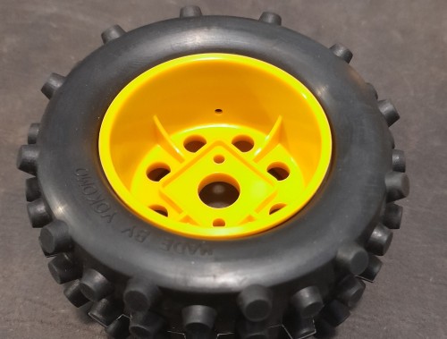

The wheels are very similar but now have tyre retaining ribs and a breather hole that was not there before .

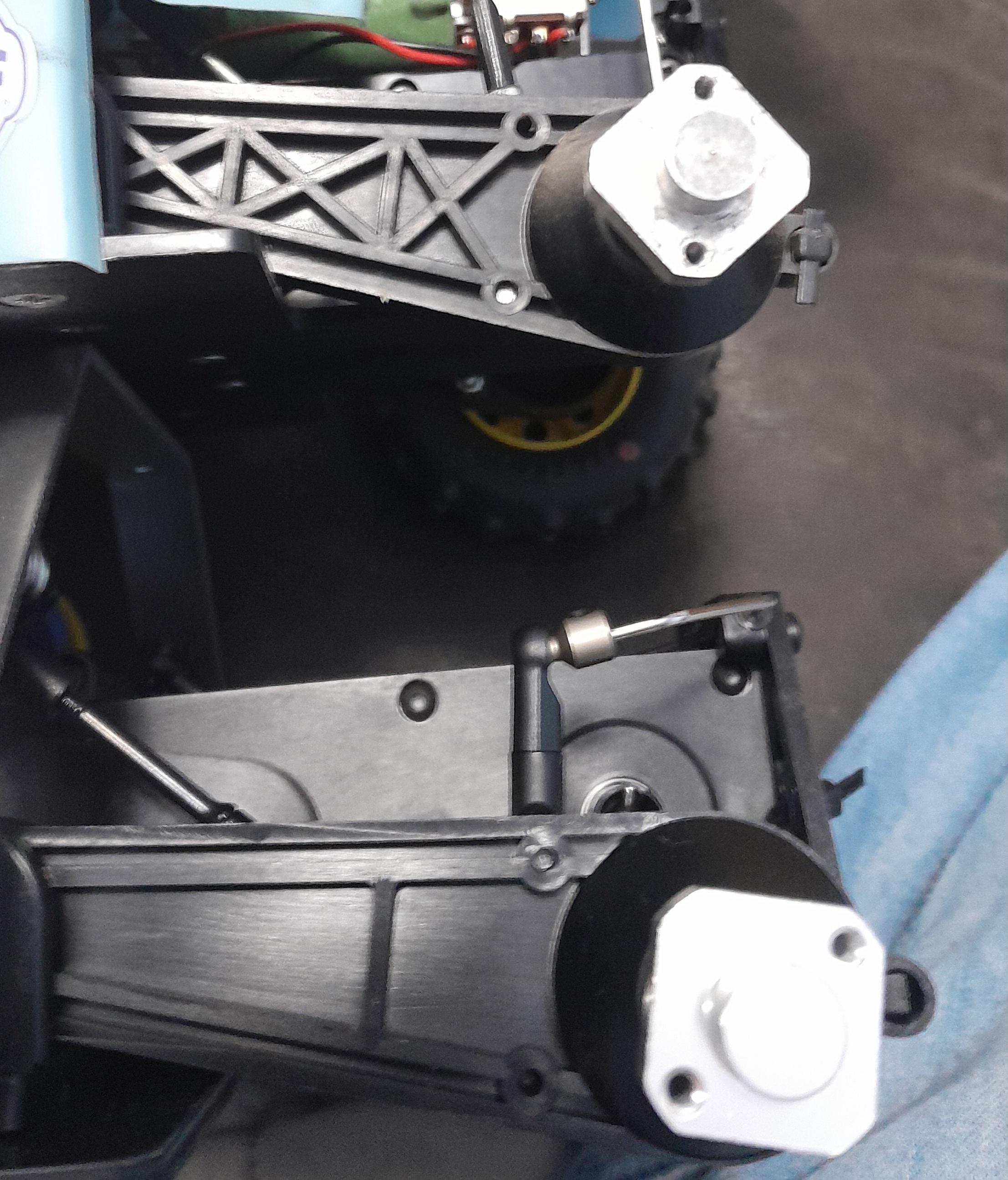

The rear trailing arms are an odity , they seem to have used the very early design with less reinforcement ribs compared to the much more common later design

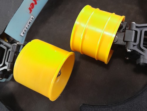

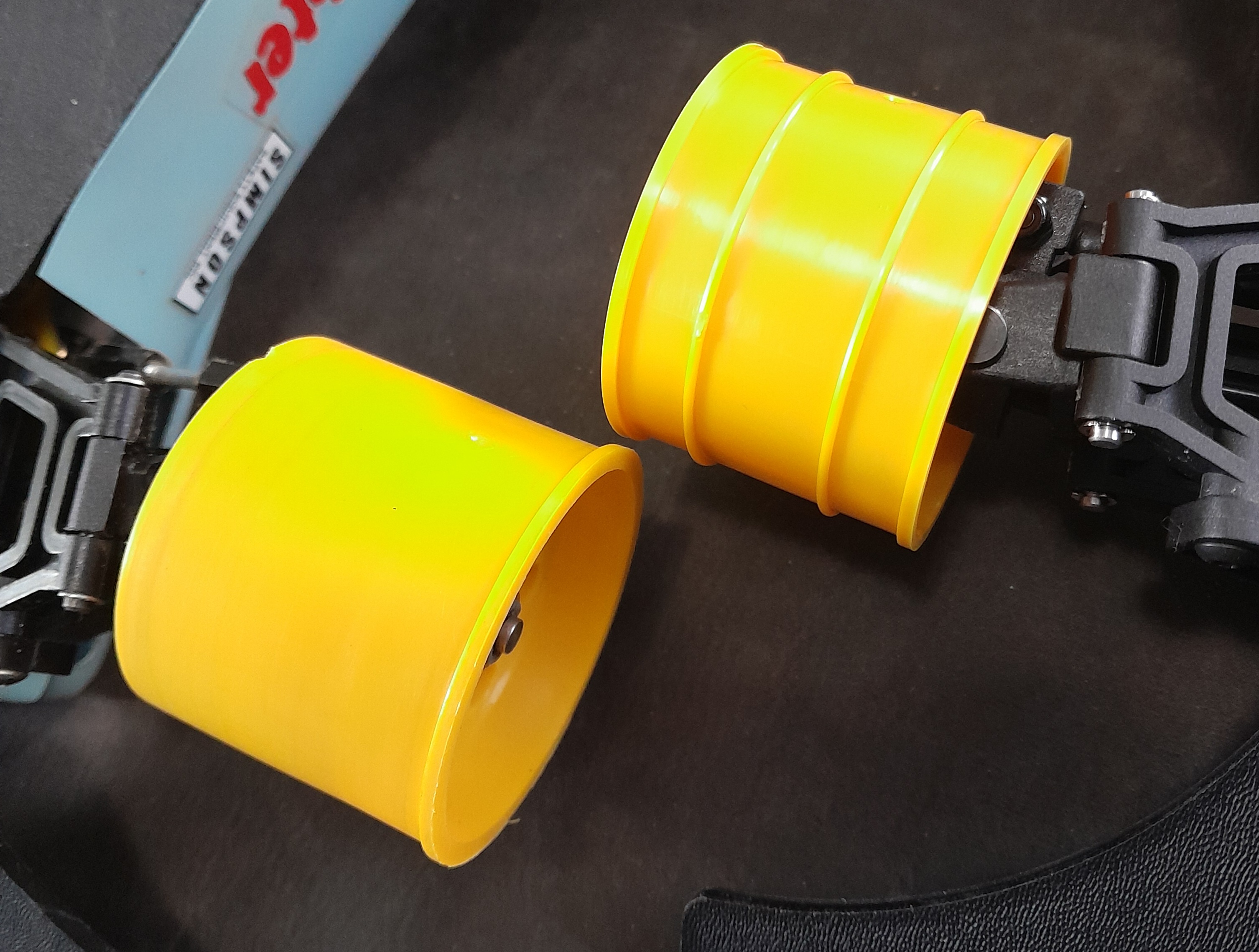

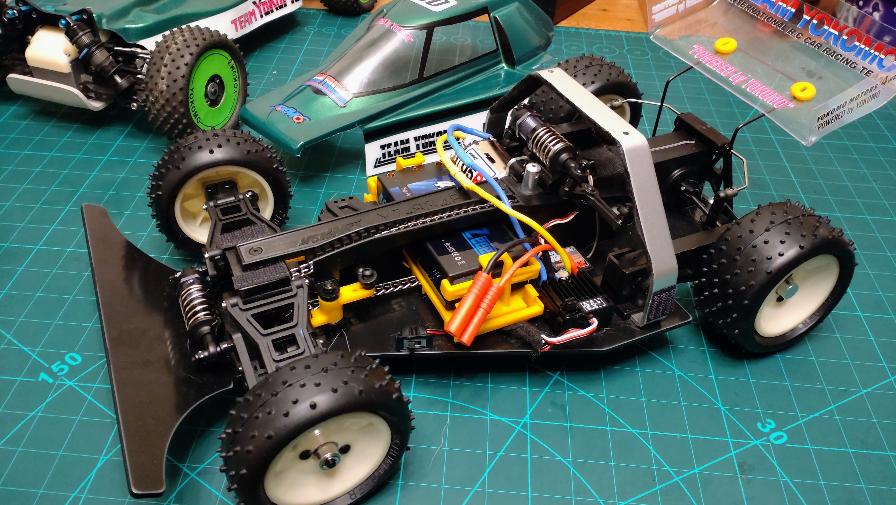

Mine is good to go, went with a cheap shorty lipo as the stick liop I was planning on using did quite fit with the body on. The stock Yokomo Motor seems to have a bit of punch for a 27T but I've only run it around the living room (hence the dog hair). One problem I had though was the rear two screws on the top deck stripped out immediately so I had to take the gearbox apart and fix them using some super glue and this Q-Bond powder I have, I then drilled and tapped them so they are much stronger now. The plastic on the gearbox and other parts feels a little flimsy but the gears and diff seem okay - not sure if putting a brushless motor in would be a good idea tho.
I also put some original 870c rims I had lying around on with some mini pins - the slightly different offset on the wheels meant that the inner was a bit too close for my liking to the trailing arm so I used an o-ring on the hub to space it out a tad. Also the centre hole diameter is larger on the later wheels but the hub is the same size so they do fit just not perfectly.
With the car fully equipped the rear seems to be a bit on the low side and I can't seem to add enough preload on the kit spring to raise the height enough - I might put a stiffer spring on before I run it proper, or have a play with the turnbuckle lengths to see if that makes a difference.
I can't really compare it to an original as this is the first one I've had but overall it is a cool buggy and very different to the later 870'c and works cars.

I'm going to revisit this as I've noticed the rear trailing arms do twist more than the later version originals ,seriously thinking of getting some stiffeners from Factory works .

Tbh I have never done a side by side comparison with and without the stiffeners, but they are made from .030 thick (~0.75mm) g10 (which is what Hot Trick used, and limited by the arm mounts) and I just don't know they they do a whole lot other than add the classic appearance.
