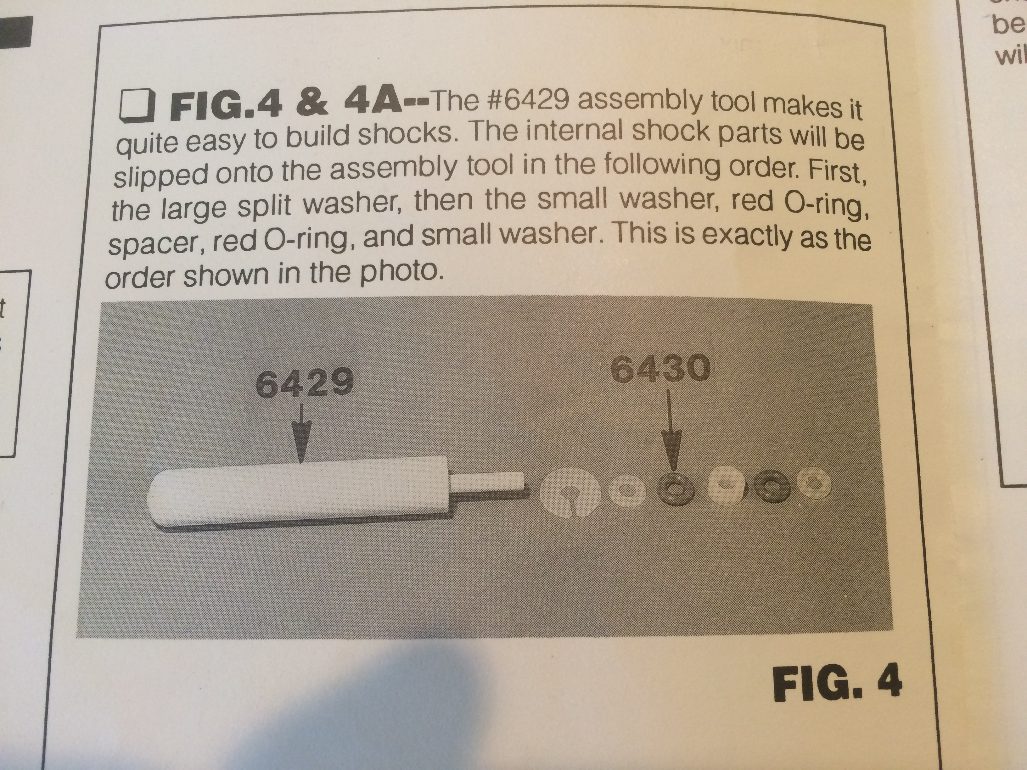

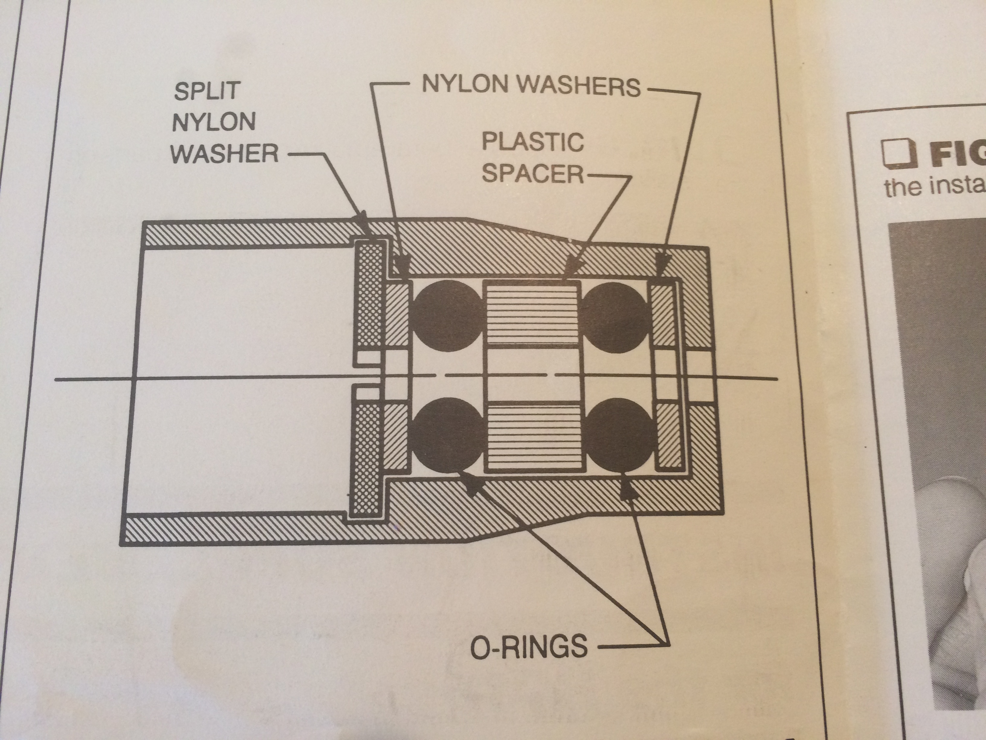

Another shock question. I’m buying the rebuild kit and just noticed the split washers in the kit are not the same as the ones I have in my shocks. Mine are round split washers like the ones in the pic from the manual I posted. The kit has square looking ones. Will these work with my shocks? What’s with the change? I asked AE and they said they had a running change on the shocks. So I don’t know what the evolution is of the shocks on this car but mine are slightly different than what the kit is for I guess. Is the washer the only difference? Is there a different shock body? Pistons? Anyone know and can help clarify for me?
Thanks for helping the new guy here!!

- jwscab
- Posts: 6580
- Location: Chalfont, PA
- Been thanked: 505 times
Re: RC10 CE updates
the squared washers are fine. they are updated from the original round ones. I think they are probably easier to install and remove.
other than gold or hard anodizing, the top load shocks are pretty much the same until you get the V2 style bottom load.
