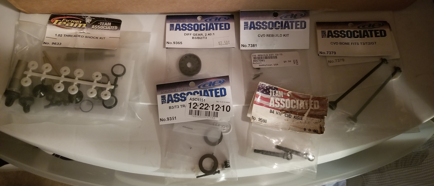

Parts rolling in. Went with B4 axels as readily available. Hope they fit!

V2 threaded shocks. If you are using the B4 axle with the blue spacer you will have to use B4/T4 hubs to make the B4 axle work.

Yes, exactly! I was unable to confirm it would work so just figured I would try! Hopefully do some building this afternoon. Waiting on my bearing order from Avidbroodenburg wrote: ↑Wed Sep 26, 2018 3:39 am Ahh nice updatesV2 threaded shocks. If you are using the B4 axle with the blue spacer you will have to use B4/T4 hubs to make the B4 axle work.

B4 axles worked perfectly with blue spacers. Freshly built cvds in stalled.
