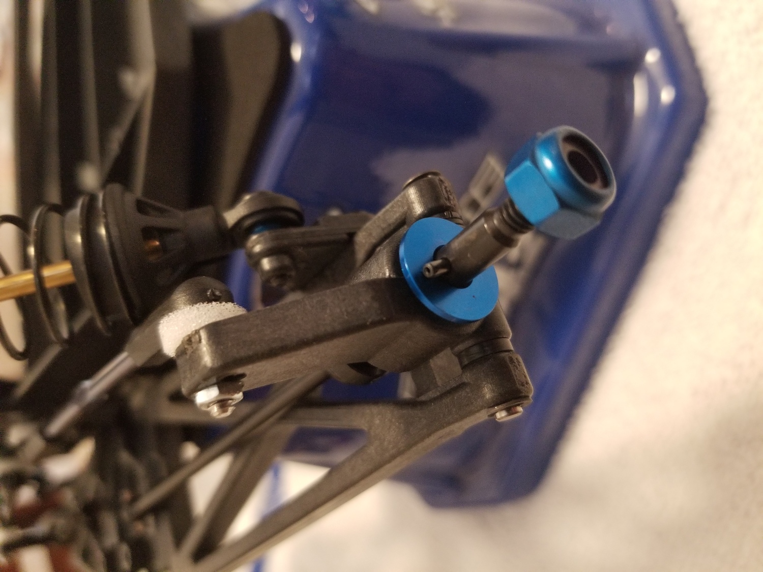

Did not want to buy the springs again from AE. So made the shocks big bore spring as i have the kits for this. Used traxxas # 3768 for the top collar. Fits perfect. Then jusy AE bottom retainer for 12mm. Feels amazing

Fronts mounted. Justed needed to add a bullstud washer on top mount for spring clearance

B4 axles worked perfectly with blue spacers. Freshly built cvds in stalled.

Good to know that the cheaper traxxas 3768 retainers do the trick. I also have BB rearsprings on V2 shocks. I don't like how the normal rear ones rub....
