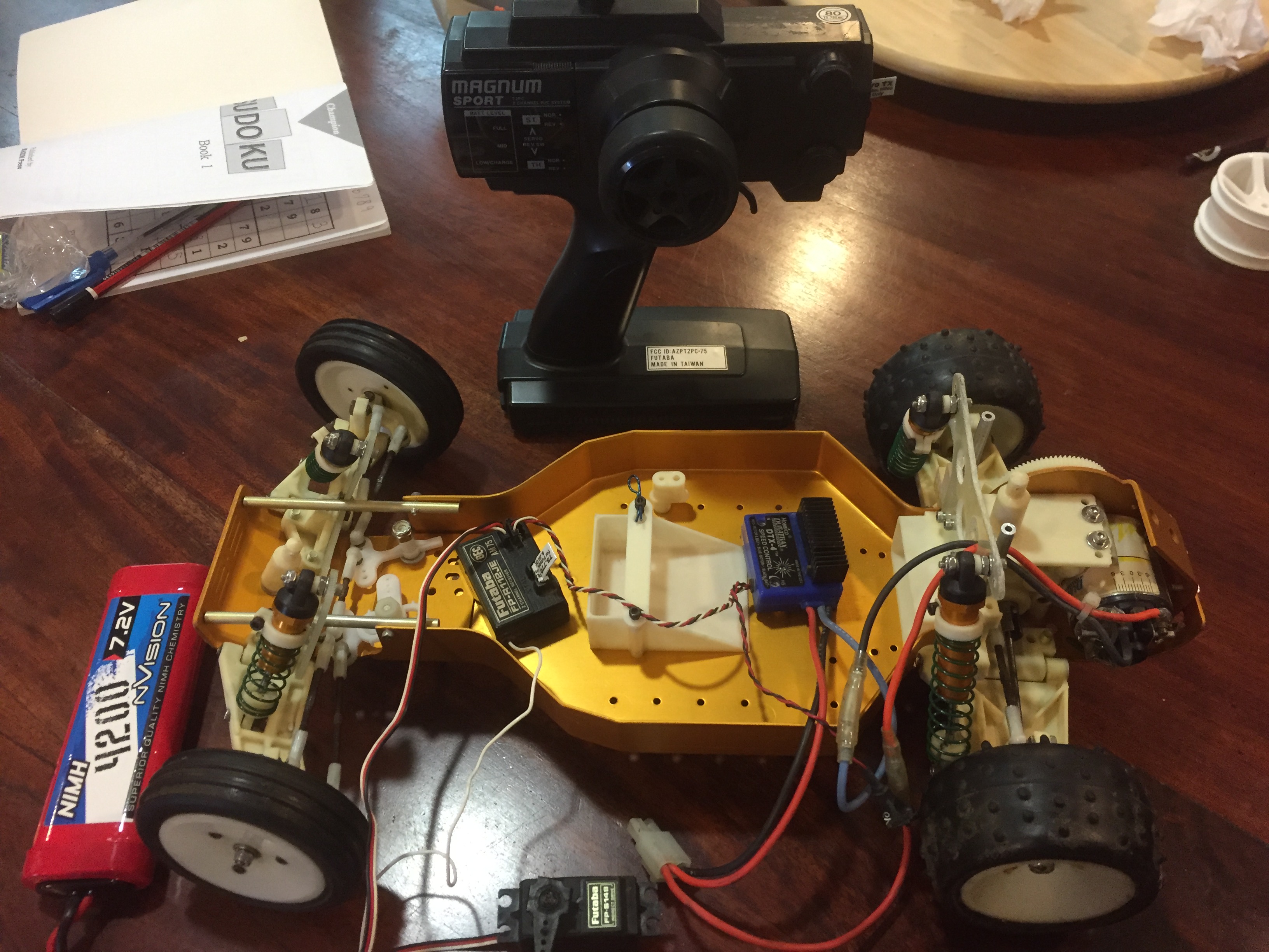

So I received my crystals but can’t get anything to work yet! :(
Wondering if I should just buy some modern electronics to run this. I have a week off now for Christmas and would like to get it going. I should be able to buy something locally here. No idea about the new gear though.
XLR8
Posts: 3318
Has thanked: 1684 times
Been thanked: 1180 times
Re: Got my first RC10 - time for a re-build
Post by XLR8 »
Hum, well that's a bit discouraging. :?
Based upon the photo, you appear to have everything connected correctly; Tx crystal in transmitter, Rx in the receiver, ESC connected to receiver channel 2, steering servo to channel 1. Assuming the problem is on the Rx side, is it possible that the ESC's on/off switch is bad? Sometimes dirt will find its way into these switches causing them not to power up. If the transmitter fails to power up, there could be corrosion on the battery contacts or they've become flattened and are not making contact with the battery holder contacts. I've had both problems with my old Futuba transmitters.
If you'd prefer to throw in the towel and upgrade to a modern radio, virtually any 2.4 ghz system should work with your existing servo and ESC. I've seen some off-brand radios sell on ebay for as little as $25.
Anyway, have a great Christmas and please update us when you can. :D
