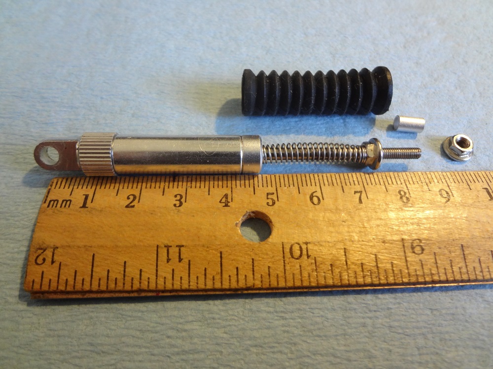

What is the total expanded length of the shocks, from the center of each eyelet to the opposite?

Hmm, that's pretty close to Kyosho Gold long shock length...those are about 90 mm, if I recall correctly.

Re: HG-P407 "Bruiser Clone" Arrived Today!
Why did they decide to fit the little spring over the shaft ? , I'd be interested to see if they are smoother without the spring ?
IMO the spring over the shaft is useless. The rest of the suspension is so stiff, it doesn't notice if its there or not. I diassembled this shock while I had it off the truck. I tried some different weight fluids. The first thing to address, I think, will be to enlarge the piston holes. Even with 20wt oil, the shocks would rather leak out the end than cycle. The floating brass piston and shock stop spring are also a joke. Something that is cool in concept, but is not even close to working properly. I'm thinking when I get a few minutes to play with it, I'm going to eliminate all that useless stuff and rebuild the shocks properly and enlarge the piston holes.
I'm assuming the floating brass piston has an O ring and bleed screw ? , is the O ring over tight causing the floating piston to be too tight ? I've had some success with resizing the O rings in other applications , if it has the bleed screw then replace it with a long screw and use the extra thread to fit into a drill chuck , spin it up in a drill and use very fine wet n dry 600+ grades to take a little off the O ring until you get a better fit . I'll try it on mine when it arrives as well as removing that spring .
Lots of trial and error but I got the shocks working and the oil to stay in !
As I mentioned earlier the pistons have to have two flats sanded onto the edge to allow more oil past them , the bottom seal for the shaft I added a small 2.5mm inside diameter O ring and removed the metal washer , the cap take's a bit more force to screw up but the additional O ring makes a good seal , finally the floating cap , this is the tricky bit , you have to pry out the O ring and that's easier said than done believe me ! then use some PTFE plumbers tape to wrap around inside the groove the O ring sits in ,I found two times round was the charm , then re fit the O ring , the cap should now have a good tight seal but still move up and down with the volume change .
