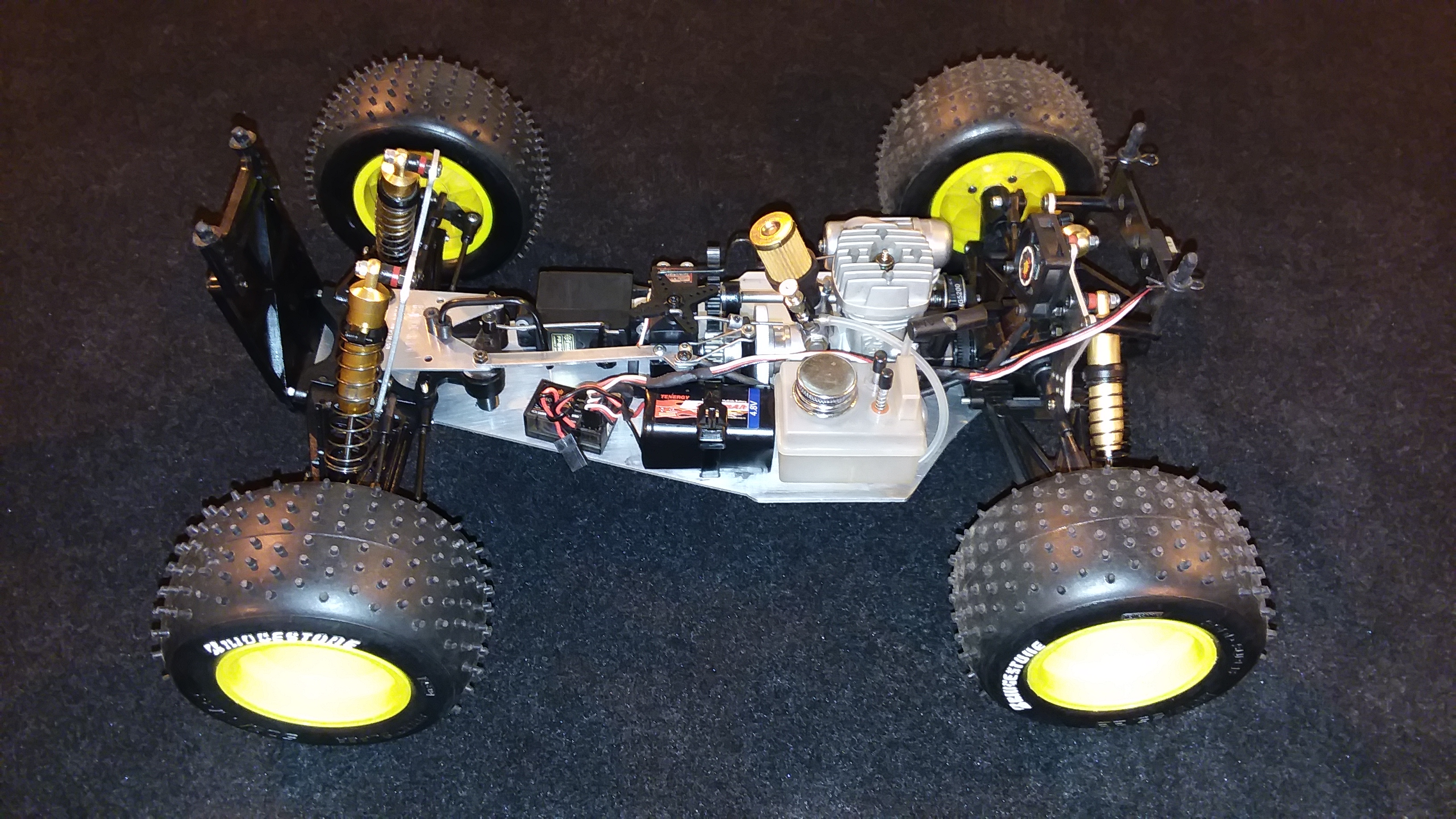

Post by coxbros1 »

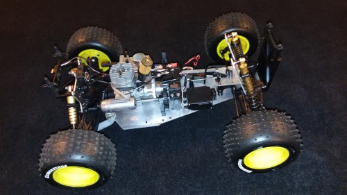

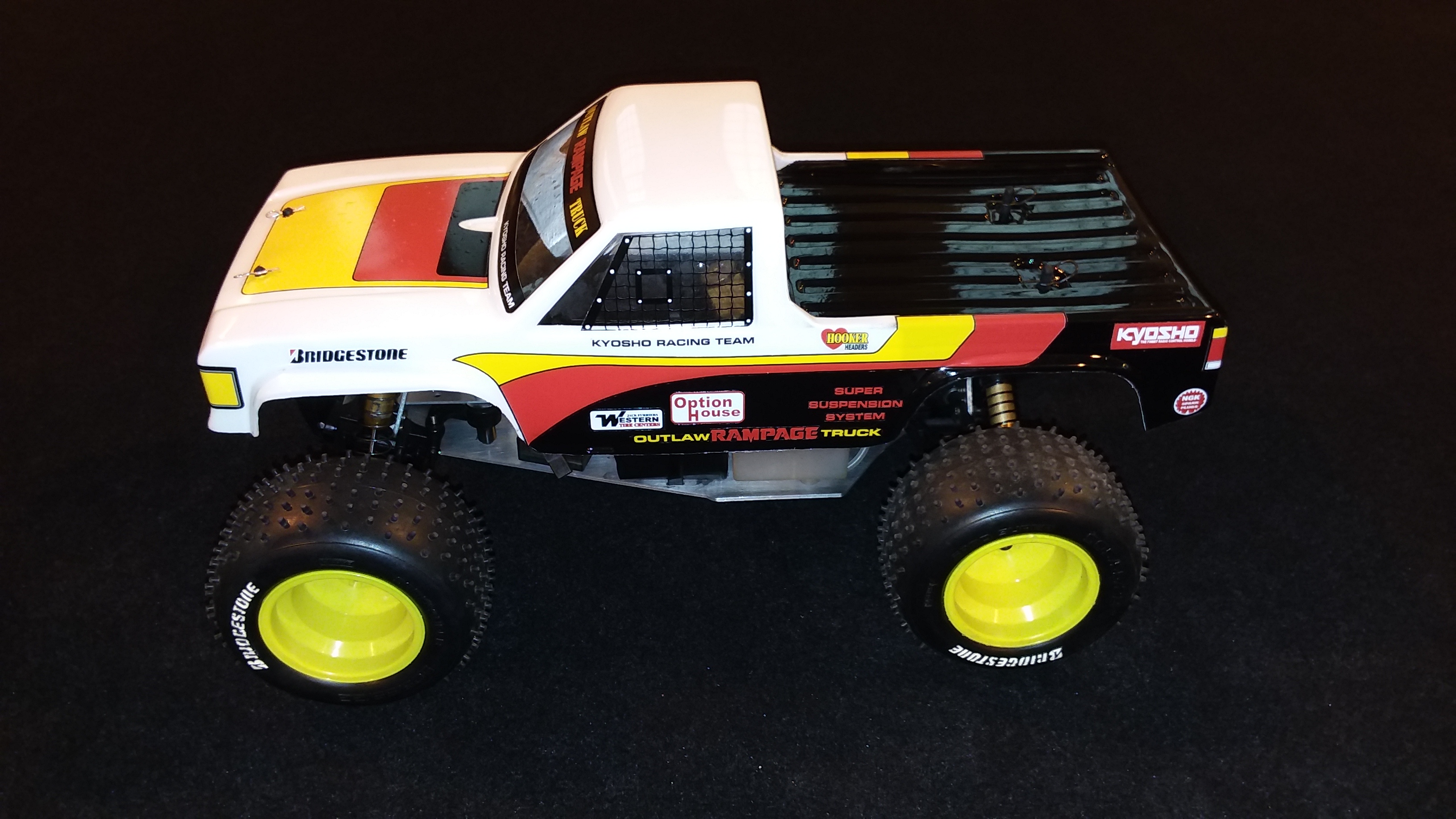

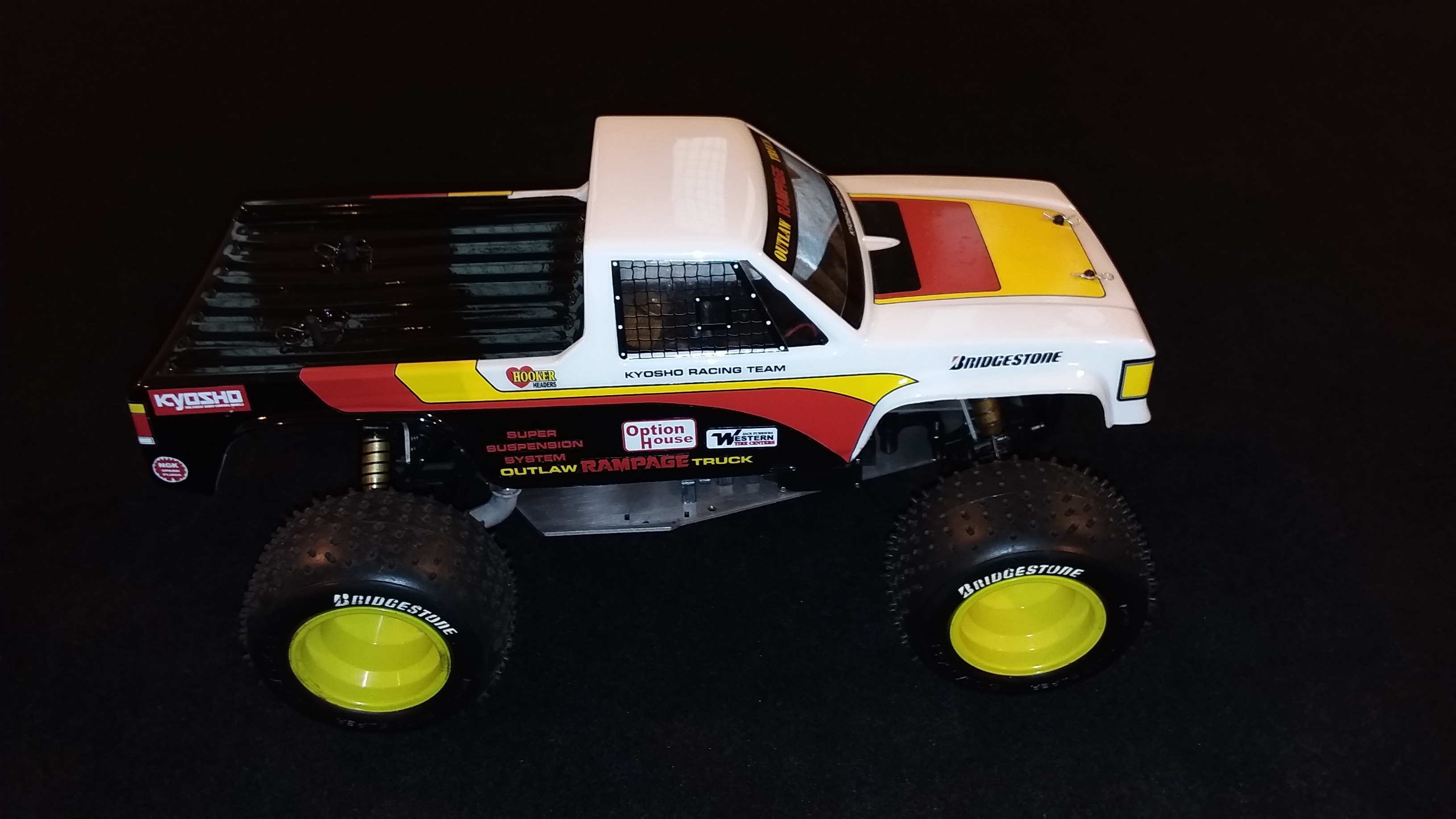

Recent restoration. Best driver i got, ask Thumbs :lol:

I always liked the look of these trucks. Looks good, well done....

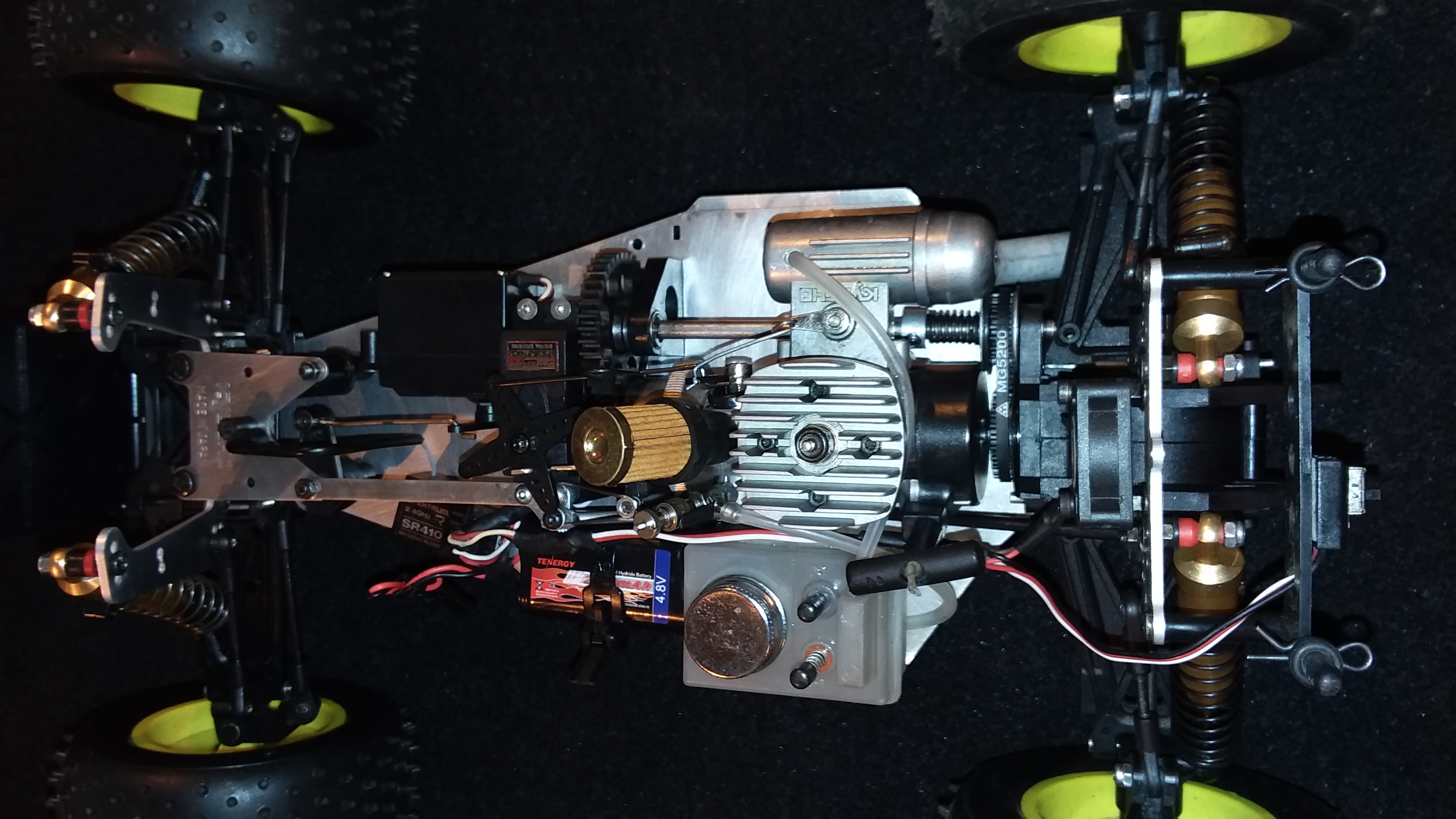

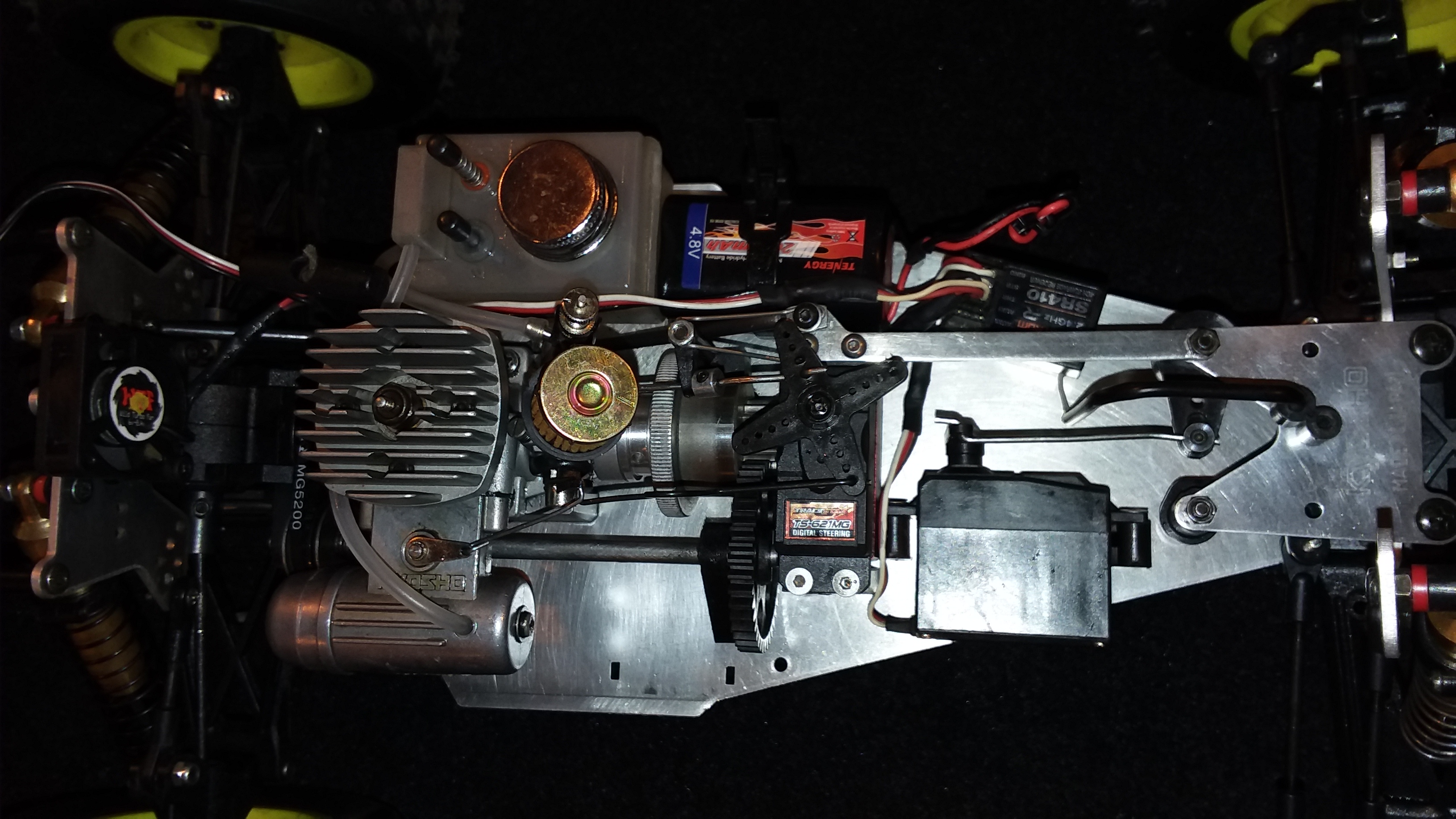

Little update.... Went to drive this today and of course the pullstart cord pulled out. I immediately yanked the motor, pulled out the crankshaft, put in a new non-pull start crank and backplate I had left over from a cz-r on my Assault build. Put it back in, fired it up on my 1/8th starter box. Warmed it up and hit the streets, and man what a difference. If anyone has seen the contraption that grabs that crank for the pullstart and what it weighs! The truck literally has 2x the power it had, it was ridiculous the difference. What a ripper!

^ That is surprising to hear. I didn't know the pullstart made such a difference. Good thing the cord broke, lol.

Yup, pullstarts really drag em down, plus good place for an air leak.

I remember similar power gains on my Nitro Hawk Image .12 back in the day. When I removed the pull start and one-way and replaced with a heat sink back plate, it had very noticeable improvement in acceleration.

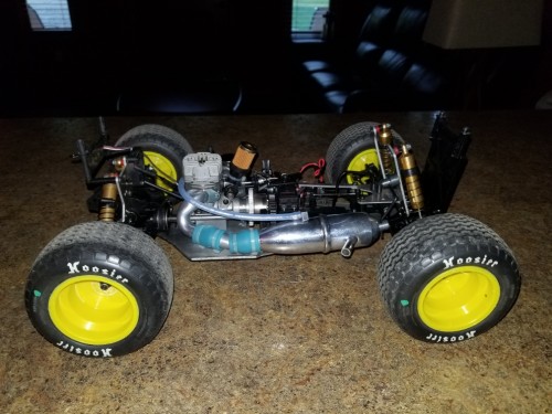

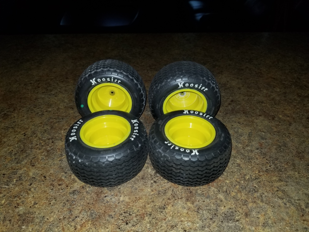

Got some new shoes snd restored these old wheels, lookn to do some speed runs soon

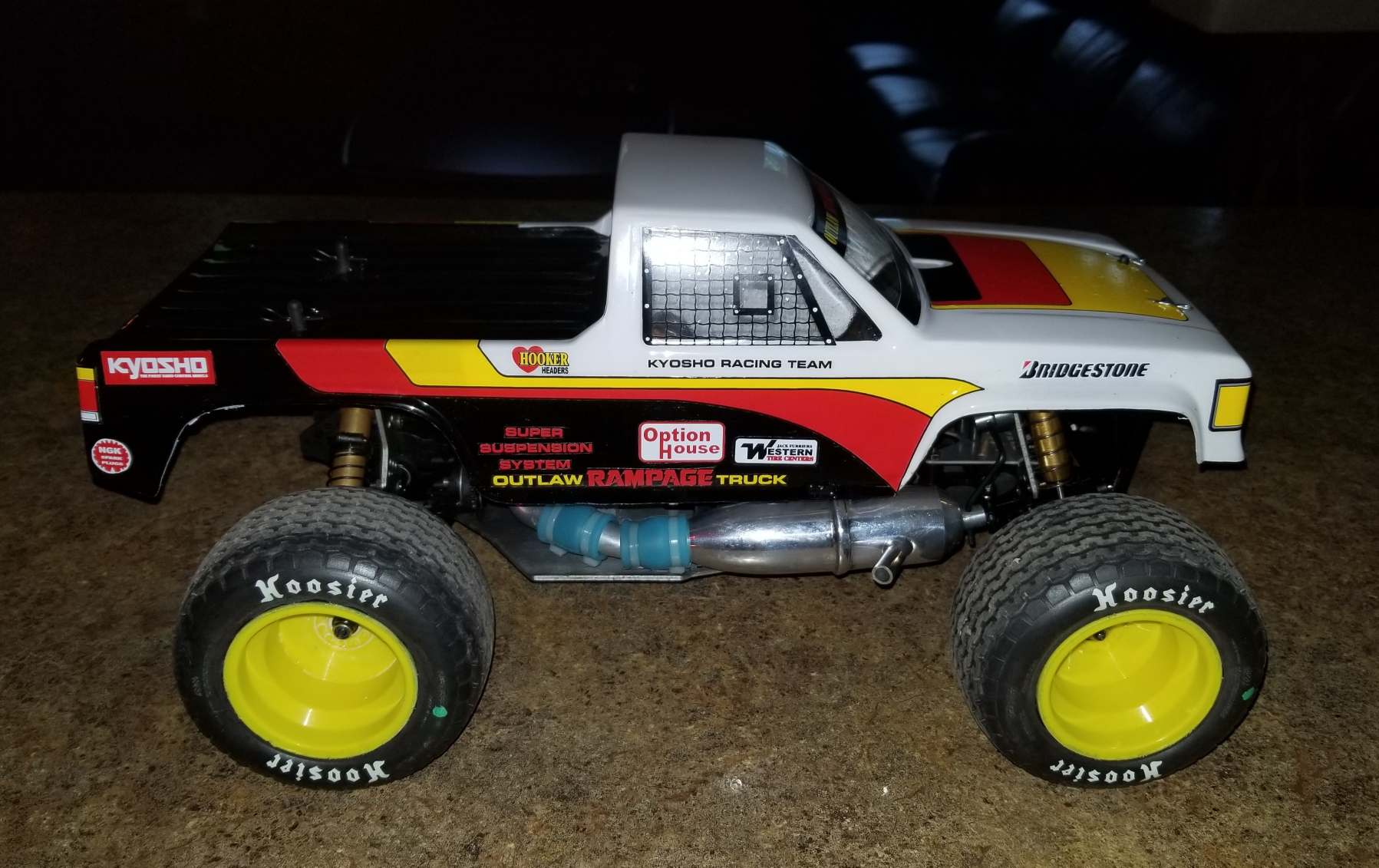

Got the pipe fitted, reversed pulleys on belt drive for taller ratio....hopin for 50mph. Raining now

who does those tyres? Links please :wink:
If it's Old Skool, It's Kool
coxbros1
Posts: 2463
Location: Energy, Illinois
Has thanked: 2681 times
Been thanked: 2339 times
Re: The Ultimate Driver "Kyosho Outlaw Rampage Truck"
Post by coxbros1 »
mtbkym01 wrote: Wed Apr 29, 2020 2:05 am who does those tyres? Links please :wink:
https://www.horizonhobby.com/hoosier-super-chain-link-t-22-m3-truck-tires--f-r-p-pro828002
