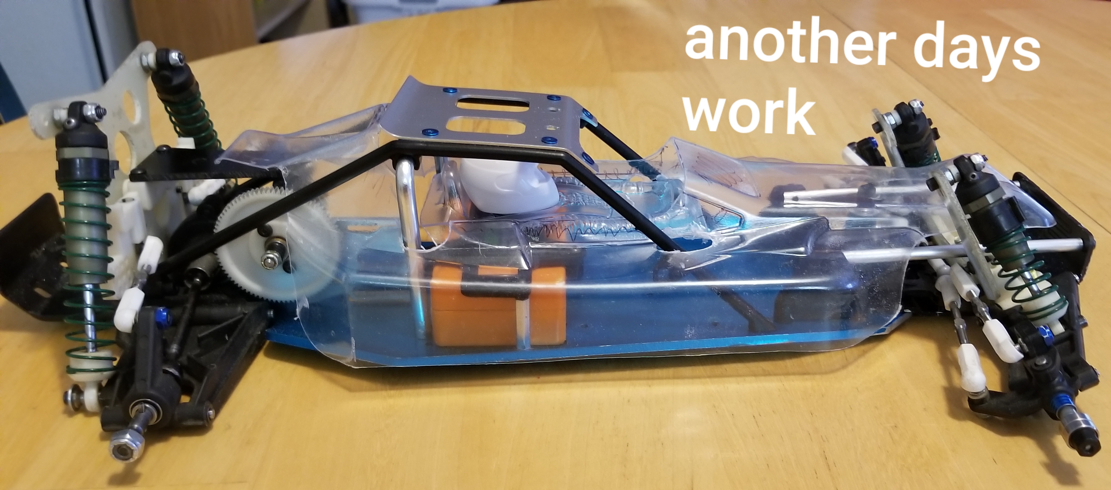

Finally got around to the RC10 Mid 2.0 with blue chassis instead of tub! Still waiting on the Kyosho Ultima rere.
Associated GT RTR chassis/trans
Associated RC10 Team Car suspension
Associated RC10 B6.1 battery holder
Kyosho ZX-5 lexan
Kyosho Turbo Scorpion roll cage
Kyosho Optima driver figure
Going to add B4 top shaft and fancy slipper, and diff rebuild.
Ironman Ivan Stewart paint
Kyosho ZX-5 lexan

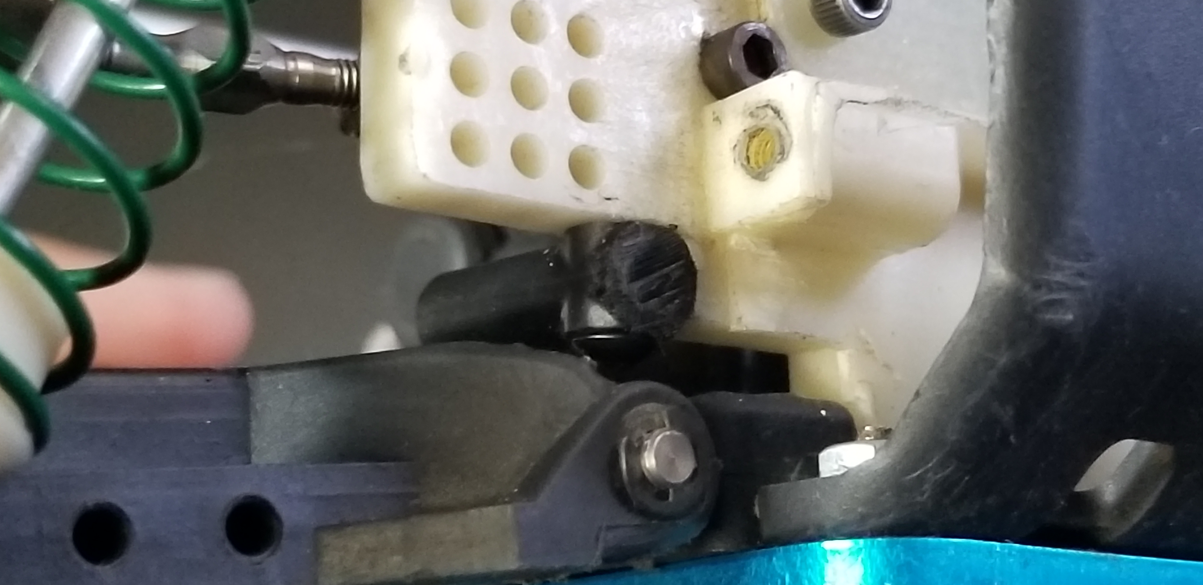

The close up of the rear tower is to show the way I mounted a section of the Kyosho roll cage so the the cage could clip on.
The RPM ball cup have been replaced with Dubro. I like how they mount with screws instead of ball cups.
The roll bar is stock Kyosho Turbo Scorpion.
It is easy to make nose tubes with aluminum stock.
I want to put a B4/5/6 fancy slipper on as well as a maintenance session on the diff before going out racing with it.
I might play around with the rear shock mounting to get a good lean back on the shock.
Paint needs to happen.

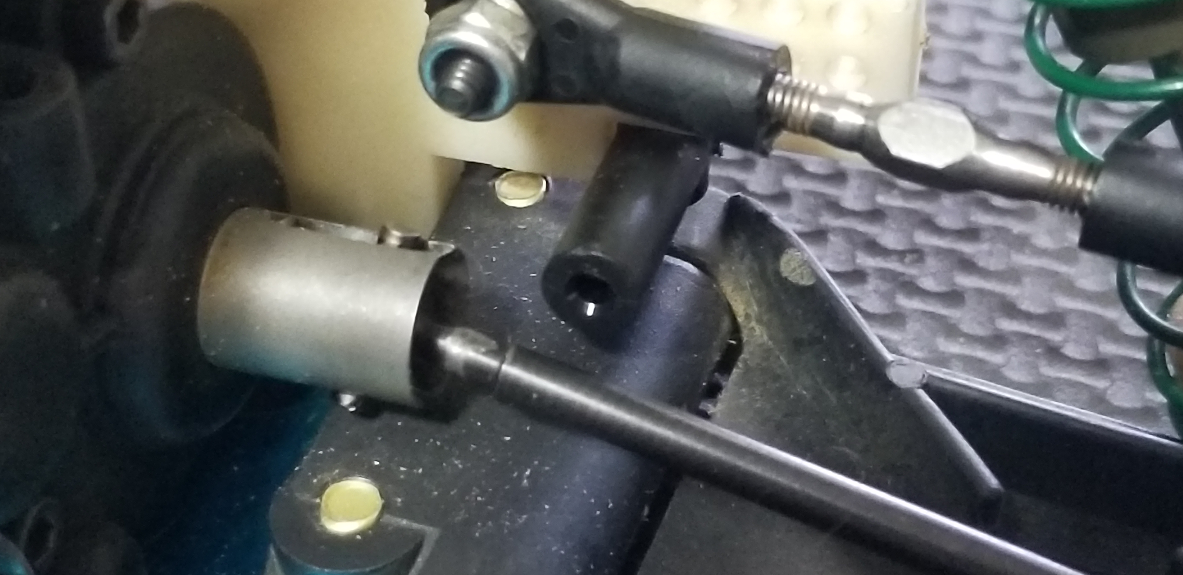

If you rotate the steering servo by 90 degrees, and Tuesday a shorter tie rod you can move the servo further forward to generate some space. I assume that is a low profile servo

I haven't decided how to mount the servo and the steering rack too.
It is low profile so I have more flexibility.
