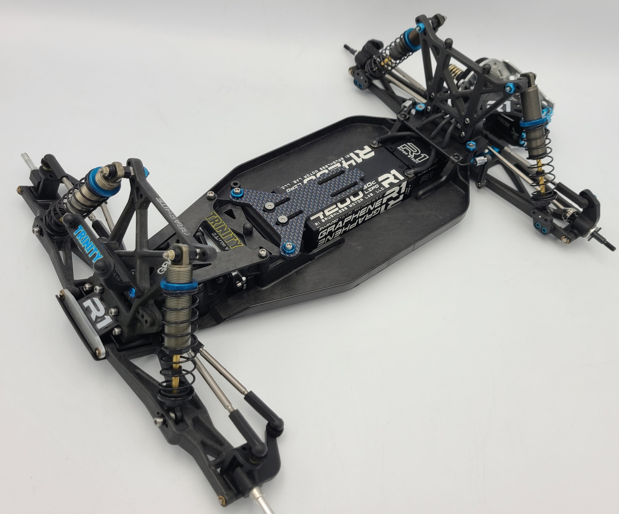

I am in the middle of a full rebuild on this truck. I'm not entirely sure why I am redoing it, but I just thought it would be fun to take this build to the next level.
The Lunsford tie rods are being swapped for these lovely Tecnacraft units. The MIP steering is replacing the stock setup. The MIP bearings are more than twice the size of stock. It also gets rid of the servo saver. This is better suited to modern servos.
I modified the rear tower similar to what I did on my XX Kinwald build. This one was much more difficult though. The reason for this modification will be clear soon. I also removed the outermost holes on both towers.

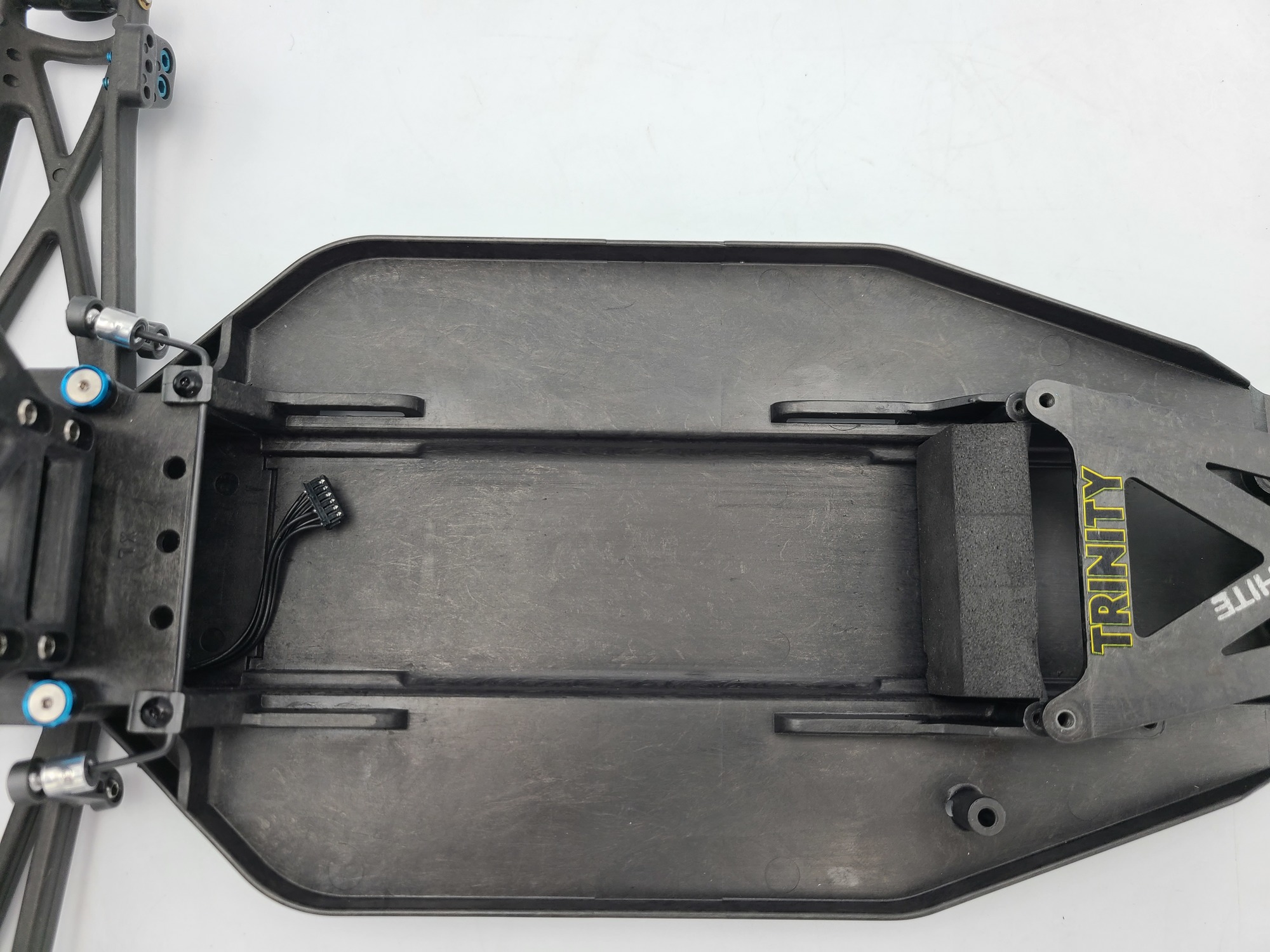

I want this truck to have a very clean and minimal electronics layout as well as being very functional. I carefully cut the sides of the battery tray on the chassis so that a modem lipo battery sits flat. I don't have a lathe so I had to do this by hand. It was hard to do without messing up. I also wanted it to look as factory as I could. It took very careful hand dremeling but the result came out well. Now the battery sits as low as possible. I also cut the rails to the length of a shorty battery, so that the battery is prevented from sliding fore or aft.

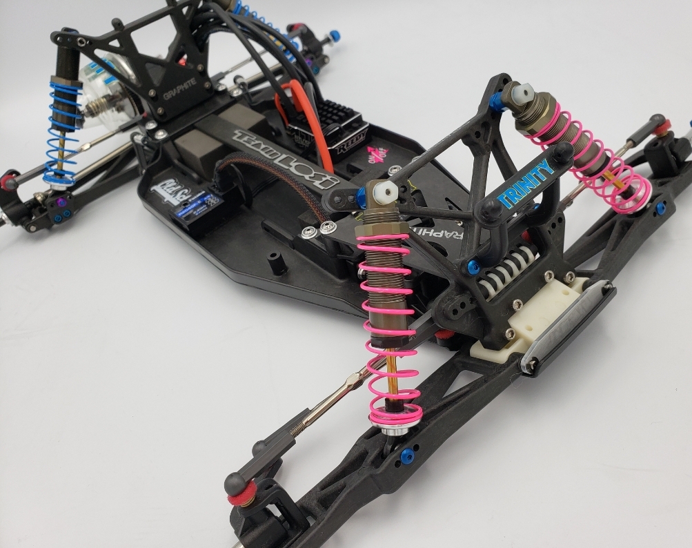

I am mounting the esc at the lowest point in the chassis. I drilled to allow the motor leads to come directly up and then pass through the cut out rear tower. This esc placement should look very clean, and also allow for the lowest center of gravity, shortest leads, and let's me hide the capacitor out of sight.
I was originally going to use my Tekin RSX controller, but this new R1 Wurks Digital 3 unit fits better. If I had known I was using it prior to cutting the 3 motor lead holes, I would have done them differently. Oh well!
The receiver will be hidden from sight once mounted. The motor sensor wire is run out of sight and enters from the back under side. I am very happy with how it turned out.

I'd thought about doing this (trimming the chassis to get the battery to sit flush) But was always a bit worried about the thickness of material & whether I'd break through! The idea of setting a dermal onto an original Graphite STD length chassis in good condition somewhat scared me lol! :D

^ Thanks! You don't need to remove any material going down to the bottom of the chassis, just remove the little lip that runs the length of the tunnel on both sides. This is a XL Graphite chassis and it was hard to make myself cut it. However it's not brand new. I did make a small gouge when drilling the hole for the servo lead, but it's completely covered once assembled.

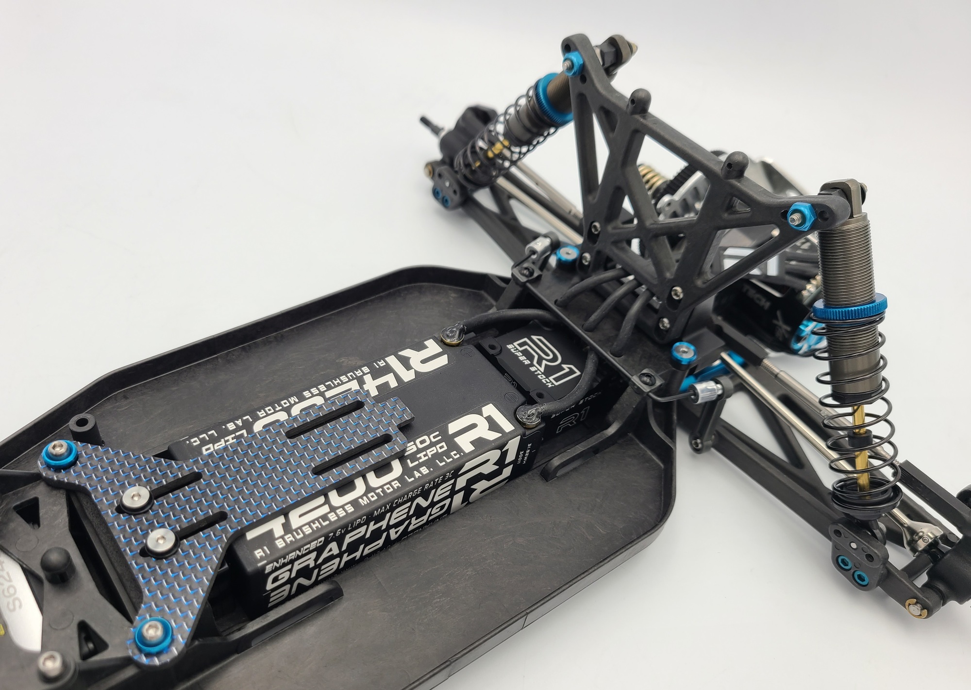

This thing is close to done. I spent a lot of time to make sure all parts fit and interacted just right. This is truly built to be a runner. The battery is very secure. I ended up using a CF brace I had laying around. It has blue inserted in the carbon strands and it matches the Trinity blue very well. Happy accident.
I put on black springs for now, but may change back to blue /pink later. I upgraded the servo while I was at it. All suspension movements are free but without slop. I spent long time getting all these little details just right.
I'm excited to paint a body and run it!
