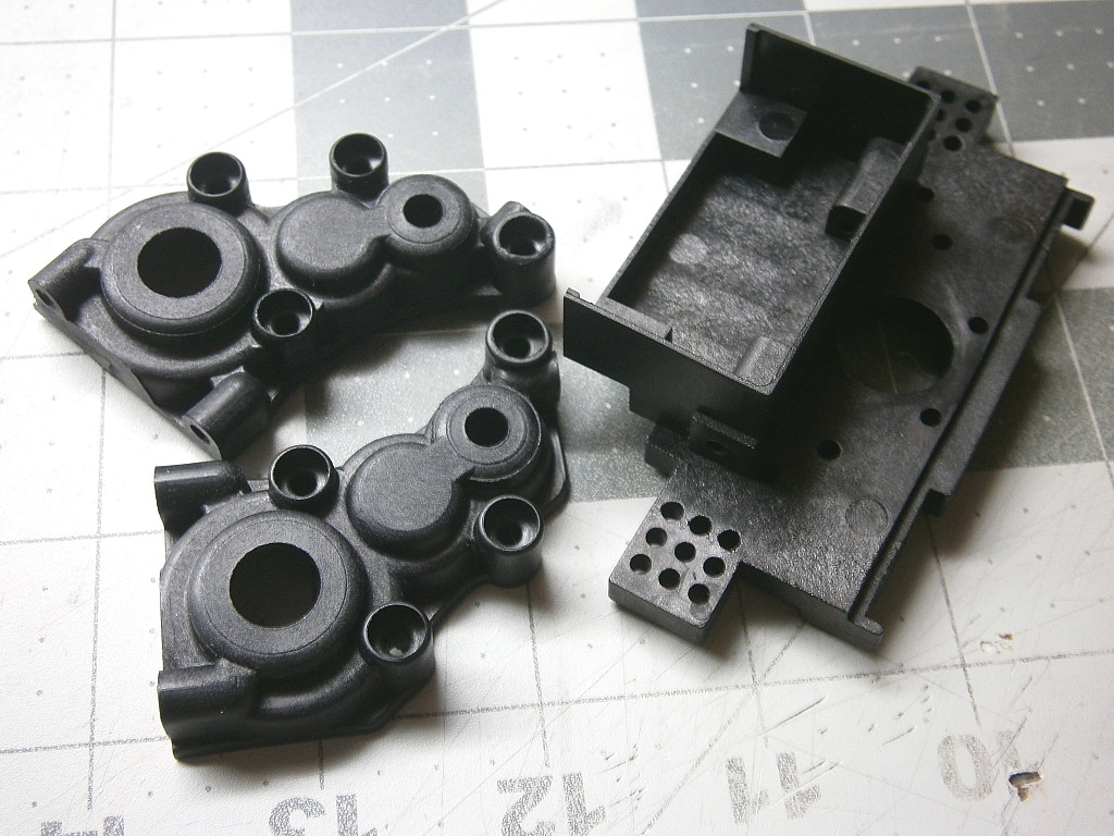

Dyed the rear bulkhead and the trans cases with rit dyemore graphite this morning, came out nice.

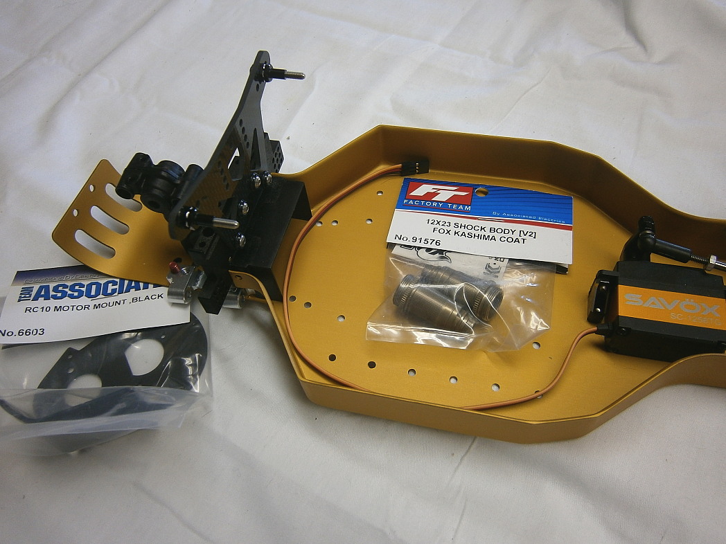

I installed the Factory Works rear arm mount, dyed bulk head, and DHAWK aluminum rear arm mounts. I was out of black 8-32 screws so used red ones for now. Trans. is ready to be assembled as soon as I machine some spacers for it!

Looks great so far Nomad. Be careful of that dye as it can sometimes stain adjacent parts. I will often make packing tape gaskets to prevent dyed parts from staining other nylon, G10, or anno'd parts. Whatever that dye touches, it will be stained forever.

Thanks for the tip, Doug. I've always rinsed the dyed parts with cold water after dyeing and then used Windex to clean the part. Don't know if the Windex is needed but do it anyway.

While waiting on the Diff rebuild kit, shock time!

Cool shock stand Nomad. I swear you have a tool for just about everything.
By chance are those B5 shocks?

I like tools, the cooler the better!
Yes, B5/B6 shocks, KASHIMA coated bodies with Ti Nitride coated shock shafts. Using Exotex bottom caps and top rings.
