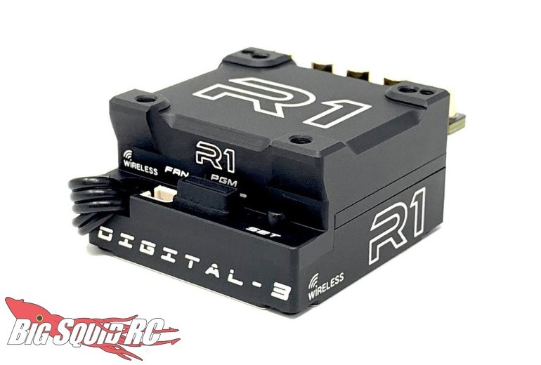

ESC melted down waiting on my new Wurks Digital 3.......................................

Update:
Received new ESC very nice unit and the WiFi thingy all I have to say is wow. Initial Set up was easy connected my phone to the ESC and my lord so many parameters it’s overwhelming, going to start off with the standard settings for now and work my way up.
Telemetry is awesome how it shows up on my phone I’ll take a snap shot for you guys. Data log 50 minute record time is a plus, it has a fan also which I just installed that you can control.
