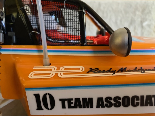

Re: My Box Art replicas of the RC10
Here is what I came up with. I machined out of nylon rod. The lower portion has raised edges to help capture the excess antenna wire.
- Limestang
