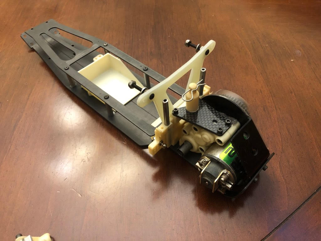

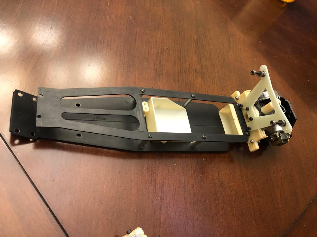

Well this is my first project in a very long time. i got lucky to win this chassis, since i missed this chassis when it came up for sale over a year ago. iam going to build it as a NIX carfor the most part. so far i got a good start just waiting on the parts from shapeways. iam going to keep the original frt bulkhead, but iam going to add the NIX frt bulkhead to this chassis. notice theirs no way to put on the battery strap??? hum.. lol

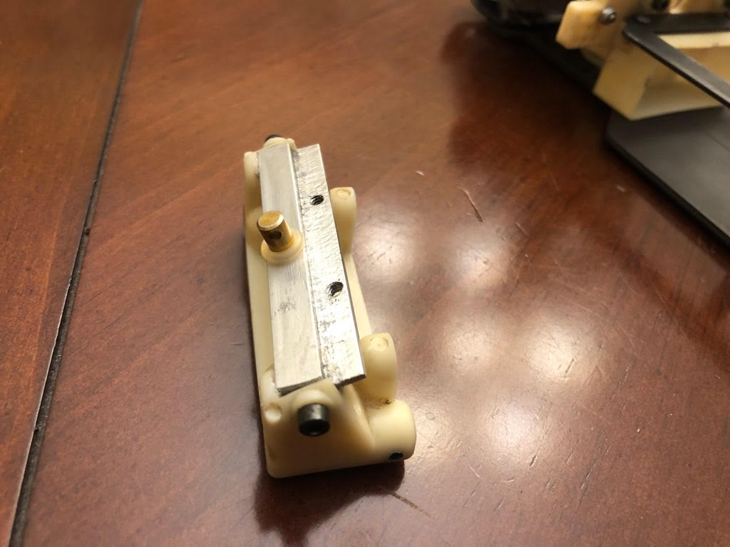

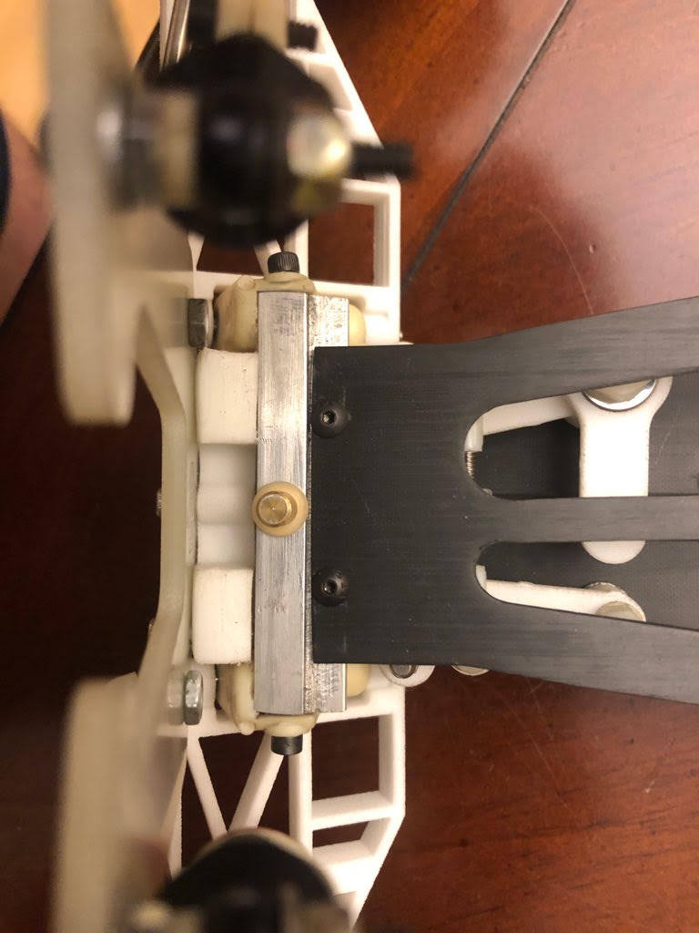

well i wanted to use the nix frt bulkhead, BUT when i got it i forgot how narrow it is compaired to this chassis lol. so i had to mill it way down and mount it with 2 screws from under the rc10t bulkhead, i think it came out great!. still waiting on some more parts.

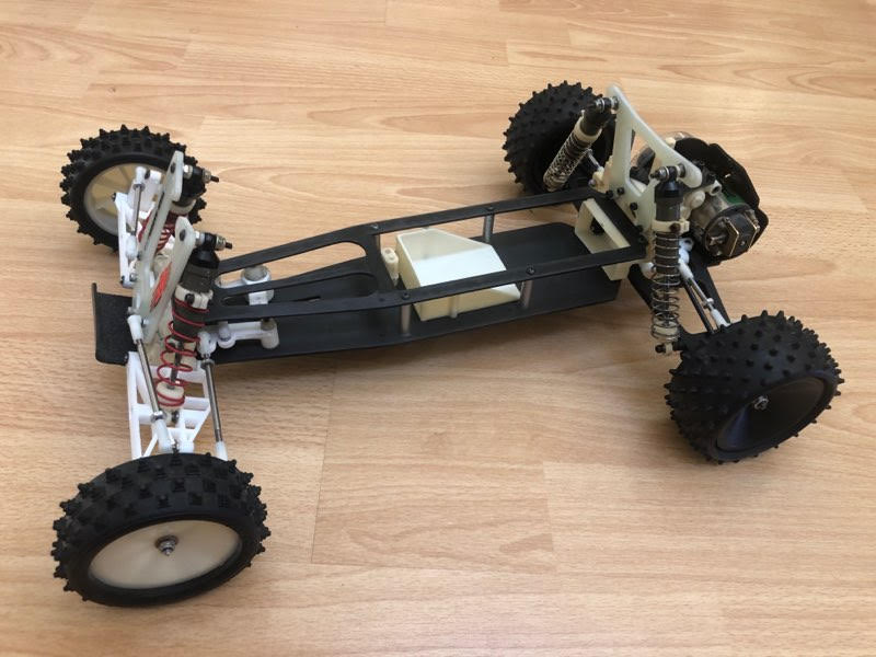

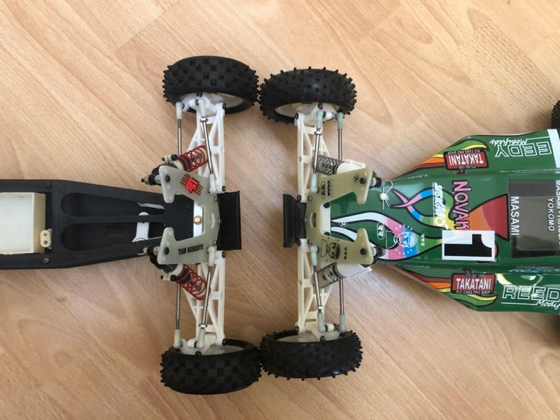

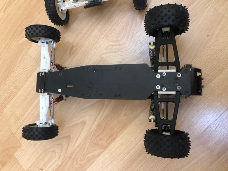

well it s all done came out pretty much how i wanted it too except for the rear arms. i used a set of rc10t tekin chassis rear arms ( just cause thats what i had and i think they look pretty cool) cause the nix91 rear arms made the rear of the car too narrow, since the frt of the car is on the wide side due to the 10t frt bulkhead.

Man that looks badass, the fronts arms are installed that way for a reason? they seem to be backwards is it to extend the wheelbase or am I off base here.
