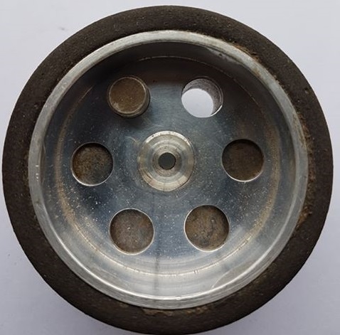

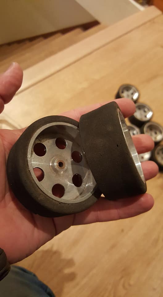

Post by dinglem »

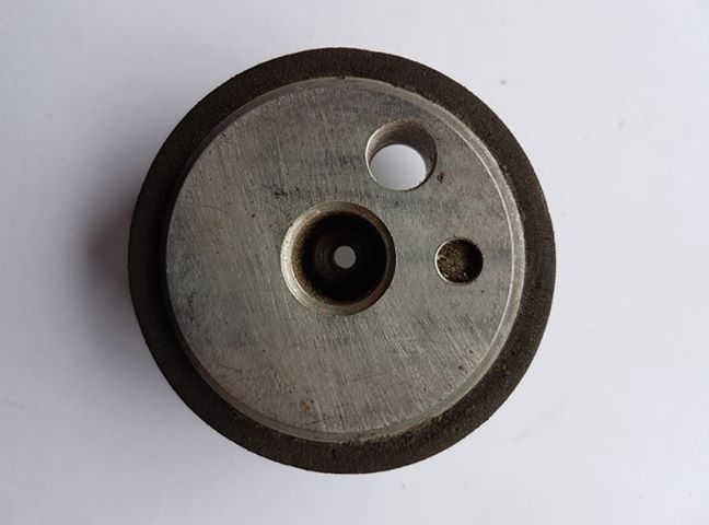

I doubt it. My father was probably dreading finding the jig for that very reason - HA!
I was really banking on these four rims showing up.... we would have only really made some rears if they hadn't.
They are lovely when fitted.... found another pic from bitd of this very car too.

How did they mount on the inside? Were they machined to fit tapered axles and the weird hexes with tapered holes, or did they use straight axles with crosspins?

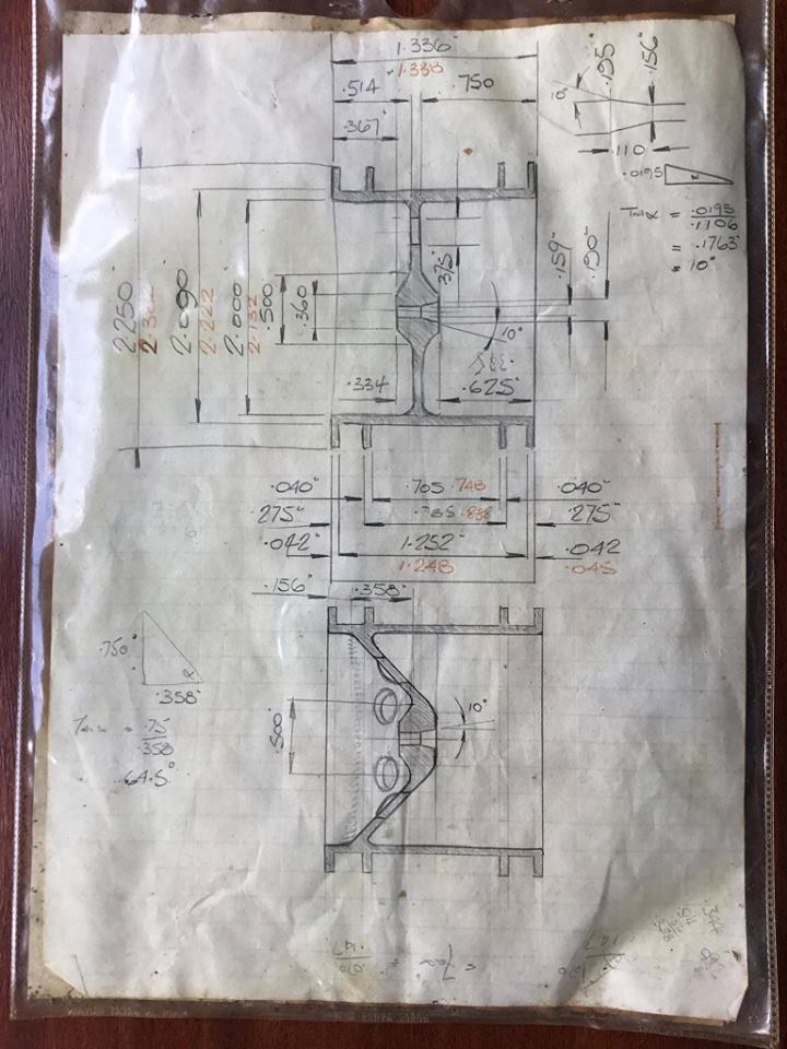

Now that I can answer.
I am very VERY chuffed to have also found the original drawings my father made before starting these very wheels. What he actually discovered were very very slight differences on each corner of the car so he actually fitted each rim to a specific corner of the car believe it or not. Once loosely made he added very slight alterations to each rim to make it a perfect fit and to eliminate any play whatsoever. They were just tightened down hard onto the taper and we never had any drive issues whatsoever.

Wow, now that's thorough! Thanks for sharing the design drawing...you gotta love that hand-drawn pre-AutoCAD stuff!

My father is very much like that with everything he does. Old school engineering and tool-making.
I am very proud to still have all of this stuff he did for me in the late 80's, although saying that my recently turned Meteor wheels also have the same style of design drawings accompanying them! :lol:
The slotmags he made for my 870c were also done this way.
I was very fortunate to have such a capable pit man, and he always re-engineered everything in the hope of gaining a slight advantage. He literally hated any play so that was his big thing to remove from all of my race cars. He is still doing the same today.

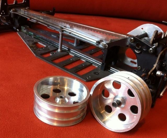

Pretty simple.

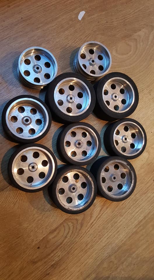

Just another quick update as i realised i had forgotten to add pics of the rest of the alloy wheels that revealed themselves when dad was moving a trailer out of the back of his garage! Nice to find another pair of narrow fronts complete with foams.

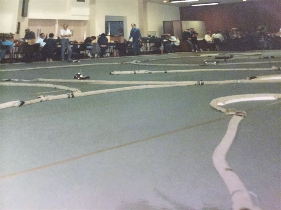

Well a couple of cool things as a bit of an update. First of all, during their imposed isolation my parents have been going through some old photographs. One is kind of cool, as it is this Mid in carpet racing mode, complete with dad's alloys running indoors at Stafford Indoor club (Thursday evenings), in around 1989. Stafford was one of the most competitive clubs at that time, and regularly had 11 or 12 heats running. Lots of great memories from that place.

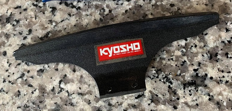

Next up, having been unable to lay my hands on the same make of Mid bumper I ran on the car back then (and my own example seems to be nowhere to be found) I have been advertising everywhere for around 3 years now....
Then BOOM! one popped up on Fb yesterday, and the guy has agreed to sell it to me. :D Something so simple, and yet I am literally thrilled.
Of course, what this actually means is my dad will no doubt stumble across our original example at some point next week... :lol:
