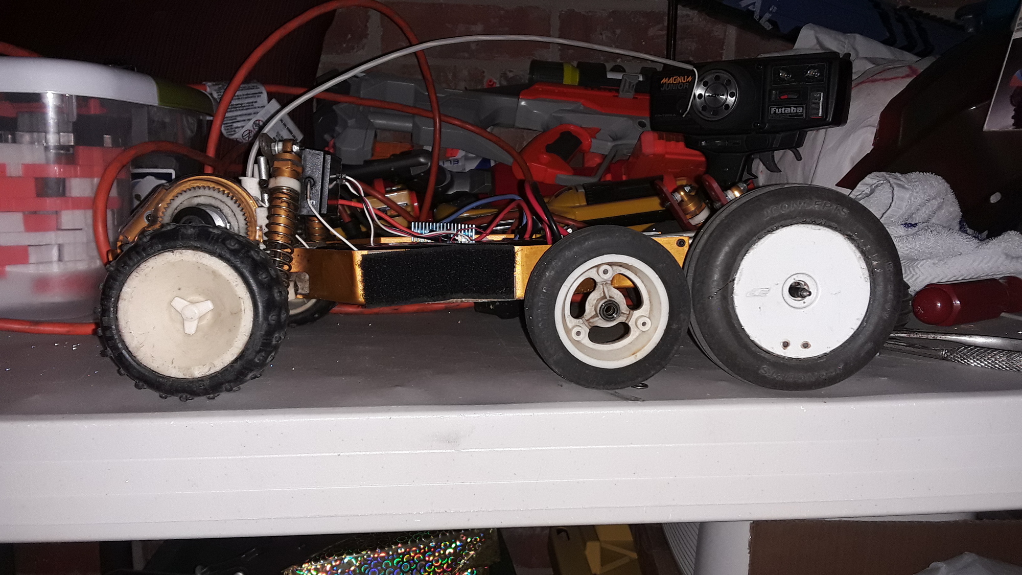

I didn't think to ask the seller the dimensions of the front wheels and tires. They're WAY bigger than the originals and bigger than the rears! :? The pic kinda sums it up. I might be able to transfer the bushings(same bore), and drop the front end all the way to make it level, but it'll still look way goofy. Back to Ebay! :roll:
I'll still leave positive feedback since it's my fault, but now I know! ASK BEFORE YOU BUY! 8)
The rears fit great! Can't wait to thrash 'em!

Those look like standard truck tires. What did the listing say?

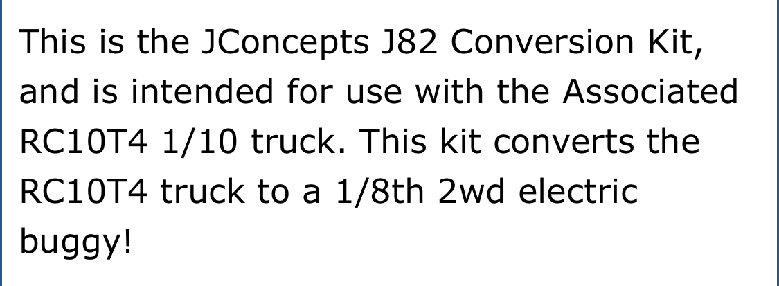

It was listed as Rc10 wheels and tires.
The description said: "This auction is for a set of 2 wheels and tires for an RC10 J82 conversion from JConcepts. Please feel free to ask any questions about this auction. Buyer to pay shipping."
That bit about the J82 conversion must be important, right? :oops:

Yeah the j82 part was important haha. It was a 1/8 scale buggy conversion for a truck.
