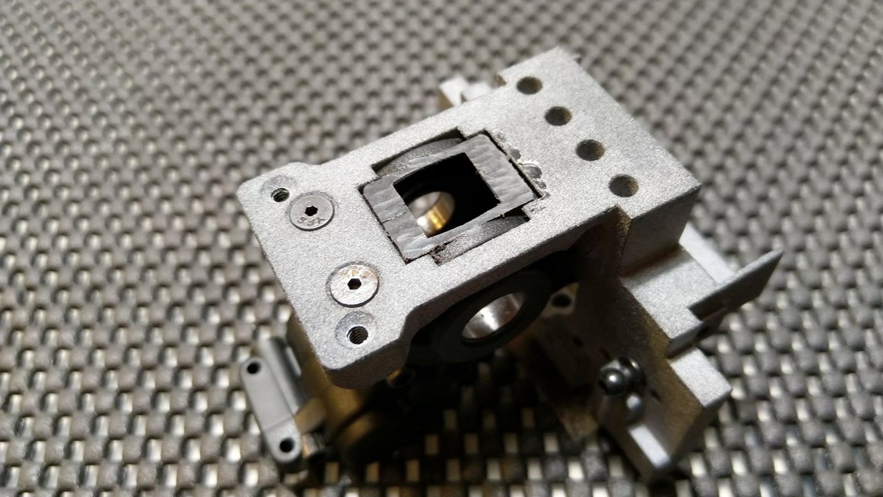

Hello All,
By replacing RC10 stock bulkhead with NIX63231 bulkhead, you'll be able to mount RC10B4 transmission to your RC10 tub or carbon chassis. You don't even need RC10 Stealth transmission holes as this one mounts to stock bulkhead holes and rear holes of classic 6-gear transmission. There's no need to modify your chassis at all which I personally like alot and kept as a guide for this design. You only need to cut away the lower section of the B4 transmission case just under the diff gear. It's easy when using NIX63231 bulkhead as a guide.
What do you think? Do you see all the nice options here... :)

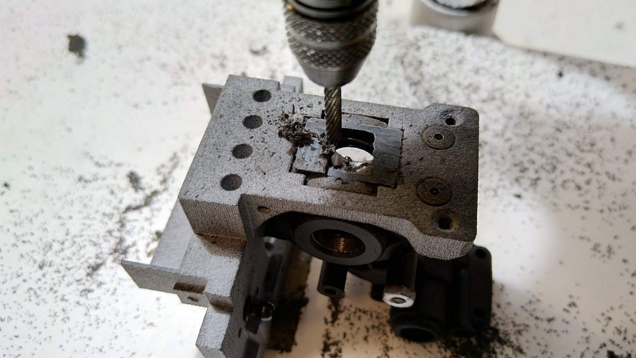

With the first bulkhead (white SLS + ASC9574 case) I removed the lower section of transmission with a Dremel sanding drum. Easy. With the second bulkhead (grey MJF + ASC9826 case) I tried a flat head cutter. Even easier. TomiS will get the SLS bulkhead to his car and I will upgrade mine with the MJF bulkhead. This plan fits in well with the fact that some RC10 Stealth transmission parts seems to be hard to find these days...

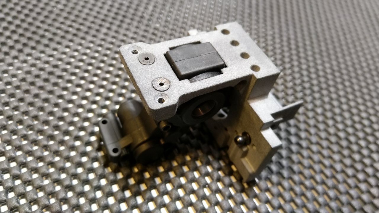

NIX63231 + B4.x gearbox + B6 gear diff.
If needed, you can easily shim the gearbox up to get diff gear just above chassis. Or make a small groove to chassis.

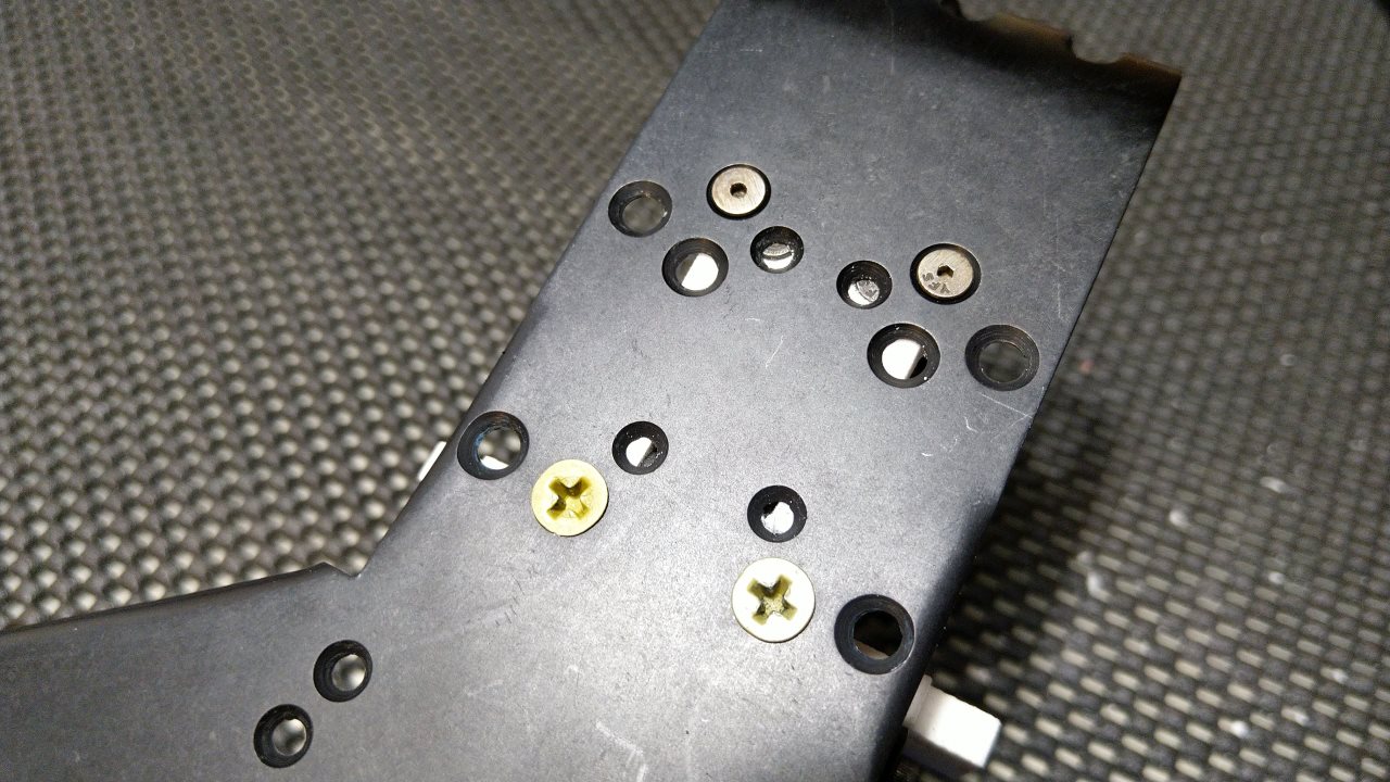

I finally managed to strip down my Graphite and mount b4.1 transmission with Niki’s bulkhead. Previously I had it mounted with only two screws at the bottom and wing mounts so now it’s much more secure with two more screws. As I have already modified the chassis I didn’t have to remove any material from the lower section of the transmission case. It sits right on the chassis without any spacers. I’m using b4.1 gear diff but may have to go for b6 diff eventually as outdrives are quite worn out. The car handles very well on astroturf and no need to worry about burning the ball diff.
