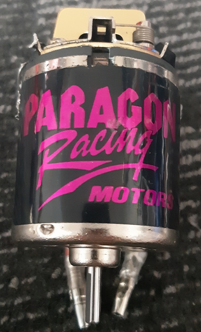

Any help with identifying this Paragon motor?
Stock? Modified? Turn? Wind?
Any links to past history available?
Thanks..

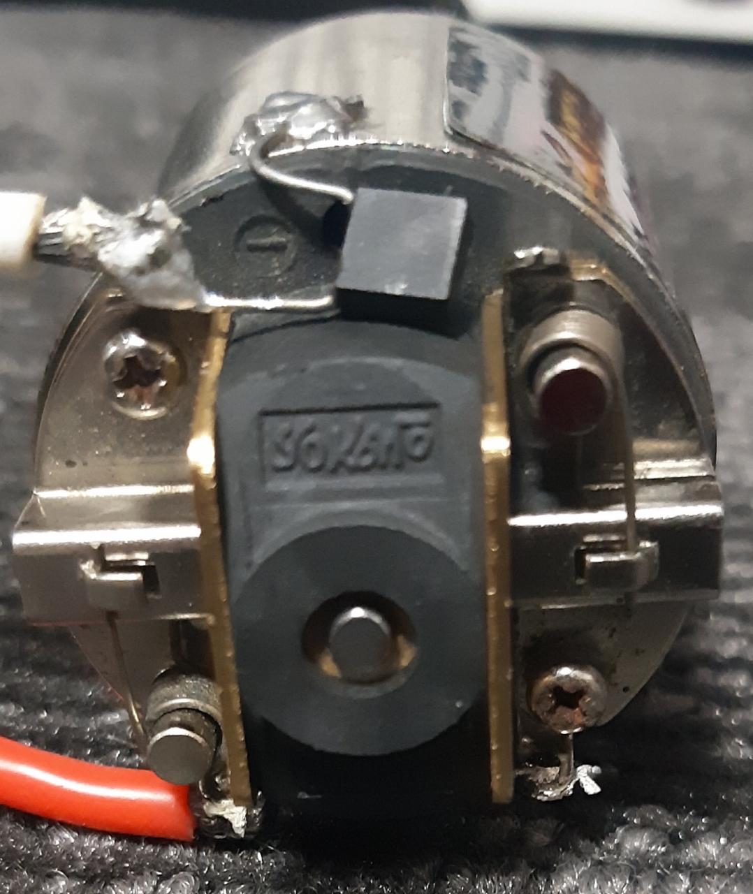

I wonder how it runs wired up like that?
I would say it's a 24 degree 27 turn stock motor having fixed timing and bushings.

Re: Paragon Racing Motor Identity
You mean the + and - wires?
That's how I received it but you mean they both should be on the same end?
Yeah, the way it's currently wired up would be a dead short.
It doesn’t matter as long as they are on opposite sides of the endbell (and the polarity is correct)
Awesome, looks like I've got some soldering to do..
Also found this after my first post, seems Paragon only did one Stock motor and this is it..
Thanks again..
