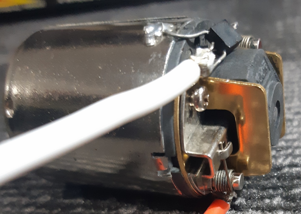

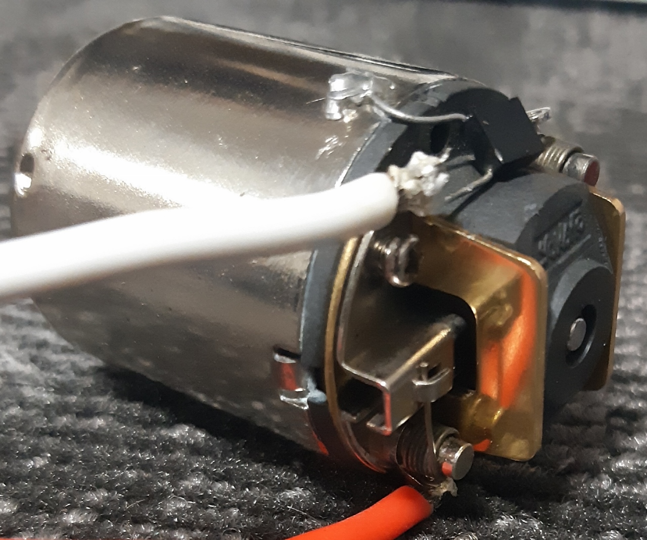

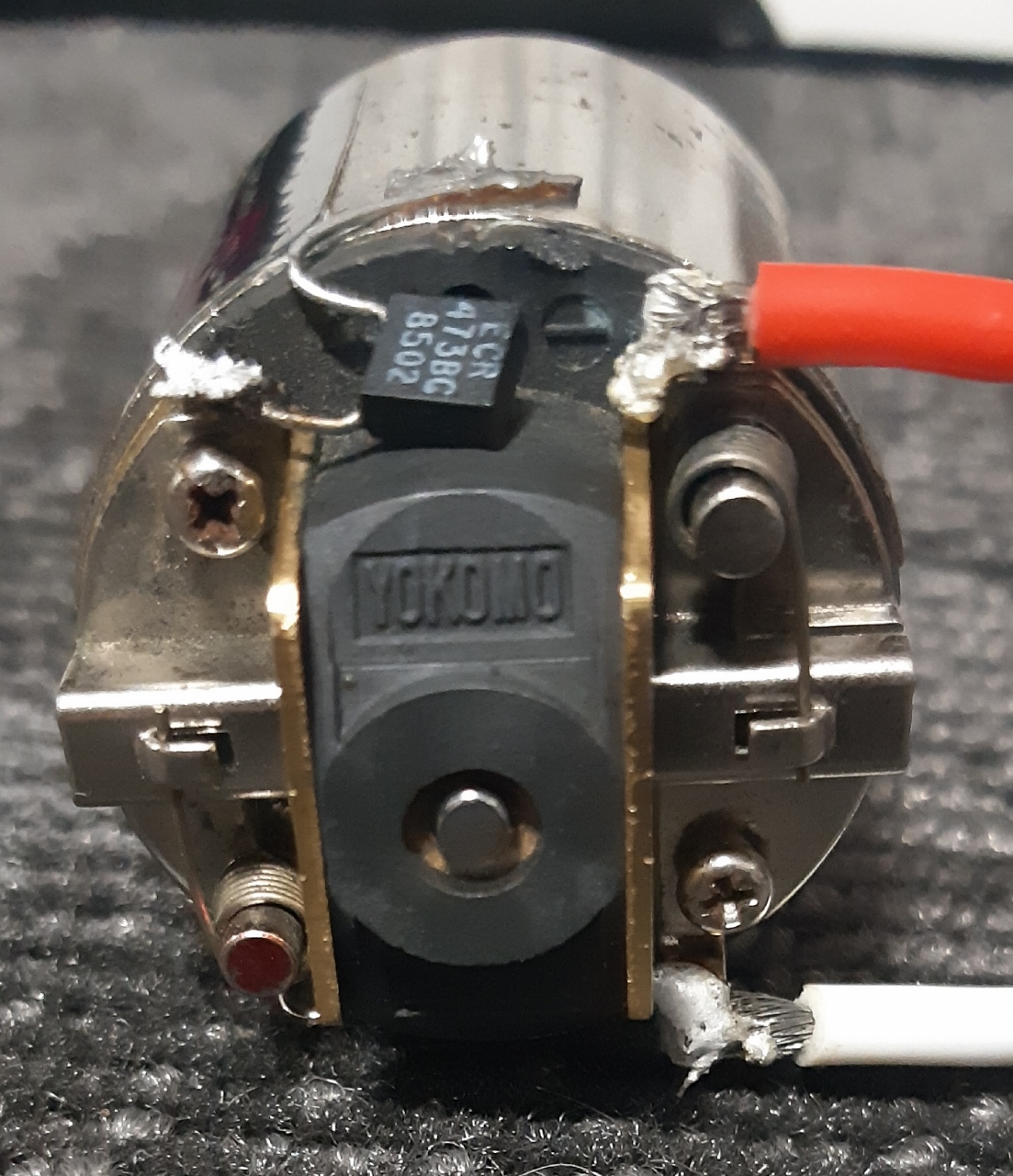

Hi all,
Any help with identifying this Paragon motor?
Stock? Modified? Turn? Wind?
Any links to past history available?
Thanks..

Re: Paragon Racing Motor Identity
I wonder how it runs wired up like that?
I would say it's a 24 degree 27 turn stock motor having fixed timing and bushings.
You mean the + and - wires?
That's how I received it but you mean they both should be on the same end?
Yeah, the way it's currently wired up would be a dead short.
It doesn’t matter as long as they are on opposite sides of the endbell (and the polarity is correct)
Awesome, looks like I've got some soldering to do..
