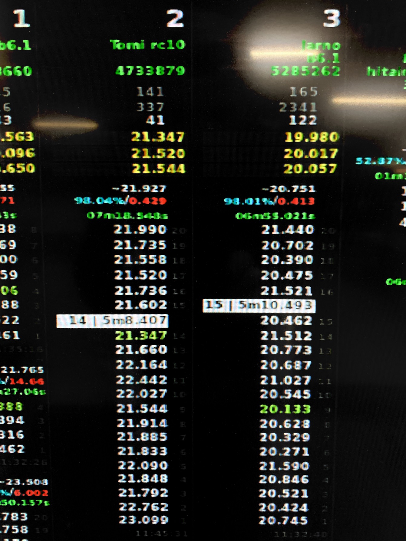

And here's some lap time comparisons with his B6.1. Not bad as this is the first time in 20 years he's been running a rear motor car and took it a bit easier than with his own car. Graphite on the left, B6.1 on the right.
