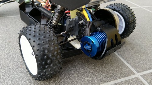

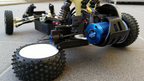

This is now my setup for astroturf:
-NIX63231 MJF-bulkhead made by i.materialise.com
-ASC9826 gearbox
-B6 Gear Diff
-CustomWorks 3241 rear hubs (It's like RPM '91 conversion hub)
-Stock rere-RC10 Worlds axles, bones and spacers.
-Stock rere-RC10 Worlds arms and inner mounts
-Stock rere-RC10 Worlds rear shocks with just 1 shim inside the shock.
-ASC9826 gearbox
-B6 Gear Diff

Re: RC10 with gear diff
Setup is now pretty much perfect, only thing I would like to improve a little is on power steering, or the lack of it. I seem to be overly cautious with the car as I don't want to break it but it still is much faster than I thought it would be. And very easy and predictable to drive. Gear diff is working really well on astroturf.
I still think it’s great! Combined with Niki’s rear arm mounts, traxxas arms, and b4.2 hexes it’s a superb handling package. I have only run the car on turf but see no reason why it wouldn’t work on carpet also.
