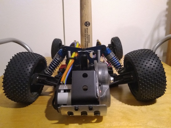

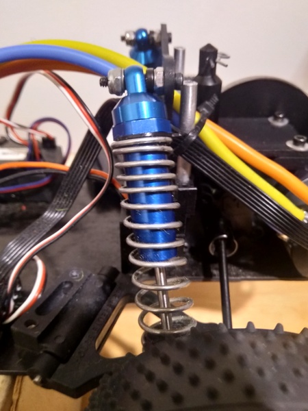

Was there ever a Houge specific shock tower made, besides the drilling instructions that were included in the arm kit (which I always thought was a bit lackin)? The first problem is that the shocks will be at an angle, and the original bushing do not allow this (unless your shock caps are worn). Now 30 years later I've found that newer #6473 bushings allow this, however you still need put the bushing other way than in the instructions. Back in the day I used soft rubber tube for bushings. Second thing is that with 1.32" shocks, the suspension is quite limited (especially if you use the Houge spring retainer), and the shocks will bottom way too early. Now after getting 1.02" shocks, I think the car is much better. The droop is the same, but now the chassis will hit the ground before shocks bottom.
It would be interesting to hear if anybody has come up with a better way of installing the rear shocks.
