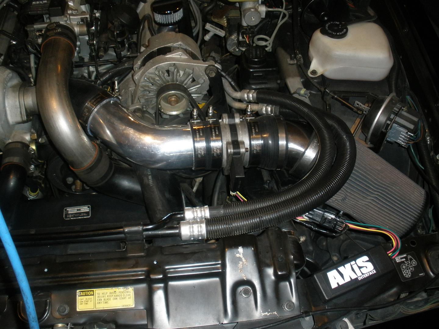

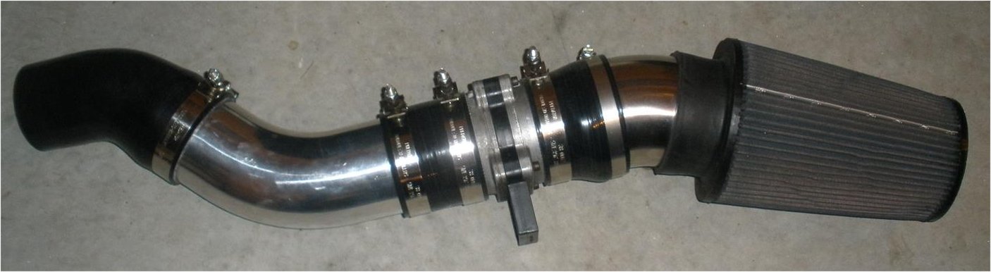

I also fabricated my own CAI for my '86 GN, making one from 3.5" tube, because all the aftermarket ones were 3", or 4"--the latter requiring a bigger turbo inlet bell, which is practically impossible to find anymore, unless you go with a bigger turbo. As long as you're able to get your car's computer to recognize the increased airflow (requires a chip programmer or, in the case of the old GN, the AXiS translator you see in the pic), you will definitely gain some horsepower.

You just brought back some serious memories, I had an 87 GN with all the goodies Ken Bell fuel regulator, high/low chip, ported manifold, ported turbo and heads, factory front mount intercooler and so on she ran 12.00 with those minimal mods but I had good money in the suspension.Coelacanth wrote: ↑Fri Feb 14, 2020 1:53 pm aFe Power claims dyno-proven gains of up to +10 horsepower, as KidAgain mentioned, at least for the Dodge Magnum 5.7L Hemi. A lot of other brands only make claims that may or may not be substantiated by actual dyno testing. I have this on my '05 Magnum and while I can't say I feel a significant difference, it sure sounds like it breathes better, and the engine bay looks much cleaner. I might even gain a few more HP when I finish doing my Danko Reproductions shaker hood this summer, which has a duct that mates directly to the top of the CAI airbox, and effectively becomes a ram air setup.
Back to the CAI, Ive been to AFE when they were working on the Dodge diesel stuff in 03 (my buddies truck was the mule) and the diesels always made SOME power with the CAI but the gas cars only made real power with the addition of a tuner and when I say real power I mean like 2-8hp..............................
