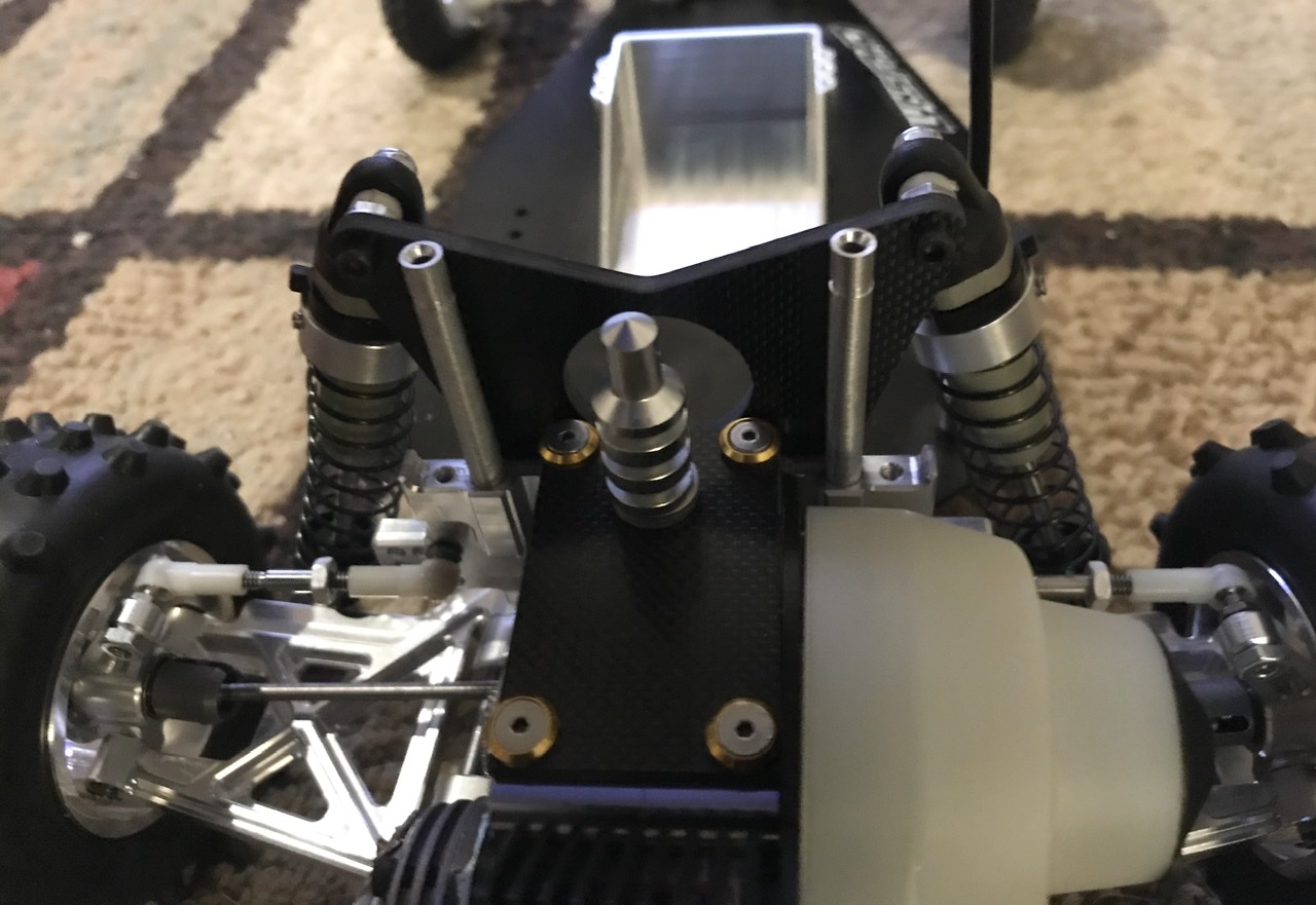

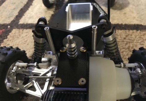

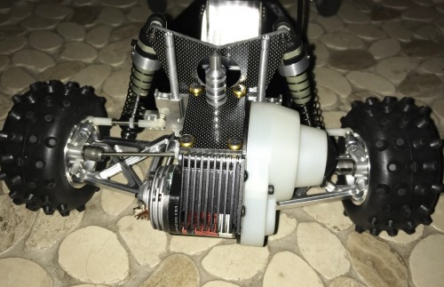

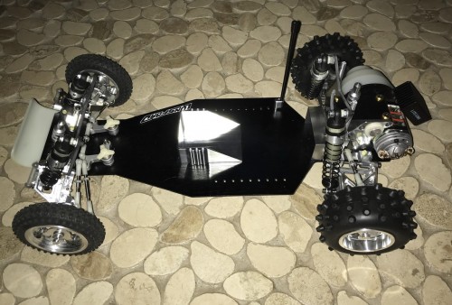

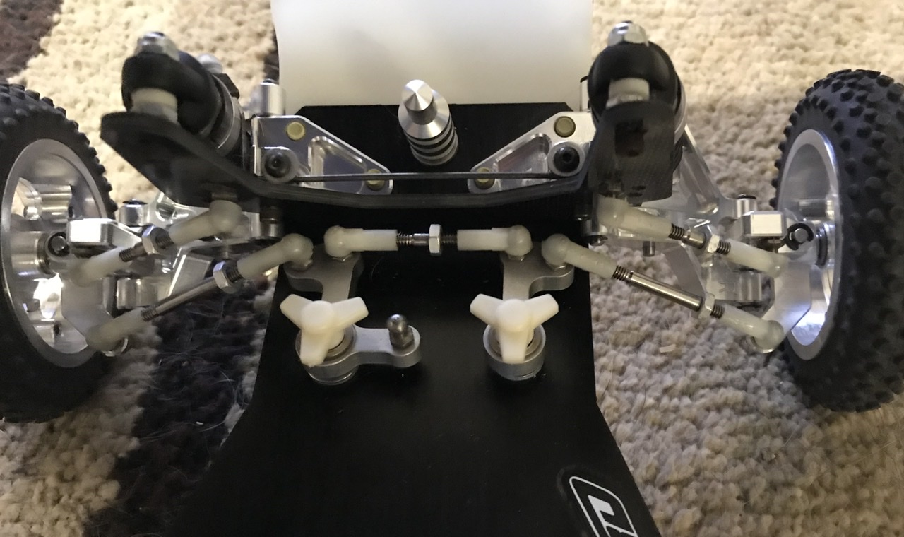

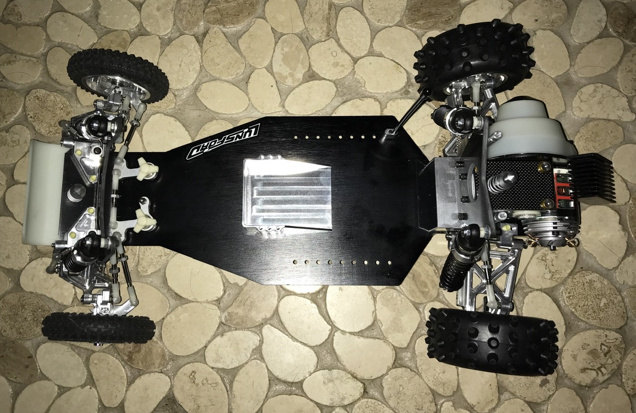

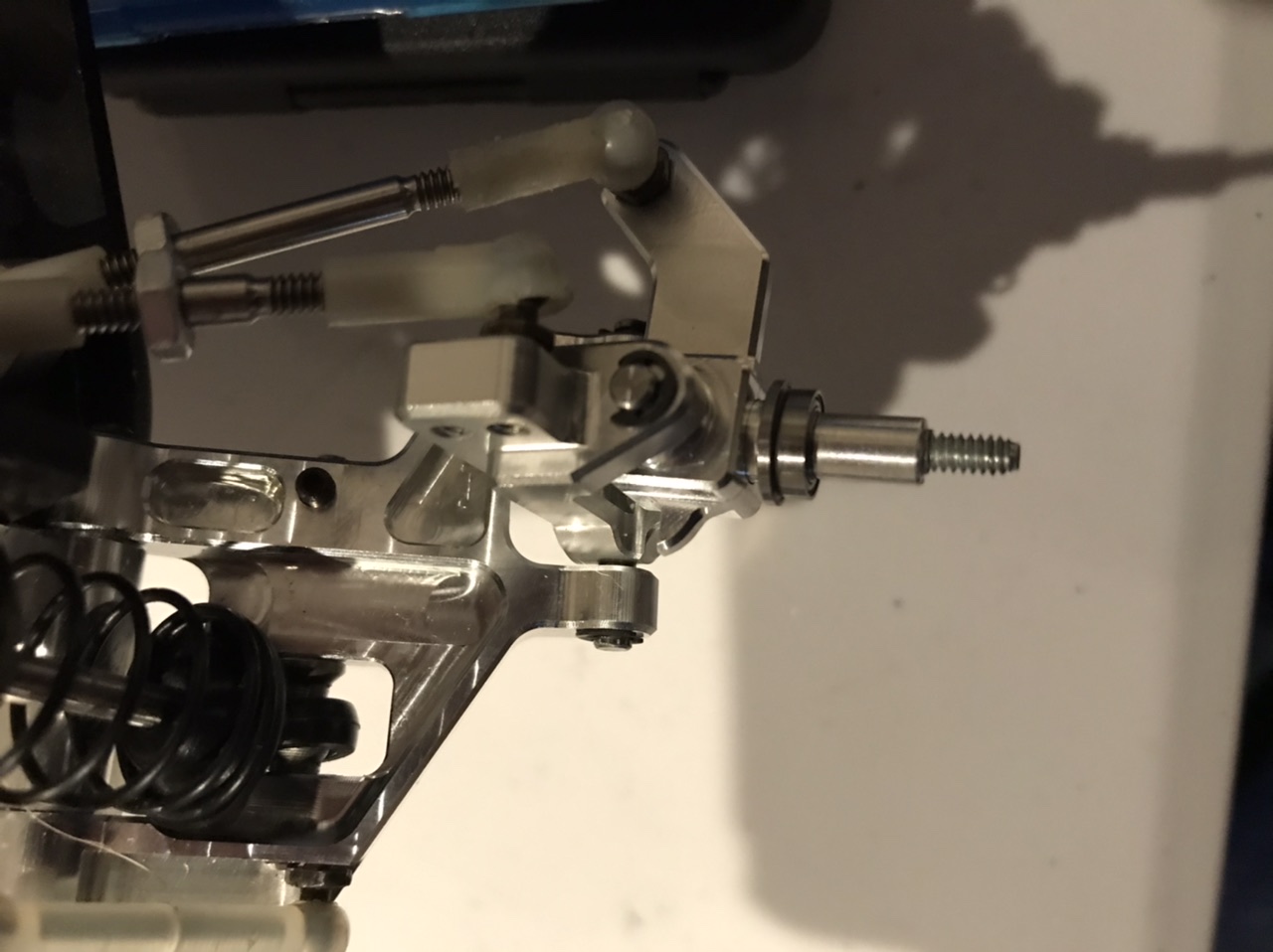

I’m sure many can relate to cabin fever due to the Covid19. I gathered a bunch of parts and built this RCovid10. Some of the parts include: Sassy chassis, Rogue wheels, Losi Bellcrank, RPM nose, RPM gear cover, alloy shock spring collars, and dhawk alloy parts.

Nice! Heavy Metal edition for sure. How do you like the Rogue jelly bean’s

The Orion motor looks good in there! Very nice overall!

I really like the rogue wheels and knock-offs. I had to convert the front axles to 4-40. I also did a few mods to the wing tubes (notch for dhawk setscrew, shortened length, machined a decorative band to match body mounts, and chamfered the wing wire holes for easier install). Also, found something to use the plastic knock-Offs for:)

The rear stub axels have me stumped. I don't remember ever seeing those before.

Thanks, glad you like it. I believe they are from an Rc10T2. For some reason Dhawk went with the newer style Axle.

As shown with the addition of an unpainted body 1lb 13oz. Dhawk parts fit pretty well. I had some issues with the hinge pins being a tight fit. I put the he hinge pin on an electric drill and essentially reamed the hole.

wow - 29oz- that is surprisingly light! - my all stock goldpan, without motor & body - with wheels, is 32oz - my sons '10, RTR, less battery, is 44oz
