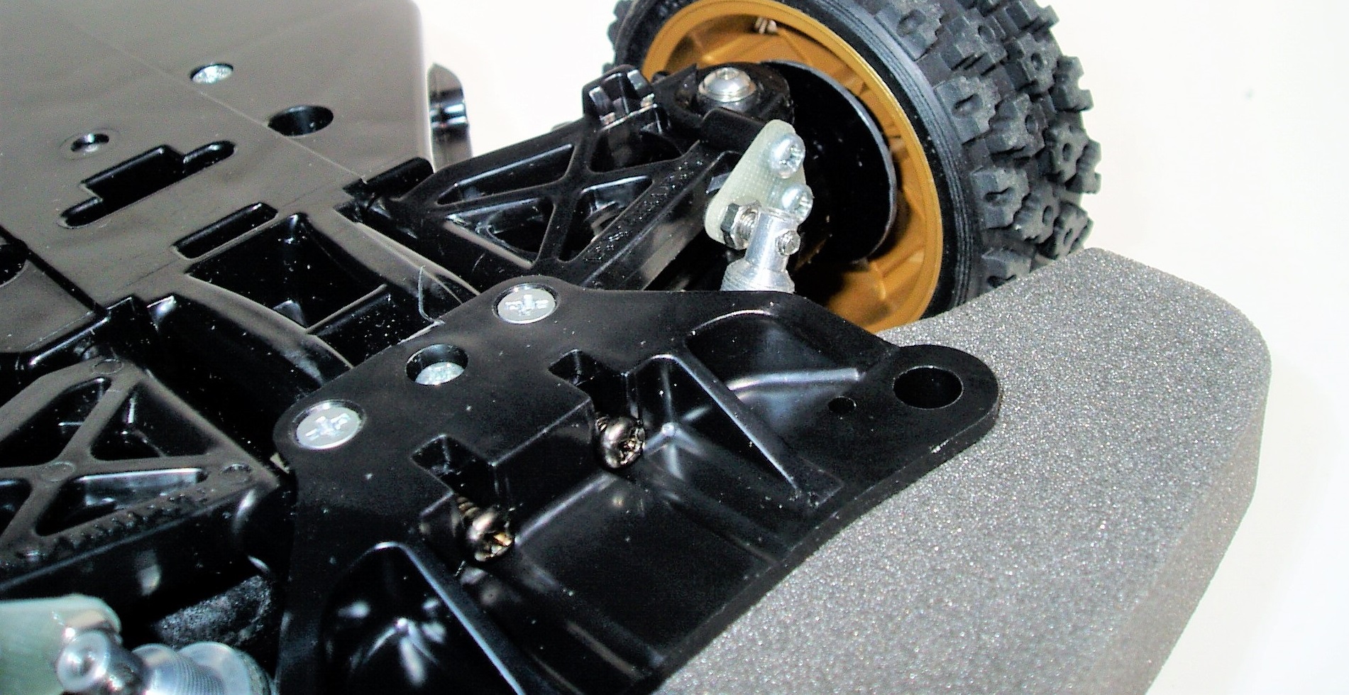

The front bumper mount has this abrupt step that I think will present some problems on my very rough and rocky track so...

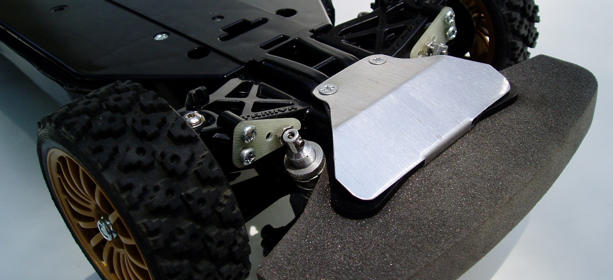

I've made an aluminum skid plate.

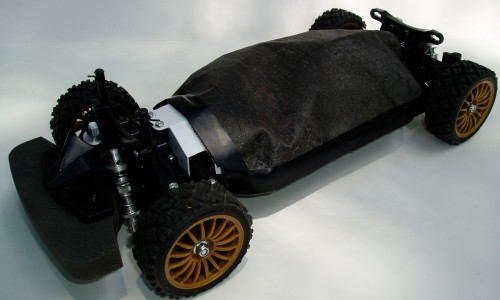

Also, I've added a tub cover to prevent rocks and other debris from collecting and fouling the steering, etc. This is made from landscape filter fabric and attached with velcro.

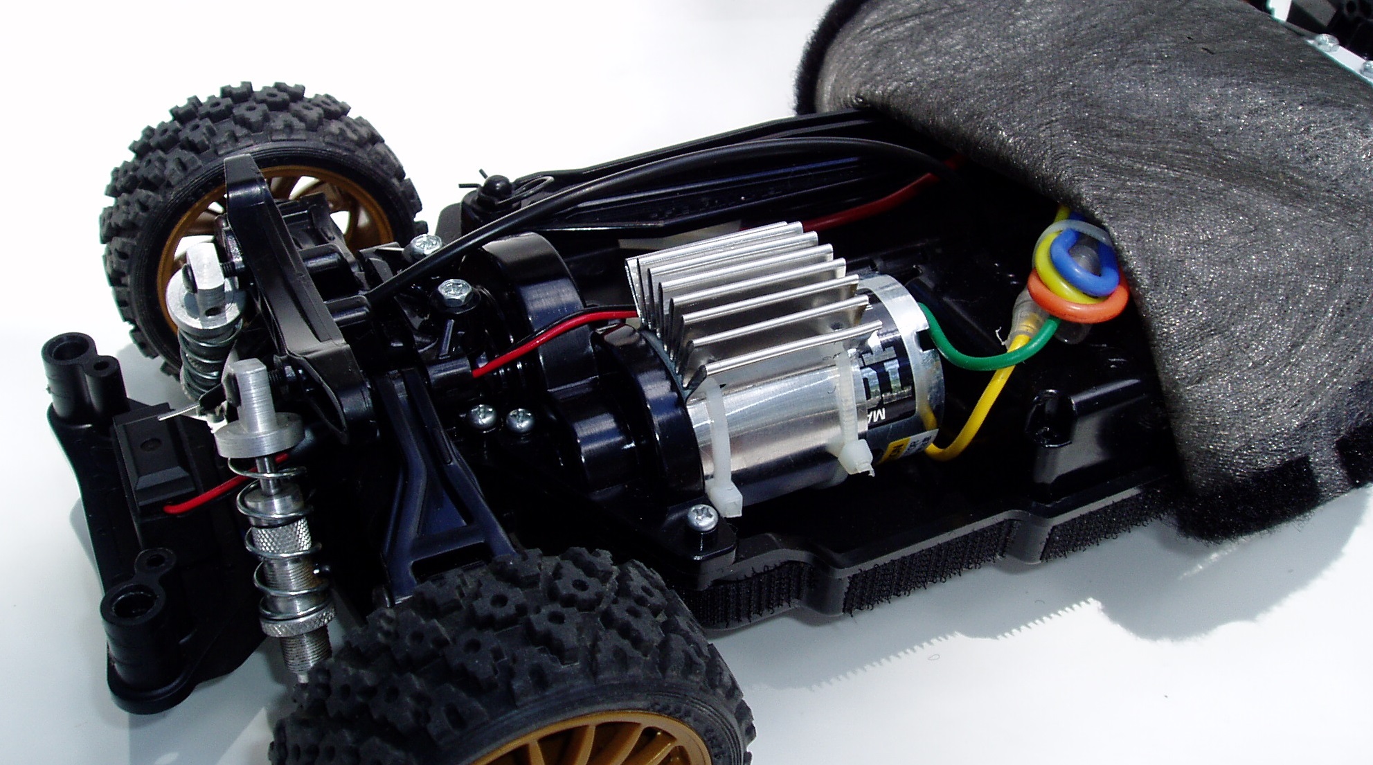

Also, after a few minutes run time on the driveway, the motor seemed to get very hot so I've whipped-up a simple heat sink.

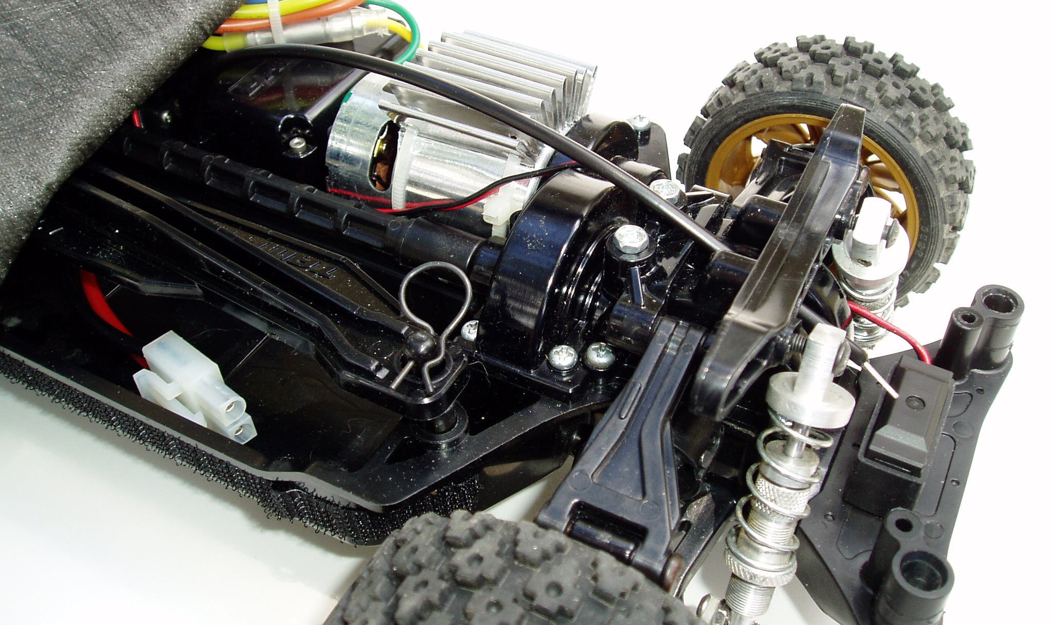

Lastly, I've relocated the switch to the rear body/bumper mount.

The dust shroud is a good idea but it's going to stop any airflow from passing over the parts that heat up; the motor and ESC. You might be at risk of frying those components, and possibly warping/melting the nearby plastic parts if they heat up too much. The addition of a heatsink is a good idea, but if you just cover it all up with the shroud, you still won't get the necessary airflow to make the extra surface area for heat dissipation effective. I would suggest trimming off the section of the shroud so it exposes the motor and ESC.
XLR8
Posts: 3307
Has thanked: 1659 times
Been thanked: 1170 times
Re: Subaru Impreza rally car build
Post by XLR8 »
Yeah, I've considered that adding a cover might reduce air flow so that's why I went with filter fabric. It won't entirely block air flow since it's very porous -- it's sorta like a nylon stocking. Anyway, I hope it will provide the needed air but I will stop the car every few minutes so I can check things out.
Also I actually don't think a hot motor will affect the plastic motor plate because Tamiya wisely provided a gasket to insulate the plate against heat. The ESC has thermal protection as well. In any event, I will certainly be monitoring the temps closely so that it doesn't go up in a puff of smoke. I certainly hope not anyway.
I really like you're idea about cutting a hole in the cover for the motor heat sink so I will be doing that. Thanks very much for that suggestion. :wink:

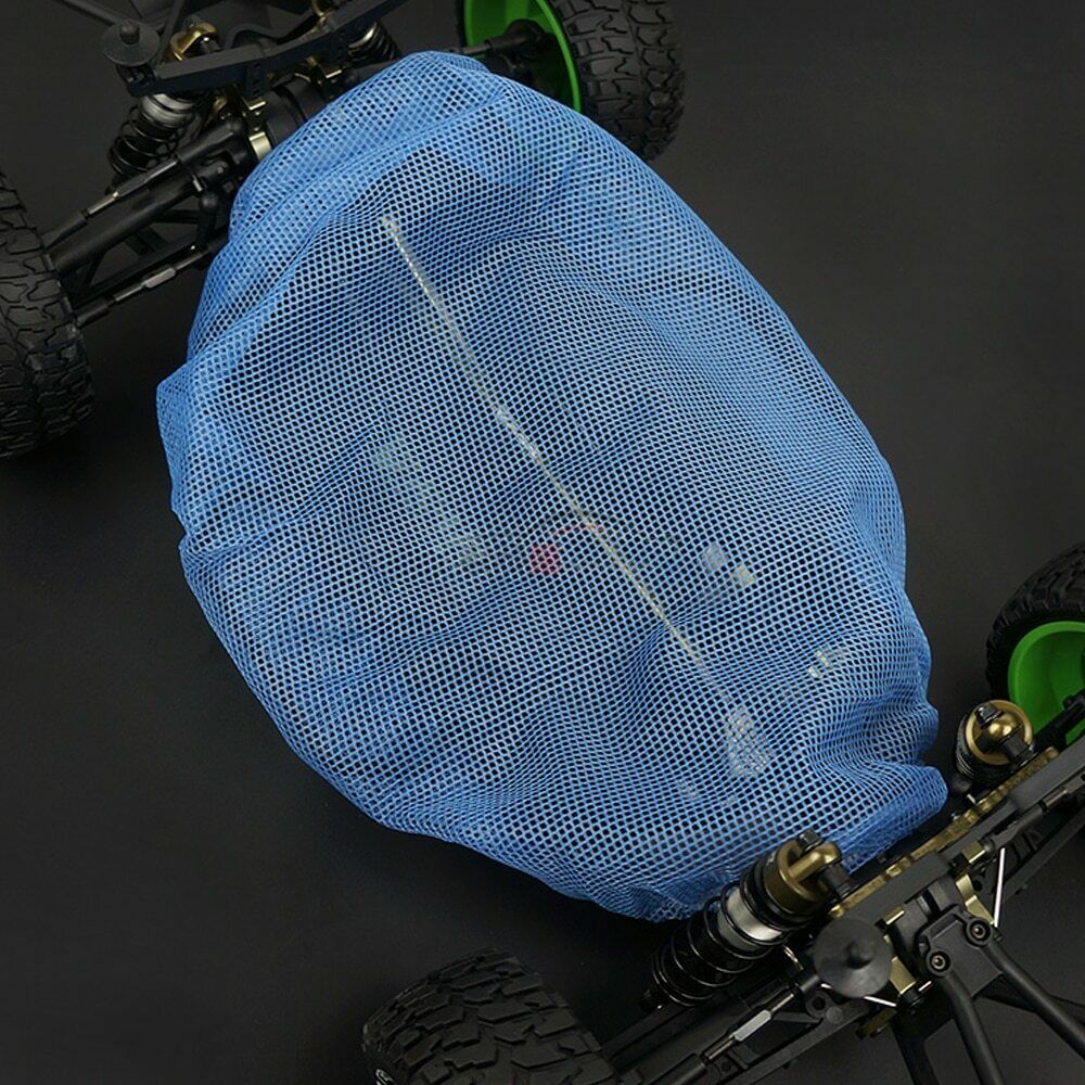

They've STOLEN my idea! :evil:
First the virus and now this!! :roll:
https://www.ebay.com/itm/1-10-Rc-Buggy-Dust-Protective-Cover-For-Kyosho-Losi-Lazer-Hpi-Associated-rc10/324258617830?hash=item4b7f51d9e6:g:54wAAOSwnTxfMwVT
Actually, I think theirs looks better. :oops: :lol:
