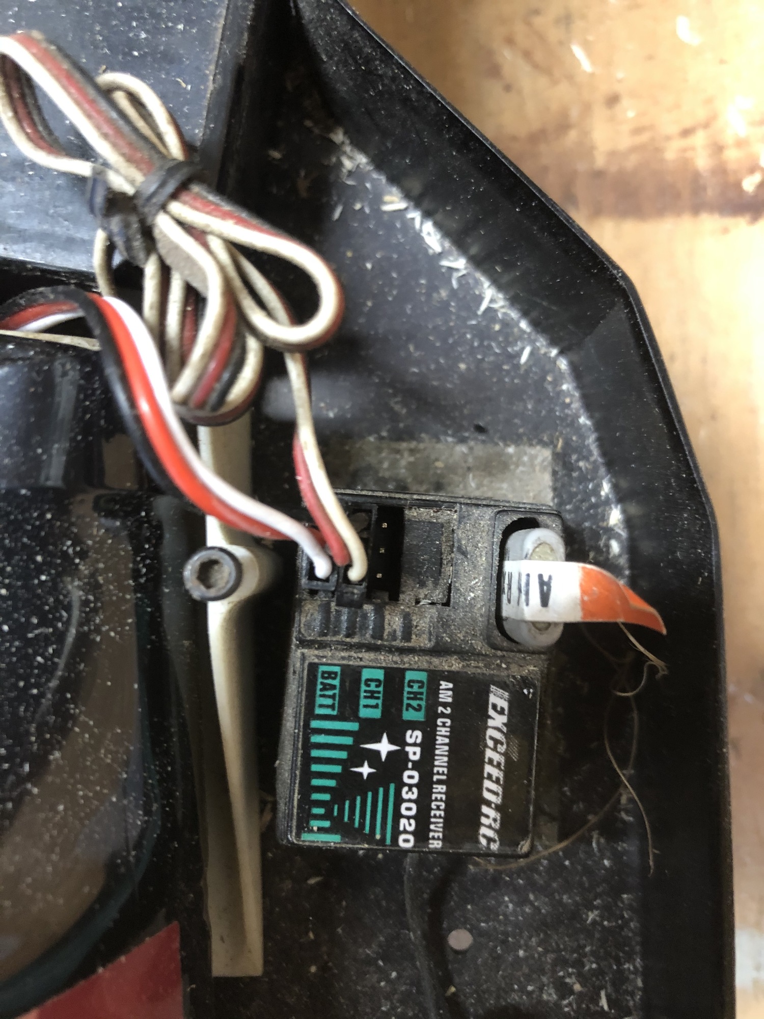

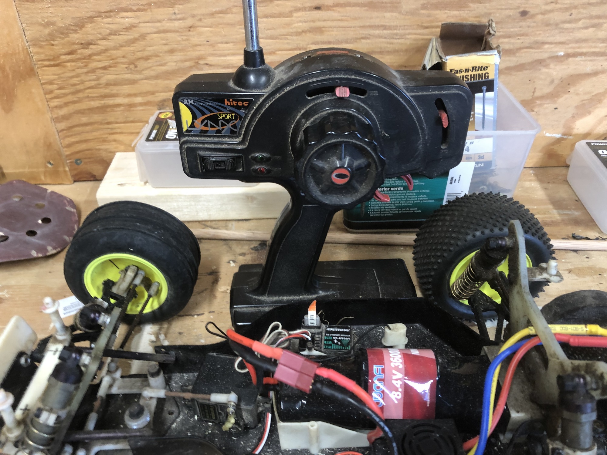

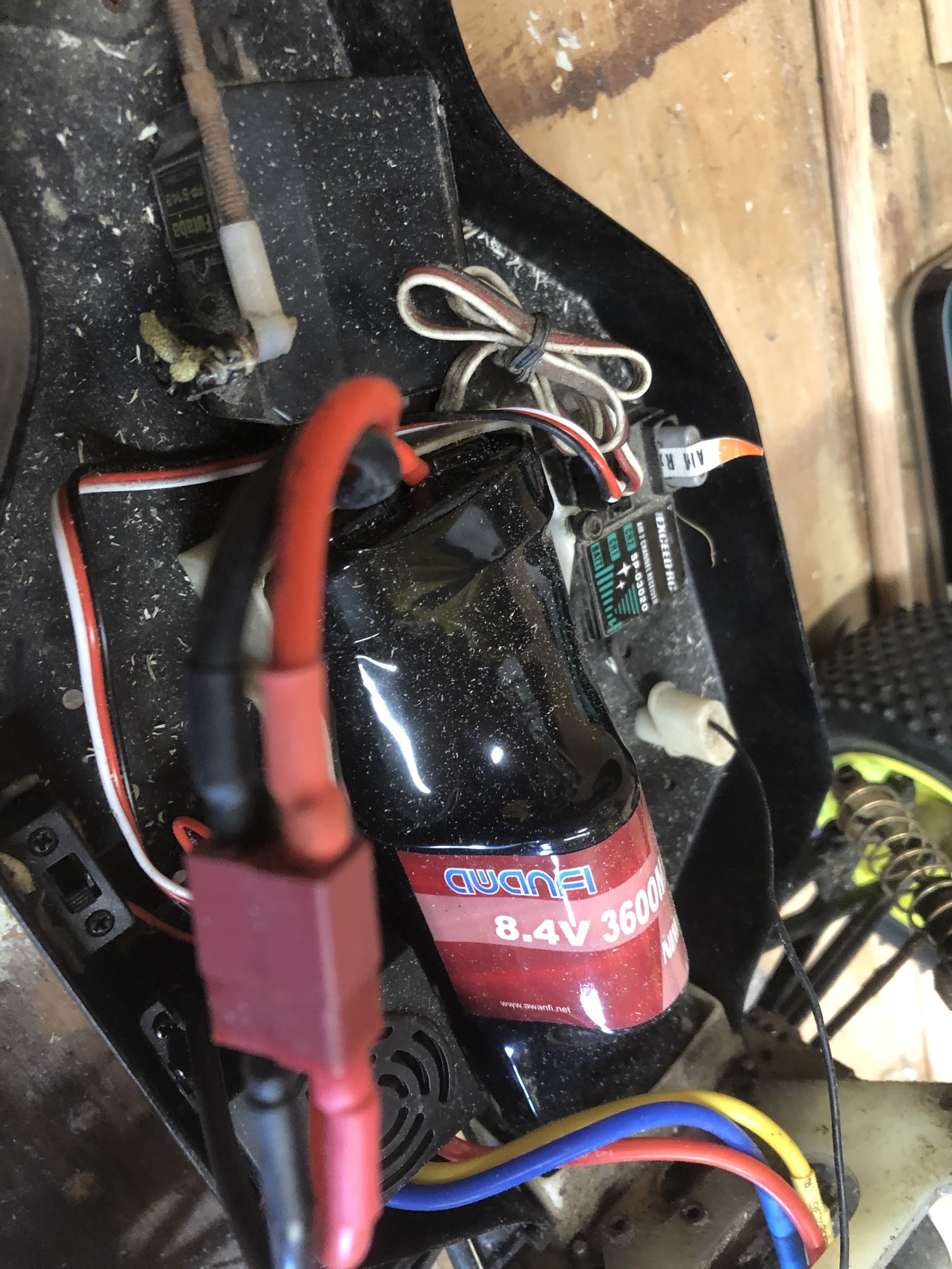

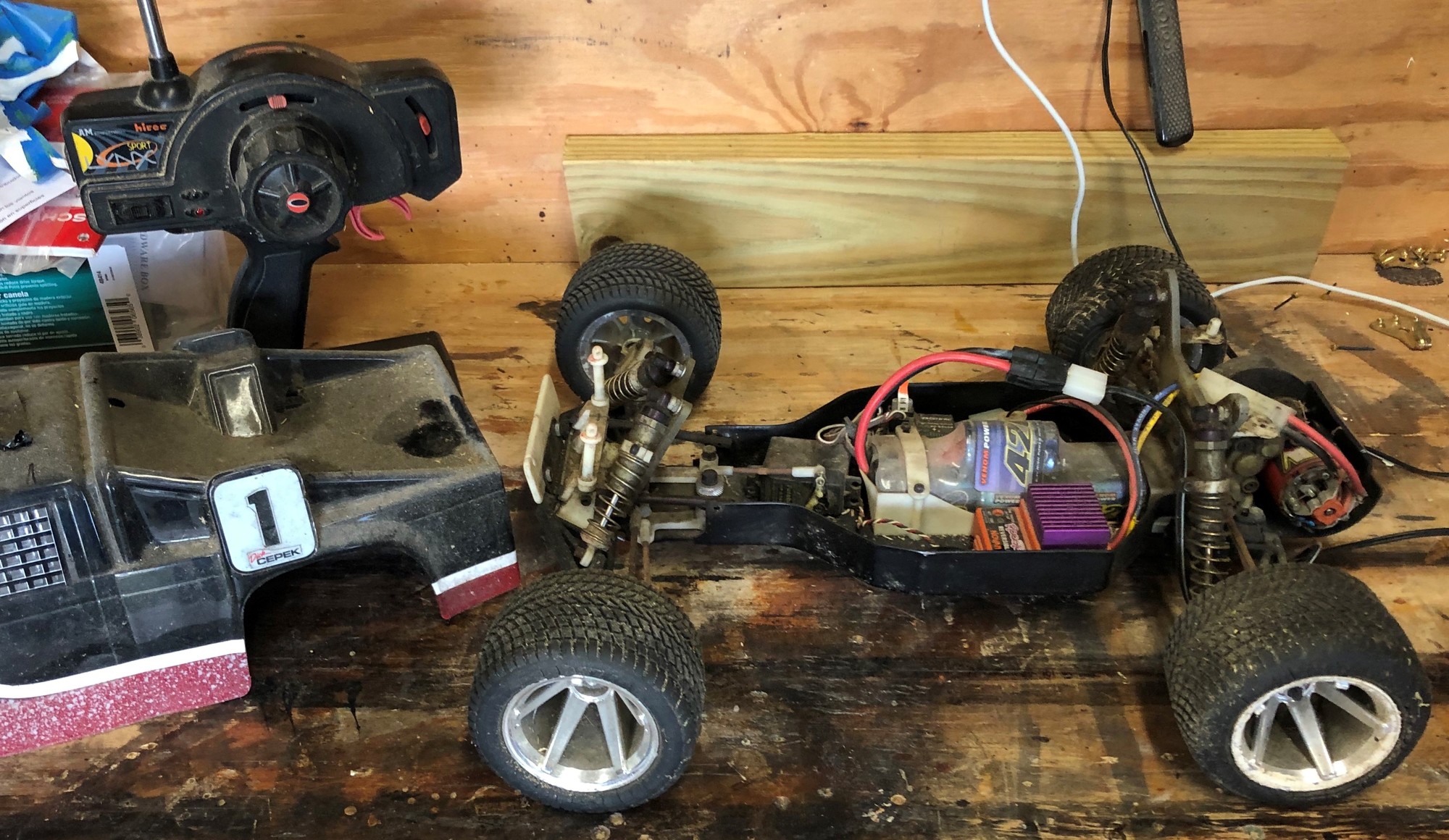

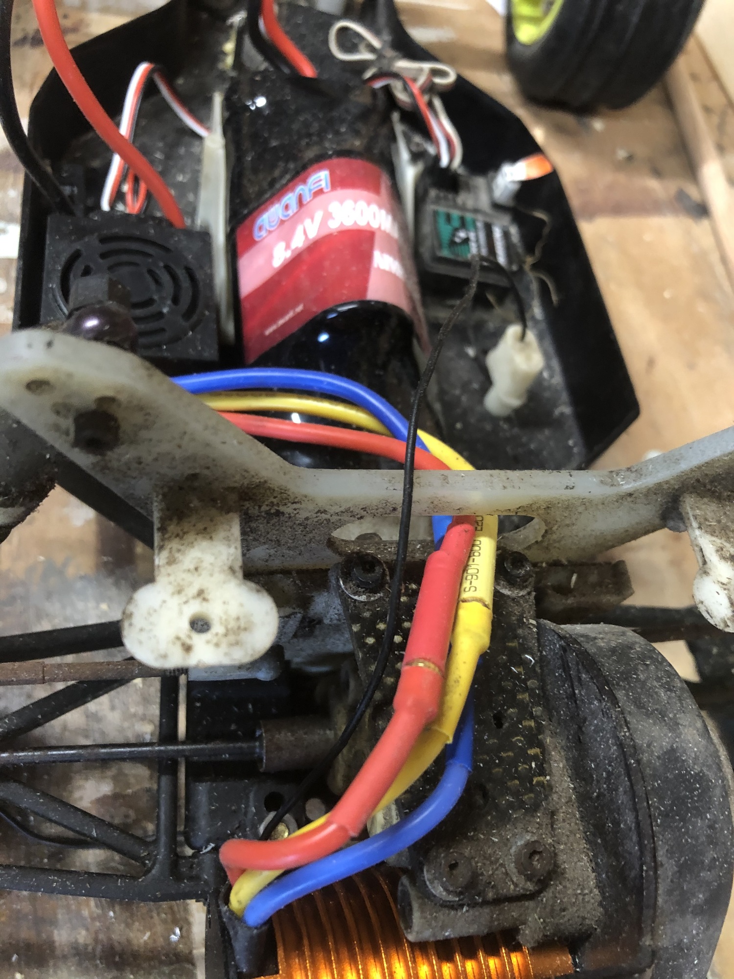

Ok gents, got the thing back together with a new battery (fully charged), ESC and motor....issue now is the thing will steer, but wont go fwd or rev. It rocks back and forth and the esc chirps on occasion. Pictures attached of the setup, I am by far an expert on these things so any pointers will be great.
- Posts: 12336
- Has thanked: 1129 times
- Been thanked: 3919 times
Re: Tech help and advice on older RC10
speed control needs to plug into channel 2, not the battery slot. Nothing goes in the battery slot
