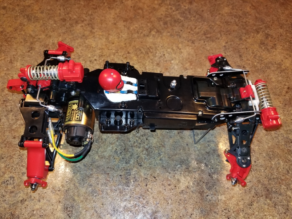

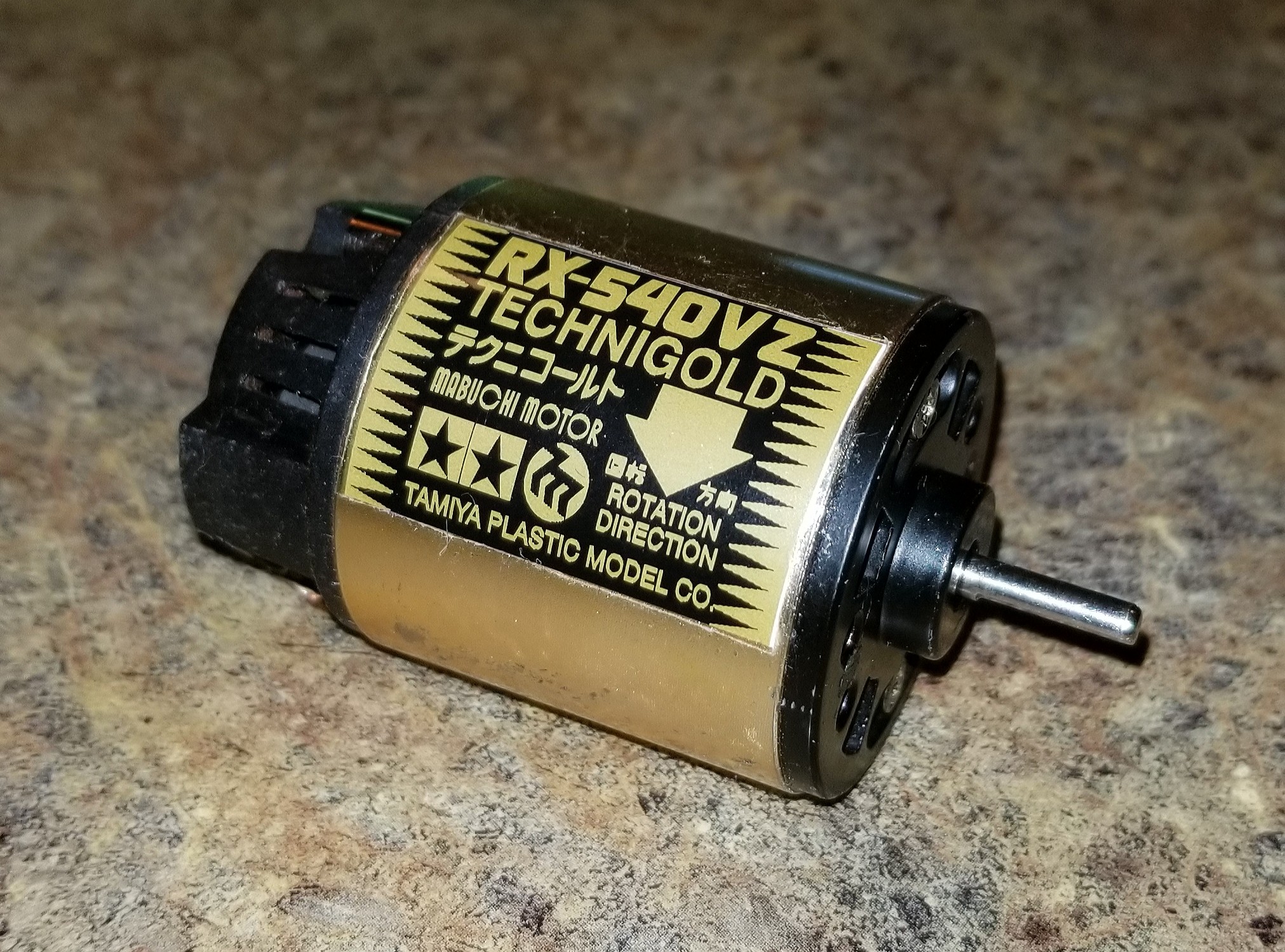

Won the Technigold....aint cheap! I will restorw it too!
Its definately going in this car.
Car ame today too! real happy with its originality. Wheels are originals painted gold, they are white behind that paint, tires in real decent shape....Got some parts in too

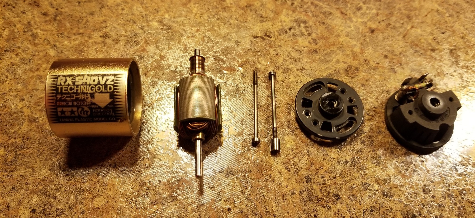

"Holy Grail" Technigold came today....yanked it apart to see if it was authentic cause it turned more rpm at middle timing than i thought it should. 22,200 @ rpm 7.2v. Looks authentic to me. Seems it might have been balanced professionally.

That motor looks like it's in good shape. It will be cool to see how well it performs in the Hotshot. I've never seen one run so I have no idea how they compare to modern Tamiya brushed motors.

Have had zero time to start this restoration but gathering parts and got motor rebuilt. Put in new brushes, cut the comm, ceramic bearings and new decal. Shes a ripper, 23,000rpm @ 7.2v, zero degrees timing

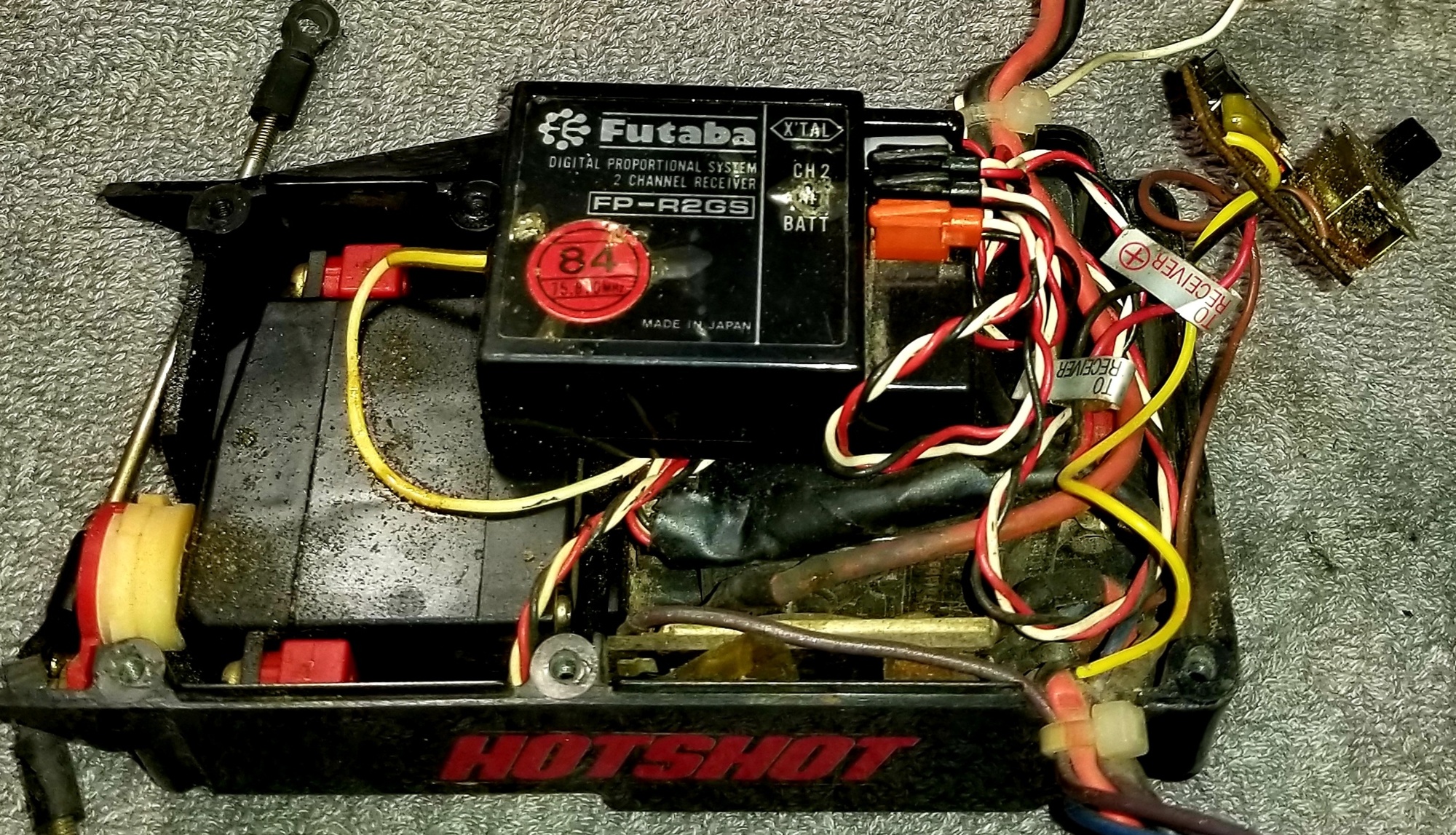

original radio box with msc!

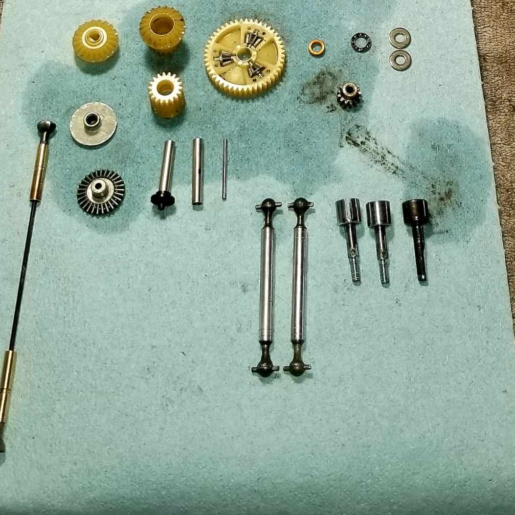

got the front axles, dogbones and propeller shaft restored

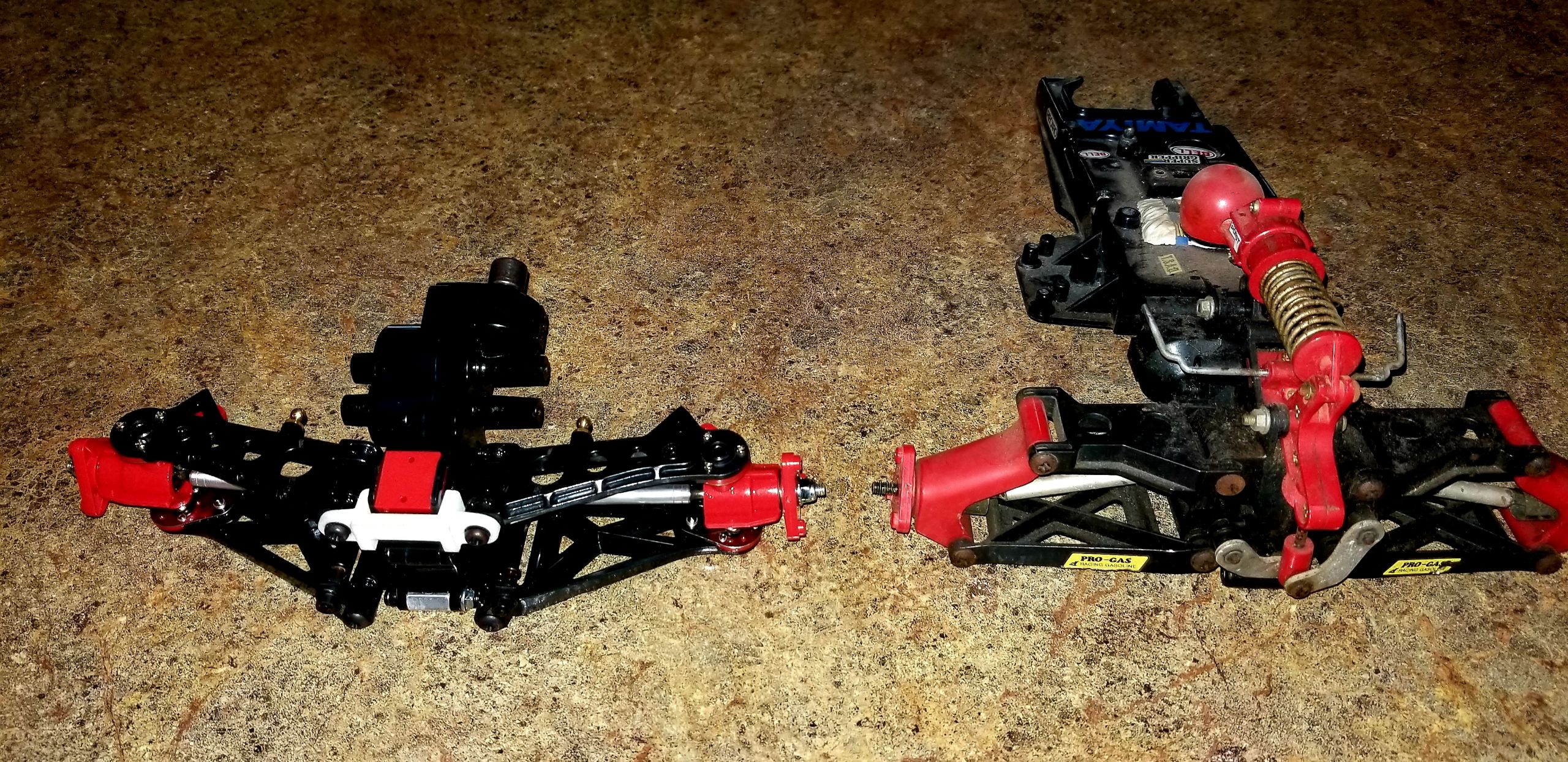

got the front end restored
