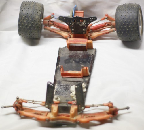

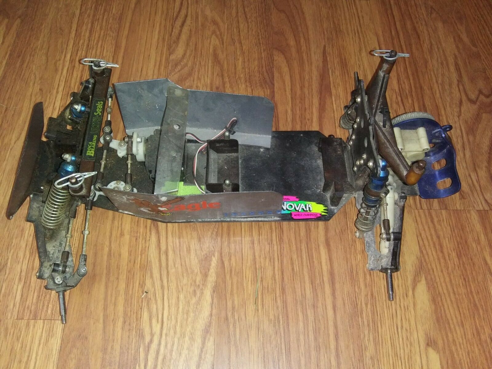

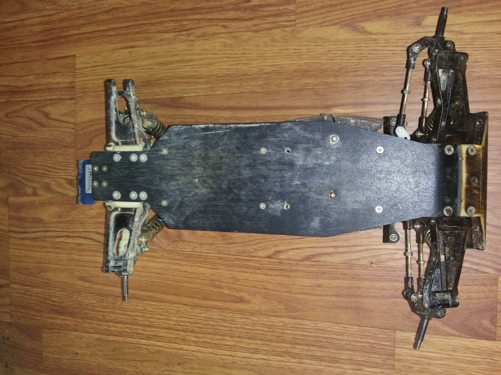

So after losing out on an old school Bandit to build up a mad idea I had, I bought a clapped out Blue Eagle on Ebay. At first glance, it's a basket case. I've been searching the site for a while for details about these and seems to be that I may regret this can of worms I opened. While all white parts would be great, I'm thinking I'll be Frankenstein-ing this thing together.
Basically, I need to know what wheels and chassis to start with?
RC10, FX10, JRX2 PRO, Blackfoot, Bolink Eliminator...much more, probably too much.

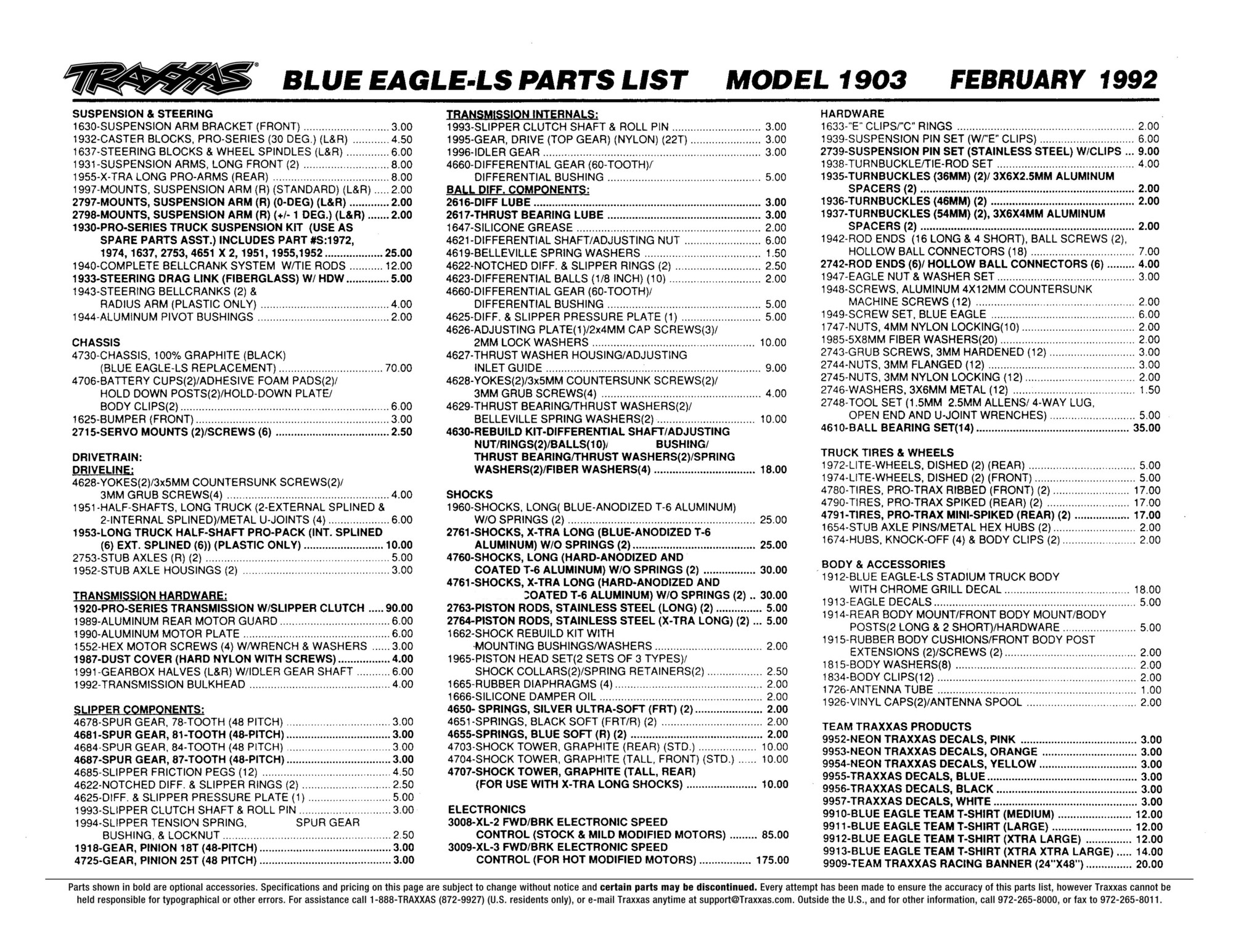

TRA 1974, Light dished front 2.2
TRA 1972, Light dished rear 2.2
Or try this:
https://traxxas.com/sites/default/files/legacy_partslist_blue-eagle-LS_0.pdf
It's the Blue Eagle LS parts list.
A Blue Eagle with that style chassis is most likely the LS version as well. The Blue Eagle was kinda an upgrade kit with three gear 272 magnum transmission w/slipper, bellcrank steering...then they came out with the LS upgrade with long suspension and light dished wheels with more offset. Then they released the entire kit with these features....chassis, trans, wheels, rear suspension arms, etc. That looks like a factory release Blue Eagle LS. But I'm not TOTALLY sure. Those rear arms look like Eagle
Traxxas shows the Eagle as released in 1990 and the Blue Eagle LS in 1991. The Blue Eagle may have been released as a kit in there at some point but very limited in that configuration?
Here is the Eagle parts list:
https://traxxas.com/sites/default/files/legacy_partslist_eagle_0.pdf
