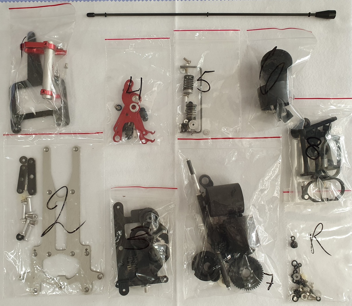

Upon unboxing one is greeted with 9 ziplock bags, each bag representing a 'group' as referred to in the manual, to be assembled in sequence. There are no step by step instructions per se, you'd need to refer to the exploded diagram as you step through each 'group'.

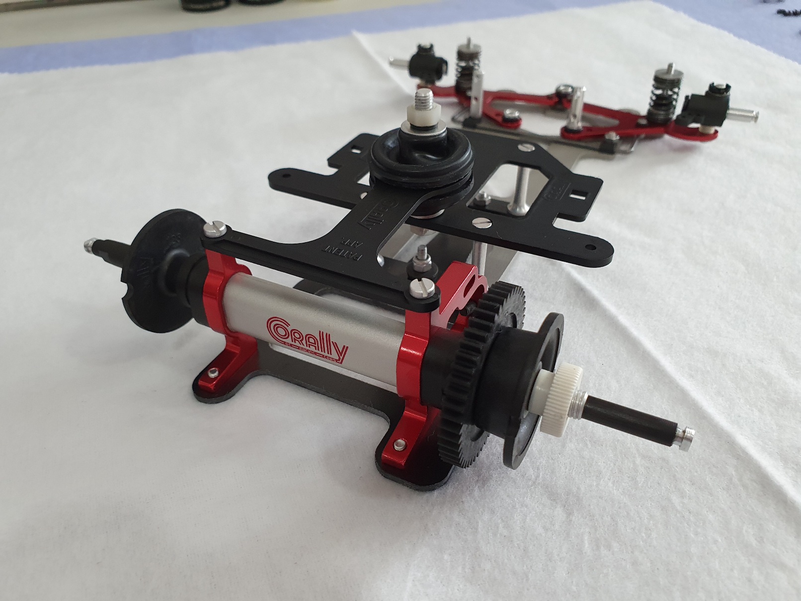

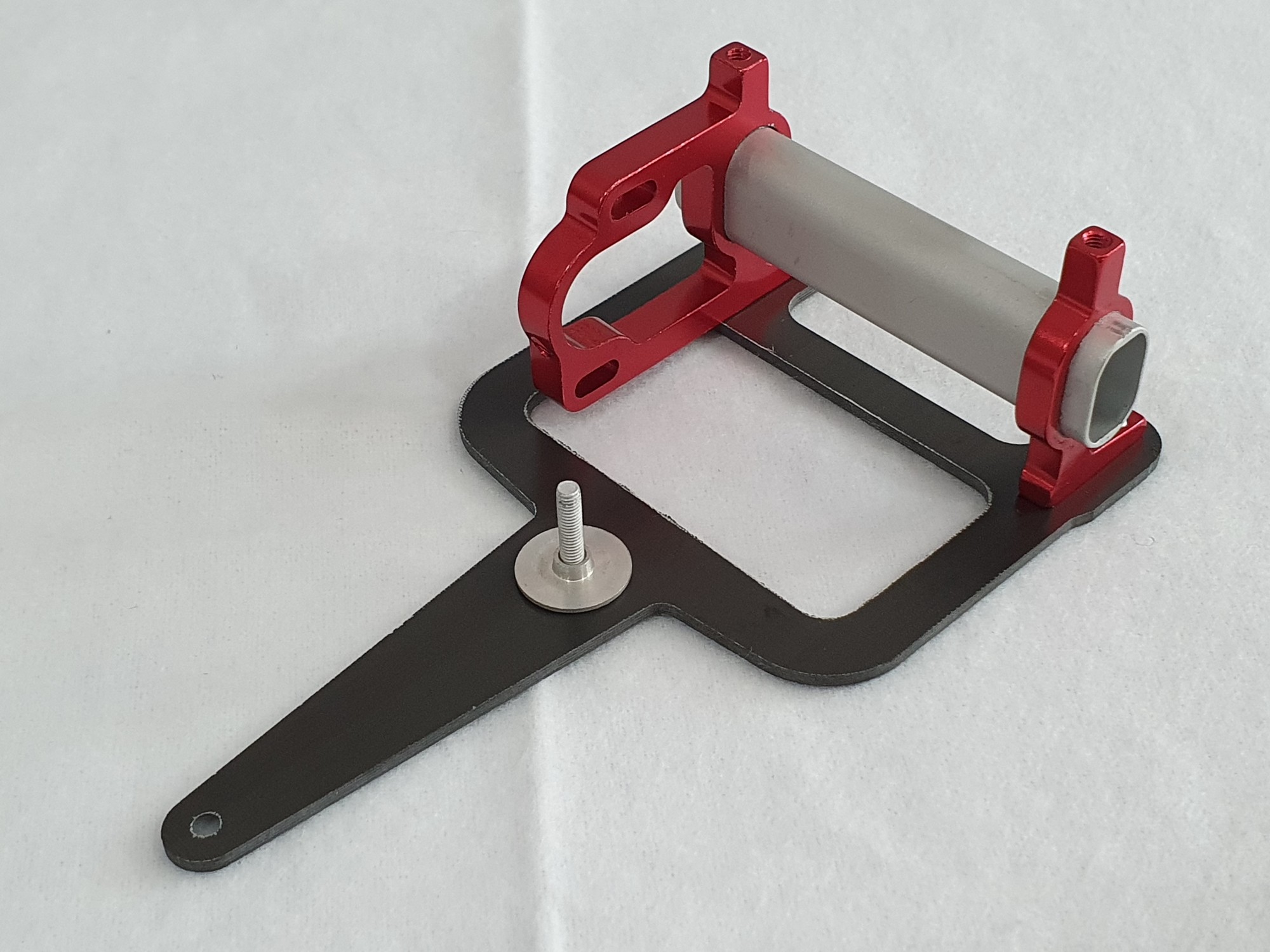

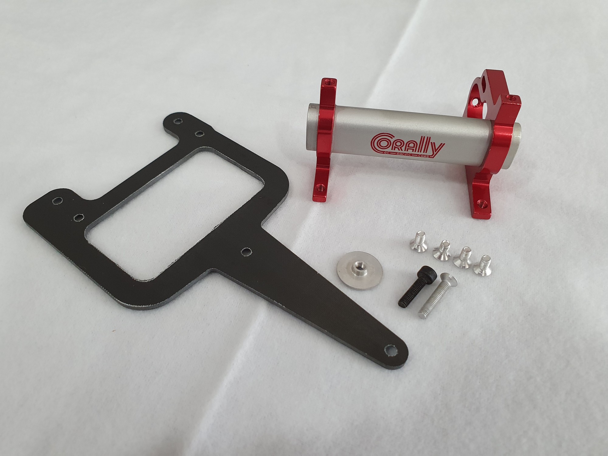

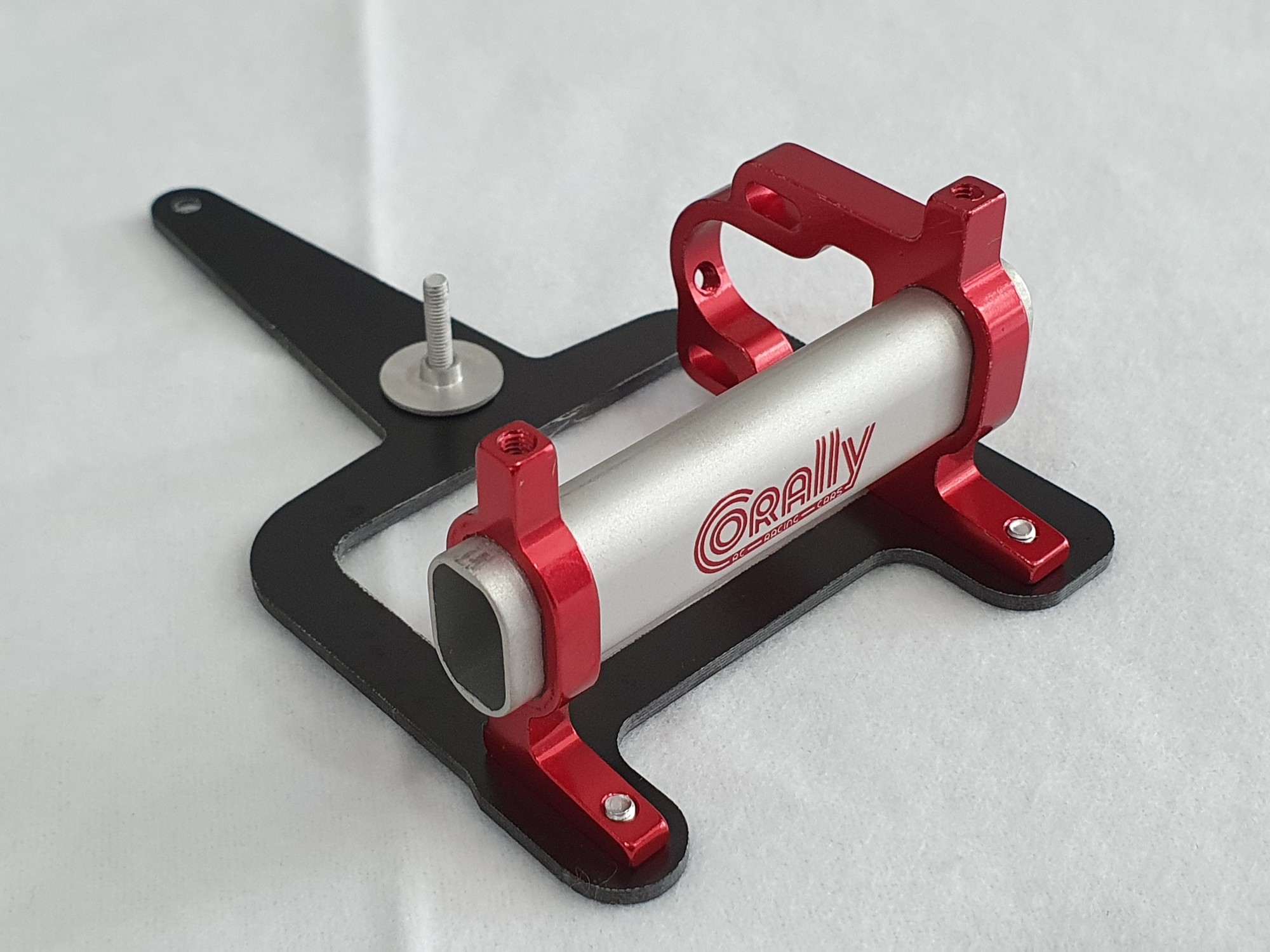

Group 1: T-bar and Motor Pod
The T-bar is made of carbon fiber, but rather than the usual woven construction, here it is made up of 11 layers with the carbon threads laid in 4 directions to render the sheet resistant to tweaking.
The motor pod is offset slightly to the left so that the motor will be perfectly centered.

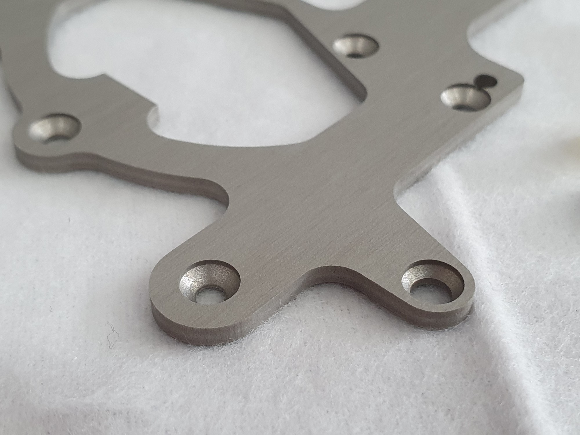

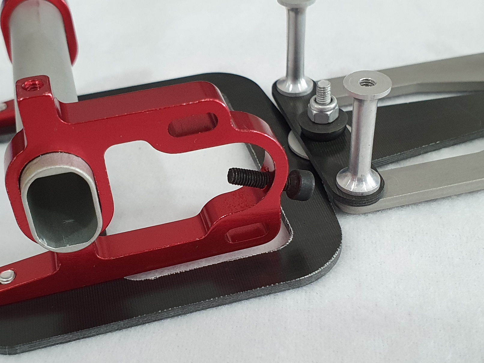

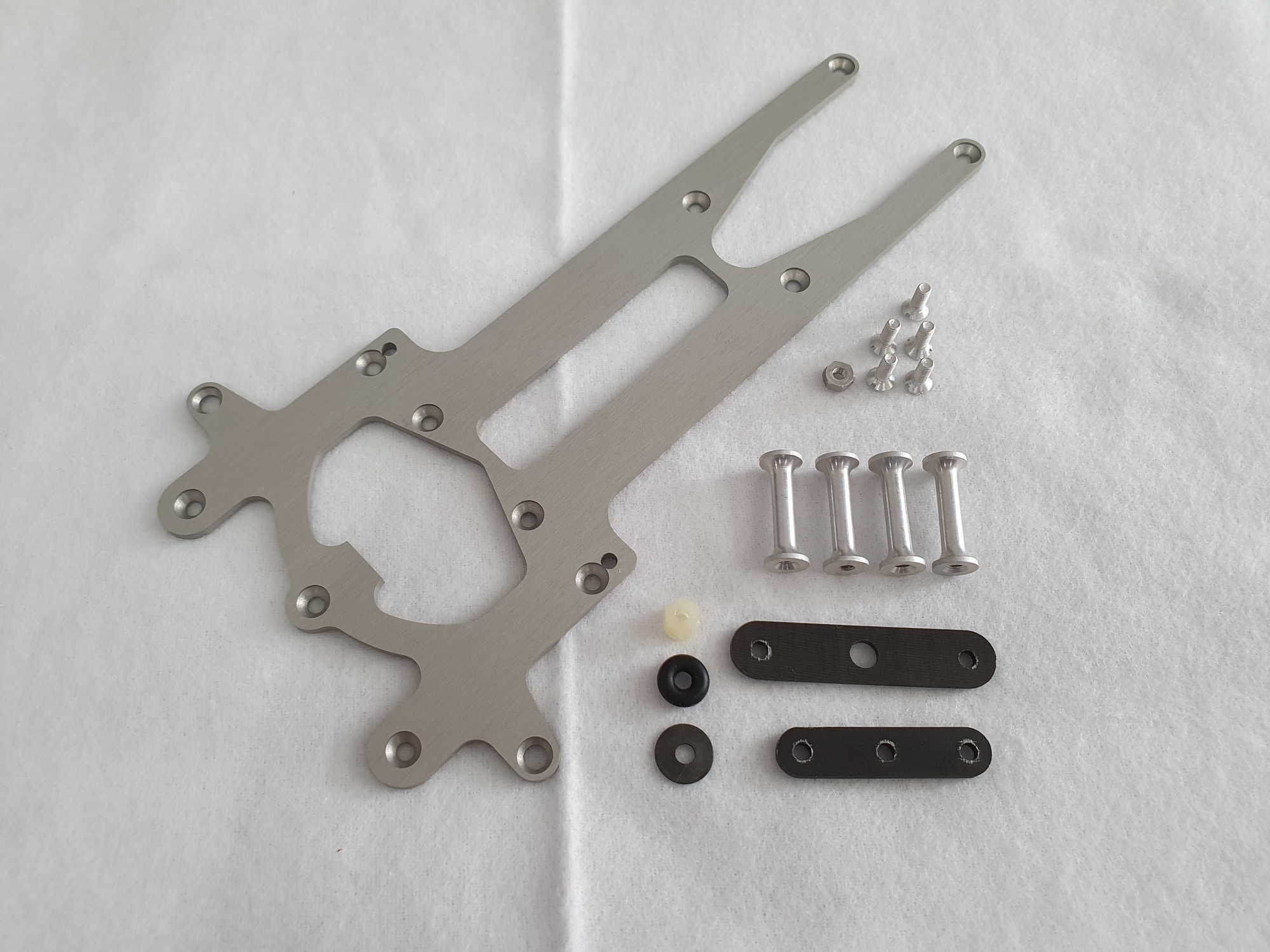

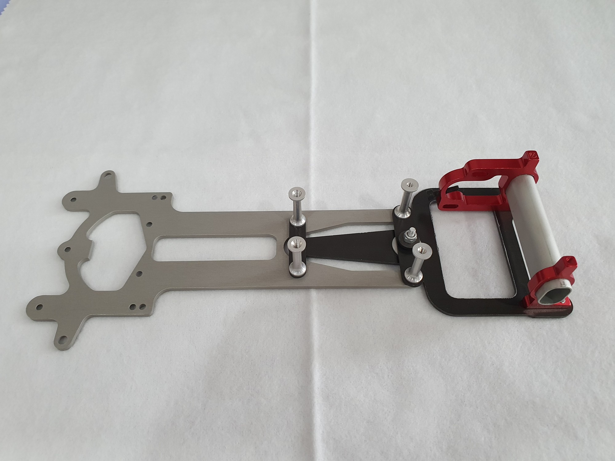

Group 2: Main Chassis

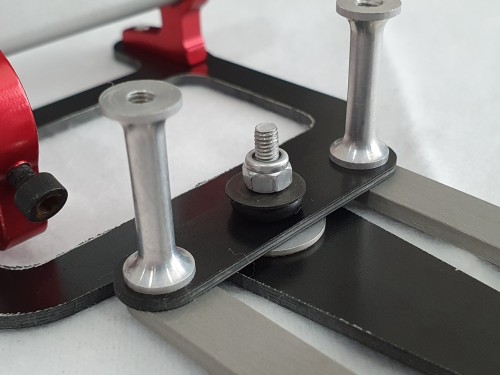

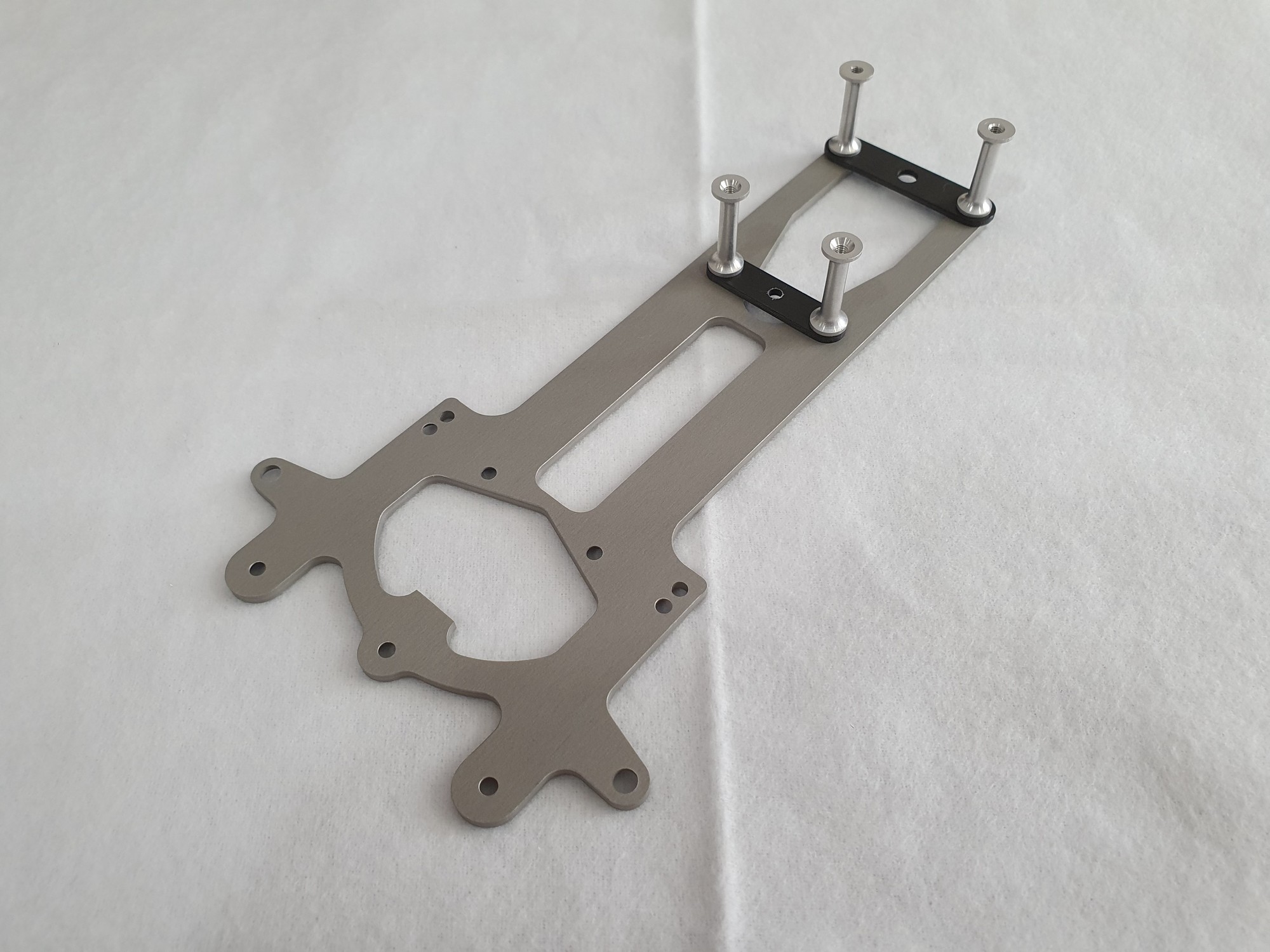

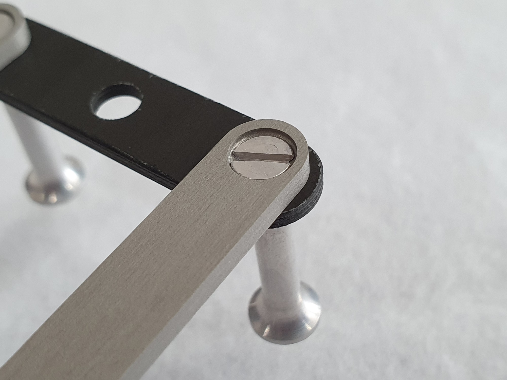

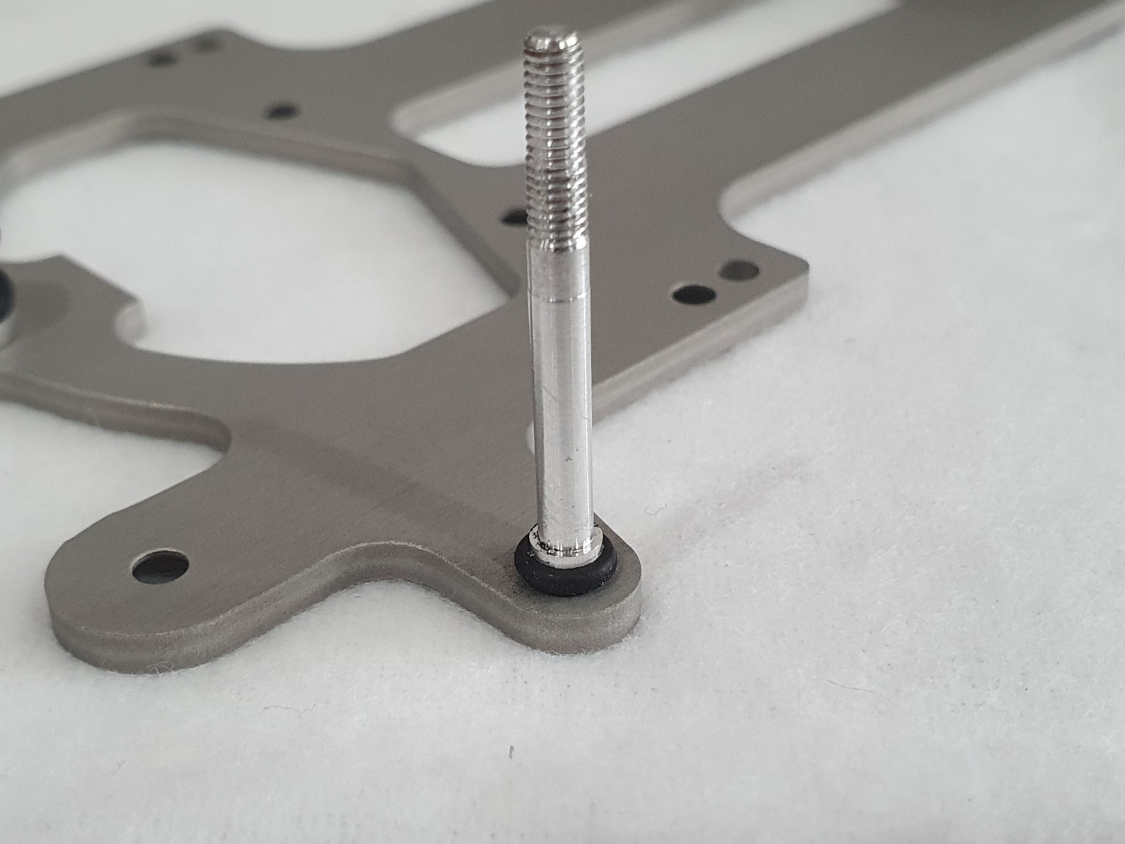

The CORAL chassis has an attractive anodized hairline finish.
Carbon fibre cross members are held down by the radio plate posts, here the similarities to the Schumacher C car is clear.
There's a lot of attention to detail - the countersunk holes on the bottom are deeper and allow the screw head to seat deeper inside.
At this point the T-bar assembly can be connected.
Close-up on the pivot that creates rear end articulation. An o-ring compressed by a bevel washer provides the play required.
The motor pod has a feature to locate the motor position with a screw, I believe this is intended to save time on gear meshing when the motor is removed and put back.

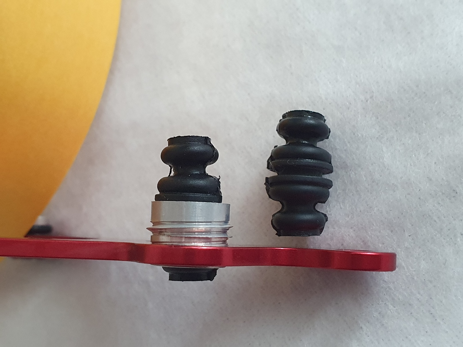

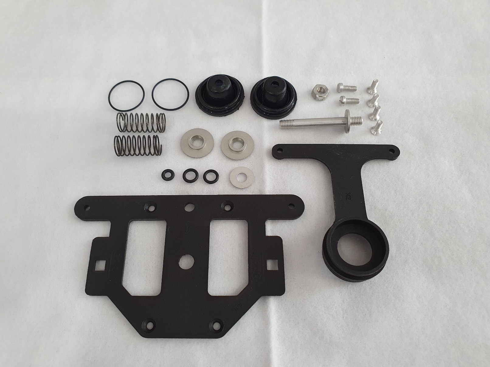

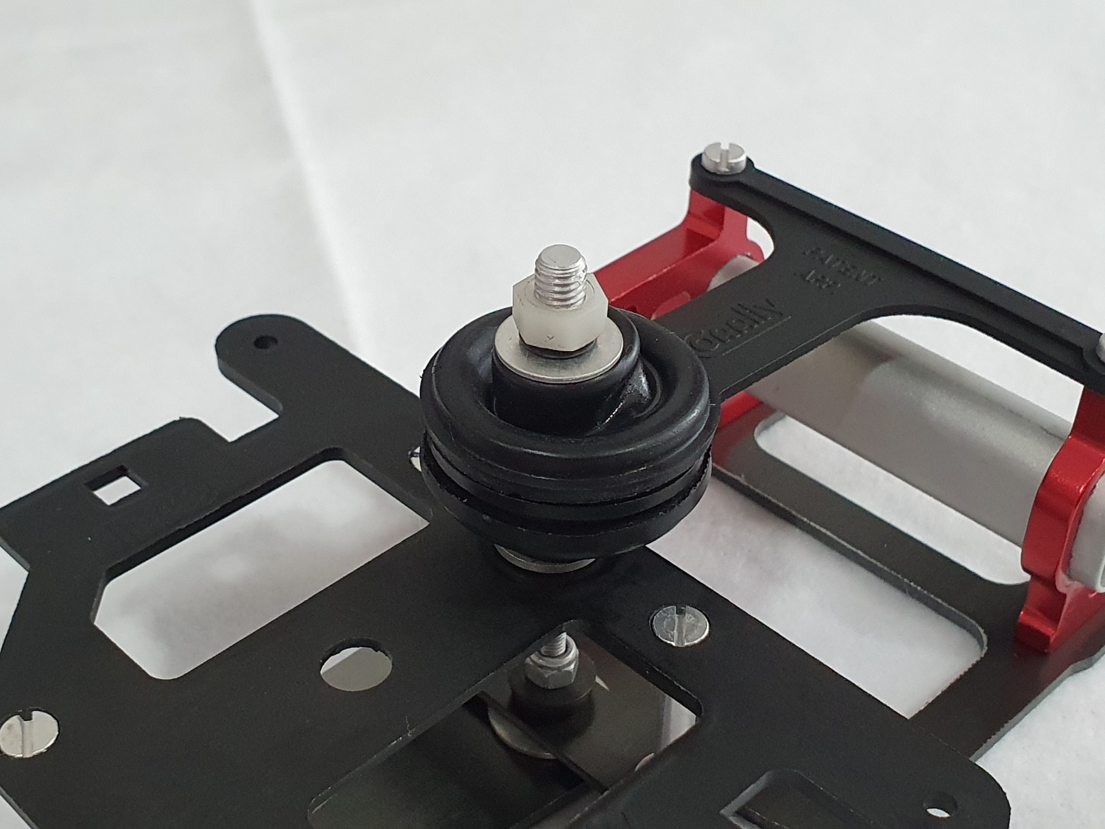

Group 3: Radio Tray and Damper Plate

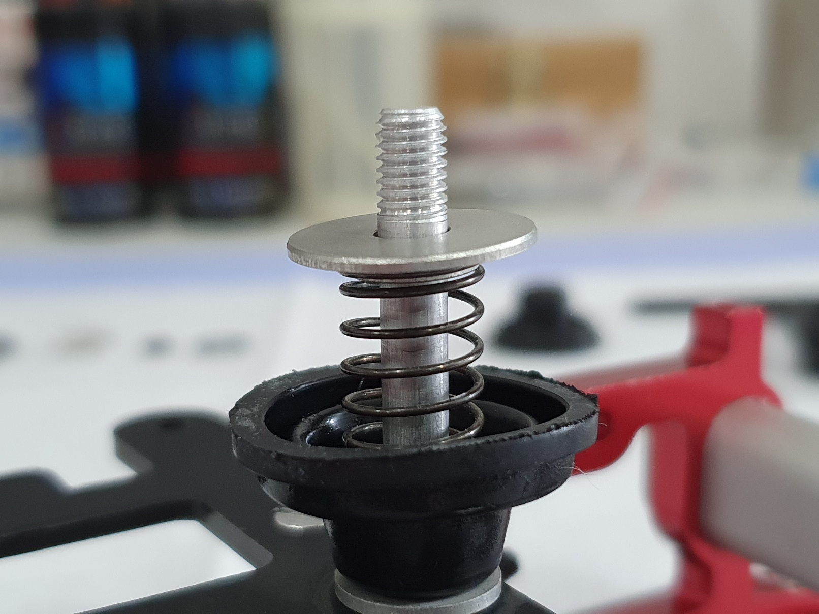

All molded parts of the PK Corally are carbon filled, except for the body posts. This helps to keep the shape of the part and would be an effective property especially for the wheels.
Close-up on the lower half section of the rubber boot, friction plate and spring. The rubber boot was first sprayed with rubber treatment compound to 'moisturize' it. I was extremely careful when working on them. In some cases they crack with age (34 years!). The friction plates are sprung against the damper plate (that is fitted next) from bottom and top. The friction plates themselves have o-rings to damp their sliding along the damper post.

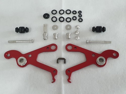

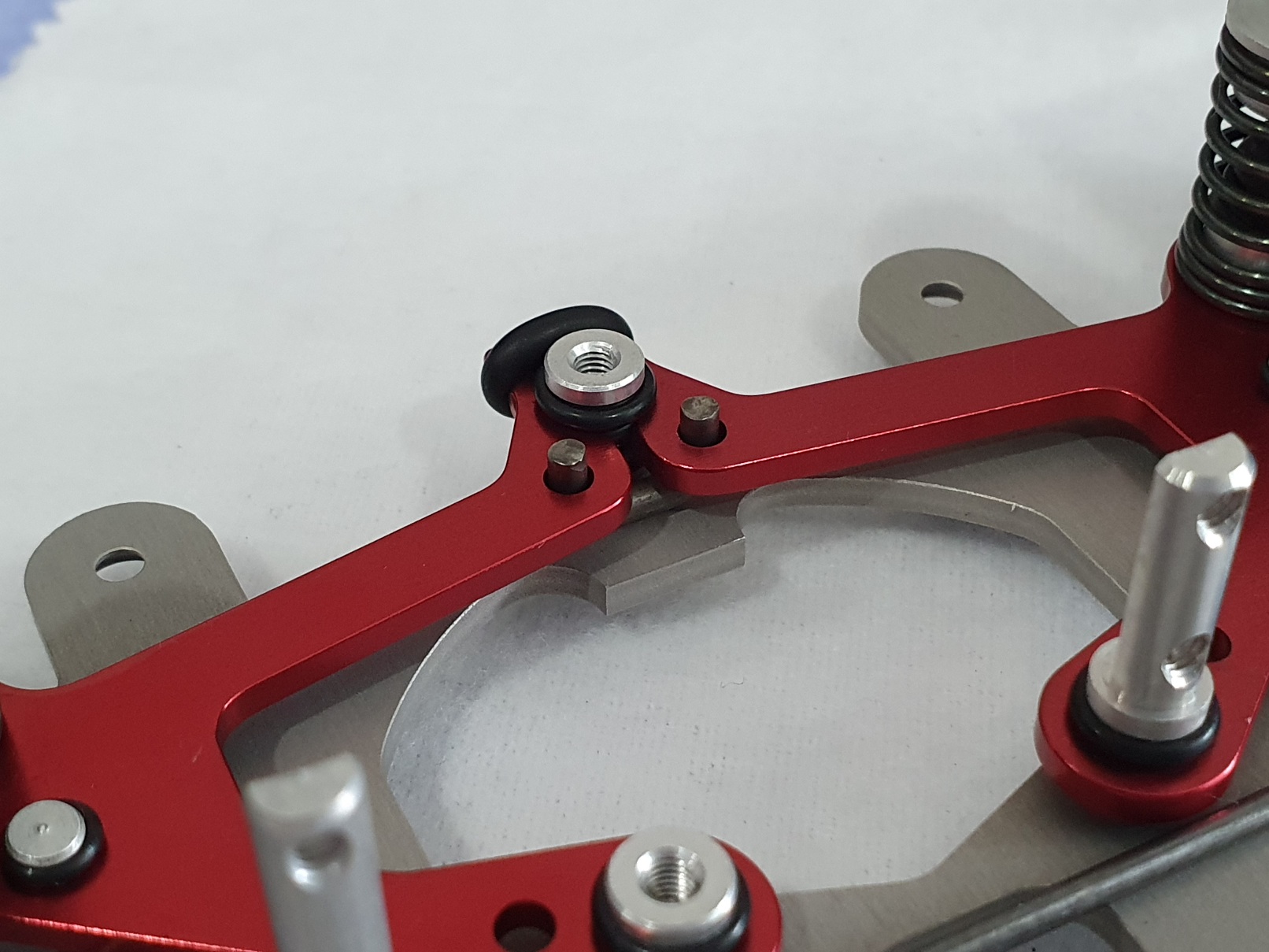

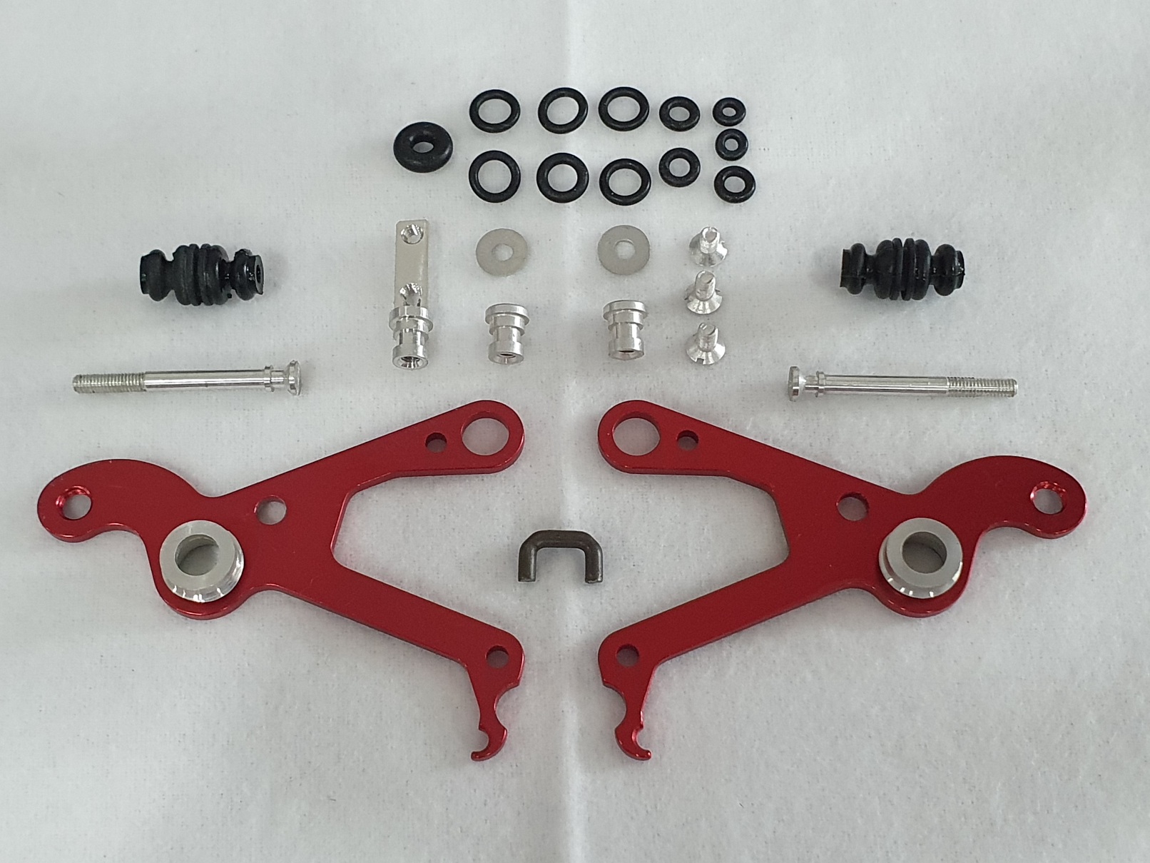

Group 4: Front A-arms & dampers

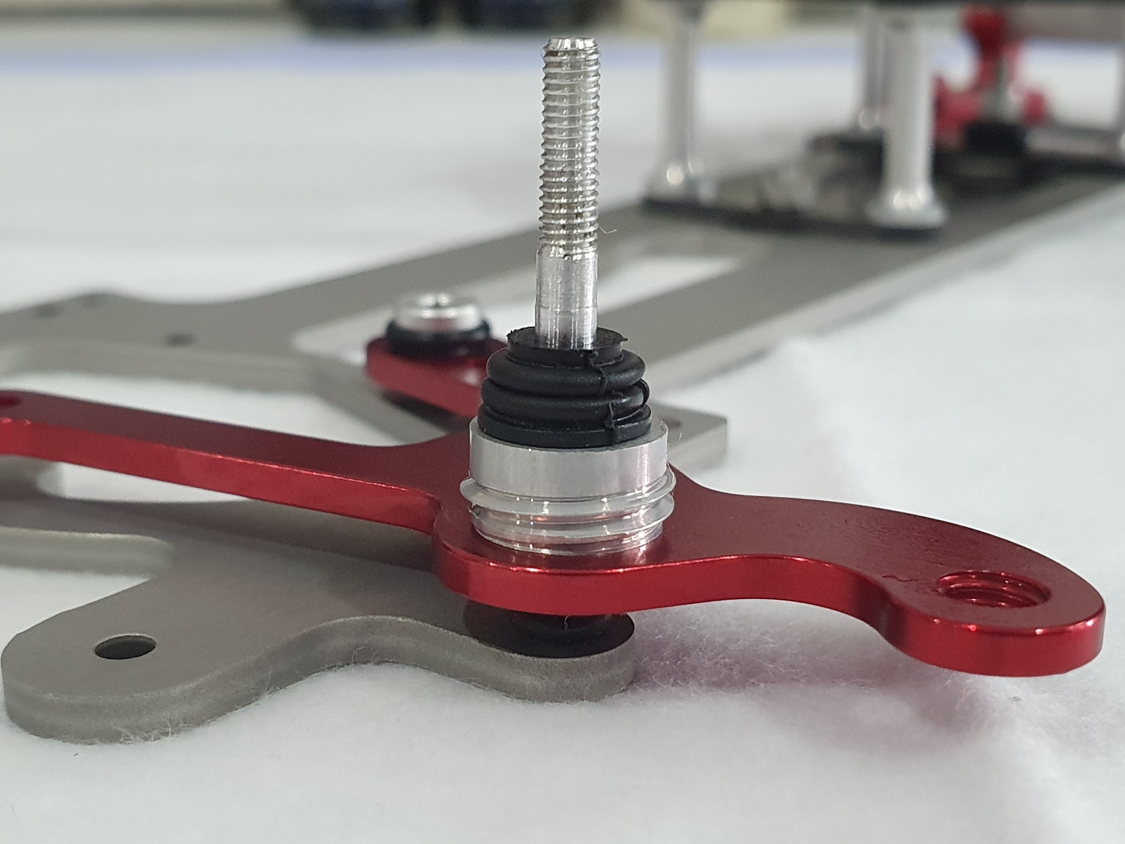

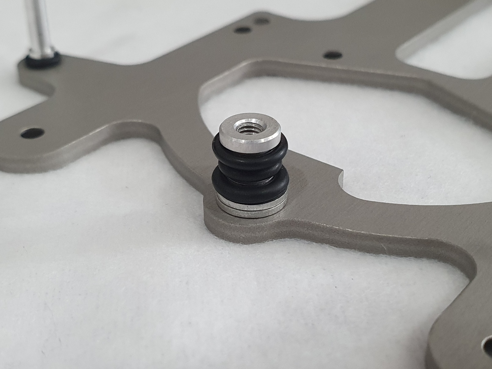

The damper posts are meant to articulate and are held in place from the main chassis with small o-rings.
The A-arms articulate from 3 pivots, the shared front center pivot is shown here. O-rings are in use here again - there are 3 for each pivot post.
The front dampers need to be very very carefully pushed into position, and the next picture will give an idea what was required. I used the blunt end of a wooden tooth pick to do this.
After this painstaking step the A-arm with the damper is placed into position with the damper post pushed through the damper, again another fragile step to be careful with.
One of the rear pivot post is integral with the steering servo mounting post. The A-arms are held together at the front with an o-ring. I don't think this was intended as a crash-back system ala Schumacher Cat XLS but rather as in improvement on the initial design that saw the arms come loose against this shared pivot post - the o-ring would keep the arms always located against the shared pivot.

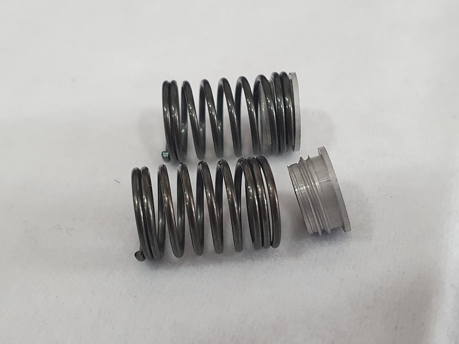

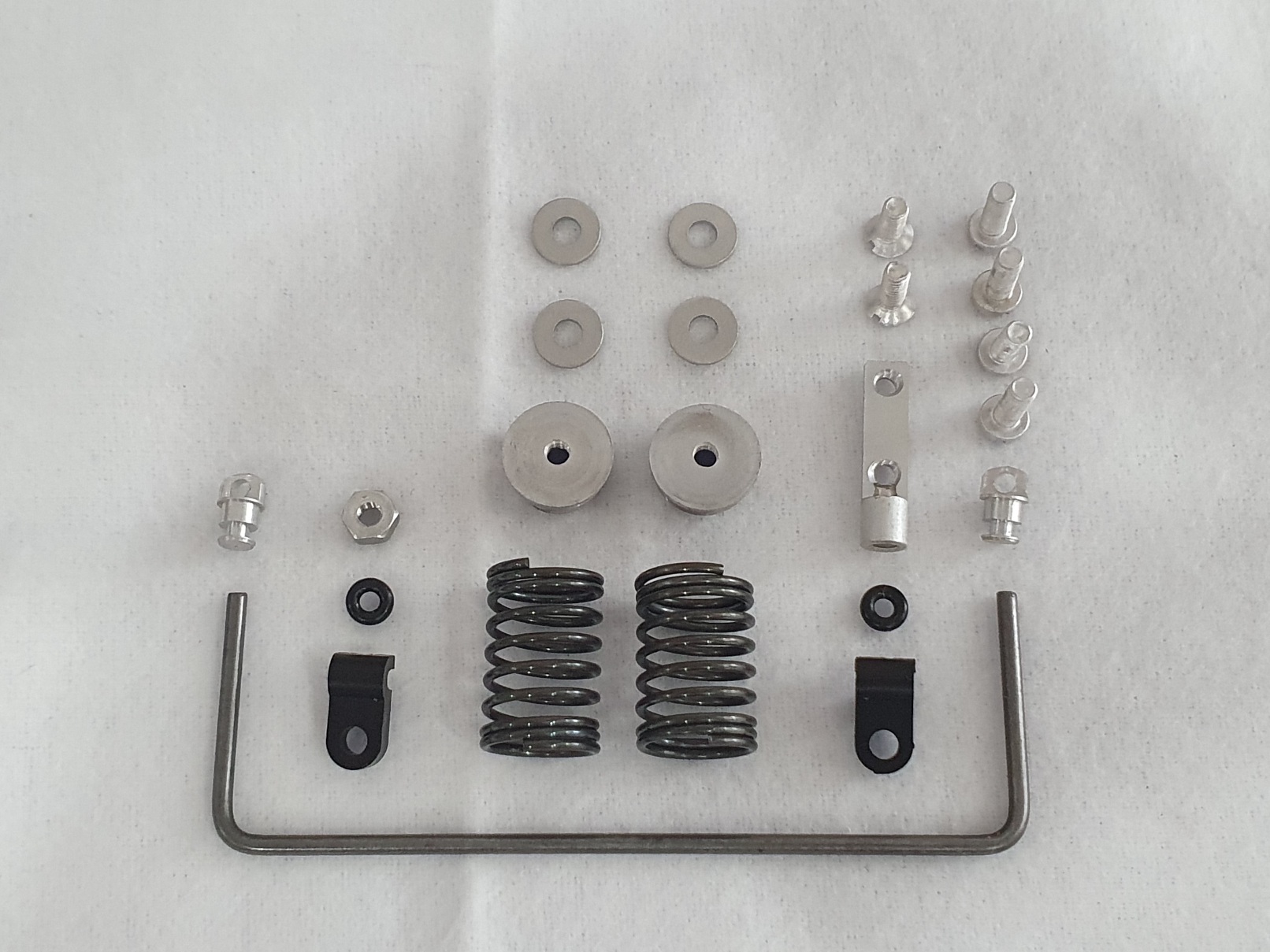

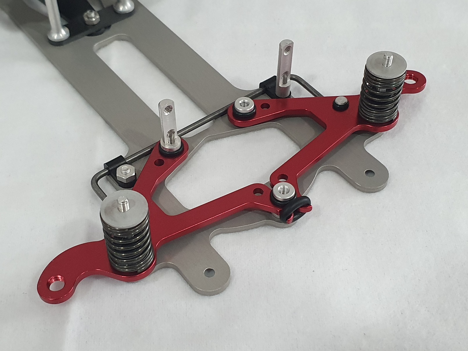

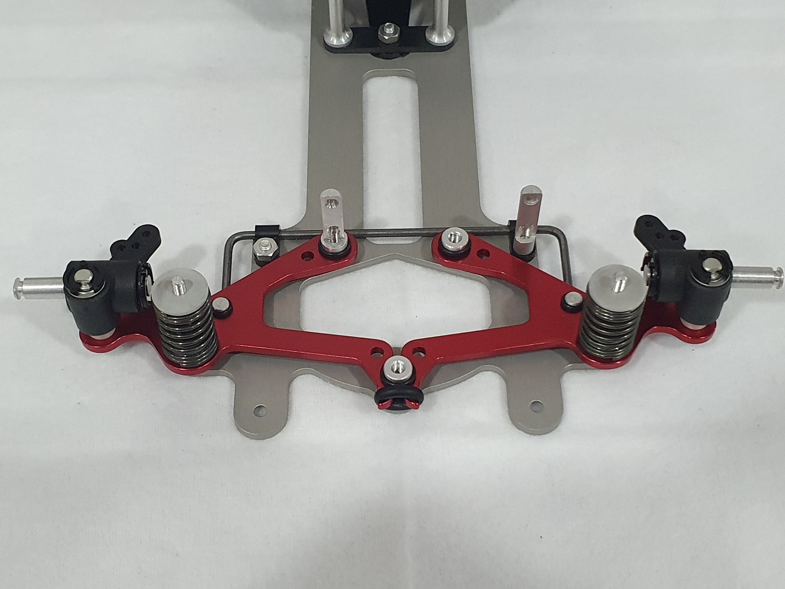

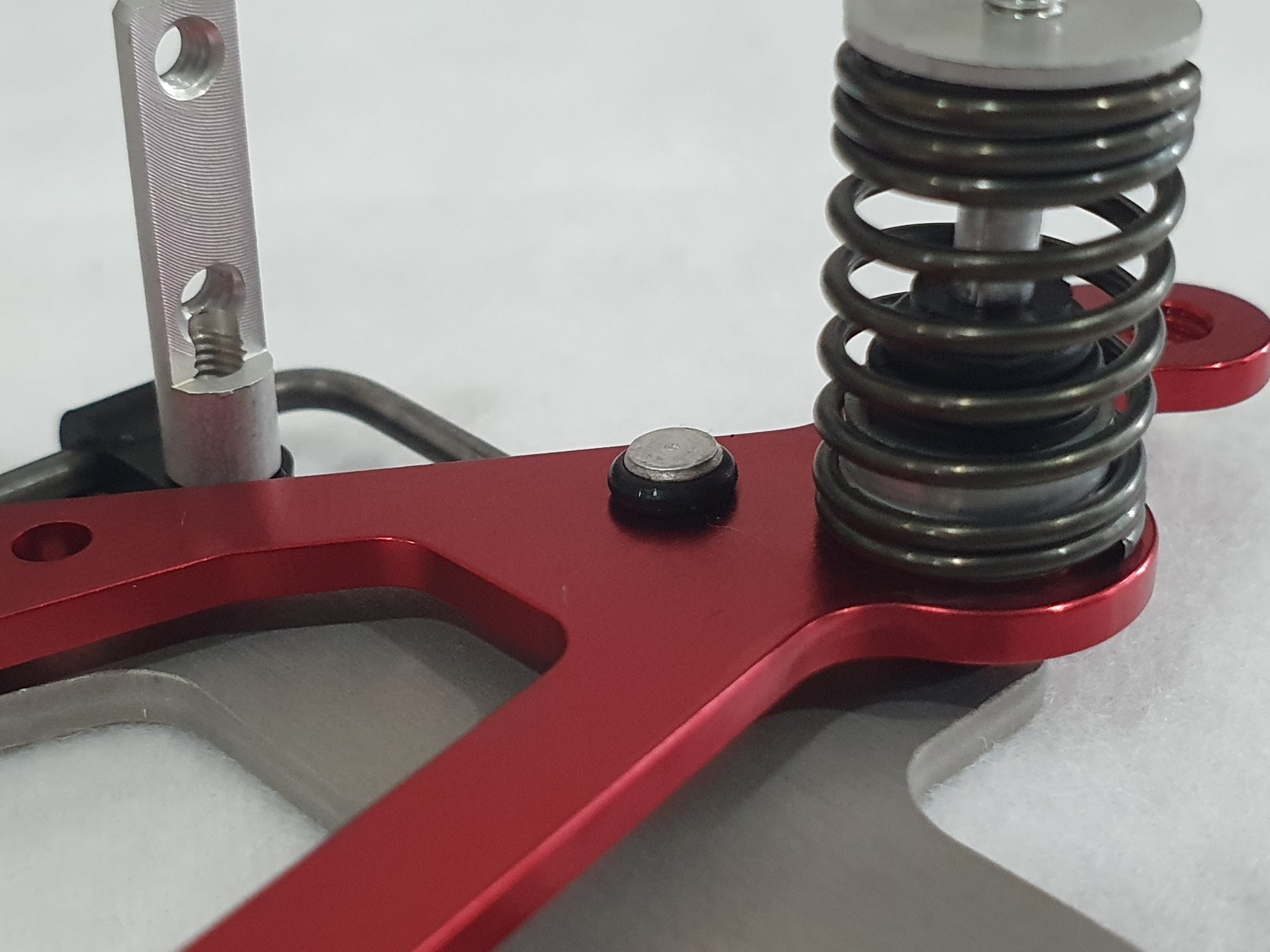

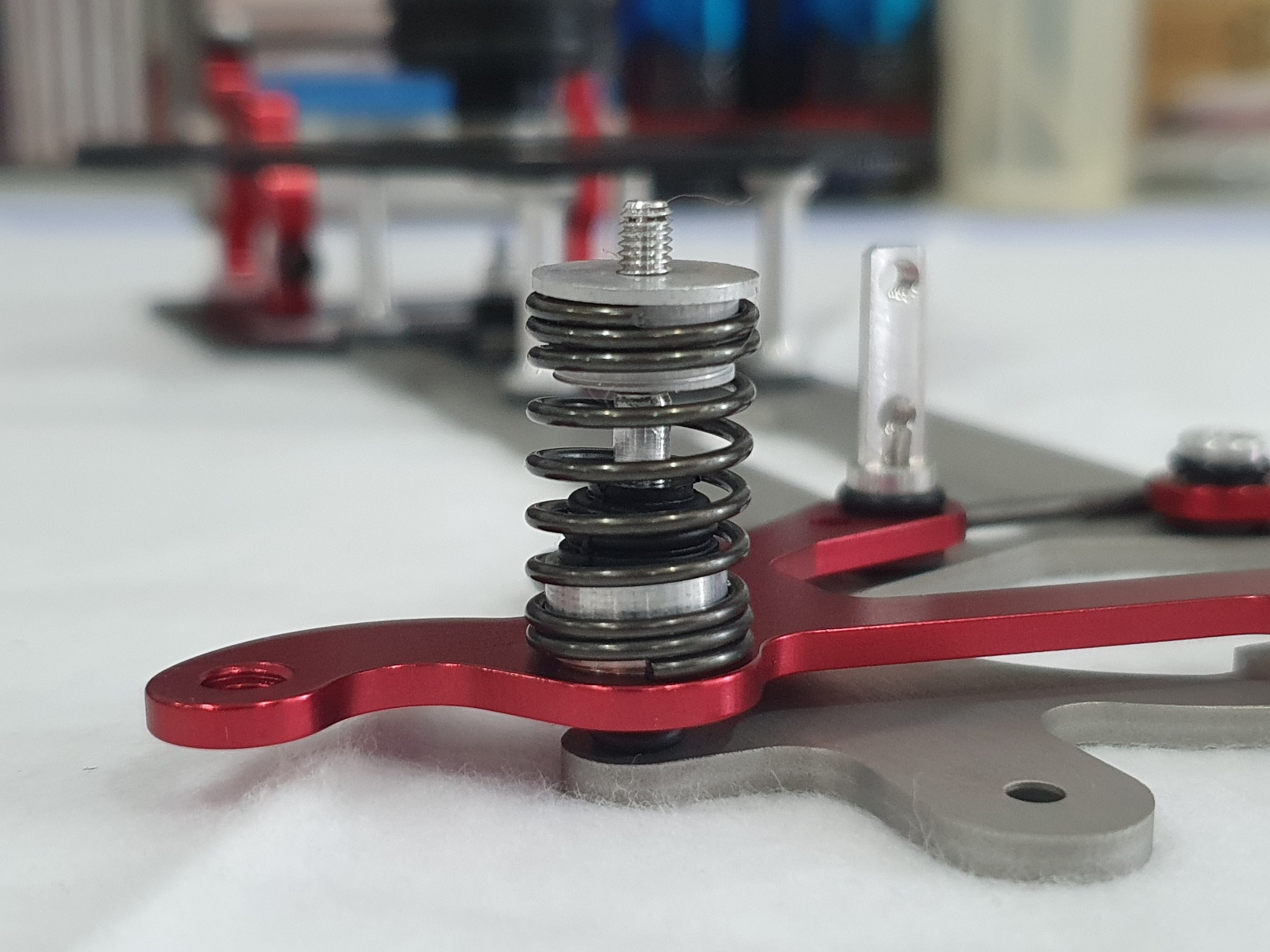

Group 5: Front springs and anti-roll bar
The springs are screwed into the threaded aluminium caps, the purpose for this shall be explained shortly. The spring perches that the springs will later screw onto are also threaded. The perches themselves are press-fitted to the A-arms.
With such a setup, the A-arms 'hang' from the spring caps, and therefore the droop of A-arms can be adjusted by turning the damper posts.
The anti-roll bar is connected to the A-arms from below. The connectors are held in place to the A-arms with small o-rings.

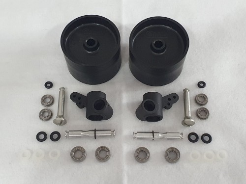

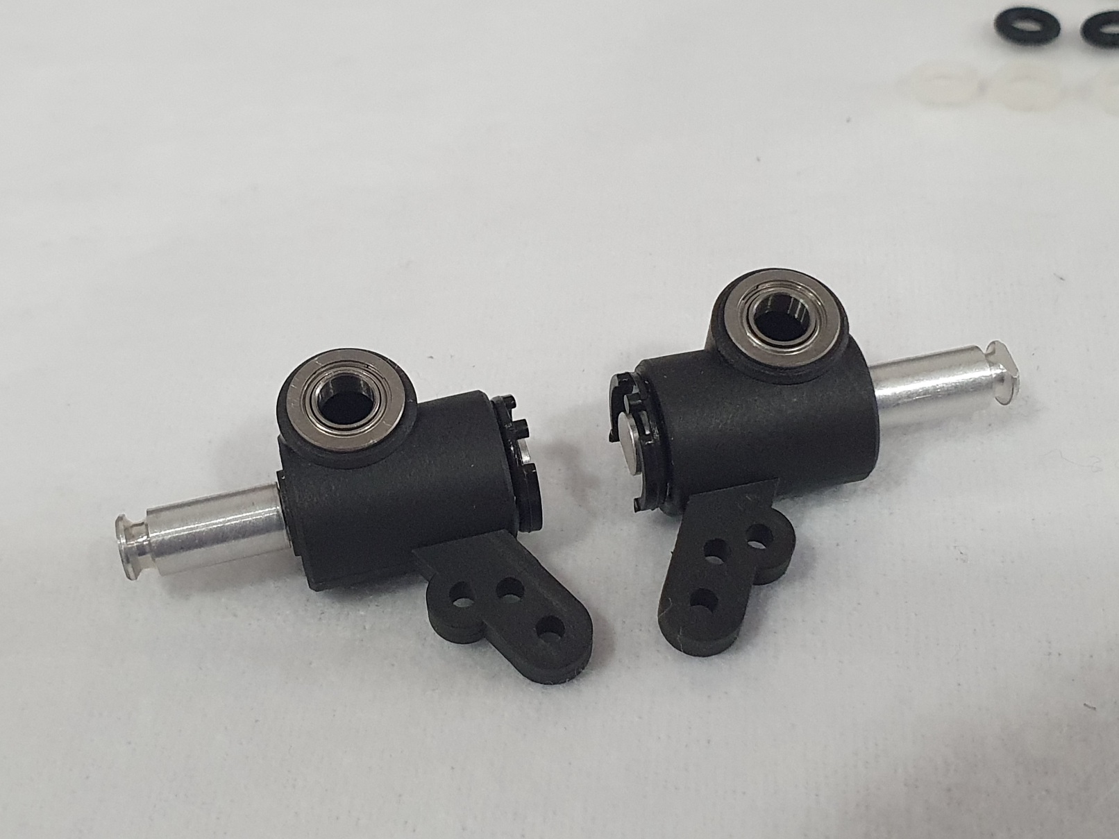

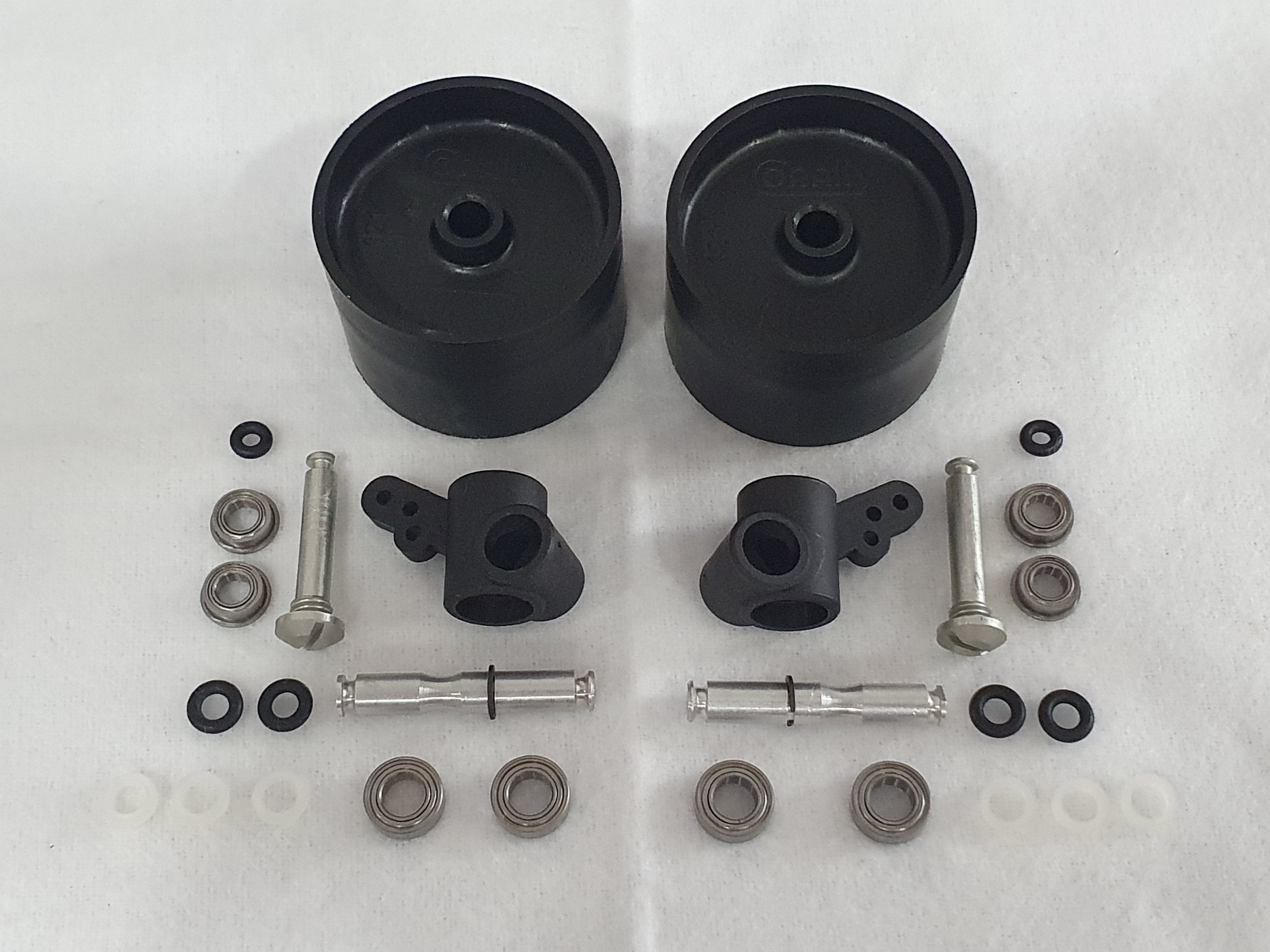

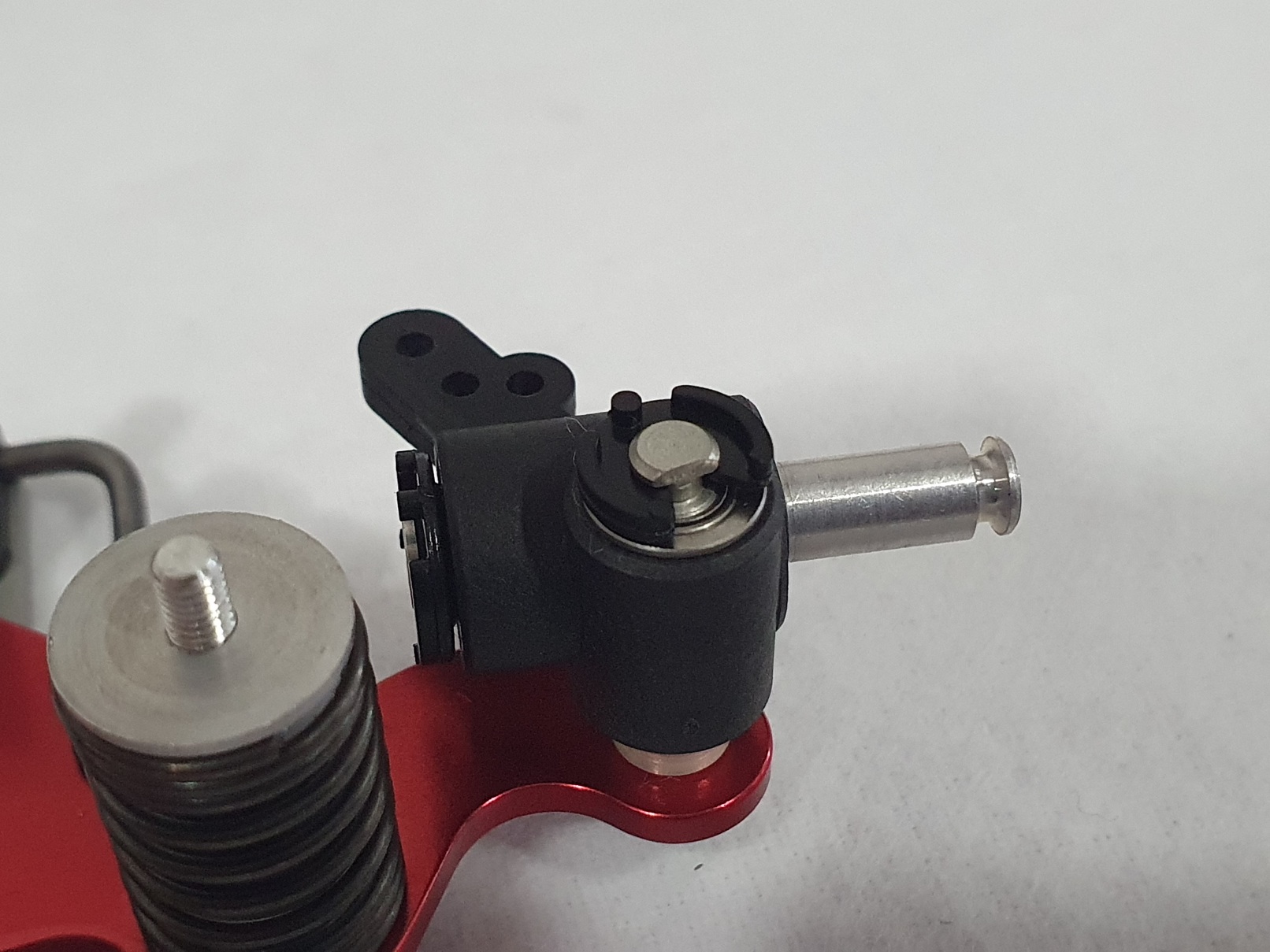

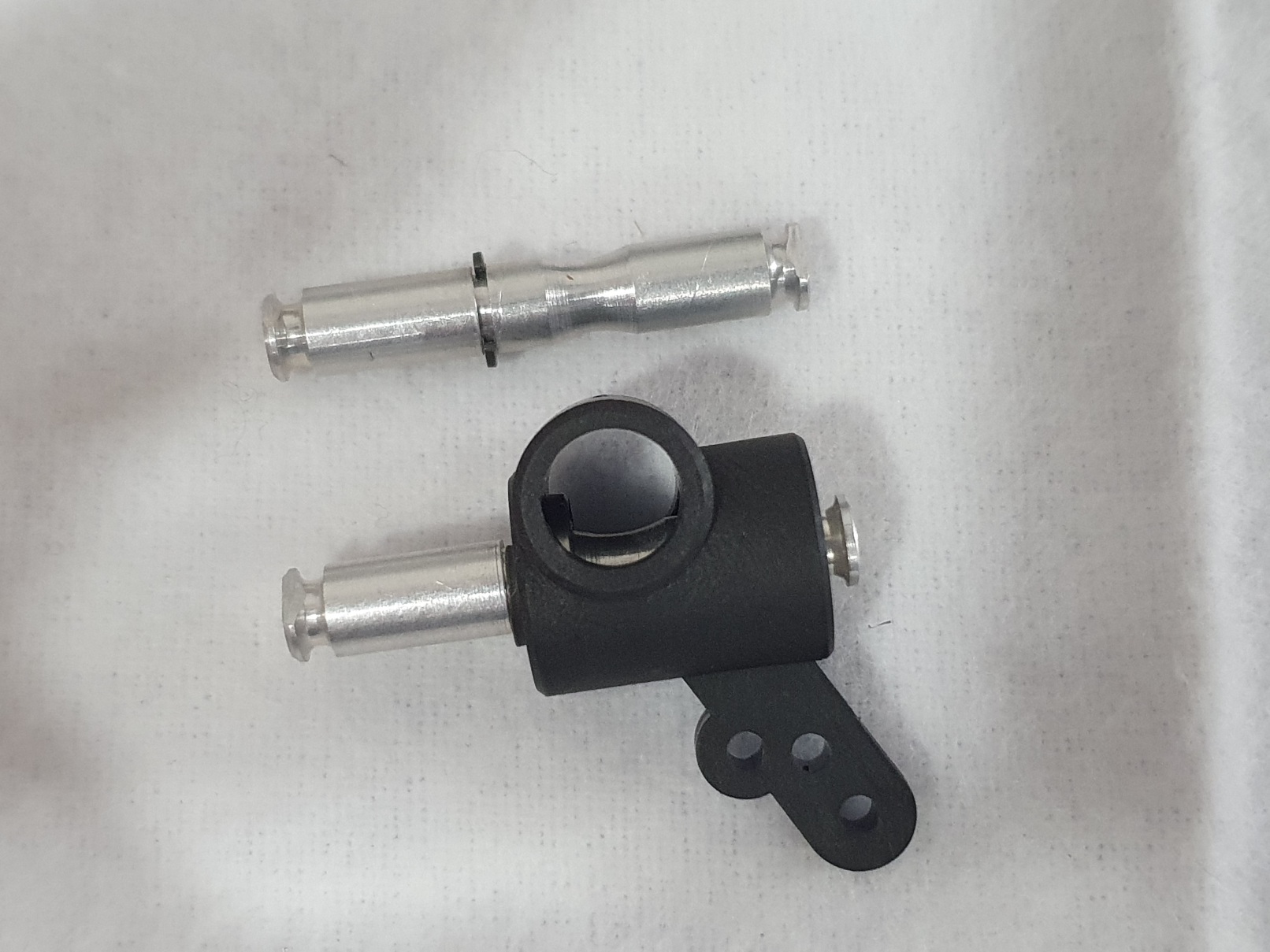

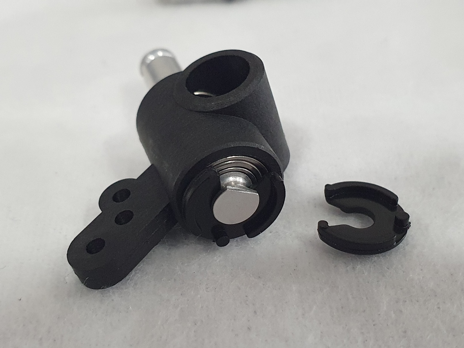

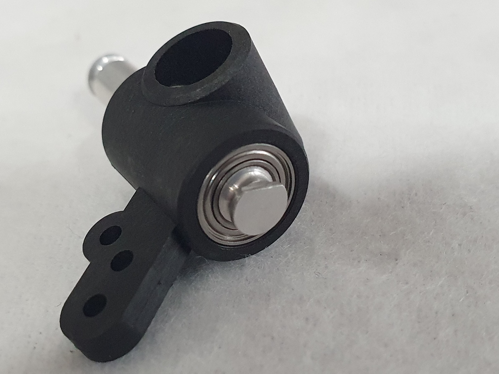

Group 6: Steering blocks & king-pins
Similar to the C car, the stub axle is shaved with a semi-circular recess to clear the king pin. However, instead of a stub axle, in the case of the PK Corally, you have a rotating axle to the ballraced steering block (the front wheel does not rotate on the axle). In order to minimize rotating mass the axles are made from lightweight aluminum.
The rotating axle is designed to be kept in place by o-ring, and you can see attention to detail in the notched flange of the axle that allows for easier o-ring removal.
However, rather than use o-rings this time, I opted for the plastic c-clips that came with later Corally cars. They are easier to remove than the o-rings.
The steering blocks have ball races also for the king pins.
The king pins are simply screwed into place on the A-arms. Translucent spacers allow for ride height adjustments. Again, instead of o-rings I used the c-clips for the king pins to retain the steering blocks.

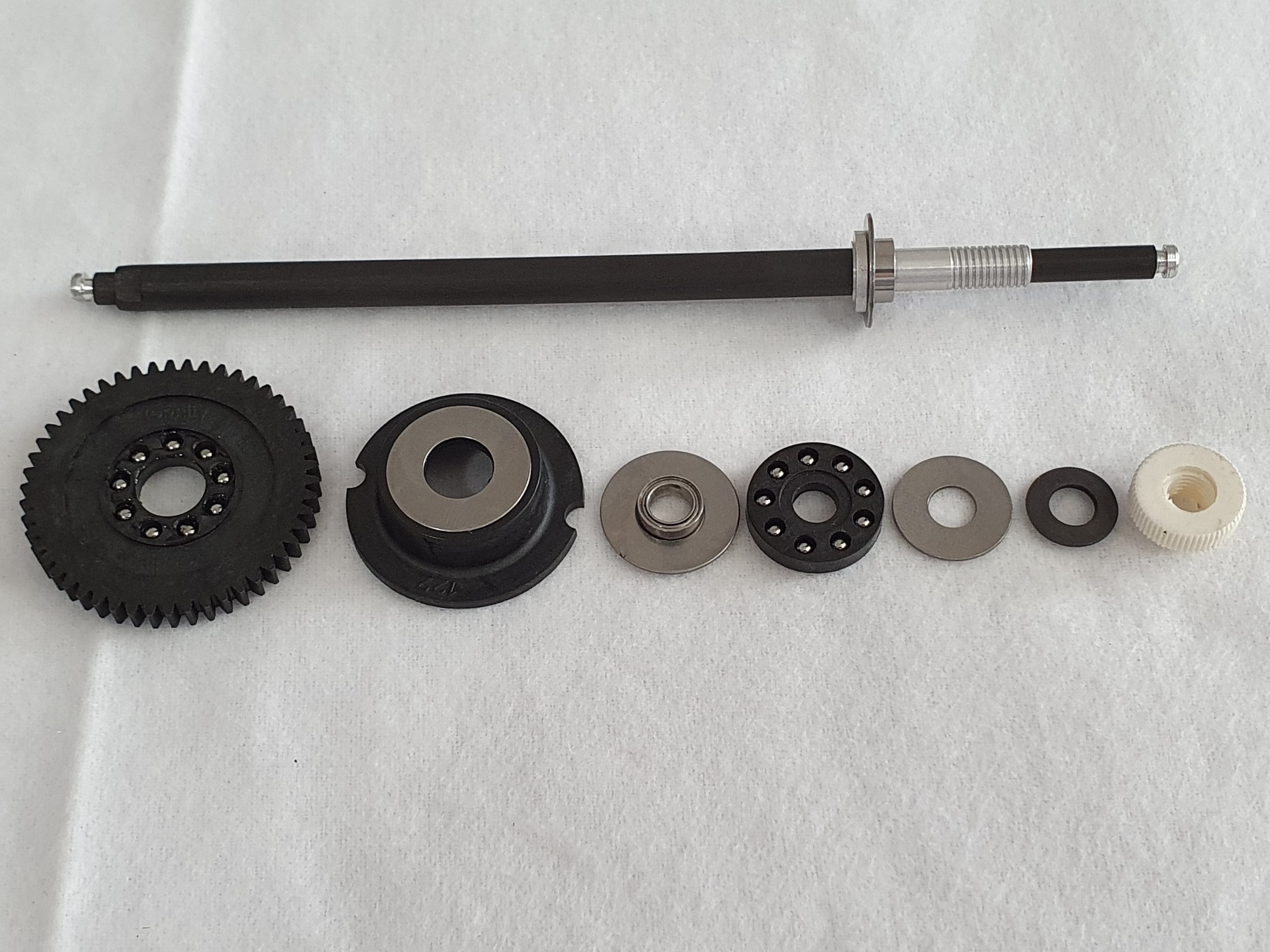

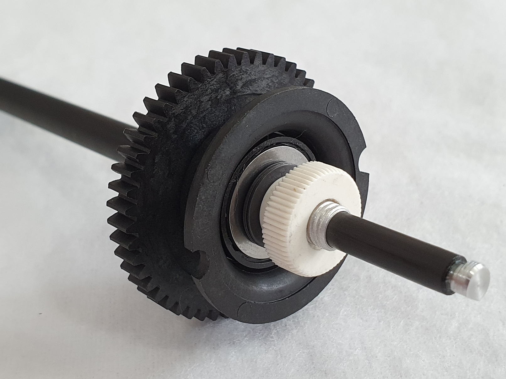

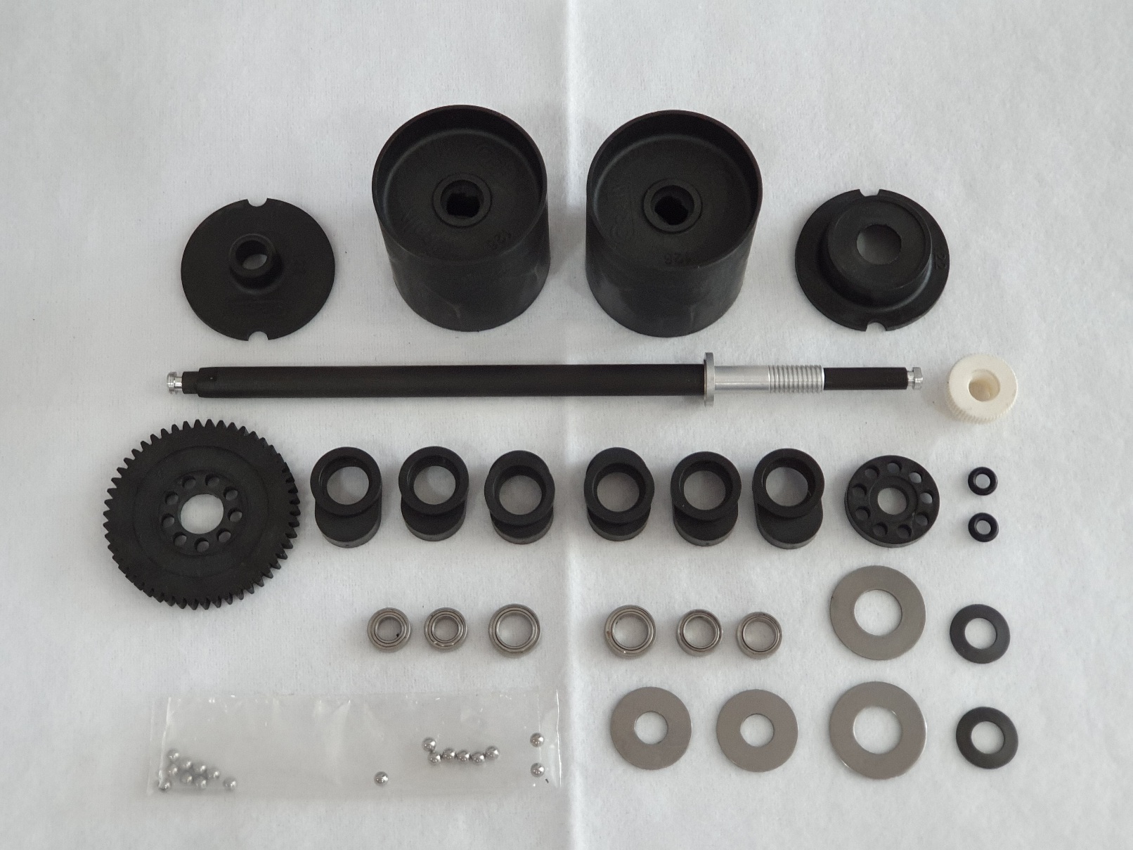

Group 7: Rear axle & differential
Unusually there are 4 rather than 2 diff washers. The spur looks to be 32P. I'll need to find a 32P pinion.
After assembly the whole diff unit looks well enclosed against debris.

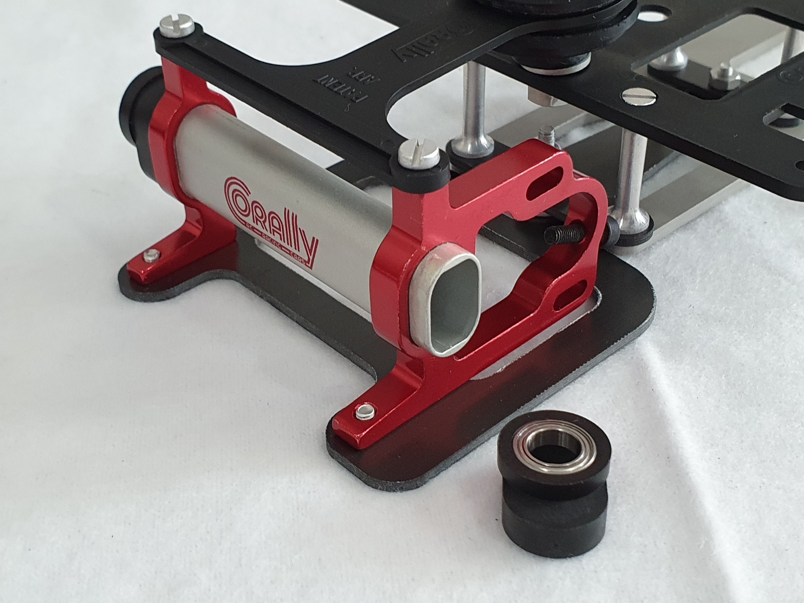

The ride height adaptors cap over the ends of the oval extruded tube of the motor pod and are easy to change out.
Rear diff and axle now installed:

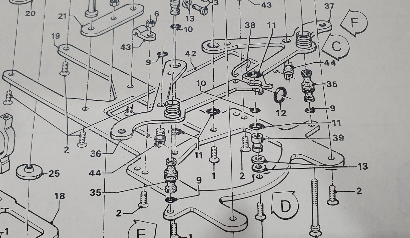

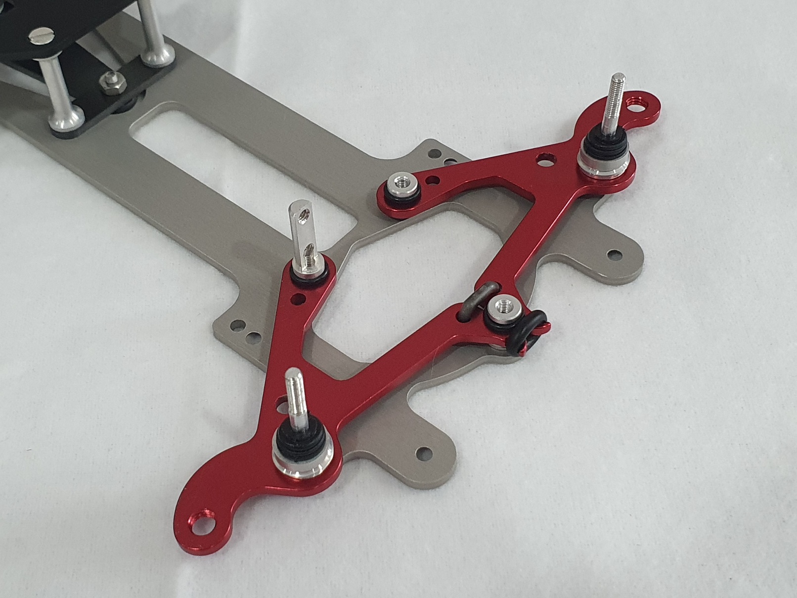

For the first time with this build I'm finding out some design revisions to this car.
Earlier PK Corallys had a chain-like element linking the 2 front A-arms, as can be seen in the following diagram, part #38.
In my kit however, part #38 takes the form of the letter 'U'. It would drop out when the car is flipped upside down. But then I realized it should fit from underneath the A-arms instead, with an added tab feature of the main chassis holding it in place.
