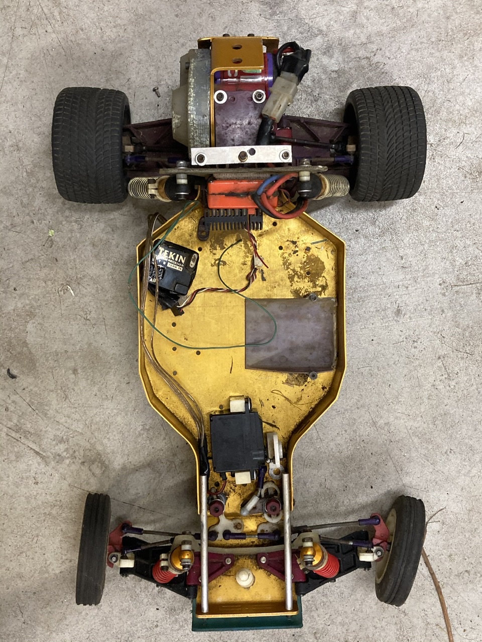

I bought this rc10 today and wanted to see what people think. The one question I had was if the slipper nut is tightened all the way down, and it still slips, what’s the problem? Any help is great.

Well that sounds right. The diff nut is tightened all the way and it still slips. Maybe the disks are dirty? And ideas on how to fix it? I would eventually like to drive it... it’s killin me!

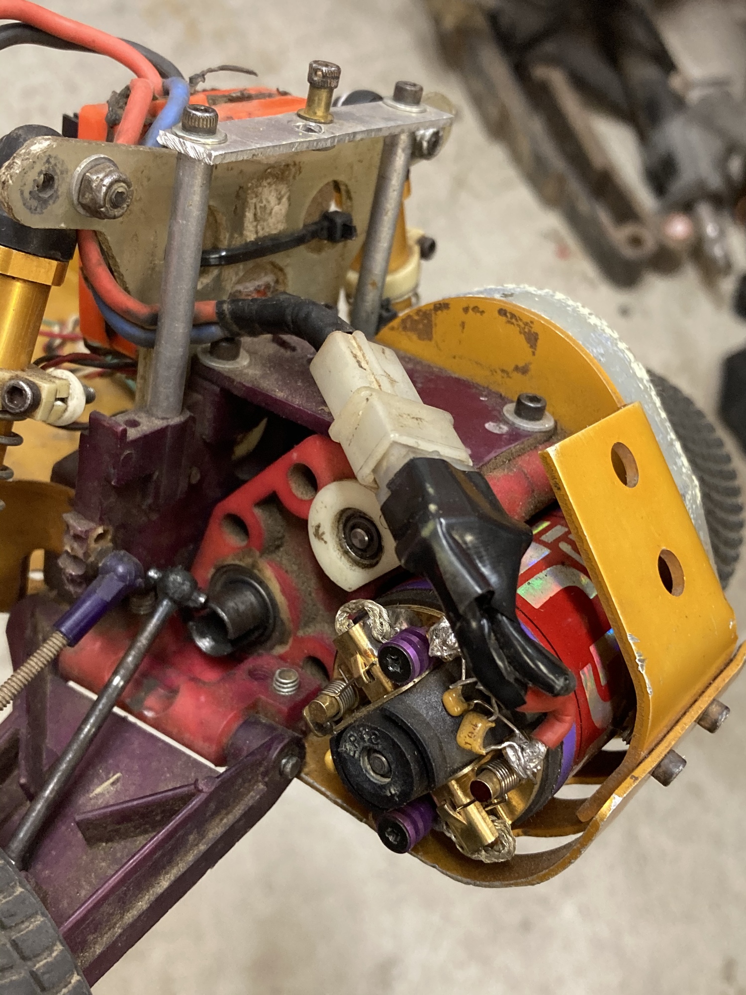

I'm looking at your last photo. Sorry if this sounds condescending but have you fix that displace left dogbone?
Also, it appears that the e-clip is missing from the end of the top shaft. I don't believe this will cause the transmission to slip but it could lead to other problems if the shaft is allowed to float sideways.

Re: My new ride
So I took her down the street for the first time today. Way faster than I thought. That EPIC motor has a lot of gettyup and go. Also cleaned the back half.
And the rear driveshaft that is loose in the picture keeps coming loose and I dont know how to fix it. They are driveshafts I have never seen before.

Re: My new ride
Universal Joint driveshafts?
Do you have them shimmed properly?
Do you have an RC10 Manual?
https://www.associatedelectrics.com/discontinued_item_downloads/

Re: My new ride
Hi,
Could be too much droop in the rear shocks?
Like RC10Resto said, the drive shafts look like the original Team Associated universal joints.
Cheers, Dave.
Cheers, Dave.
