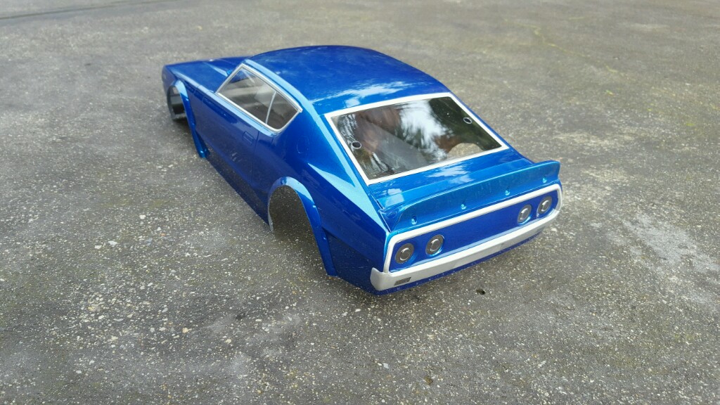

Thanks for the advice, I tried the window mask method you spoke about on my inferno mp777.
I must admit, I struggled to cut the lines evenly from the window mask. If you look at the picture below, I ended up going around the outside with a black sharpie pen to try and make it a bit neater, still not the best though.

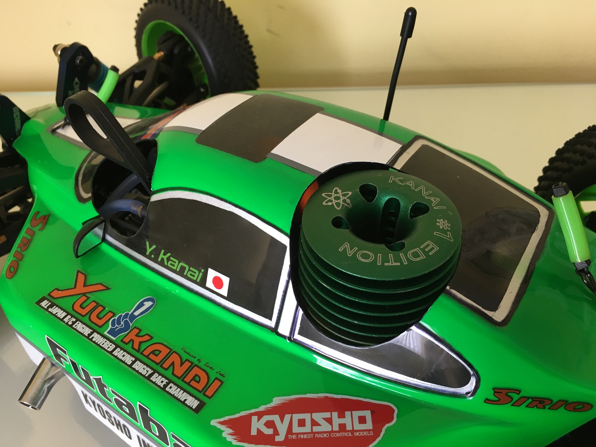

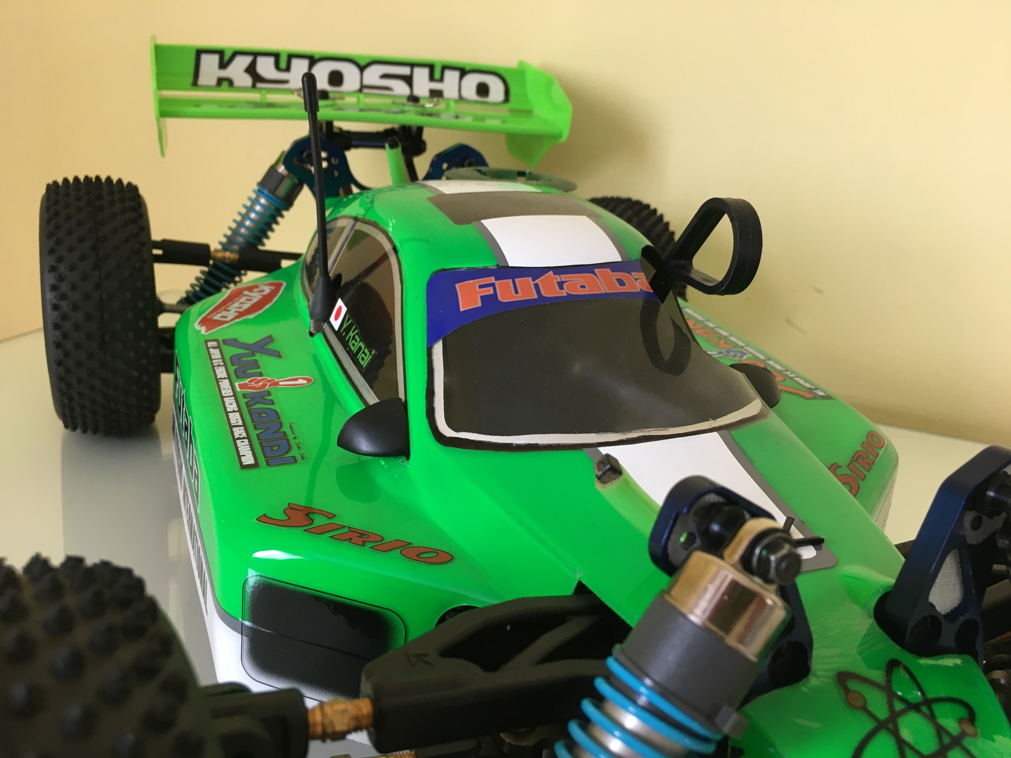

One easy amature trick is to cut it into the protective film on the outside of the body so you can follow the window lines.
- Posts: 64
- Joined: Fri Jan 19, 2018 9:25 am
- Location: Gateshead
- Been thanked: 20 times
Re: Window frames - best method
Looks good, does that mean you paint the window frame on the outside of shell.
