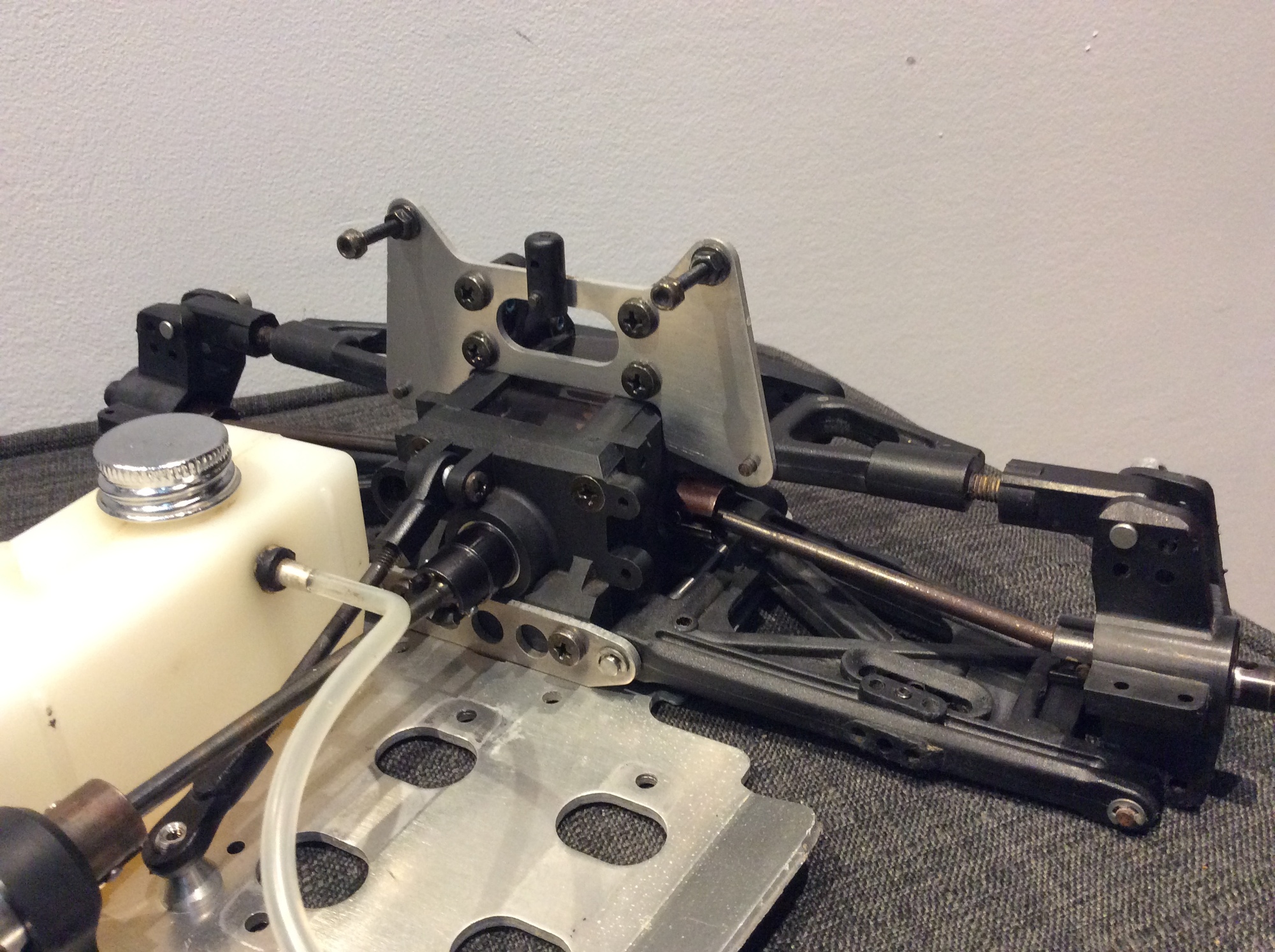

Made minor progress getting the chassis scrubbed down with soap and water and managed to get the diff cleaned and reassembled. It is binding a little and I think the right mount is warped possibly, assume due to heat under rotation? It seems to stick a little when I am rotating it.
Scrubbed down the fuel tank as best I could, got a little too aggressive and broke one of the rubber fuel lines trying to get the grime off but no matter, turned out pretty good all things considered.

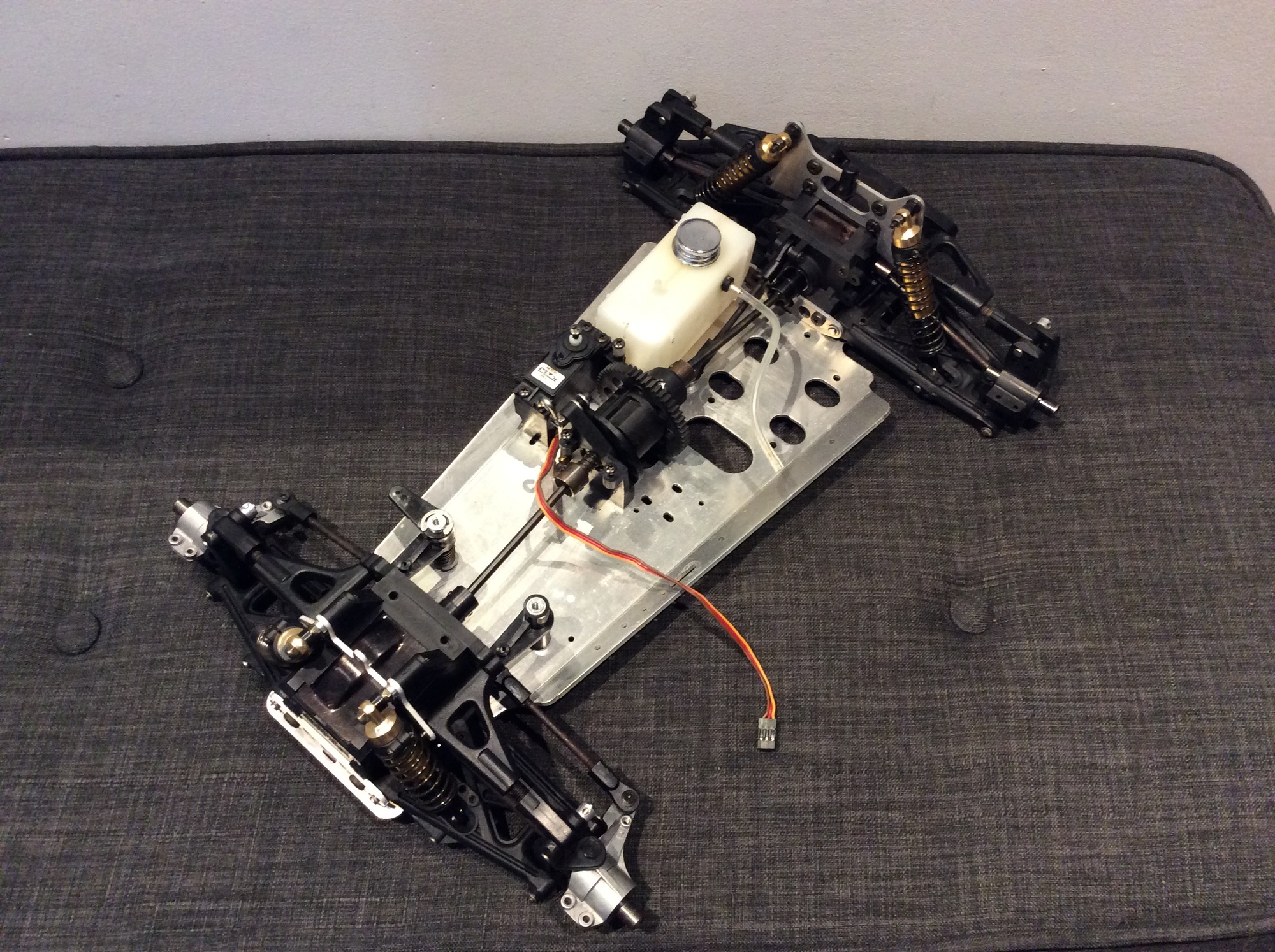

A little more progress made today, managed to lose a couple eclips into the void, either flying into the air or dropping into the carpet (the wife is letting us do craft night in the living room, she had no idea I was busting this bad boy out, she is not impressed lol).
The more I tear this car down the better shape it appears to be in, very little scuffs, a couple minor bent hinge pins but all in all the front diff teeth showed very little wear, underside of the arms are in great shape. The dog bones do have some rust and are soaking in some wd-40...has anyone ever sanded them down and sprayed them before or should I just well enough alone?

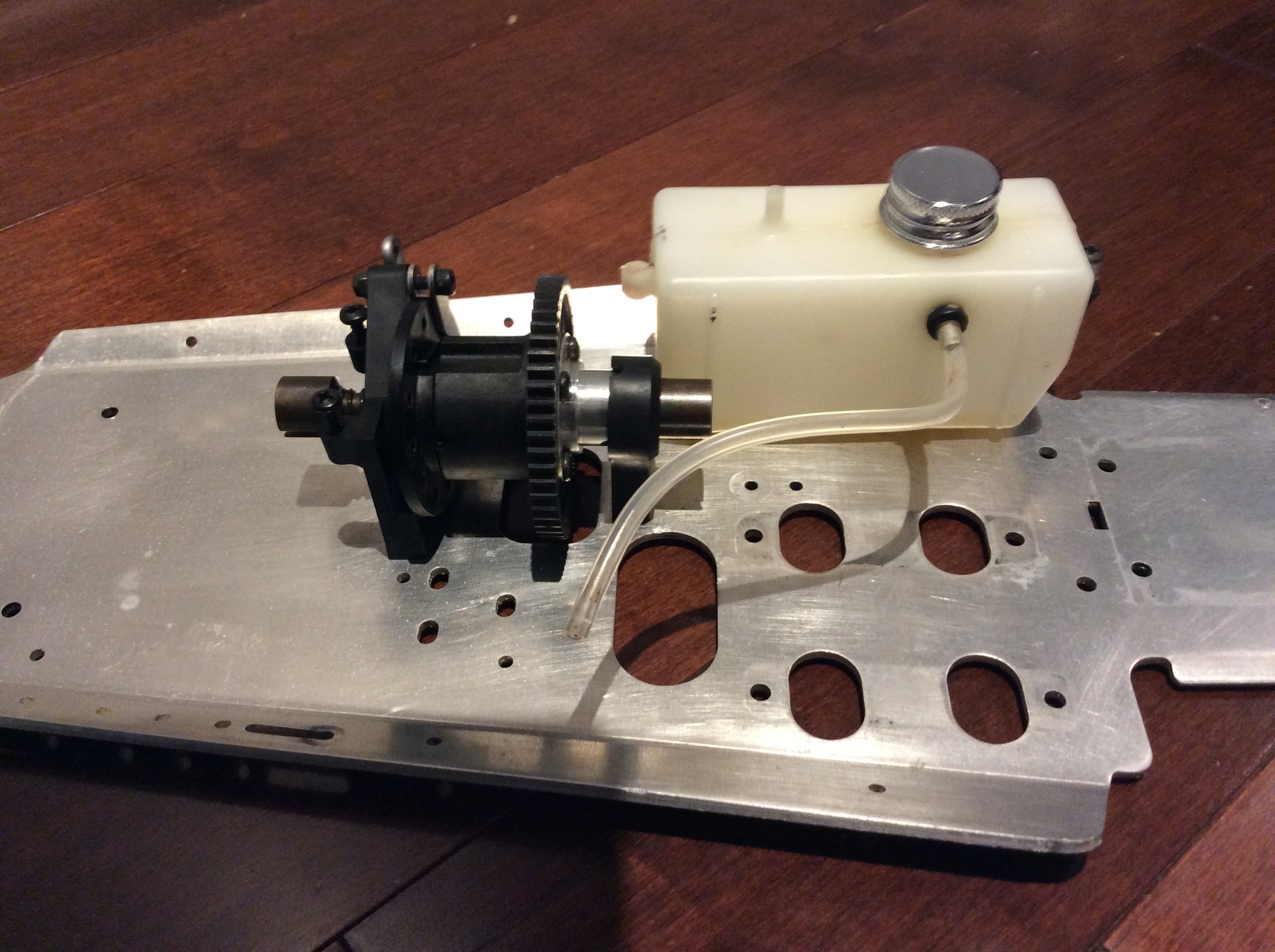

Minor update with the rear diff disassembled, inspected, cleaned and reassembled. Absolutely love how this one is coming together... :D

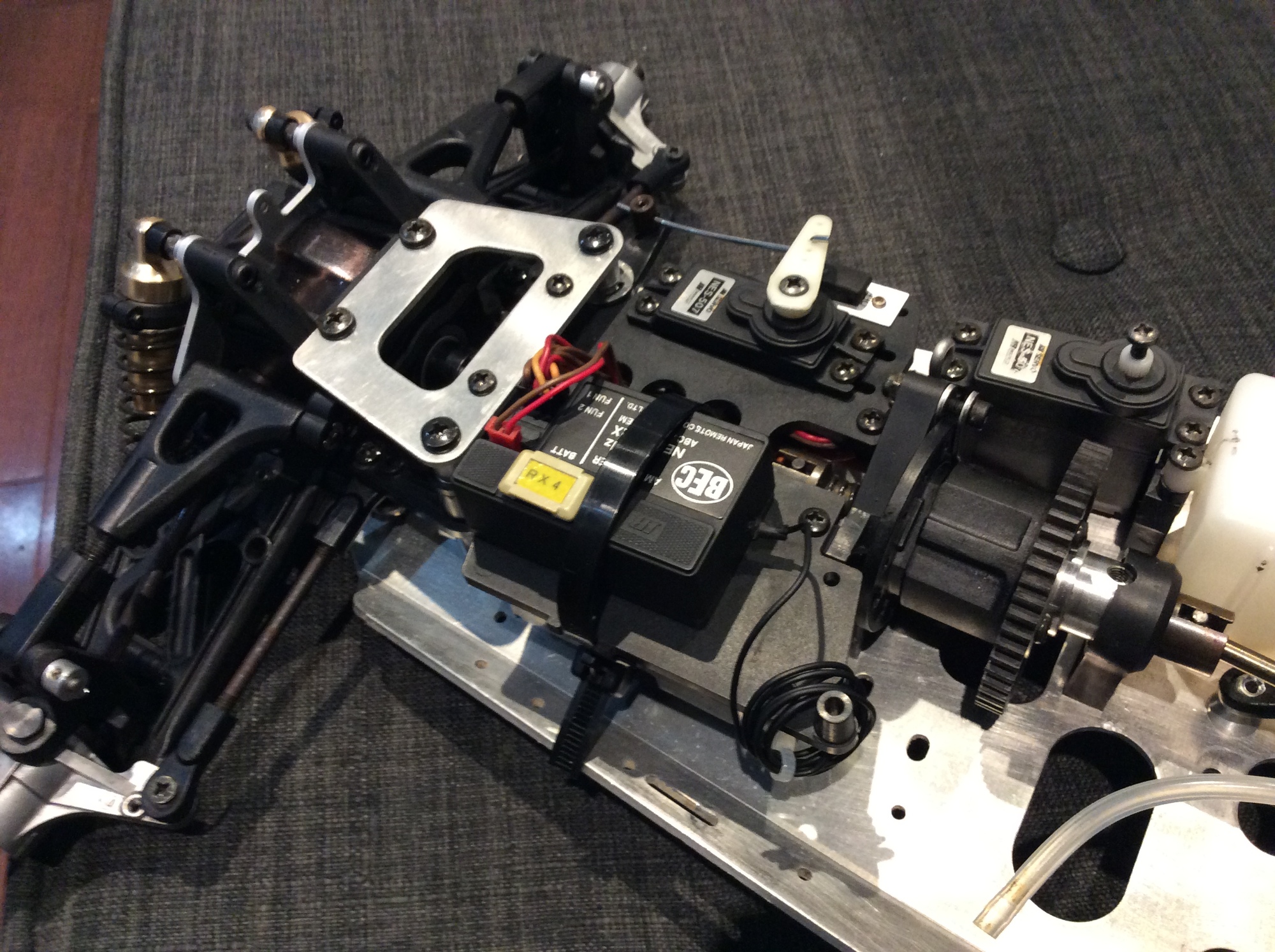

Hello all, the engine wouldn’t budge and I didn’t want to force it with the flywheel too hard so I put it aside for a bit and tackled the electronics...

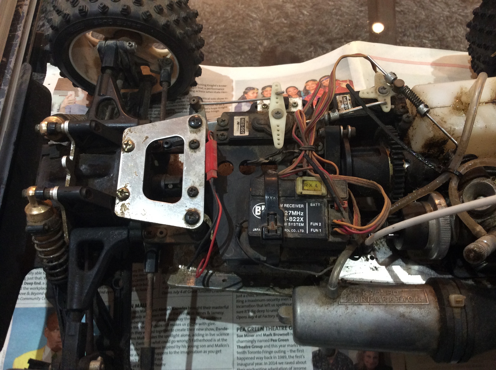

Buttttt I couldn’t help myself and I started tearing the engine down, starting with whatever would come off easily...essentially it is locked up with what I can only imagine is super old fuel, super sticky globs of brown goo everywhere, in everything and it does not wipe off/away easily...
Once it was opened up and the heat sink was off I discovered the cylinder sleeve was loose enough to remove...slowly...but the piston had zero play and was seemingly locked in place. Removing the back cover and taking a look inside where the crankshaft connects to the connecting rod was in bad shape, almost like it was rusted/rusty, the whole round circular plate was in bad shape. The one bearing that was in view also looked to be in poor shape HOWEVER once the piston/connecting rod were out it slowly started to budge.
The engine is stamped with OS Max RF on it, was this one of the first .21 buggy engines they produced?
