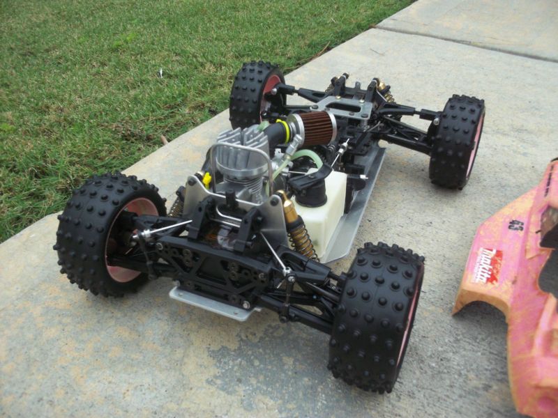

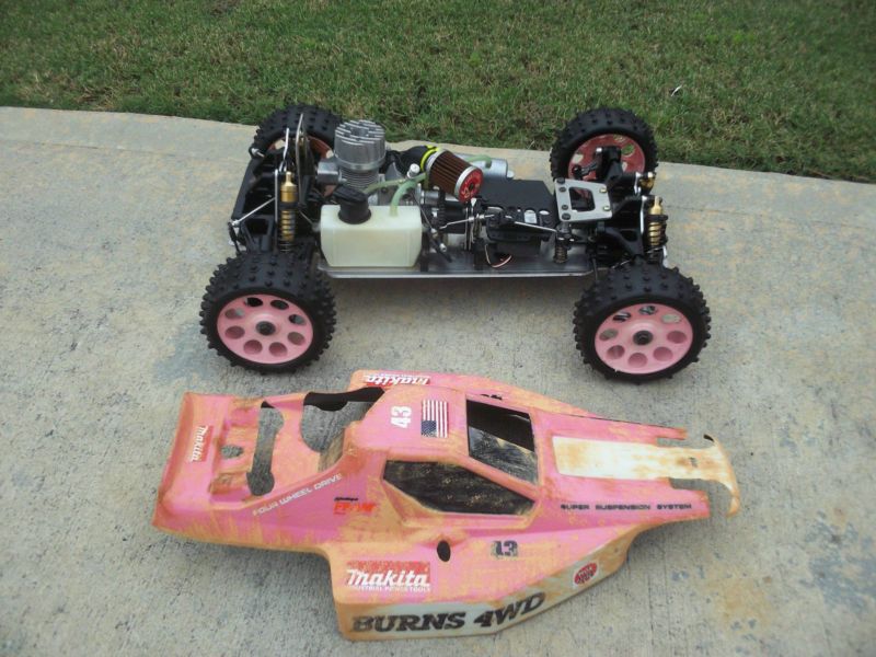

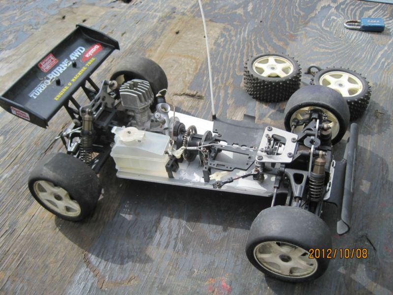

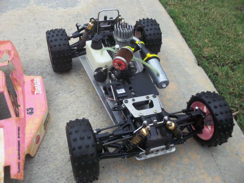

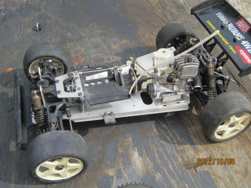

Ok so I have a new passion and wanted to share this madness with the rest of you.
I have been thinking of giving the 1/10th thing a rest and would like to build a few old Kyosho 1/8 4WD cars and convert them to brushless.
The concept is simple, there's no racing or track work for these cars but rather I want to set these cars up for fun and drive them at the park with my sons as they grow older. I figured the 1/8th buggies are a little tougher than their little 1/10th brothers so the idea is to have a few cars that will present fewer problems and allow for more 'fun time' rather than down time being repaired. Add to this I am a big fan of the original 'BURNS' body design and can see a few 'vintage' paint schemes ready to go onto fresh shells (box art OPTIMA anyone :wink: )
I am currently in talks with another member here who will help me with a 3rd car to complete the set :mrgreen:
So here are the first two cars just paid for on ePay.
BURNS. (bought for $169 + shipping)
TURBO BURNS. (bought for $139 + shipping)

The challenge is, again, that the 8th BL motors are crazy powerful. in 2wd 10th, you can drop in a modern (reasonable) BL in pretty much any chassis from the late 80's and more recent and still get away with it. In 8th, with the extra weight, the transmission gets considerably more sollicitated. I'd be worried about the BL + vintage 8th cocktail.
IF you still go ahead, the challenge will be the motor mount. The newer 8th scale motor mounts are pretty technical and in most cases are interdependent with both the center diff mounts and chassis.

Great project JM :D I know you had one of these before but perhaps I can chime in and assist.
In regard to the tyres, the wider rears are hard to get these days (so too the front for that matter) so I would recommend getting a set of MP5 or Inferno rims (as they have the same fitment on the drive hex) and run modern rubber (Schumacher have a great set of grass tyres called the spiral cut if you intend to run the car at a park). Different width tyres were used by other manufacturers as well like BMT and Mugen in the early days.
Another thing to be mindful of is that the body shells are not interchangeable between the Burns and the Turbo Burns as they have different shock towers. Repro 1/8 body shells are available from Marwan or TBG.
If you did not already know the Turbo Burns you have there has an optional front brake system and a metal spur gear. Let me know if you do not want to use the front brake system and wish to get rid of it.
The drive train of a 1/8 buggy is pretty darn strong (compare the old drive shafts to modern 1/8 buggies) but the spider gears of old were also made of cast iron and were prone to very fast wear rates. I believe the Burns were pre silicone filled diffs and relied on a very heavy grease to keep it lubed (rather than to alter drive characteristics) so keep an eye on them.
Hope this has been helpful to you, I used to race and collect 1/8 buggies (I too have a Turbo Burns btw) so if there is anything more you wish to know feel free to ask away.

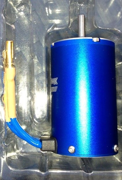

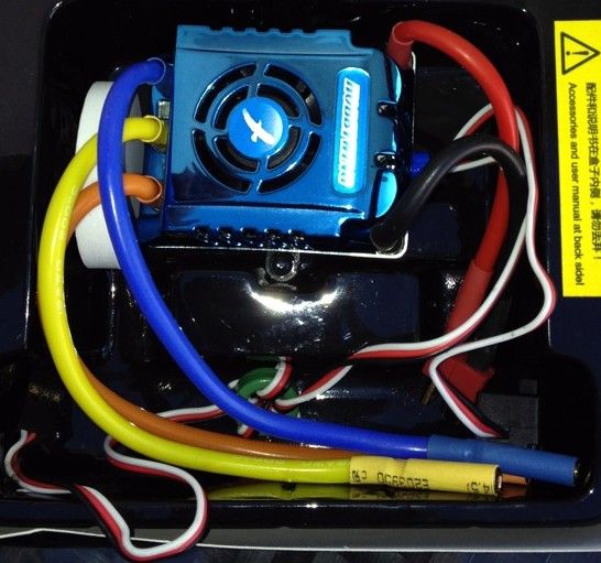

I just purchased this Xerun esc and 2250KV motor unit. Should be with me in a few days. Looking forward to getting these cars going :mrgreen:

J.M. wrote:I just purchased this Xerun esc and 2250KV motor unit. Should be with me in a few days. Looking forward to getting these cars going :mrgreen:
Too much HP for the old lady... even in modern 8th scale BL standards this is considered too much... ;)

Bormac
Posts: 3113
Has thanked: 20 times
Been thanked: 11 times
Re: Project 'BURNS' ELECTRIC!!!
Post by Bormac »
It's all going to be a bit of a steep learning curve for me Paul. I purchased these items cheap so I figured -hey'.
Maybe I'll just de-tune it via throttle profiles?
-Jason.
