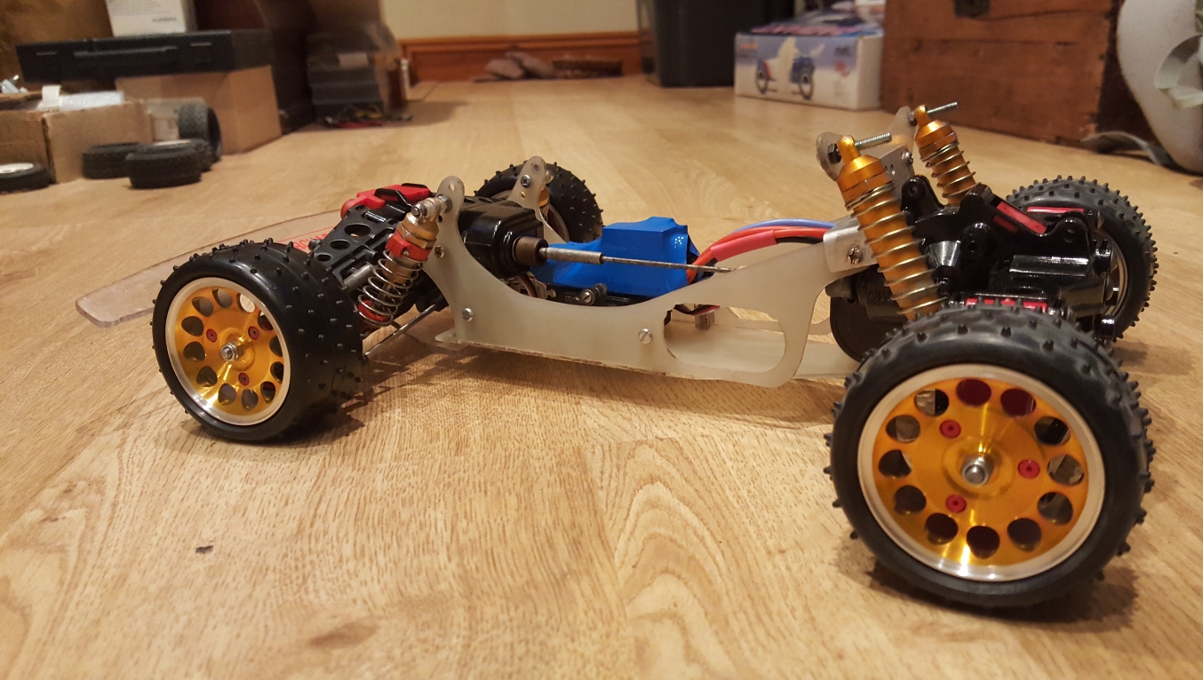

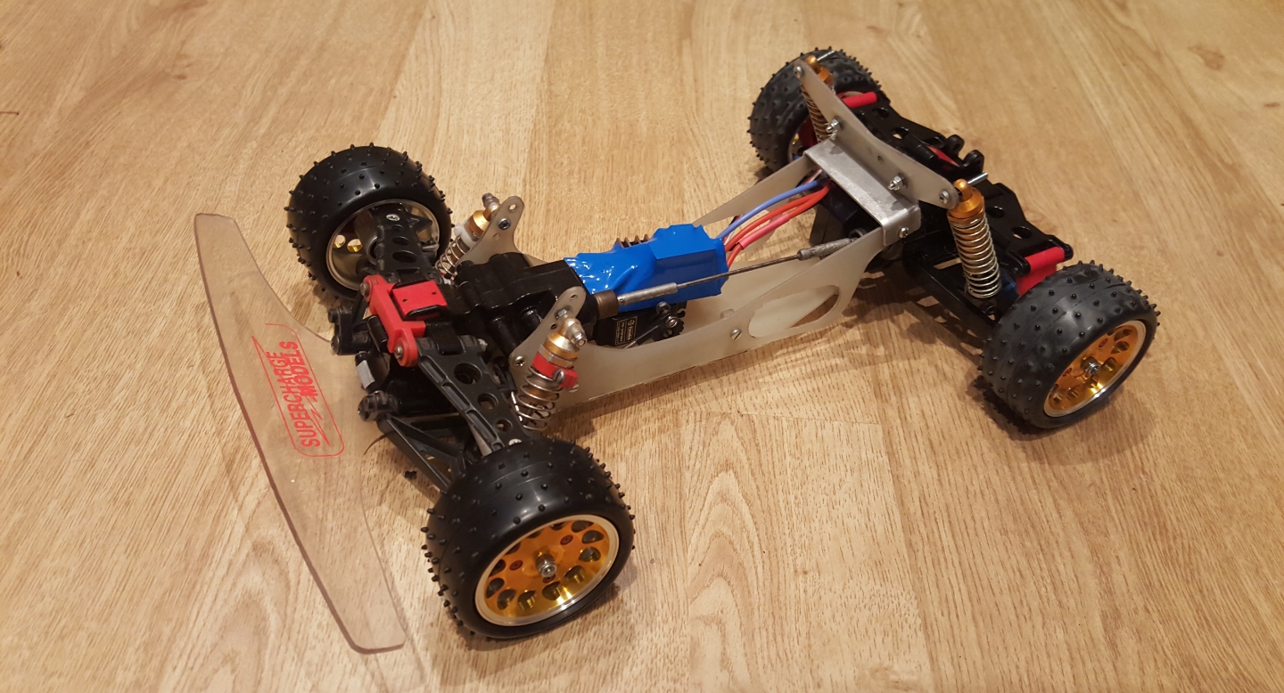

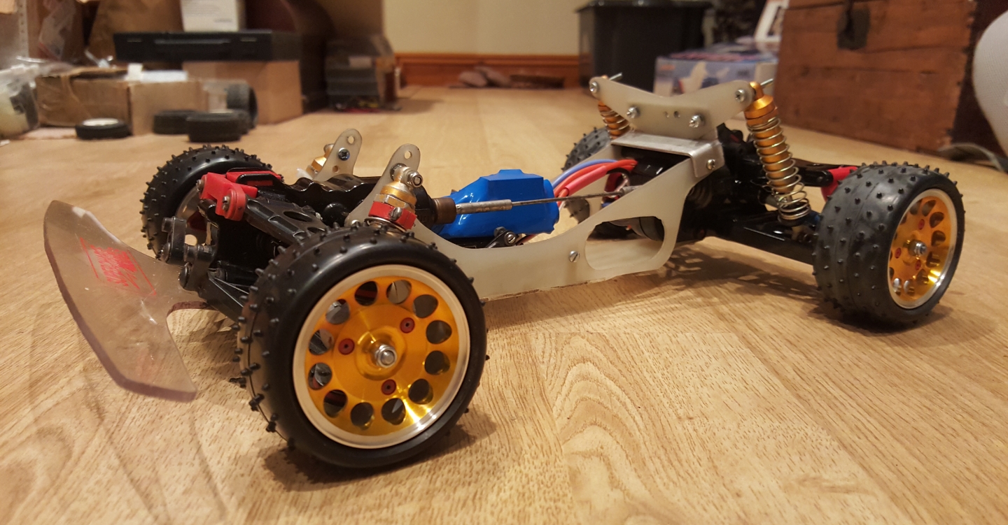

Bit of mock up progress.

- Posts: 4069
- Location: Guildford UK
- Has thanked: 2757 times
- Been thanked: 2250 times
Re: 1986/87 Supercharge Hotshot
That's looking very nice , my memory is that both my own hand made chassis that was quite thin and the thicker TMS version i had later both flexed a fair bit but it never seemed to be bad for the handling and may have improved it , i certainly thought the flex helped at the time but i was at most 15 when i was racing so ....
One major difference with this chassis and the others is the sides only mount to the rear gearbox on the forward mounting posts , not the ones further back with a spacer as well, i doubt it makes much difference as it mounts in a nice triangle .

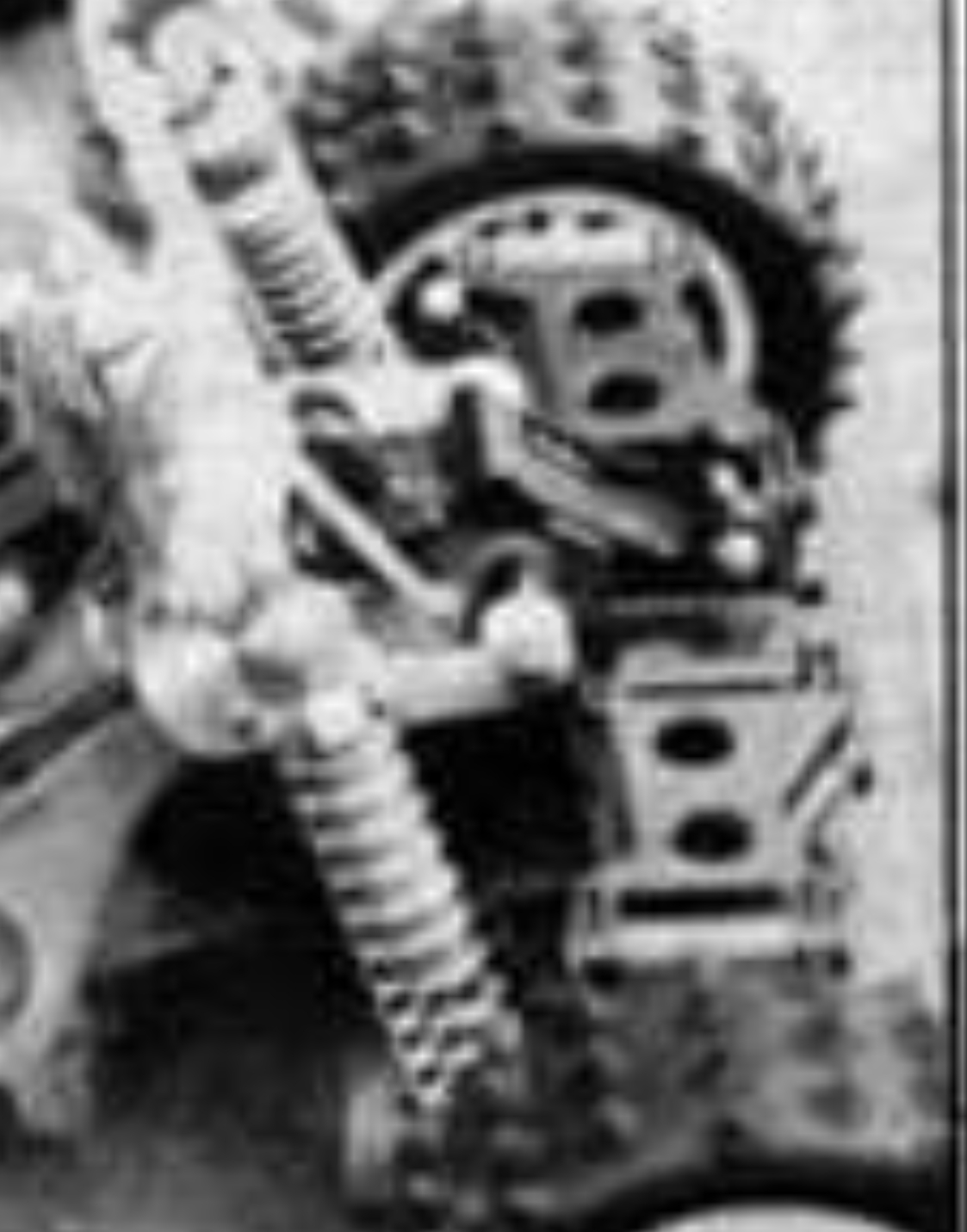

There is some flex. The FTD chassis i also have is thicker and stiffer.
I still have to add the rear support to the tail gearbox holes. In the black and white pics it actually looks like some sort of ball joint set up, but hard to tell.

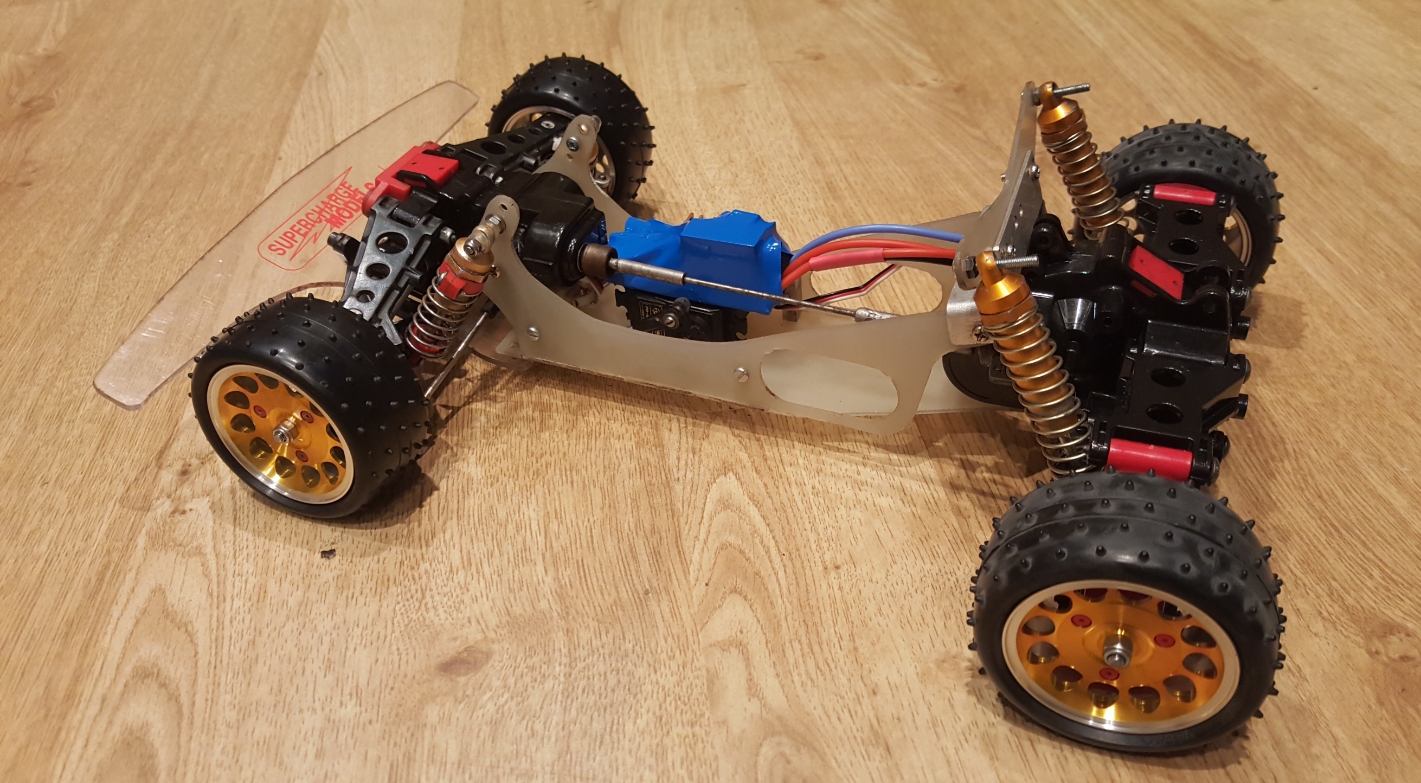

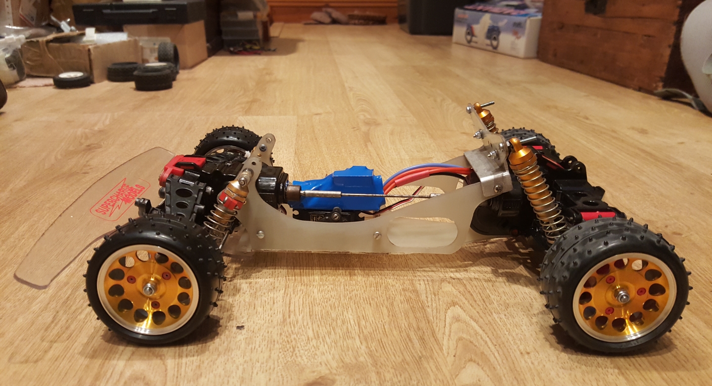

- TRX-1-3
- Posts: 2070
- Has thanked: 2066 times
- Been thanked: 992 times
I've probably missed somthing or haven't read closely enough, but how is that rear shock angle compensated for? Seems like there would be a helluva bind at the lower (or upper) mount unless it's got some serious (or no-joke) ball mounts.
Shock to the balls?
Shock to the balls?
- dinglem
- Posts: 1391
- Location: Lichfield, UK
- Has thanked: 248 times
- Been thanked: 682 times
Lower mount is on an angled metal bracket with a ball behind it. It actually works really well. Very smooth. The upper mounts have silicon tubing withing the upper cap hole (same on the fronts) which allows for smooth articulation throughout suspension travel. Actually quite effective.

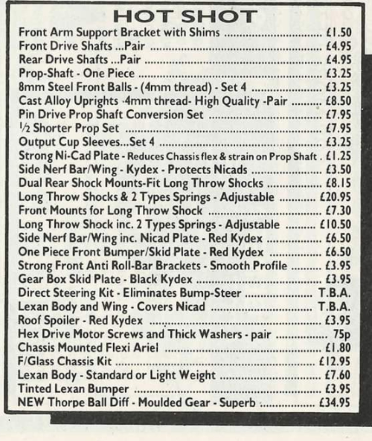

Period advert from May/June 1986 Radio Race Car date-proving the Thorpe Hotshot diff availability.
