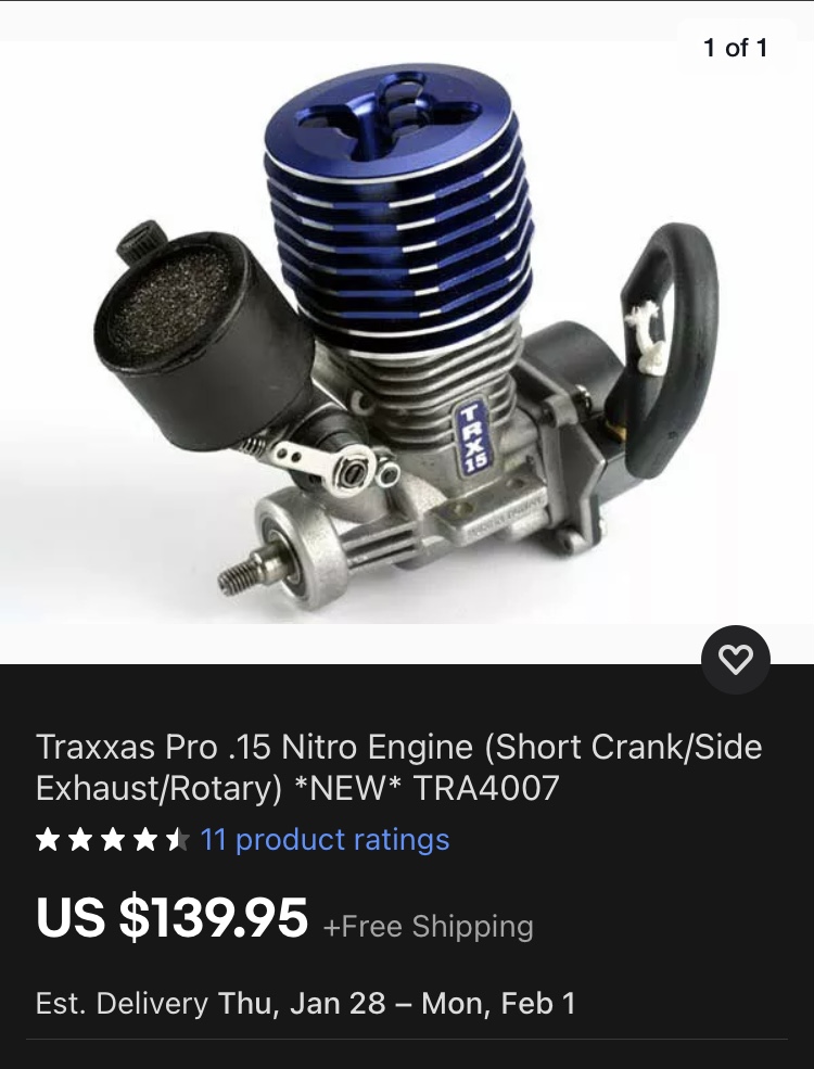

Ebay is your best bet to find replacement parts as most are discontinued and no longer in stock at any hobby store. Any .12-.18 side exhaust, standard crankshaft, rotary carb will be the easiest route. If you can find a Traxxas TRX .15 with the trimmed crank already that’s the easiest. Good reliable engines too. Traxxas also makes a decent (blue) side exhaust manifold and muffler combo easily found on eBay for a decent price. Lastly is the clutch which may take a short while to find but not that hard at all.
Edit: couple screenshots of an easy to find and reliable engine, muffler setup

As Romulus22 mentioned the Traxxas TRX .15 is a perfect drop in for the GT...or in my case a DS. Everything attaches easily.
Some may think a traxxas in an associated car is blasphemy....If you wish to use something different you can also search ebay for "Thunder Tiger EVO-12X High Performance Model Car Engine 9465", currently they go for about $82 bucks.
its a .12 engine and comes with a short crank ready for a GT or DS (glow plug not included). At one point in the past associated offered their kits with either a Yokomo, OS, Dynamite or Thunder Tiger engines.
