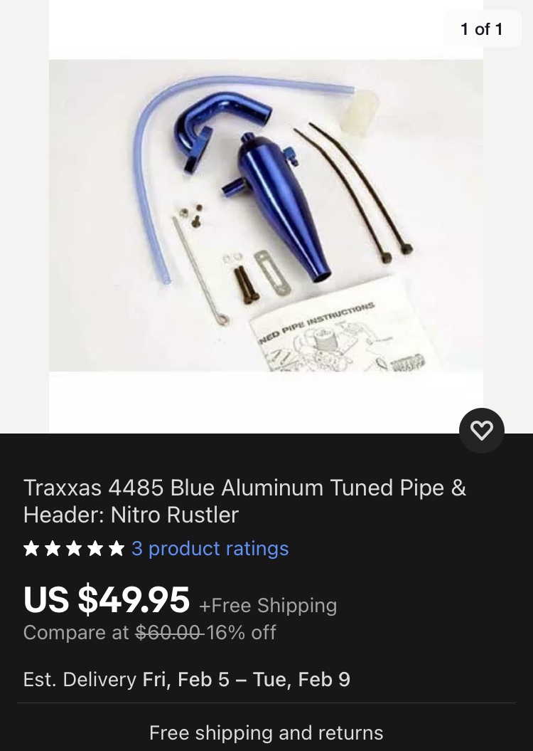

Ebay is your best bet to find replacement parts as most are discontinued and no longer in stock at any hobby store. Any .12-.18 side exhaust, standard crankshaft, rotary carb will be the easiest route. If you can find a Traxxas TRX .15 with the trimmed crank already that’s the easiest. Good reliable engines too. Traxxas also makes a decent (blue) side exhaust manifold and muffler combo easily found on eBay for a decent price. Lastly is the clutch which may take a short while to find but not that hard at all.
Edit: couple screenshots of an easy to find and reliable engine, muffler setup
