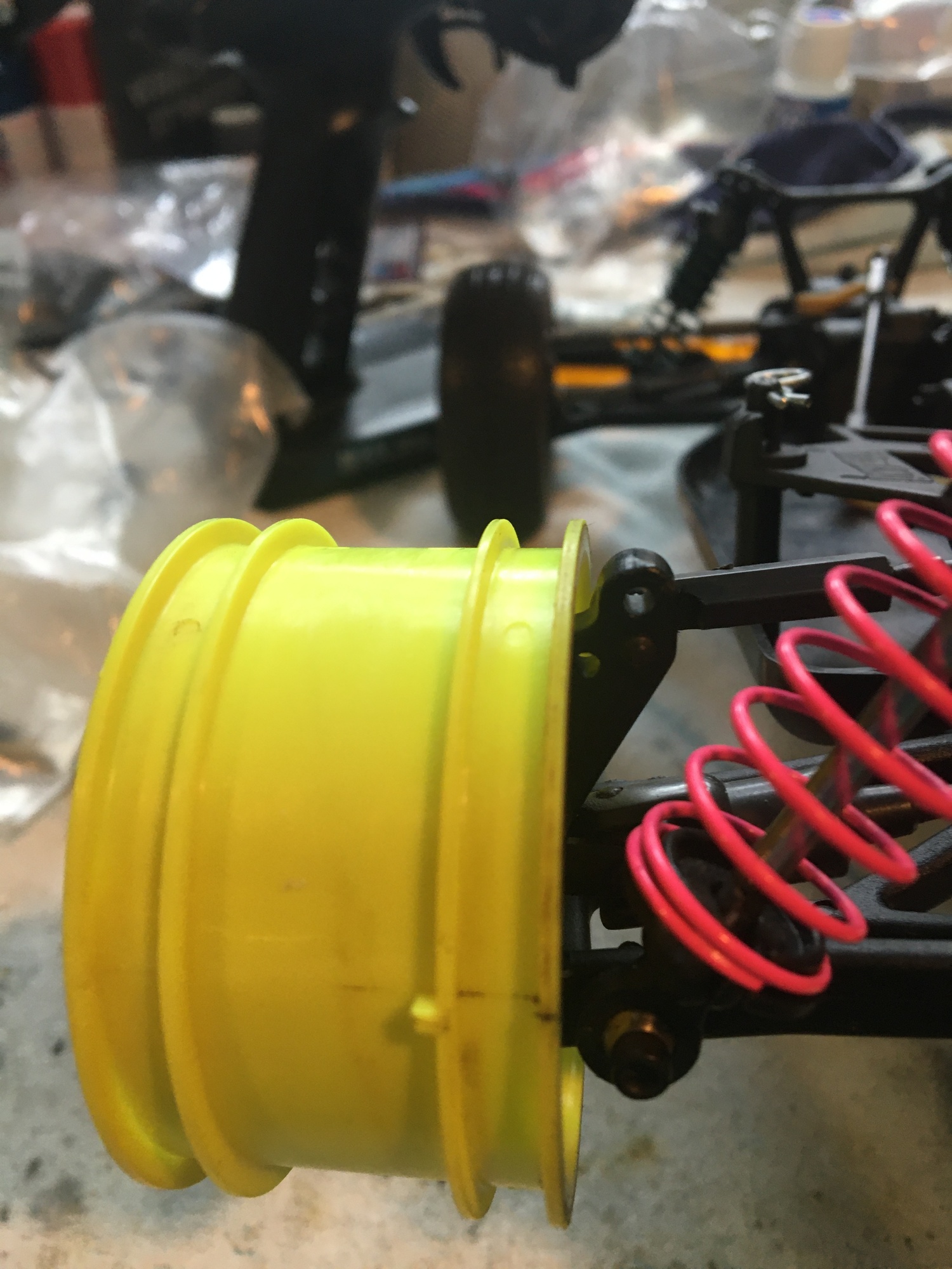

Are all the rear wheels for XX, XX-4 and XXX compatible? I just got an XX-4 and I have part # A-7141 yellow 5 spoke rear wheel which fits as it should but I just got part A-7105 rear wheel white and A-7105 is up against the rear hub and doesn't reach the 1/16" pin. Sorry for the beginner question

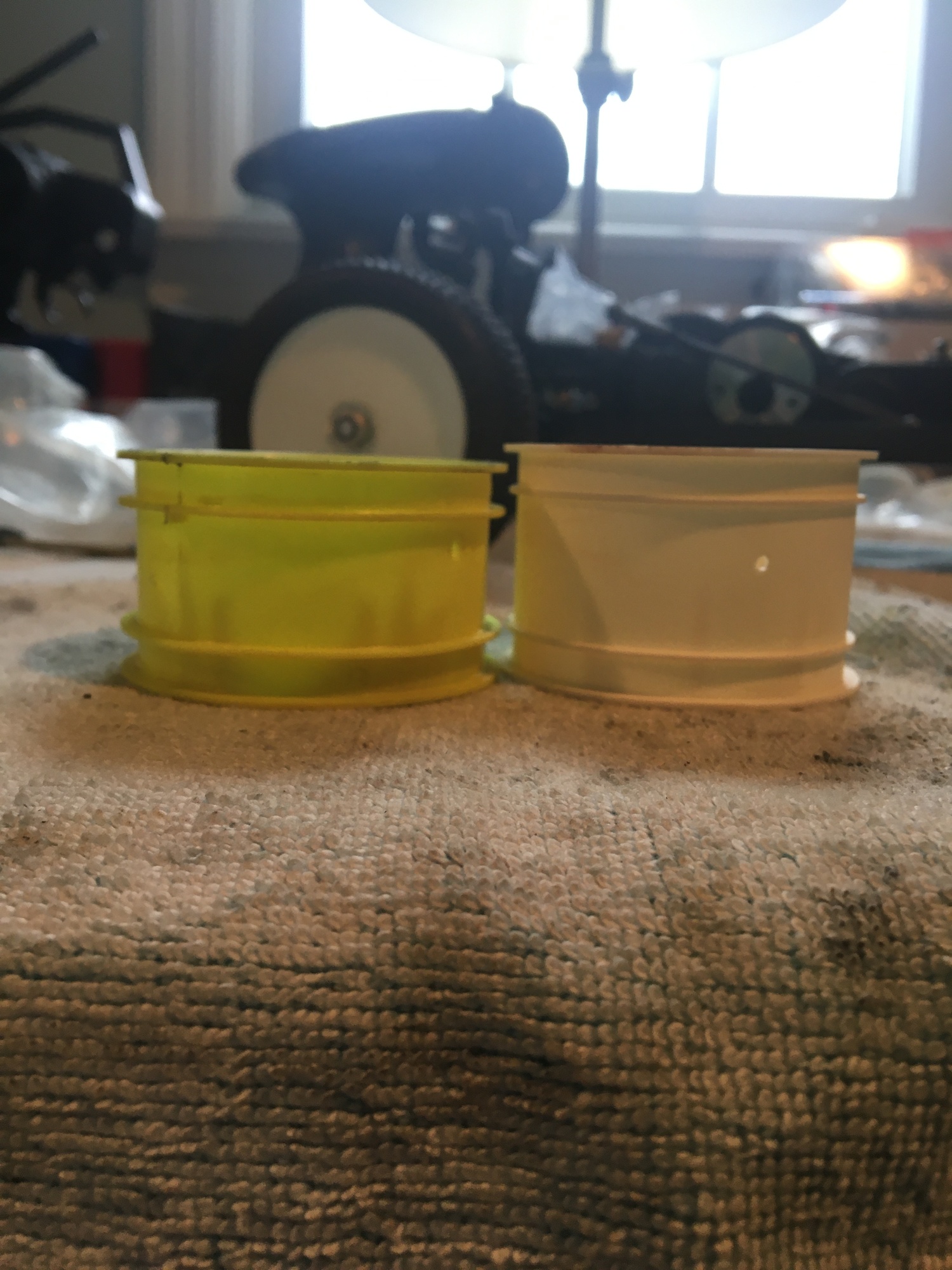

Here are some pics. Is there supposed to be such an "offset" difference and even difference in width of the wheel?

You might try updating to the Losi A-2126 'cr' rear hub, it might give you enough clearance for the wheel.

I use the wider XXX wheels on my DoubleX buggy (the modern tyres sit better on them) I've trimmed off the top-most 'lug' on the hubs, its a hole/camber position I've never used before.
