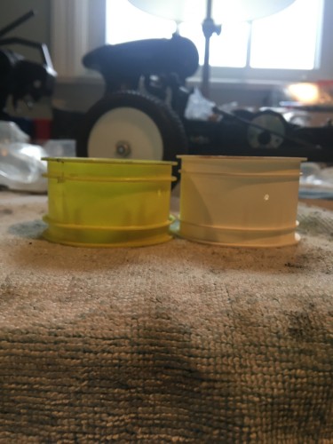

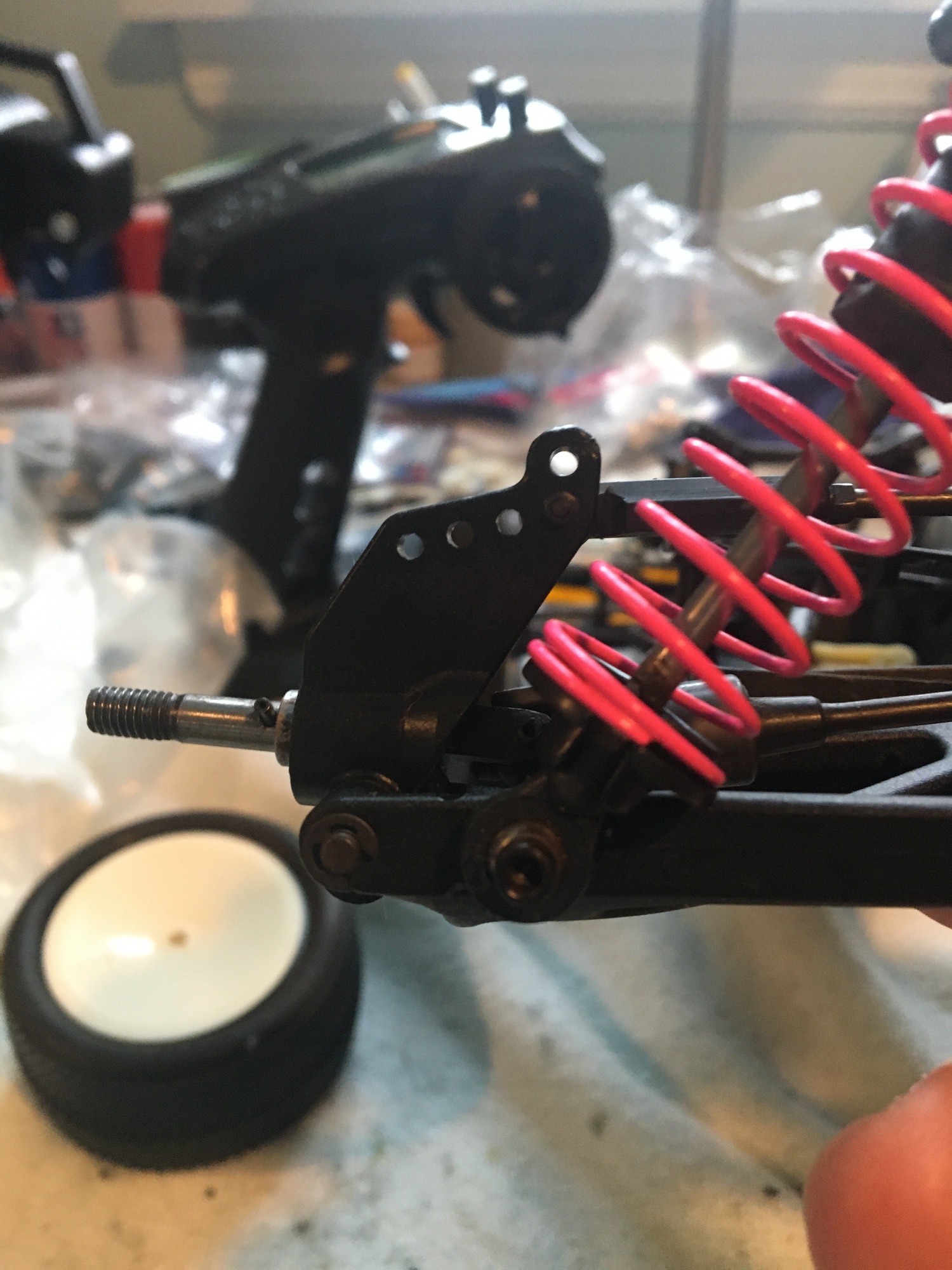

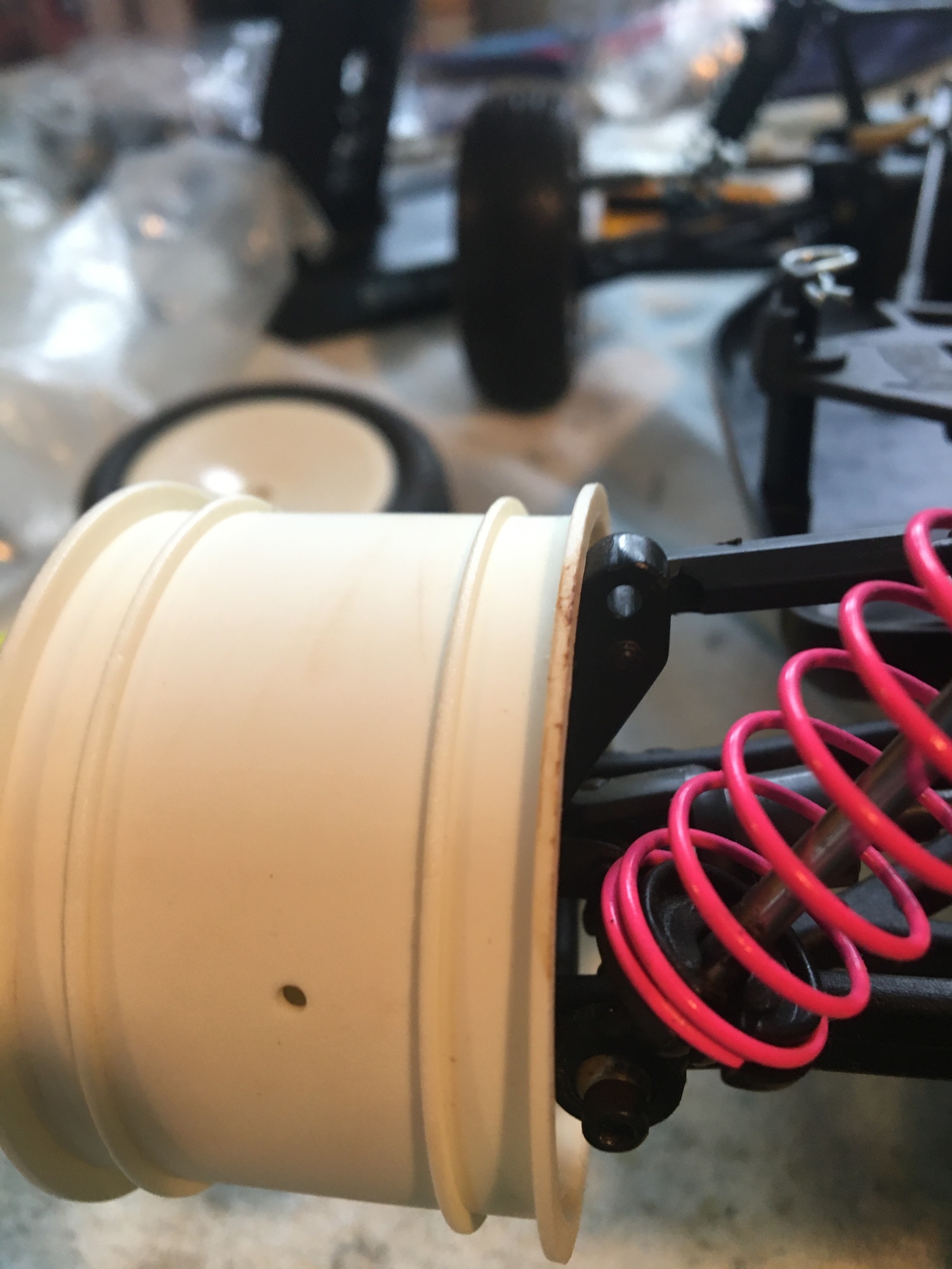

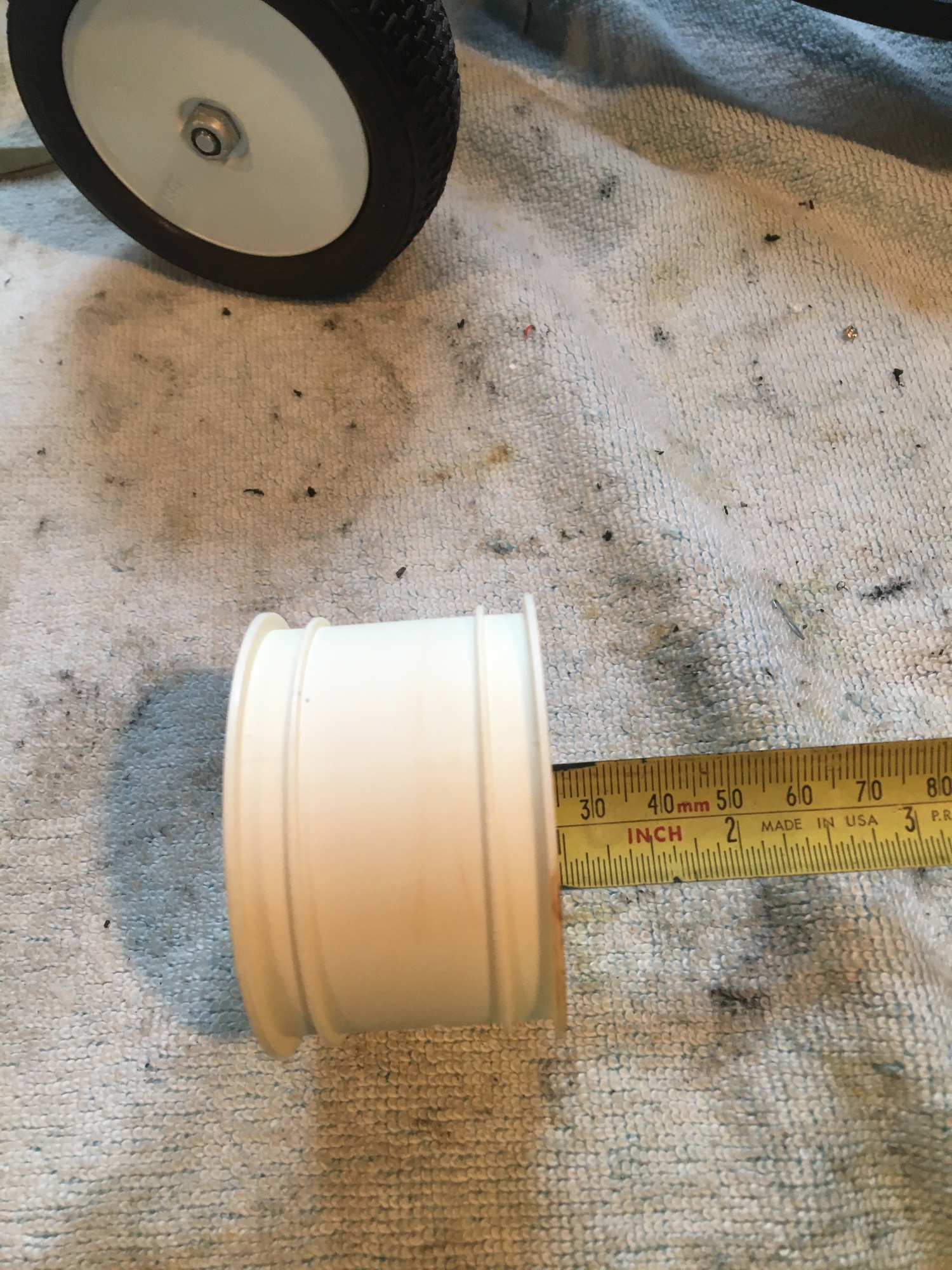

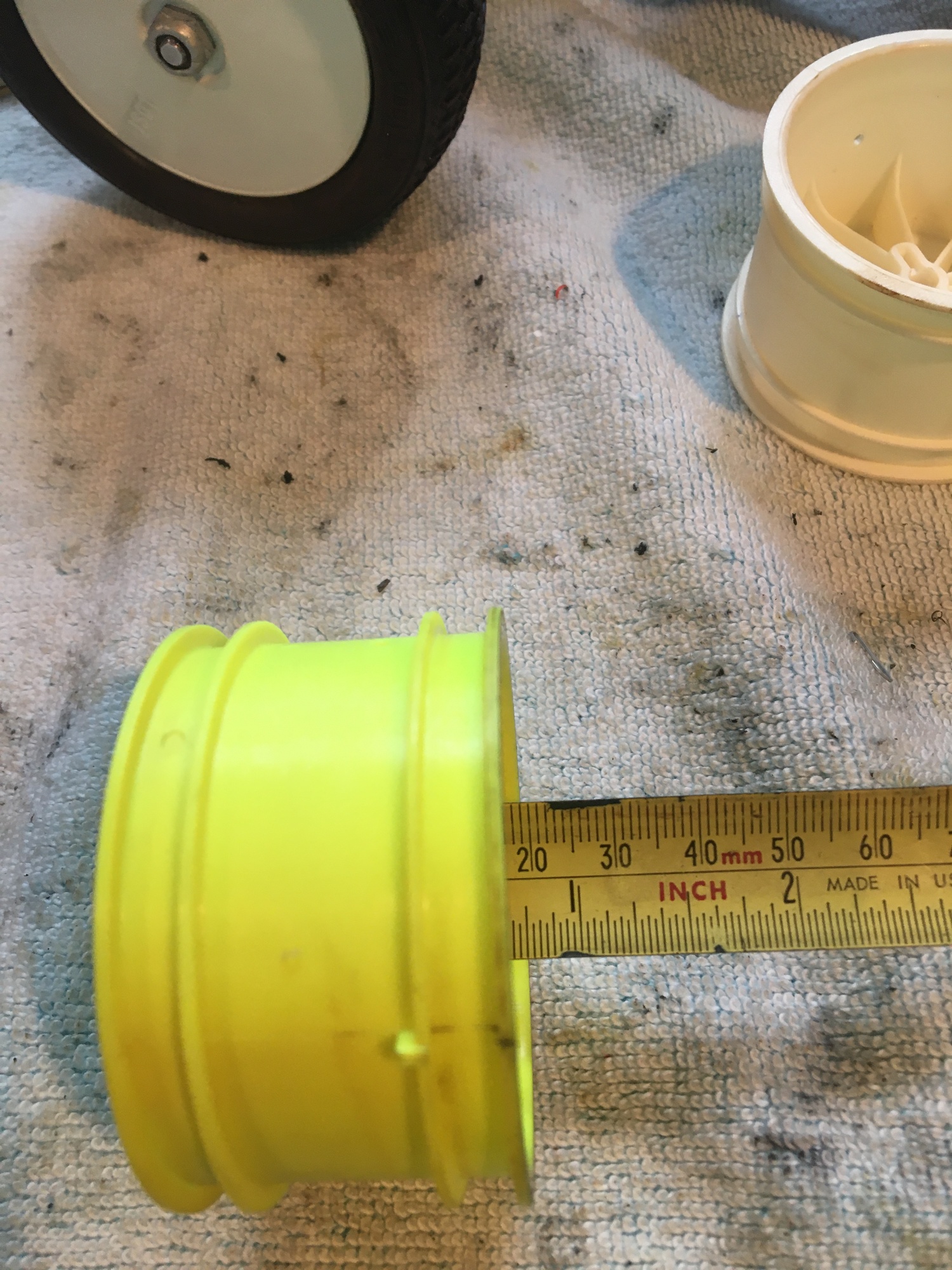

Re: XX-4 rear wheel question / Help
Here are some pics. Is there supposed to be such an "offset" difference and even difference in width of the wheel?

You might try updating to the Losi A-2126 'cr' rear hub, it might give you enough clearance for the wheel.

I use the wider XXX wheels on my DoubleX buggy (the modern tyres sit better on them) I've trimmed off the top-most 'lug' on the hubs, its a hole/camber position I've never used before.
