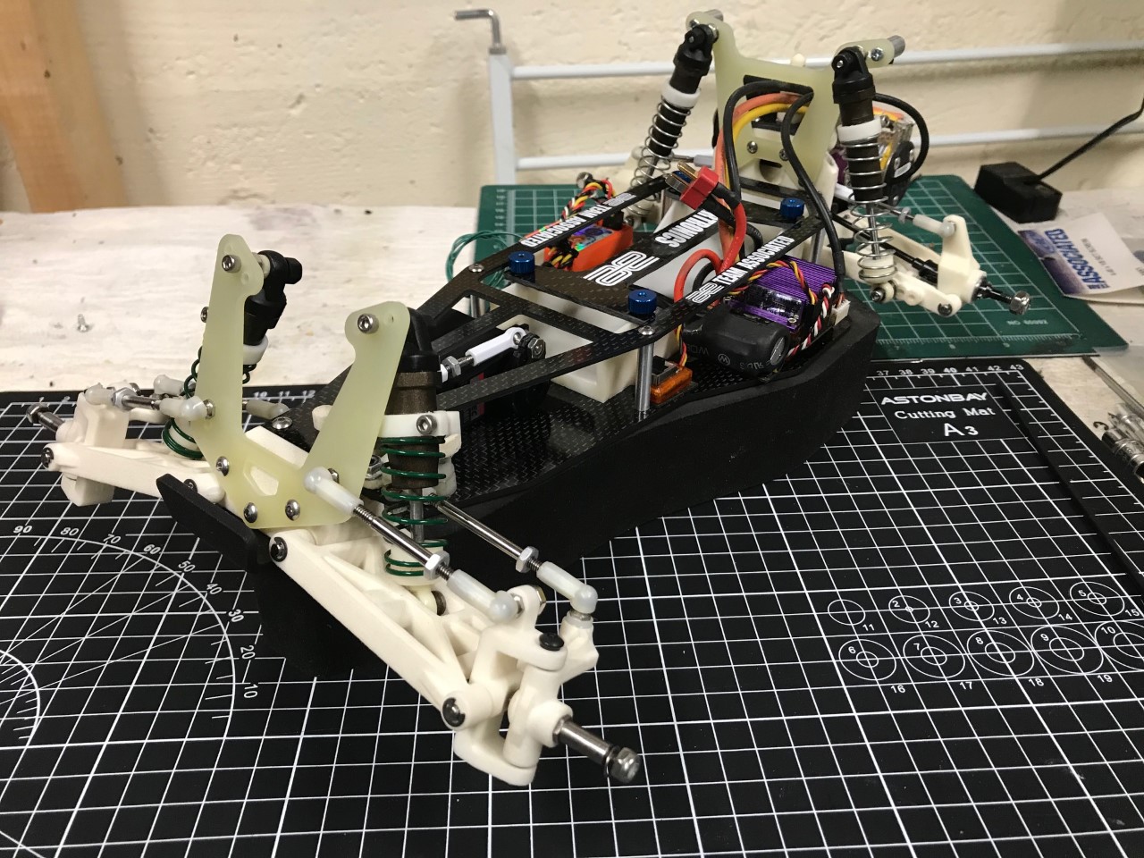

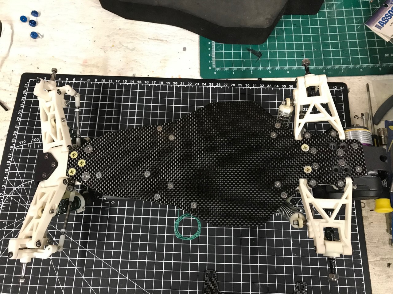

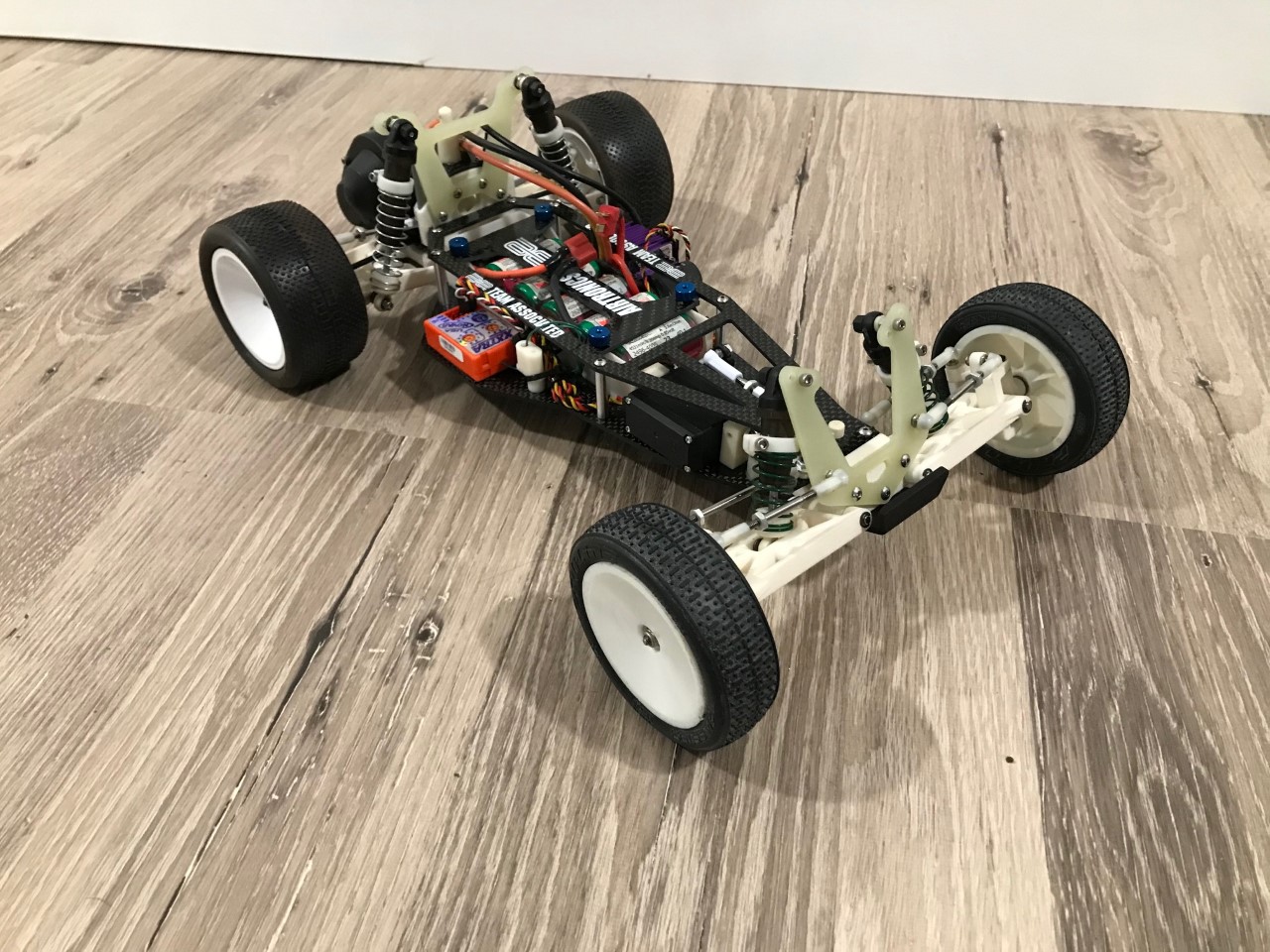

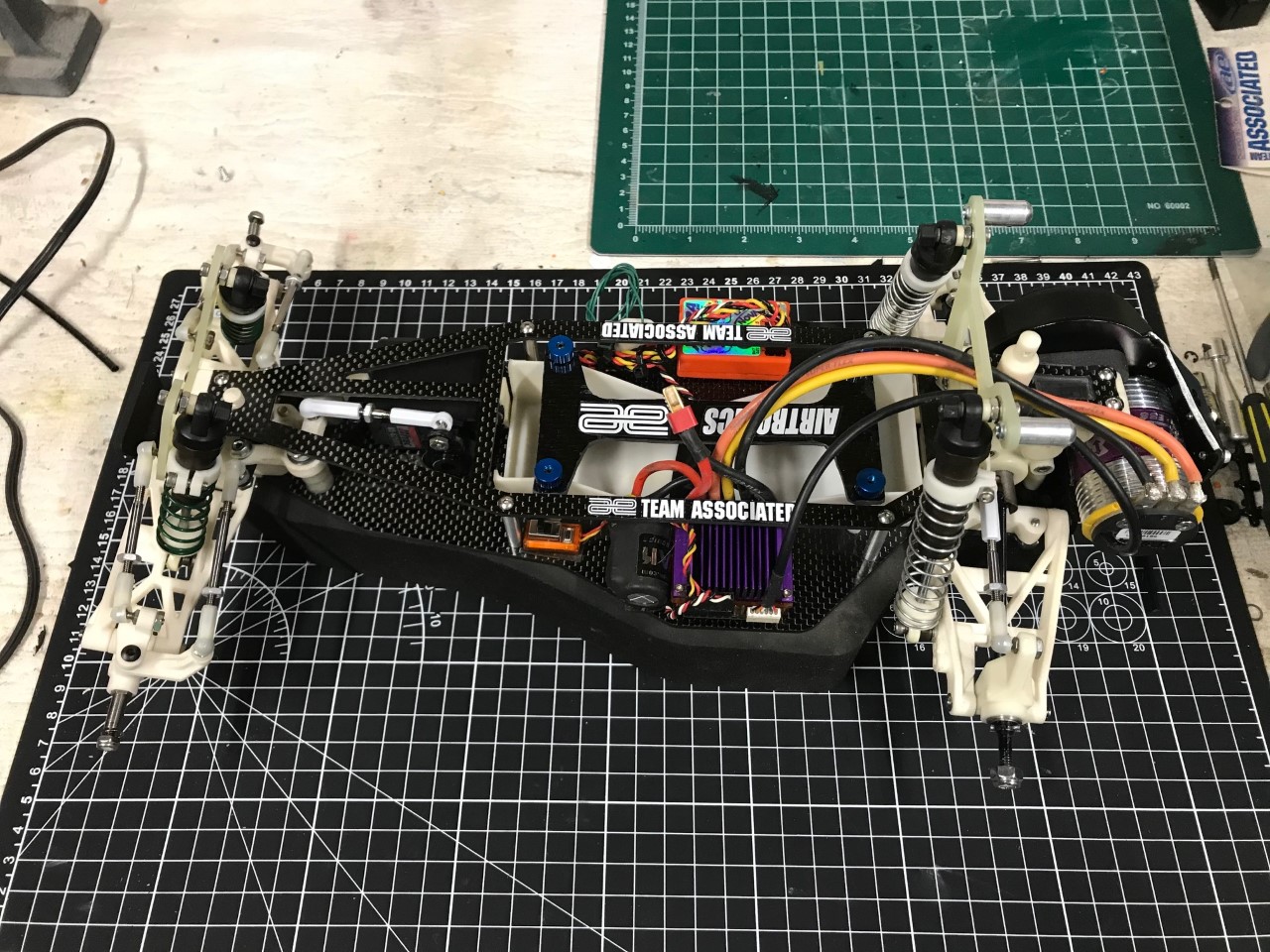

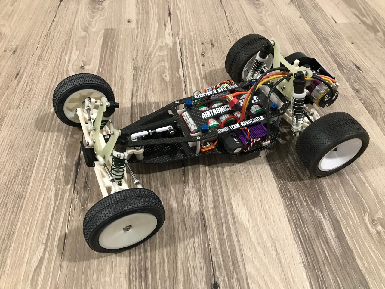

I ended up making a single battery plate instead of using two of the plastic strip ones that come with the old cars, I figured it would be a better option and could let me put in some sub c batteries if I wanted. I had a piece of carbon fiber plate that was 2.5 mm thick, I sketched it out in CAD, cut it out with a vibro tool and cleaned it up with a dremel. It came out ok, the bottom side is pretty beat up from the vibro tool jumping around but it fit fine. I put one some stickers I had laying around so now it looks pretty factory.

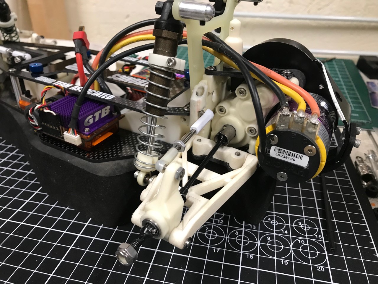

Re: RC10 NEO Stealth Car

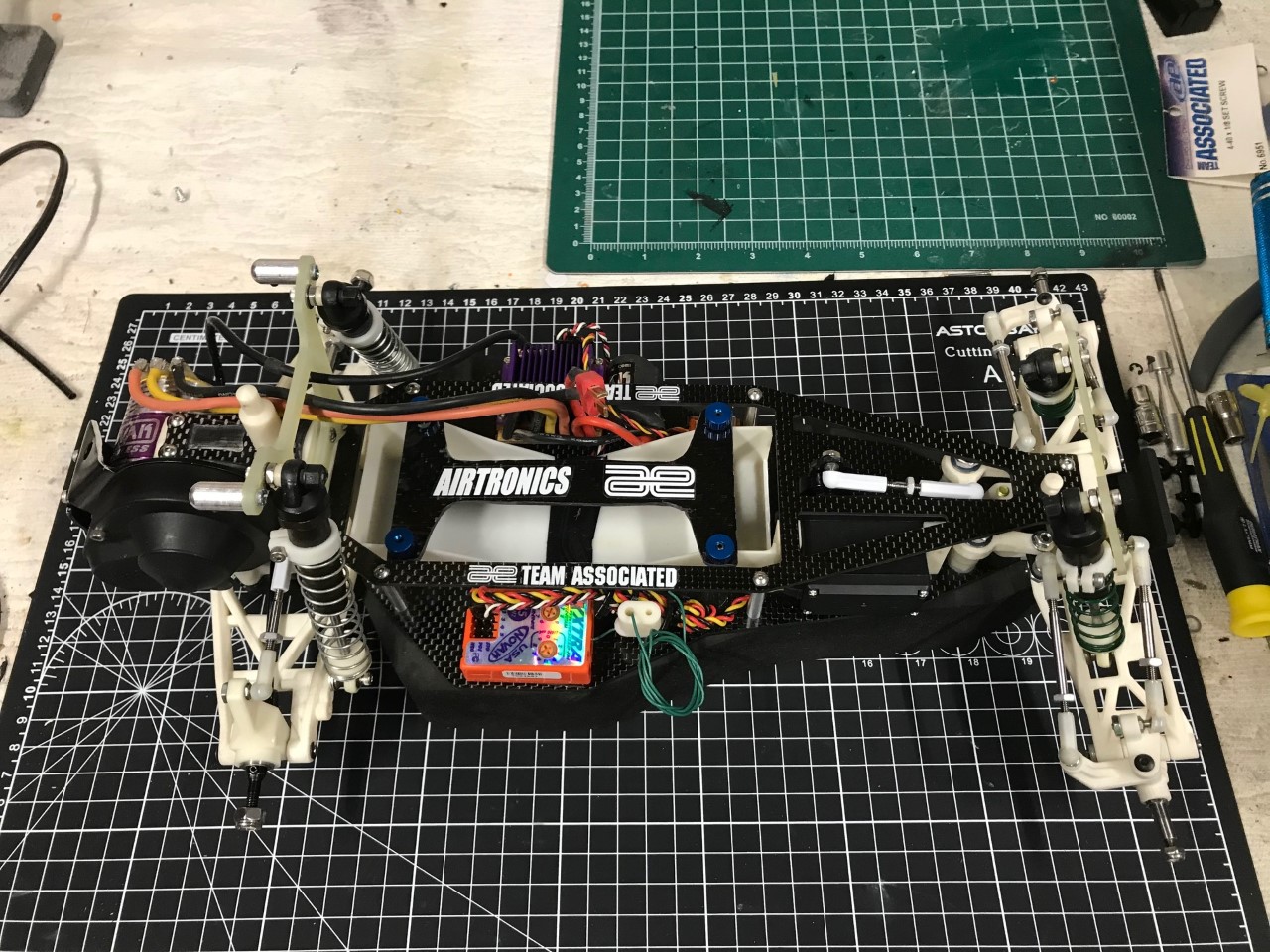

Added the electrics, I put in a Novak 75 mh Synthesized receiver that looks pretty good with this car. I had a Novak brushless setup with a 17.5 motor, this car was designed to be from the late 80's but the motor makes it more practical.
Still not sure what I am going to do for wheels and tires plus I have to order a body and wing but the car is pretty much done.

Add a layer of masking tape on any flat stock you want to cut out, it protects the finish. Aluminum, fiberglass or carbon fiber. It's also easy to mark up, and not stay on the material, like light colored fiberglass.

Yes this is a different car than the 91 worlds replicas that are out there. The front end is completely different, the front ends up being a tiny bit narrower than a RC10 worlds/CE car so it is much are narrower than the 91 car, the front bulkhead is different since it uses a completely flat lower chassis, this uses the shorter front shocks from the worlds/CE cars and it uses an offshoot of the worlds car steering bellcranks. The wheel base is 10mm longer than a stock car, i am not sure what the 91 car was wheelbase wise.
It uses the same style of double decker chassis but it was designed to use the 6 gear transmission. I put a stealth tranny in mine but I had to drill the holes in the chassis to do that. Other that that the rear of the car is pretty similar to the 91 car.
Like you said Michael designed this car to be different than what i am doing with it but I am petty happy with how mine came out, I am playing around with different types of wheels but will end up putting 2.2" on it and Mirage SS body.

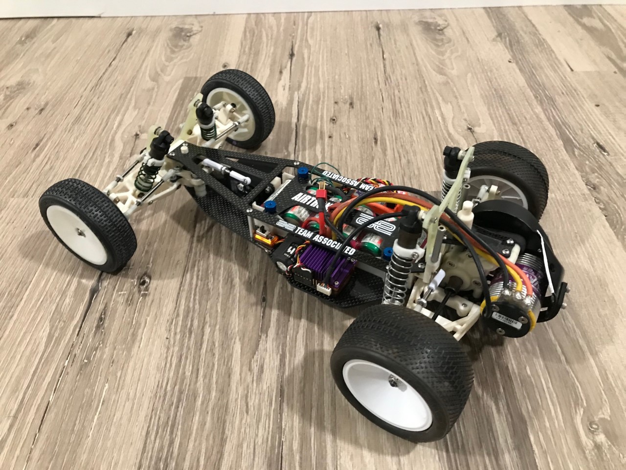

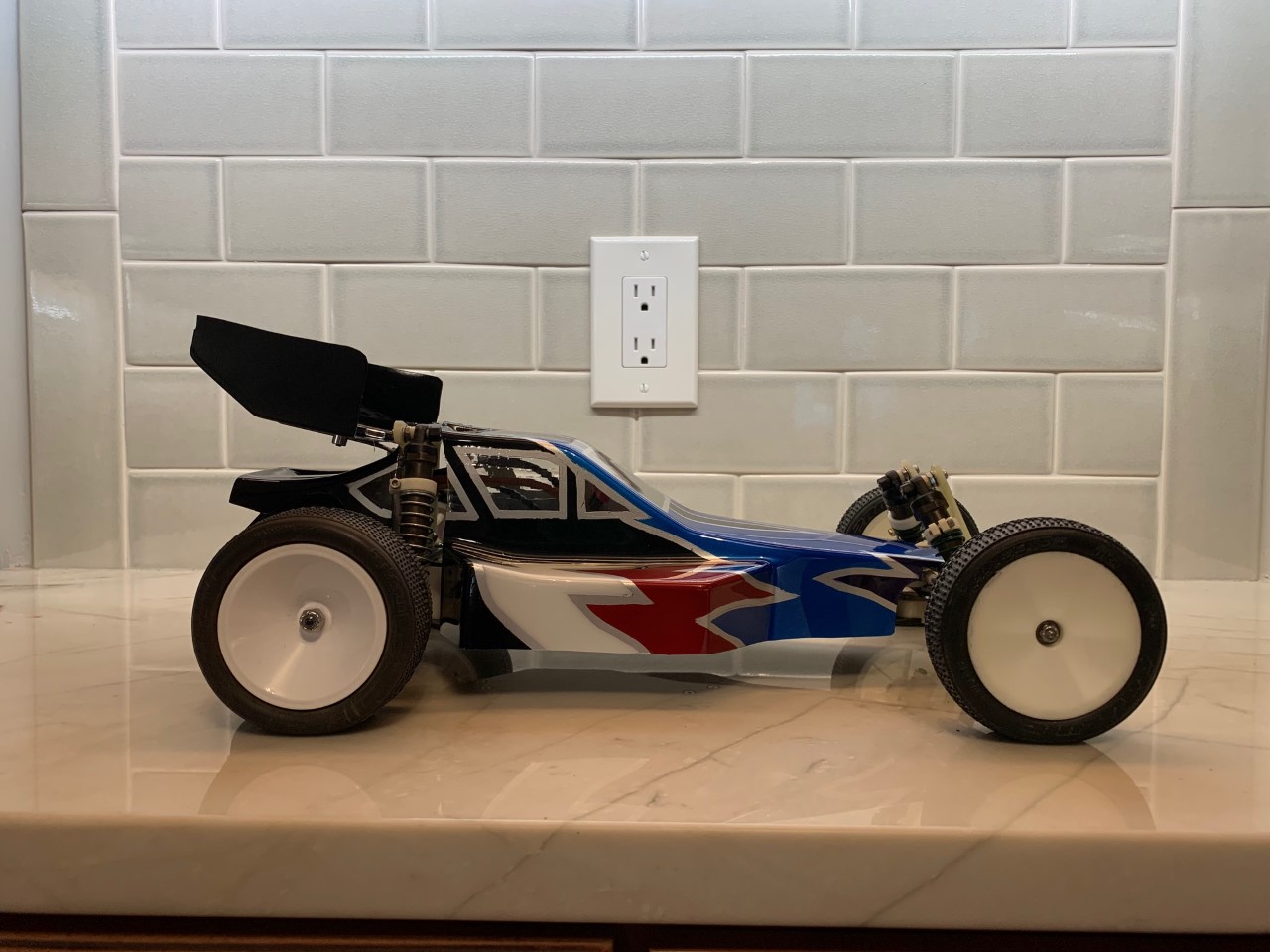

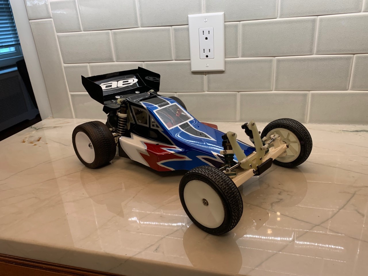

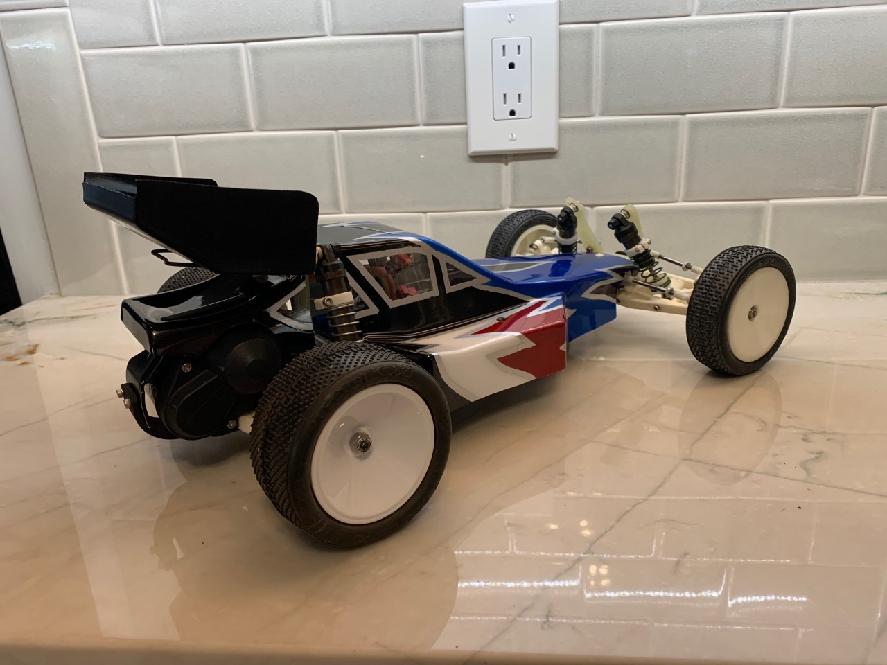

I put some 2.2" wheels and tires on it and put in a battery to see how it its which isn't too bad.
I have a body and for it and planning on painting it this week. I decided to go back to the wing tube setup since the wing mounts I had on it interfere with the shock mounting holes

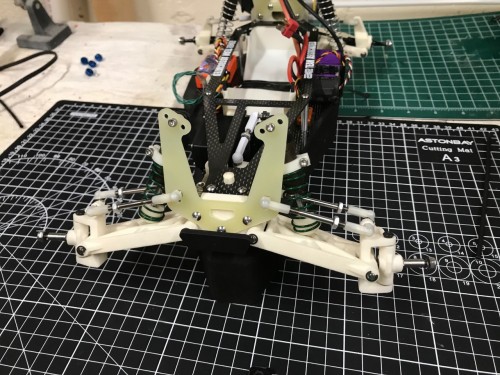

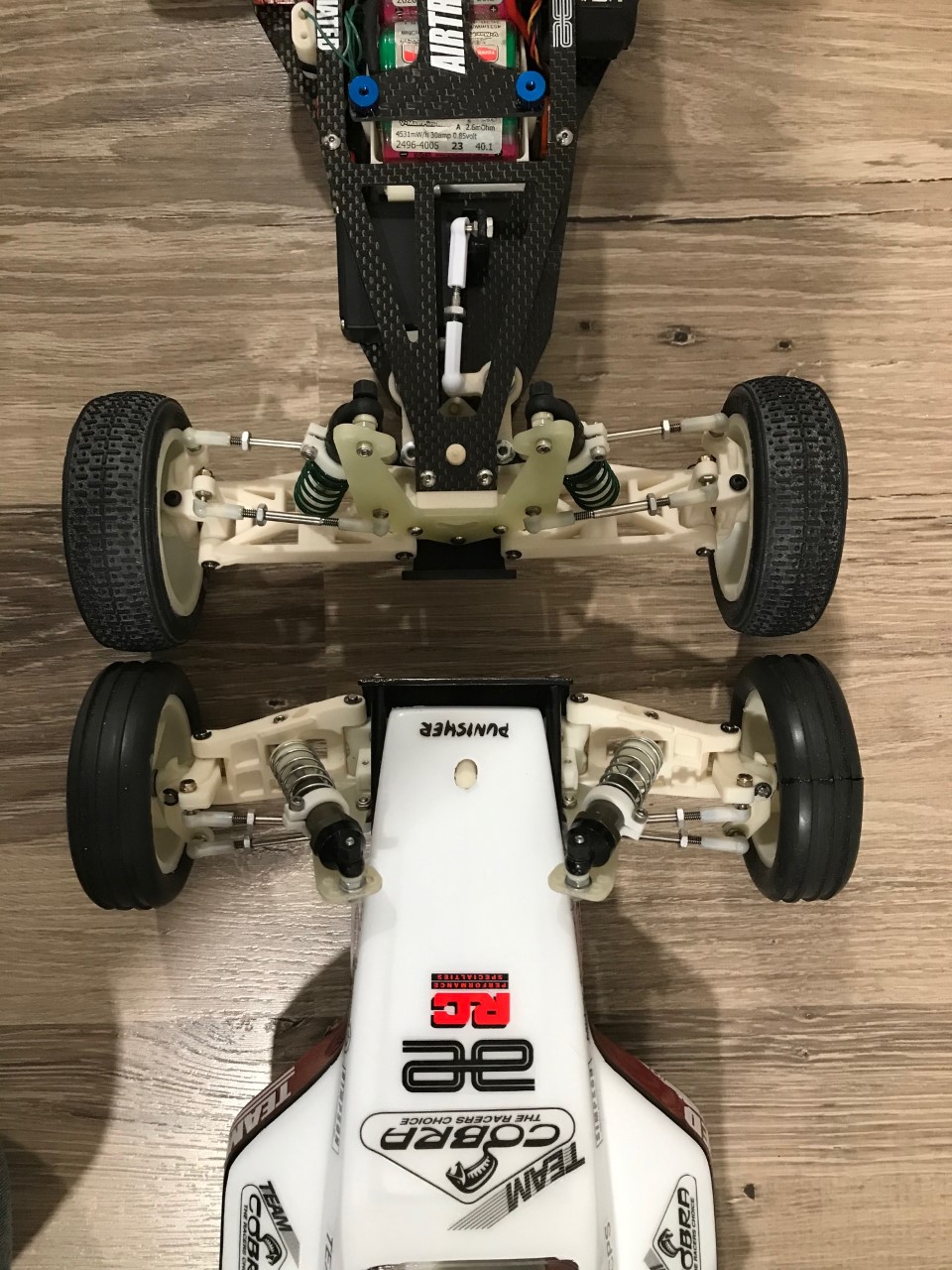

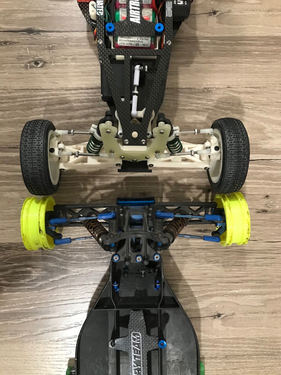

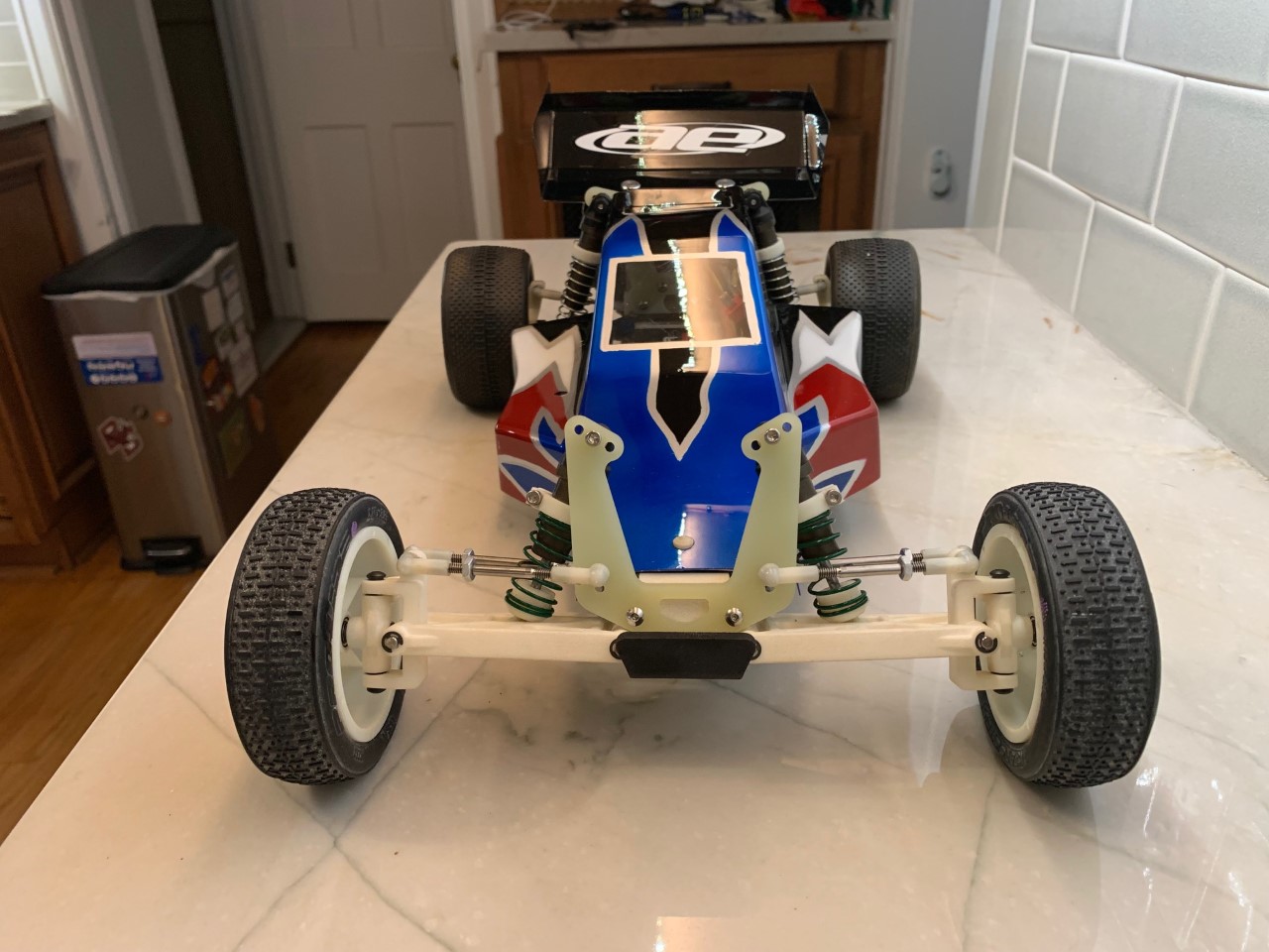

Here are some comparison shots of the front end.
It's a tad bit narrower than my team car and about 1/4" narrower on each side than a B4. The wheelbase is just about exactly the same to the B4 is which was a bit of a surprise, I thought it would be less.

It looks awesome! Like fine art to me. After being away from the hobby for while it’s great to see cars like this. I’ve seen the Neo-Vintage sight, and the cars there are all awesome. AE and Kyosho were my favourites back in the day. I’ve been thinking of updating my old 91 Team Car with all Dhawk, but this maybe some thing I’d prefer to do. So, here come the questions if you don’t mind. Will you or have you run it? How did it go? Do you think think the parts will hold up over time? Arts no good to me if it just sits on a shelf
. Can I transplant this into the Team Car without any additional parts? Lastly exactly which Traxxas wheels and tires did you use? I really like the look of them. Do they fit directly on the old 1/4” rear axles or did you have to make modifications? Thanks for any help you can provide. Cheers

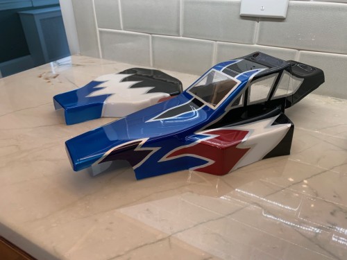

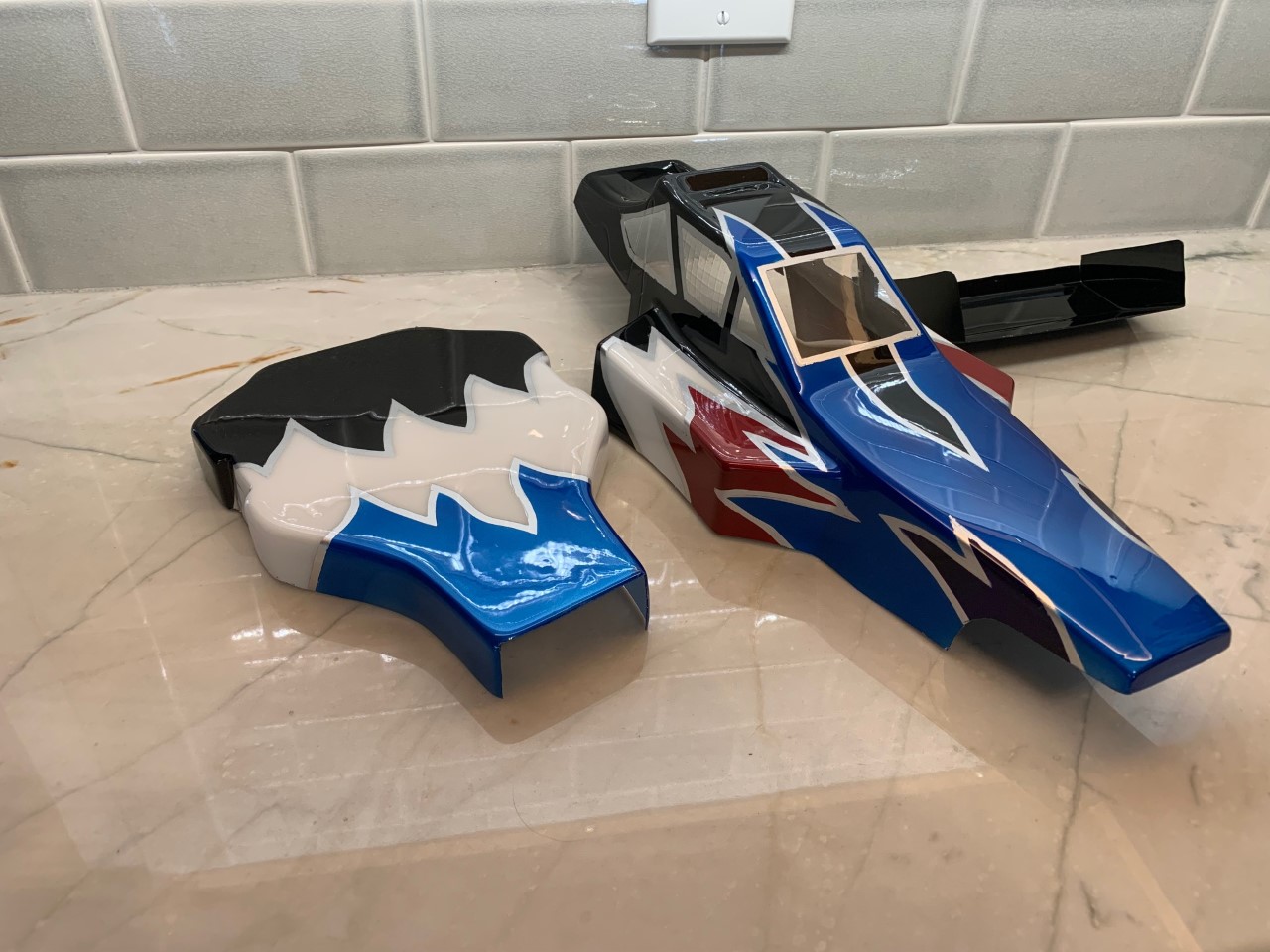

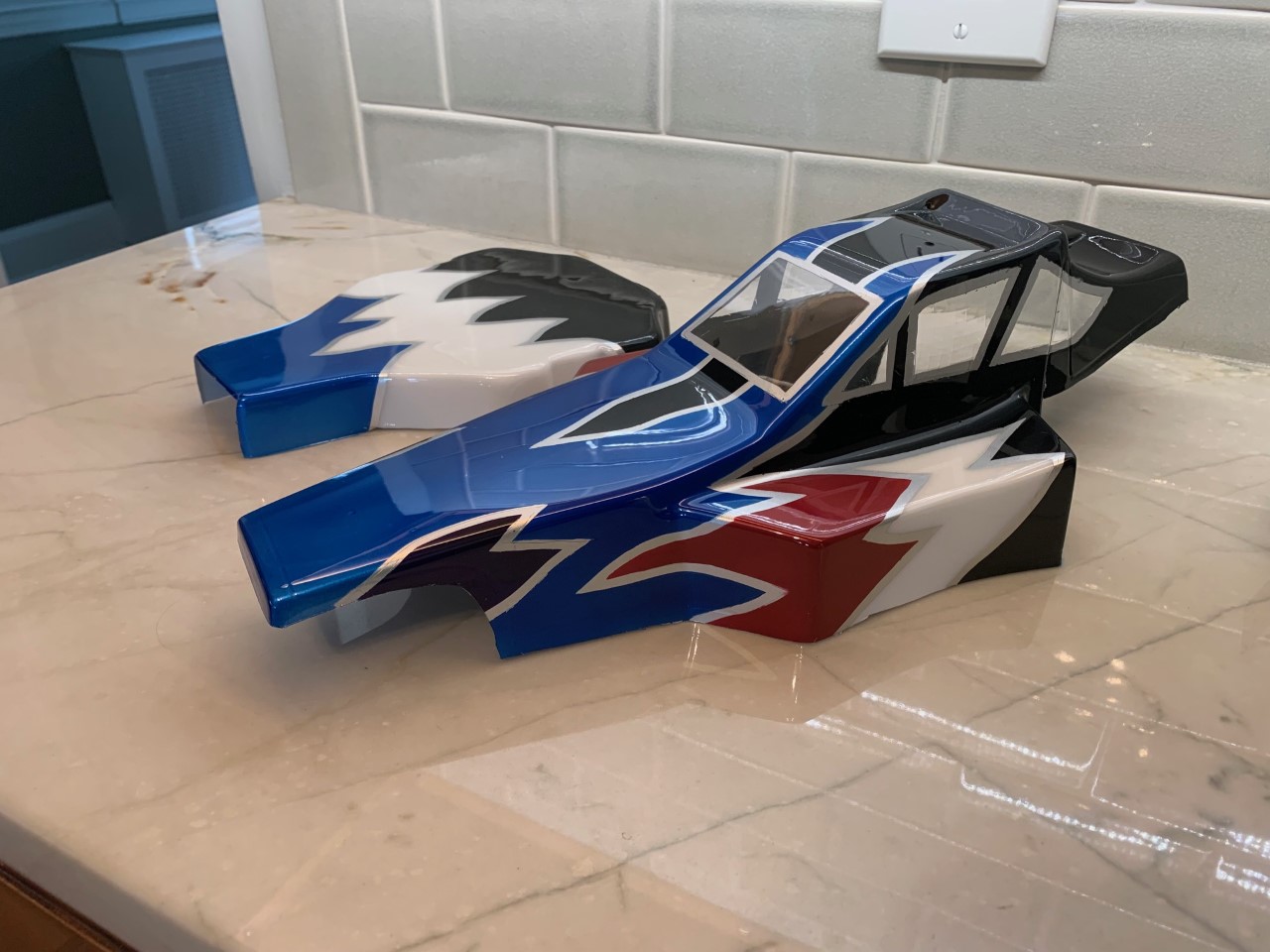

Finally got around to painting the body, I put a Mirage SS on it and found a generic RC10 undertray from Team Blue Groove. To me the undertray is a must for this car.
Now that I look at it I think the colors are more Kyosho than Associated but its too late now

Had some extra time this afternoon so I started cutting up the body and got it to fit, if you build one of these cars you really have to cut the crap out of the body for it to fit. Michael the designer has a Protech II on the cars he built but since I put a Mirage body on it I ended up cutting the front of it behind the front shock tower. Not sure if I love it but I think it looks better than it hanging over the front shock tower.
The one issue I found is that there are two button head screws right in front of the front body mount that are a bit annoying, they are basically the same height as the the body so they interfere if you use a body clip. I scratched the inside of the body a bit before I ended up putting some white strapping tape inside the body to protect it from the screw heads. I might get around to drilling out the holes in the top plate so counter sunk screws would fit but it's a pain to drill the graphite. You also have to cut the crap out of the area where the rear shocks mount, I have mine mounted in the middle hole and it clears the outside of the body but if used the inner holes I think there will be some issues.
I put on a few stickers I had laying around on but I had to order some new ones for the sidepods.
The body looks better on the car than it did sitting the countertop so I am happy with it.

Thanks for the comments, I think I will end up running it. I haven't been to the tracks by me in a while and everything has converted to astroturf which isn't really this cars wheelhouse. Who knows about the durability, the chassis is super nice quality but I am not sure about the arms. The rear ones have a ton of flex in them which is a bit disappointing, the front ones seem pretty thick but I have heard mixed things about 3D printed front arms.JPaul wrote: ↑Sat Aug 14, 2021 10:31 pm It looks awesome! Like fine art to me. After being away from the hobby for while it’s great to see cars like this. I’ve seen the Neo-Vintage sight, and the cars there are all awesome. AE and Kyosho were my favourites back in the day. I’ve been thinking of updating my old 91 Team Car with all Dhawk, but this maybe some thing I’d prefer to do. So, here come the questions if you don’t mind. Will you or have you run it? How did it go? Do you think think the parts will hold up over time? Arts no good to me if it just sits on a shelf. Can I transplant this into the Team Car without any additional parts? Lastly exactly which Traxxas wheels and tires did you use? I really like the look of them. Do they fit directly on the old 1/4” rear axles or did you have to make modifications? Thanks for any help you can provide. Cheers
When I built this car I bought a beat up gold pan team car as a donor, you need the longer front shocks that come with the stealth transmission cars. Also the kit is designed around a 6 gear transmission so I had to drill some holes in the chassis to make a stealth transmission fit which isn't a huge deal. As far as other parts I ended up buying different steering armsj and a bunch of different screws since the car has bunch of short button and countersunk ones. The rear end uses he stock driveshafts and hub carriers.
The wheels are RC10 wheels, the rears are made by J Concepts for the vintage RC10's and fit a 2.2" tire. I had to drill out the inside mounting holes a bit since my car has the older style universal joints and not the MIP CVDs that come with the re-release worlds cars. The diameter of my axles are larger right around where the drive pin is but they thin down where the nut is. The front wheels came with the don'or car I bought so they have flanged bearings and fit modern 2.2" tires.
