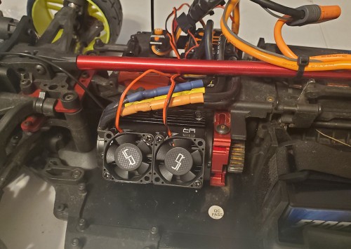

Had a little time this evening, so got a couple of things started.
New motor heat sink with twin fans mounted. Temp probe squeezed in there nicely. Need to finish the wiring. Found one of the motor mount screws stripped and no set screw installed on the pinion gear. POs are the worst!! Found an easy GPS mount stl online and got it in. It seems a little weak at the mounting tabs, but maybe it is good enough. But the biggest change of the day is the shoes! The guys at the LHS are all about the GRPs, and I got to thinking that maybe the yellow/green would work with the silver, and dog gone it, I think it looks BA!!

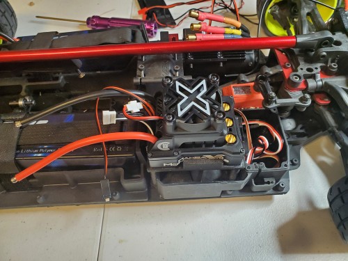

Todays updates:
Got the MMX 8S ESC in, and made a mount for it. I 'lifted" it out of the cavity the stock one fit into, maybe thinking it would allow a little more airflow / cooling. Might to nothing, but might. I had gathered all the parts I thought I needed to quickly slap in a "limitless" spool, but after pulling the stock Infraction diff, there are obvious differences. Apparently the entire gear range is different between the two as the Infraction comes stock with a 46t spur, and the limitless comes with something in the 28-34t range. I have put in the order for a 46t 8mm bore mod1 gear, which from what I can find, one company makes. Also found out that the "handbrake" disc is driven off the rear drive cup, so that needs to be ground down to keep the brake. I am in the process of printing what I hope will be my main switch box for the whole rig. I am planning on running a mini 3P switch to control: 1) esc power, 2) power to motor fans off one battery, 3) power to temp monitors off one battery. That way I don't need to remember (and probably forget) to plug things in all the time. The batteries are either plugged in their chargers and balance plugs, or they are plugged into the esc and accessories. On run day, one switch is on or off.

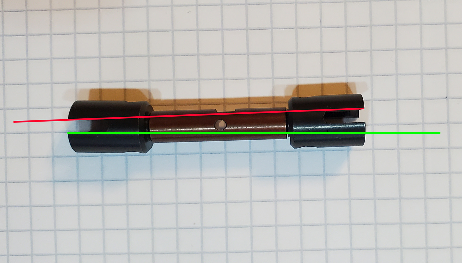

Well, I am on hold waiting on gears at this point!
I did go through and get 90% of the wiring done, and it came out pretty clean. One single loom along the spine keeps it all in check. The only part left is the temp monitor on the bed, but that will just plug in. Single switch in the front turns on fans, temp monitors, and esc. At some point in my life, before I die, the lesson that "cheap parts cost you more in the end" is going to sink in, I don't don't know when! As shown in a pic above, I am changing over from a traditional differential to a straight spool, as this rig is being built to just go straight. The spool set up is built from several individual parts, of which of course Arrma makes, and "others" like HR make. I made a mistake by saving about 25% by going with HR shaft and input cups. At this point, I think the shaft is the issue, but I am not 100%. I have an Arrma shaft on order.
I just happened to throw the setup on the mount and spin it over, and noticed the obvious issue. It kept stopping at the same point, as if there was an out-of-balance issue, or a bent issue. I could have easily just put this thing together, and ran this spool at 10K+ RPM. I really can't imagine what would have happened at that point.
How do you make something this crappy? Note how one side of the cup collar is flush, and the other is 1+mm out!

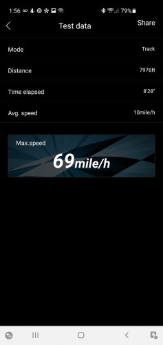

Just updating this really just for my own good. This thing continues to intrigue me and frighten me at the same time, which I why I think I continue to move forward with it.
Have a set of 25/42 gears in there with the stock 2050kv motor, and could finally record a 90+mph run on 6s. My motor temp sensor never went higher than 141*F. It will do more than this, but my main issue is finding the real estate to let it loose on.
I thought I found a great road this weekend, until I found "the hump" on the second run. After that, the truck was like a moth to the flame and couldn't avoid it!
Quick vid. 1st pass, okay. 2nd pass, hello hump. 3rd pass, why am I on this road? 4th pass, I should have just hit the hump. 5th pass, I thought the other way would work, but then hit the hump MUCH more violently off camera (listen for it).
But ultimately, a recorded 91mph is a recorded 91mph. Next phase is more gear and less drag.

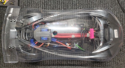

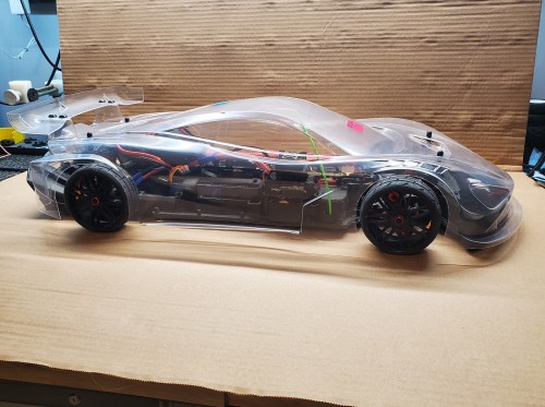

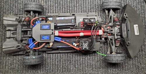

New P/S ratio is 27:42. This, with the change in motor, should be over 100mph. I was seeing about 10-12*F temp rise during every run previously, so there is room for upping speed there. I am also currently designing a pit / cooling box, that will throw ice-cooled air under the body during cool down times to lower "under-body / ambient" temps. I am seeing under body temps in the 110-115*F range, so if I can drop that closer to actual ambient temps, that will greatly help with reducing motor / ESC temps. But seeing in that it may be November+ before really getting running again, I may not prioritize this.
New chassis overall: The new body overall. Honestly, just 2sexy! I wish the front was a little more aero, but when compared to the Infraction truck body, it is night and day! New rear sensor mount and power switch: The temp sensors are now mounted so they can be viewed through the "mid engine" clear opening of the body:
The most drastic is the body, but that isn't complete at this point, and the next three weeks are going to be "no rc time" so it isn't going to change for now.
BUT, because of the body change, all of the custom parts that I built to fit the truck are a no-go, so a complete re-wiring of the ESC, motor fans, and temp sensors had to be done. I am happy with it overall. What is nice is the power switch is on-off-on, which I just had as double-throw previously, but now one on is fans and sensors, and the other on is fans, sensors, and ESC. Keeps me from having to power up the whole rig to run motor fans for cooling down.
I did put a new CC 2200kv sensored motor in it. The jump from 2050 to 2200 is only 7% (and I shouldn't sell that short), but sensored helps a lot with tuning. Matching the ESC to the Sensored motor is an added bene. I am also going to start bringing along a separate tablet to BluTooth to the CC system, and I can keep my phone BluTooth on the SkyRC.
