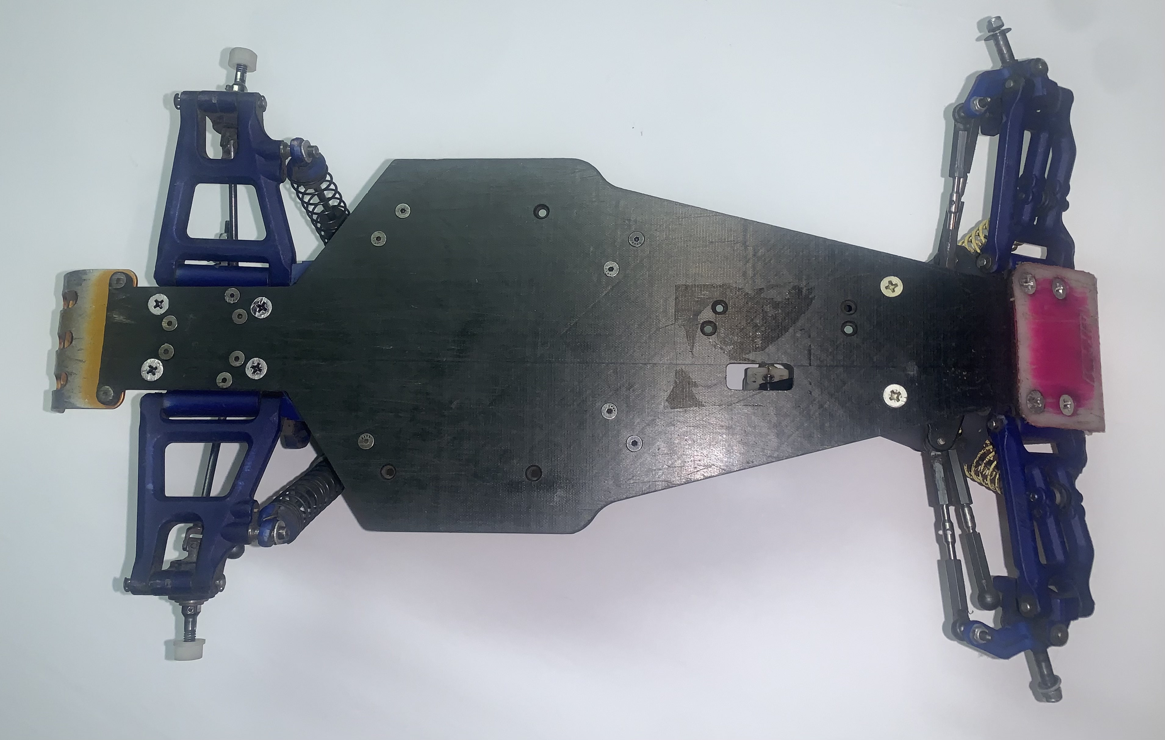

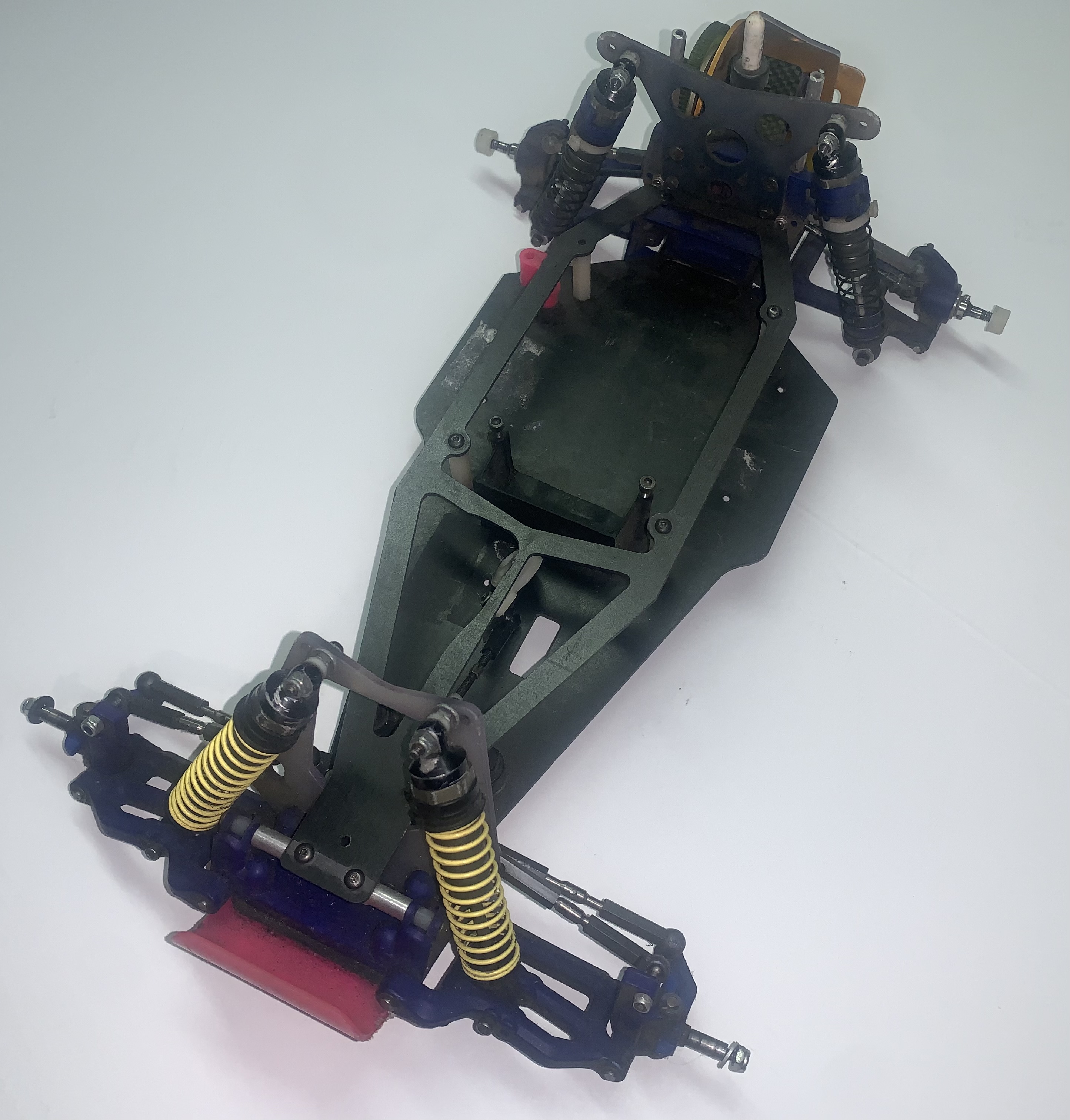

Did a quick brush off just to inspect everything, found a couple nice pieces and some I need to question.
After making the front springs go away for good I can see the front rpm cups, eyelets, spring retainers, and adjustment clips are present.
Couple other rpm goodies.
The rear bulkhead has been cut out and sits down around the lower chassis, Is this normal ?
Also I’ve decided I like the rpm parts in blue, pretty even dye job and in good shape so they will stay this way.

Those yellow front springs are correct for the rpm front end. They are the 'medium' set from rpm and what they recommended for initial setup.

jwscab wrote: Sat Sep 04, 2021 9:04 pm Those yellow front springs are correct for the rpm front end. They are the 'medium' set from rpm and what they recommended for initial setup.
Oh really, I honestly thought they were Losi springs. :oops:

If they fit the rpm collars they are rpm. I think crazy enough you can still buy them from rpm.

Yeah, they had yellow (soft) and silver (medium).

Yes they did fit them well. I mean it’s not that I threw them out I just really don’t want yellow springs on it.

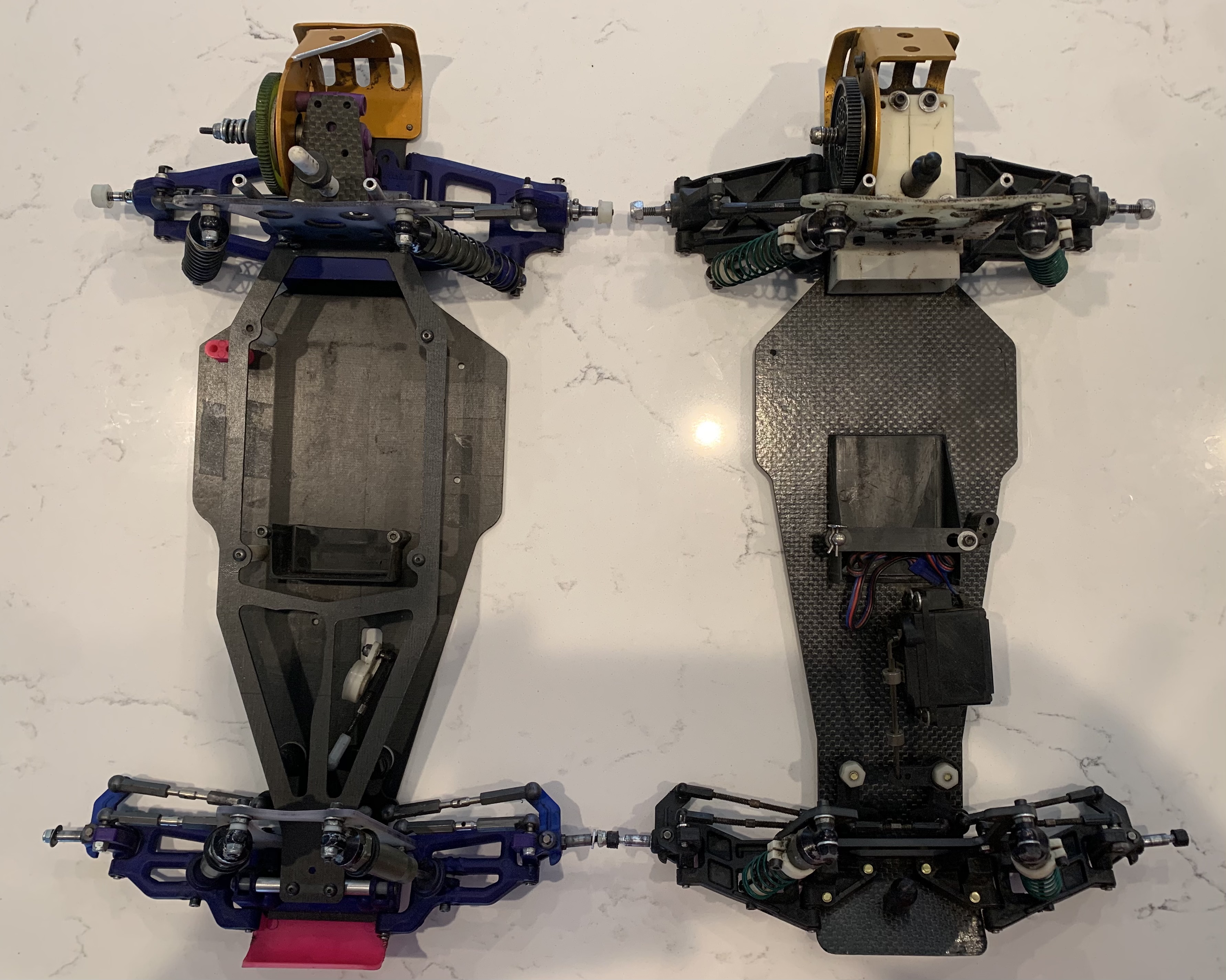

They may not be perfect specimens but since I know it’s been mentioned before and it is something of a rare opportunity to do so, I figured I’d take some side by side photos to display their similarities and differences shape wise.
