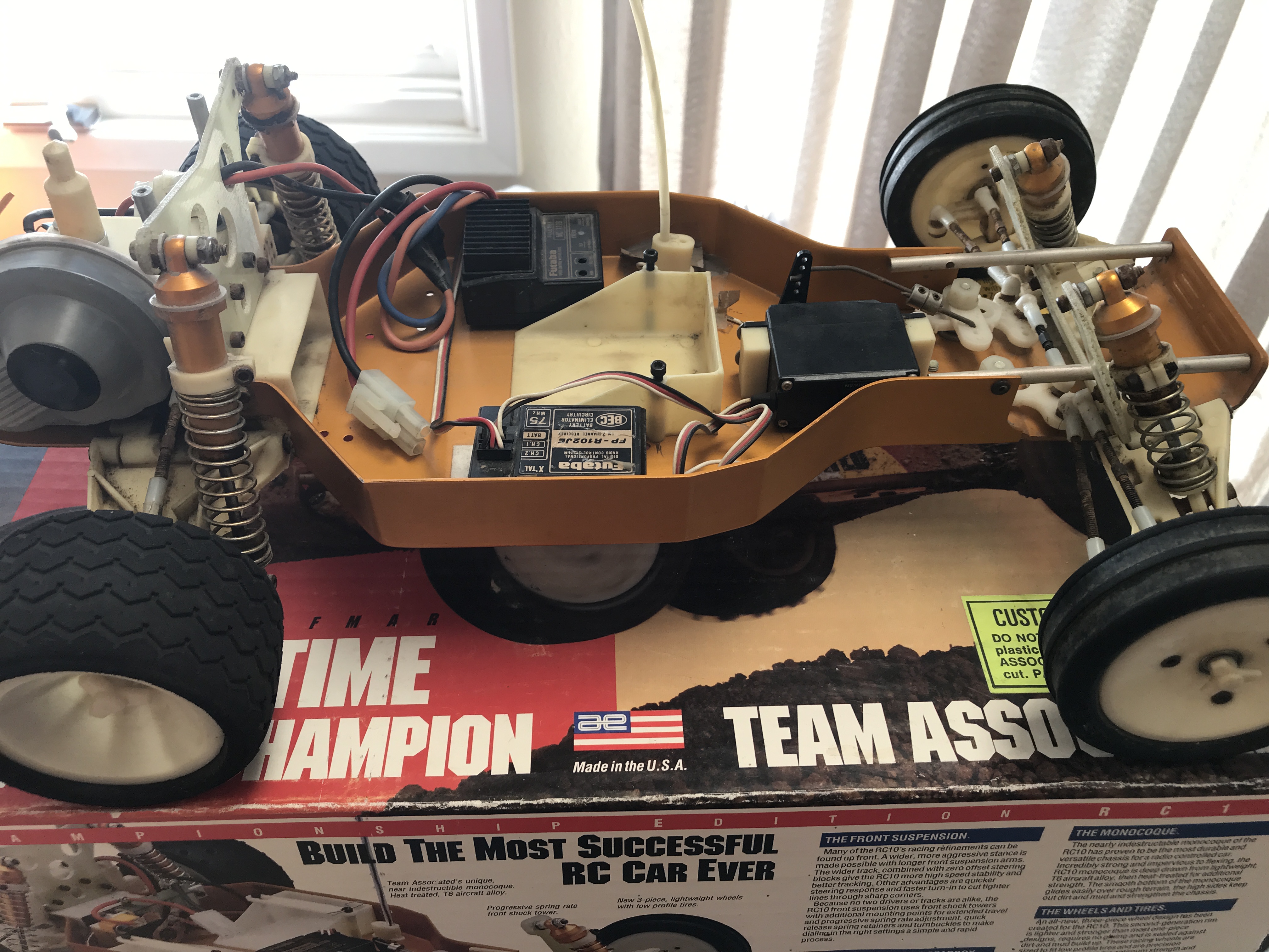

Sorry about the picture in the middle there. Trying to get used to adding photos. Not very computer or tech savvy. I’m going to try and add a few more photos.

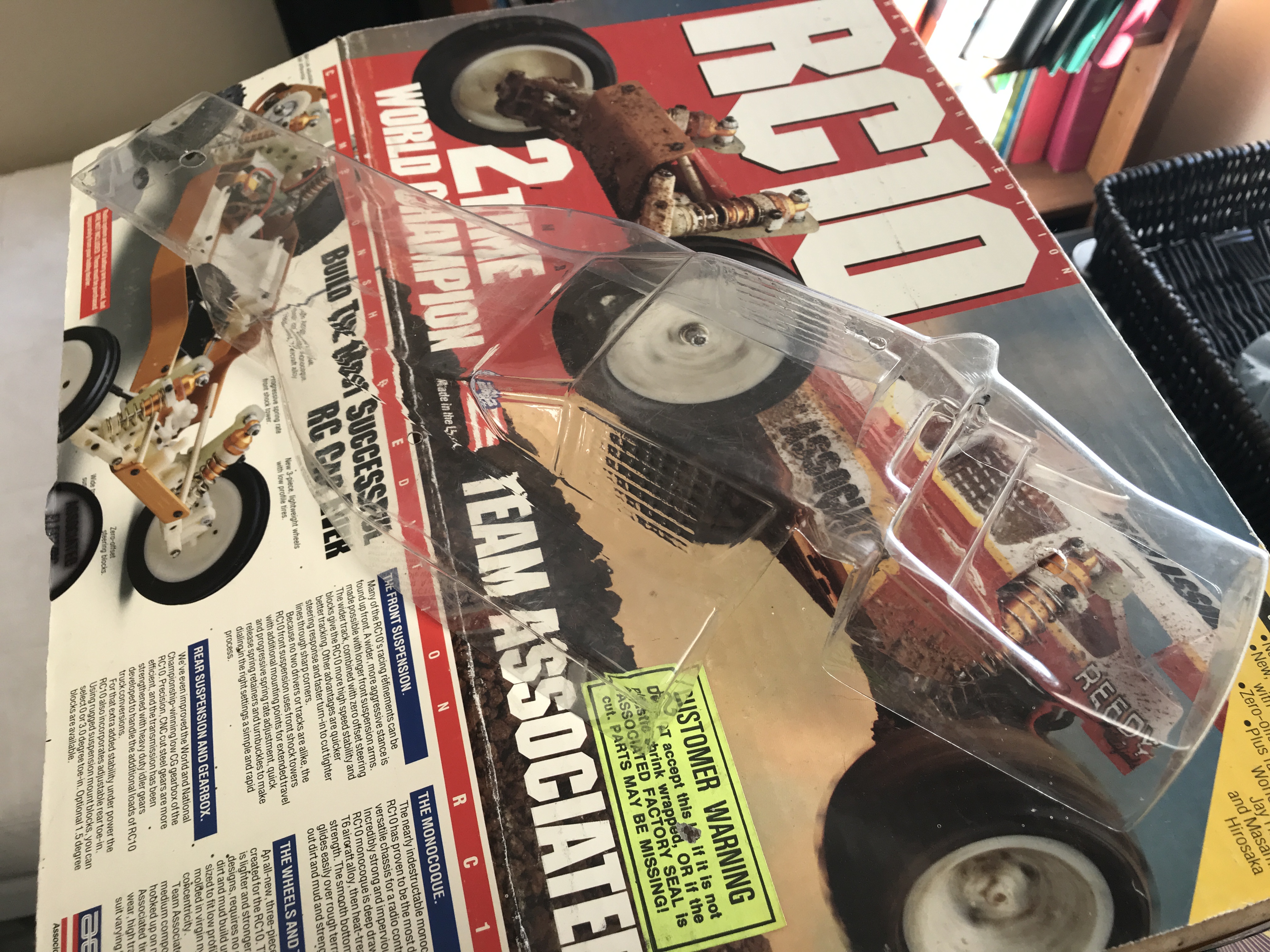

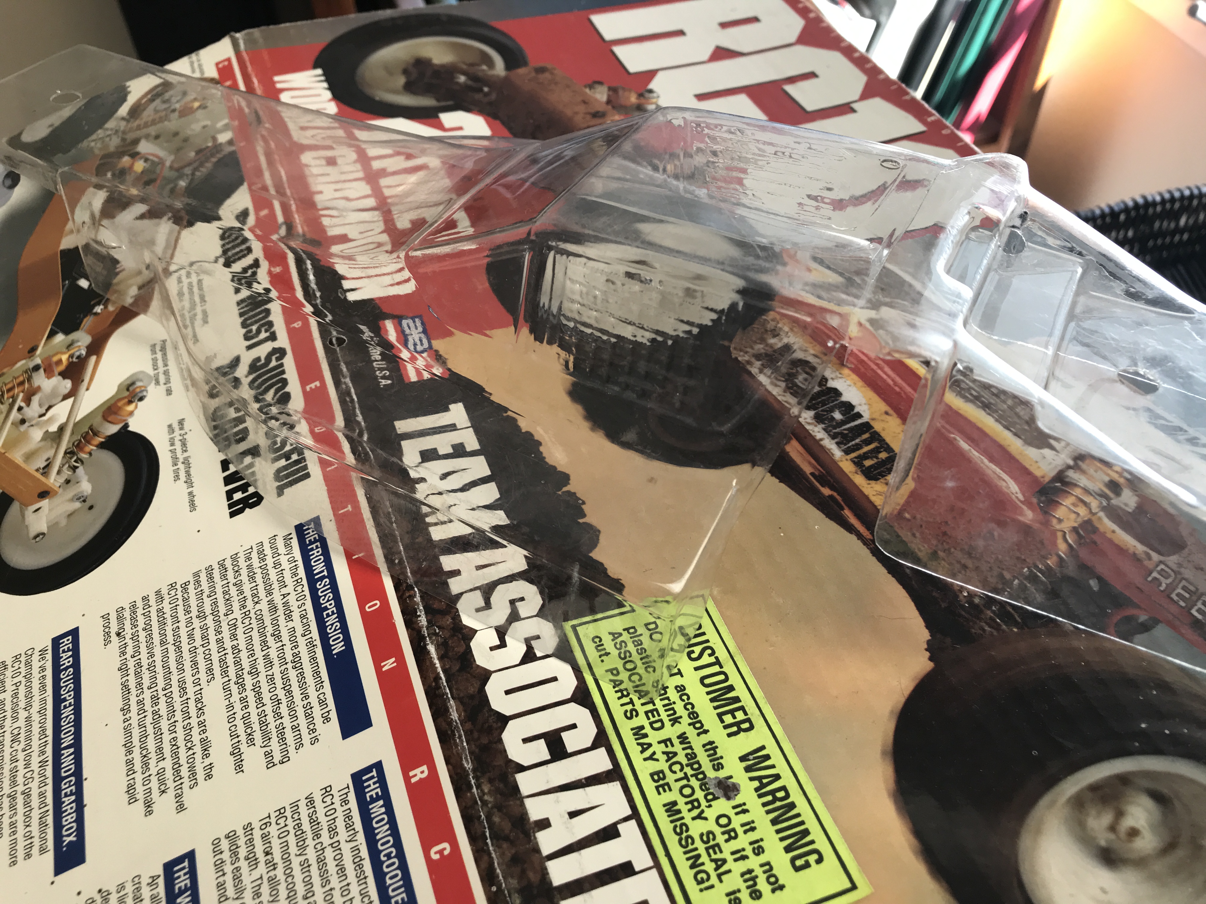

Also....how can you tell if the body I am original? There are no markings on it. It looks like there are or were a few companies that made aftermarket bodies for the rc10. Thanks

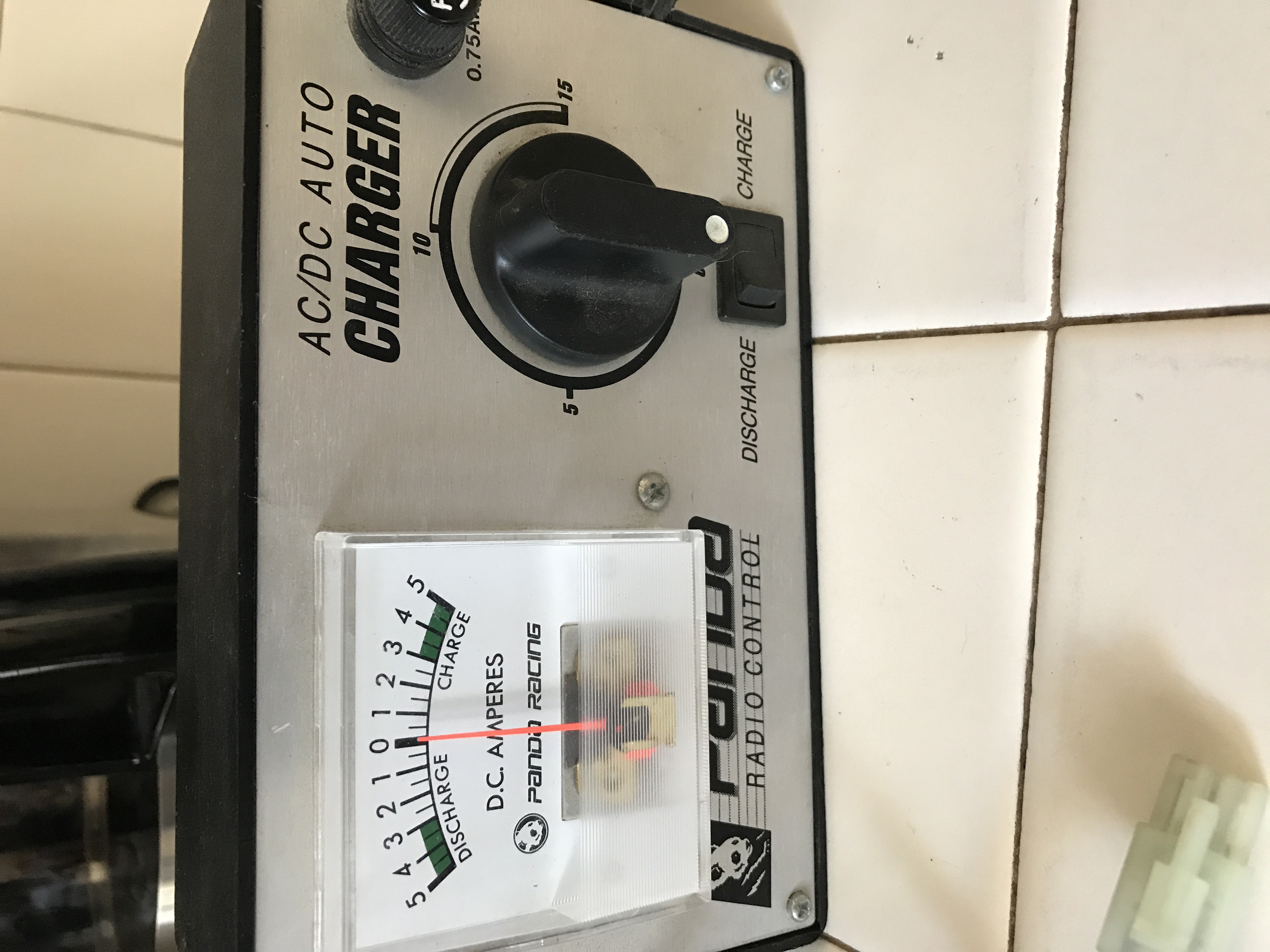

Since verified that the car is working, if the charger is working as well you can simply get a NiMH battery with a tamiya plug.
It would be something like this one
https://www.amainhobbies.com/onyx-6cell-7.2v-subc-nimh-battery-w-tamiya-connector-3000mah-onxp5311/p-qtaqtsrq6m2xactz
Most of the batteries will cost and perform alike. You can get them from Amazon or anywhere.
There are larger capacity batteries, but you may need more than the 15 minutes on the charger to charge.
Some others can chime in here, but the plastic can dry out over the decades on these cars making them brittle and easier to break. It be worth it to dissemble the car and soak the white plastic parts in water so they get more flexible.

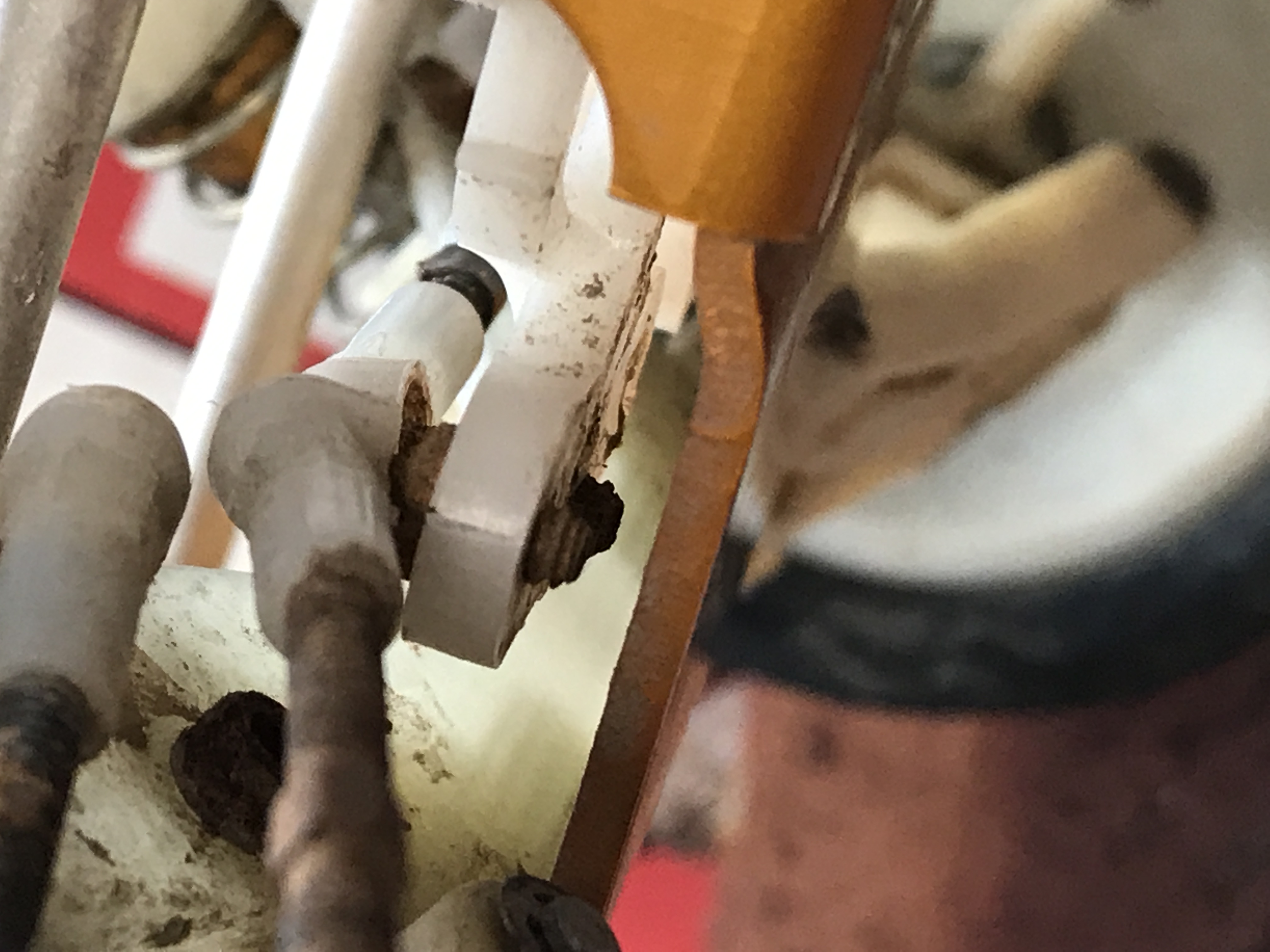

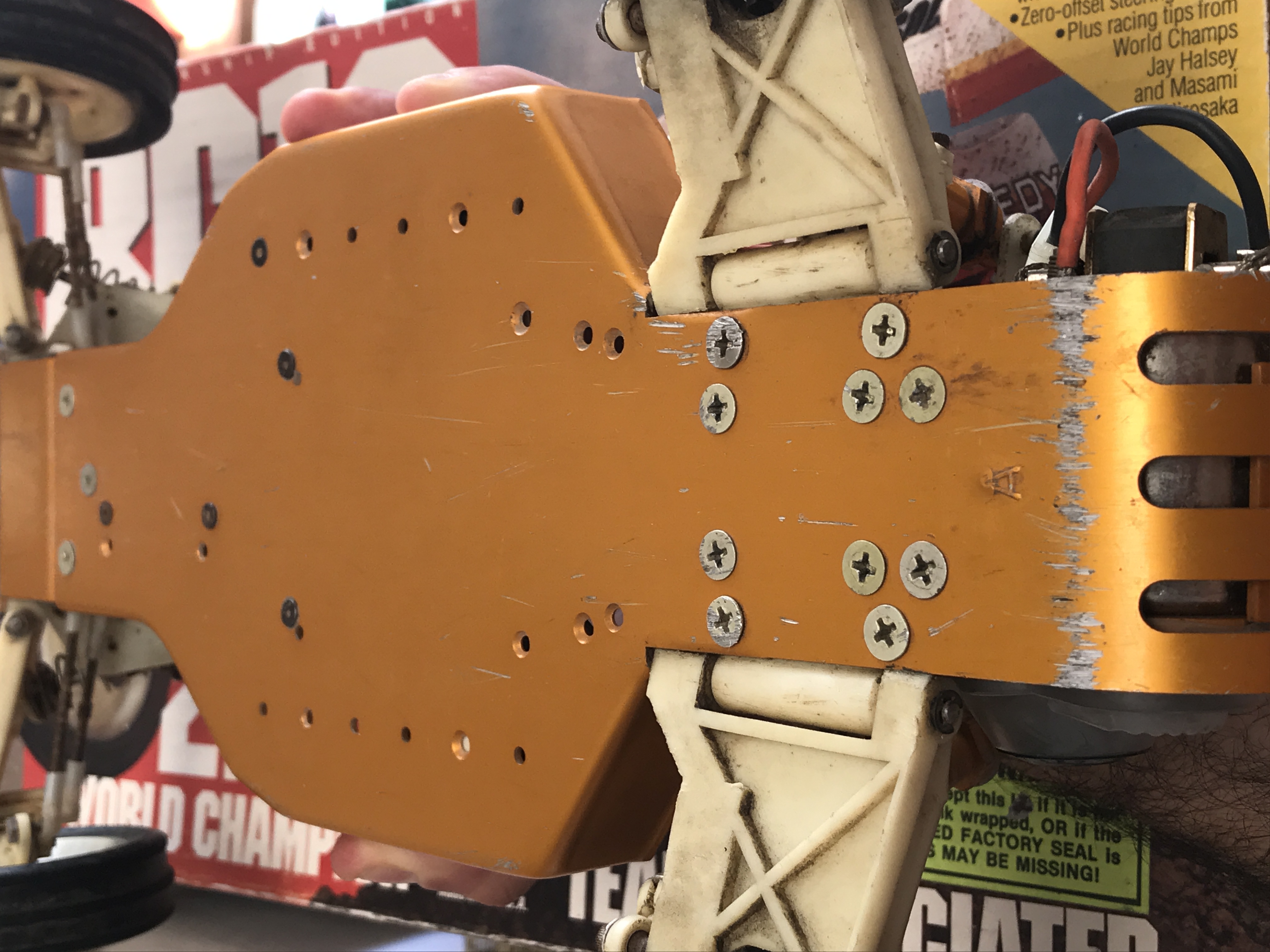

You are right about the brittle plastic. I took a better look at the car and saw that it had a crack on both parts of the steering linkage. I think they are called the servo savers.
My plan is to tear it down and clean it up and replace parts as needed.

Those servo savers were extremely prone to cracking and being sloppy. I have several with small cracks.
You can still find aftermarket bellcranks that are a huge improvement. Then use a servo mounted saver.
