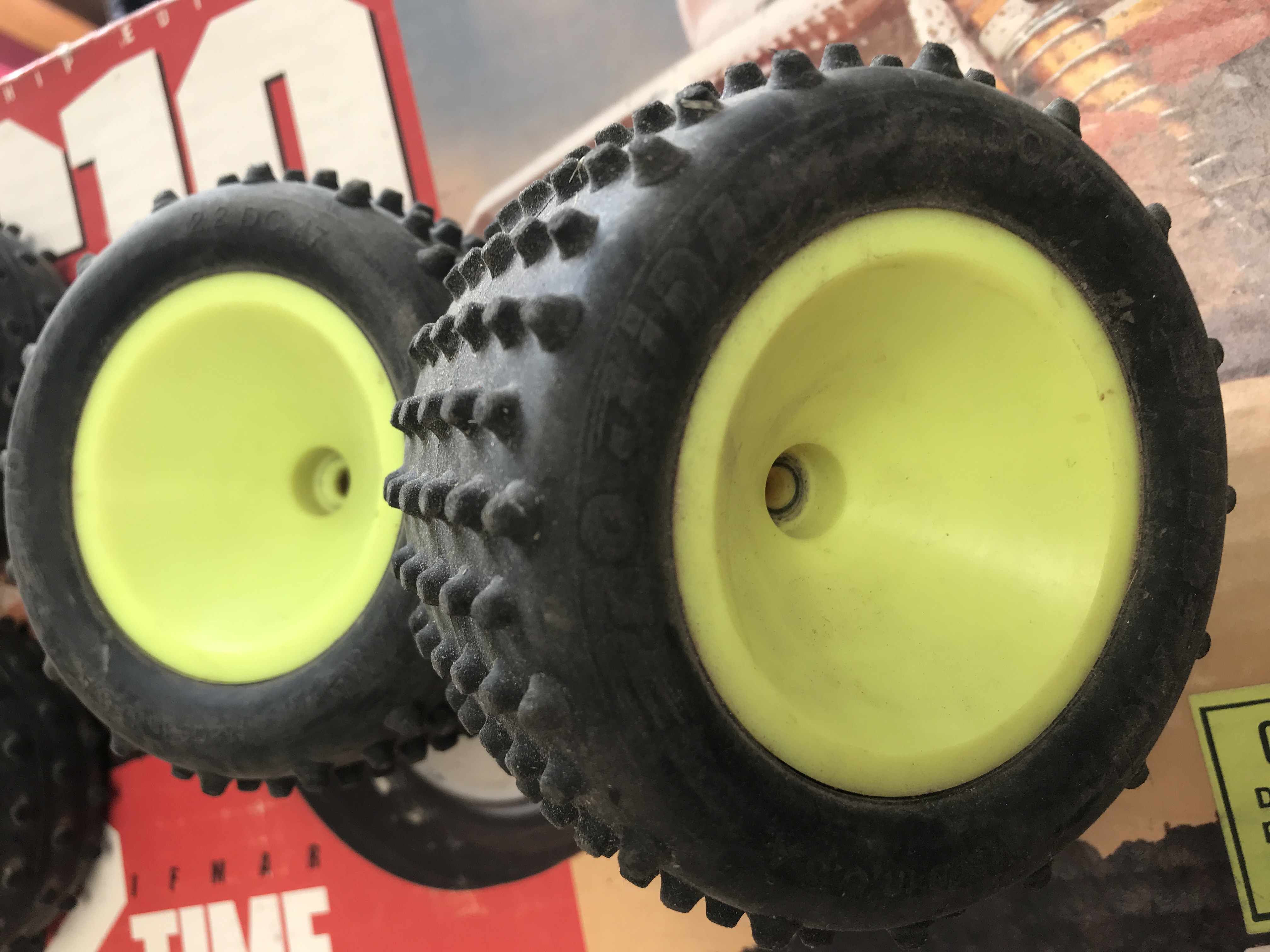

I paid $175 for the car, controller and a few extra wheel/tires and an old battery charger. It
looks pretty much exactly like the car I had when I was a kid. The box looks the same too, so I’m assuming it’s the same model that I had.

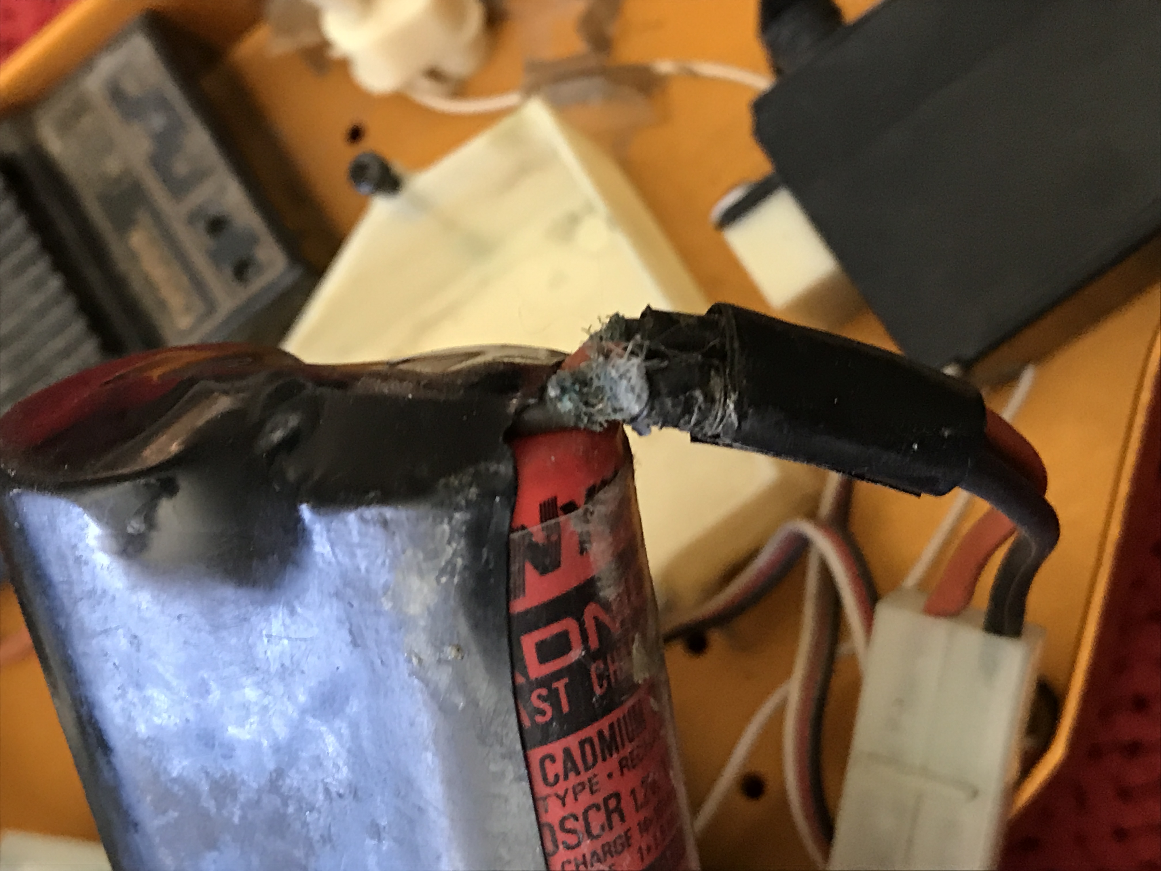

Anyway, long story short. The car still runs! I was amazed. But it needs a new battery. The positive and negative wires are frayed.
Any suggestions on what battery to get would be helpful. Thanks. Vinnie

Since verified that the car is working, if the charger is working as well you can simply get a NiMH battery with a tamiya plug.
It would be something like this one
https://www.amainhobbies.com/onyx-6cell-7.2v-subc-nimh-battery-w-tamiya-connector-3000mah-onxp5311/p-qtaqtsrq6m2xactz
Most of the batteries will cost and perform alike. You can get them from Amazon or anywhere.
There are larger capacity batteries, but you may need more than the 15 minutes on the charger to charge.
