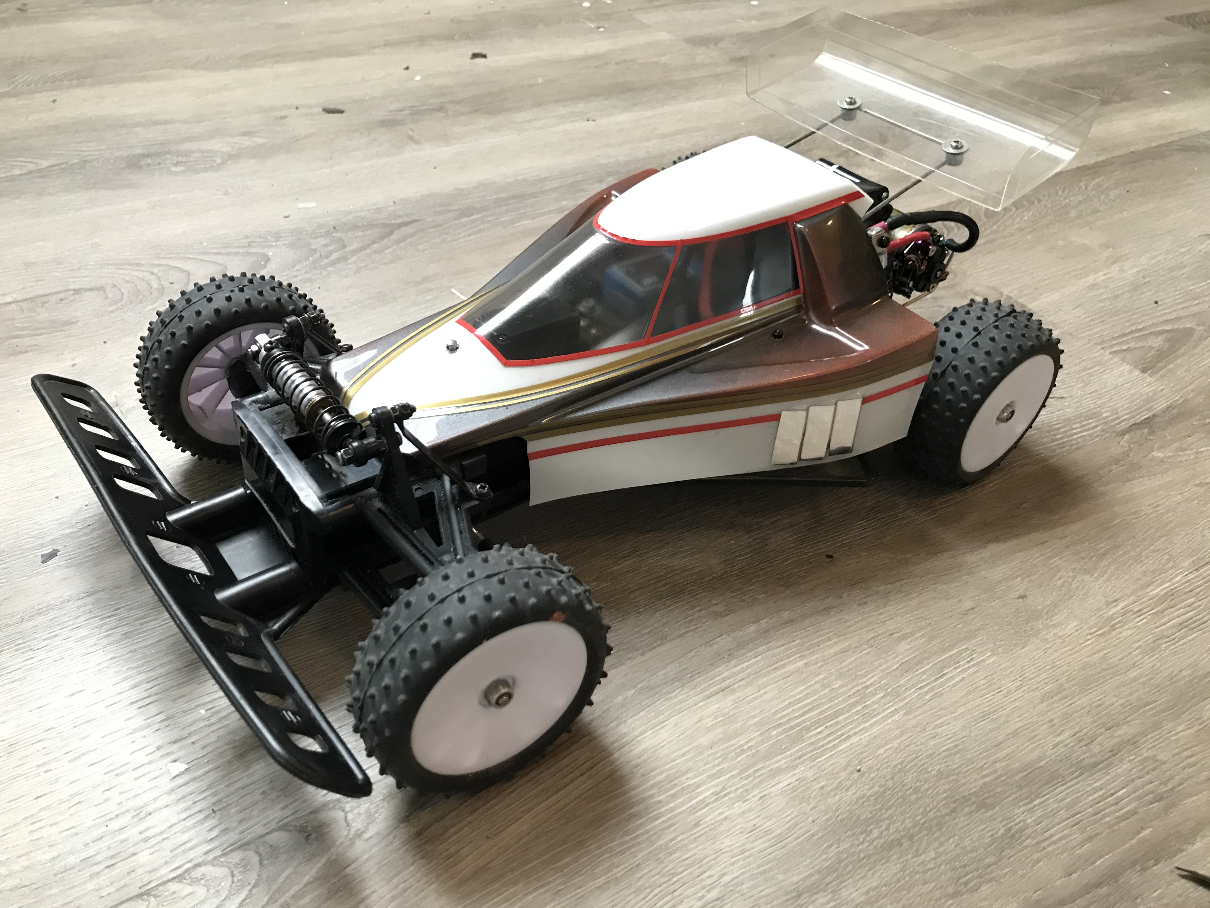

The build is still ongoing but being kept under my hat till next months build of the month contest

Been busy Printin ! I got quite deeply inspired by the Prototype White Samurai's that were sent by the Marui team to the 85 worlds , ever since I saw them I was in love
White parts are all Printed in Polycarbonate except the main chassis that's original and painted.

The Chassis is on the way though as you may have seen in my 3d printing thread , the final version is printing now and if its as good as think it will go in Shapeways with the rest of the parts

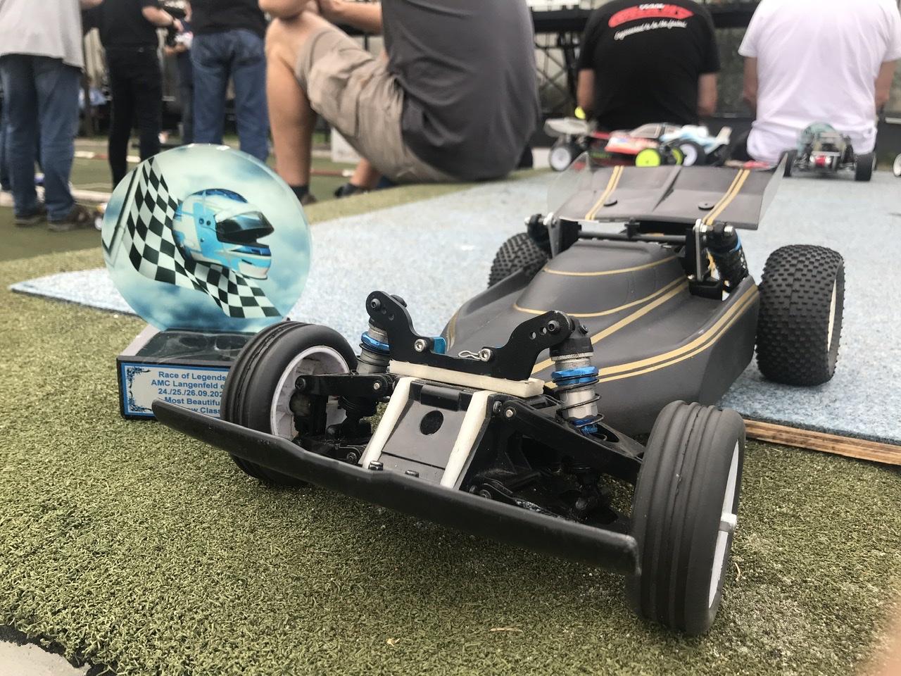

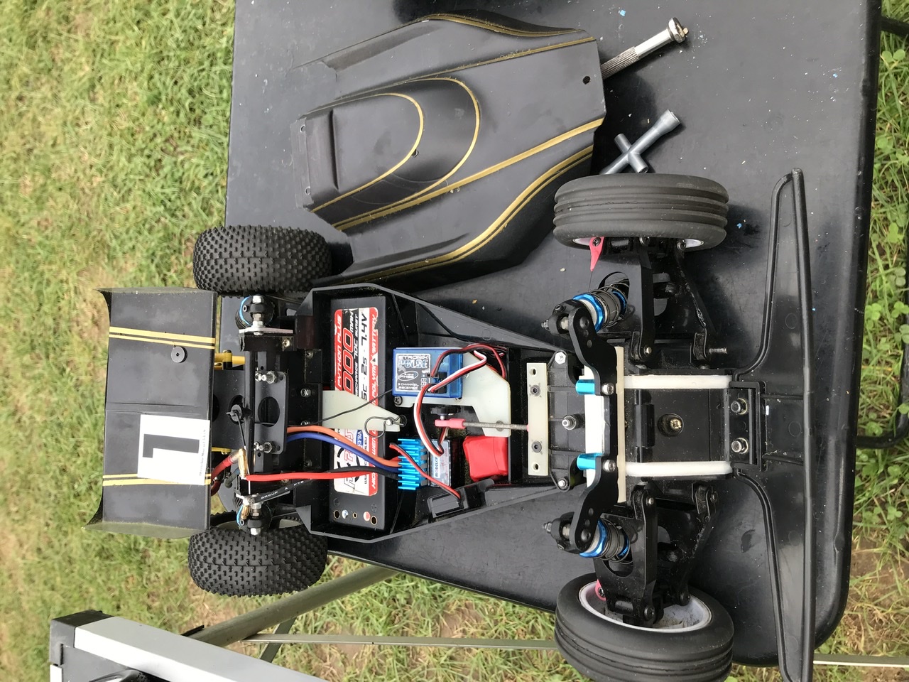

I ran my dolphin for the first time at a vintage event last weekend. The drive train : super efficient and incredibly silent : the opposite of my expectations for a chain drive. Nothing got permanently damaged either but it popped out a front dogbone within 30 seconds from the start and a rear wheel came off in the the practice round. It quickly became clear the front end needs travel limiters to reducie the chassis roll in corners. And I lost the rear wheel again in the last minute of the heat.
Overall I'm clearly not ready but it lasted and shows itself worthy of some more effort on my side.

Popping drive shafts and wheels falling off sounds exactly like my memory's of racingMr. ED wrote: ↑Sat Oct 02, 2021 12:21 pm I ran my dolphin for the first time at a vintage event last weekend. The drive train : super efficient and incredibly silent : the opposite of my expectations for a chain drive. Nothing got permanently damaged either but it popped out a front dogbone within 30 seconds from the start and a rear wheel came off in the the practice round. It quickly became clear the front end needs travel limiters to reducie the chassis roll in corners. And I lost the rear wheel again in the last minute of the heat.

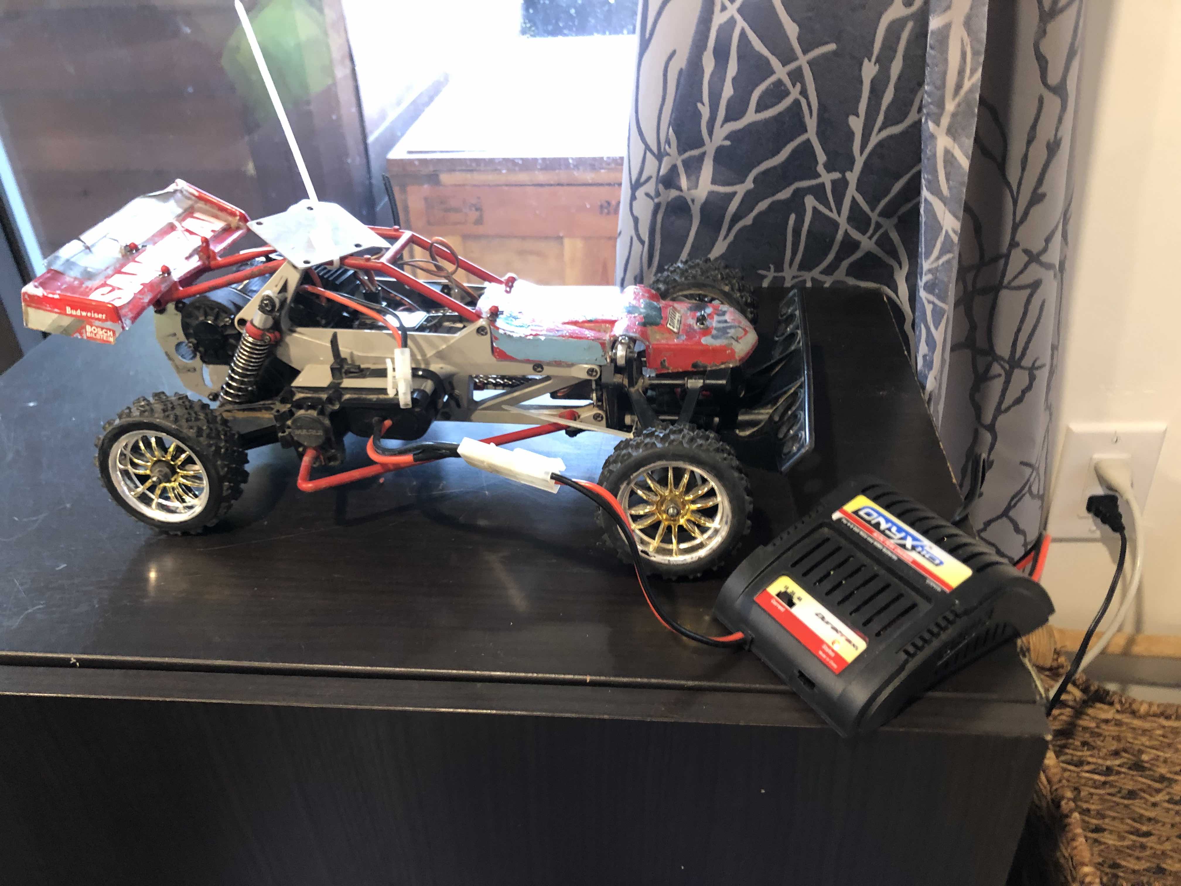

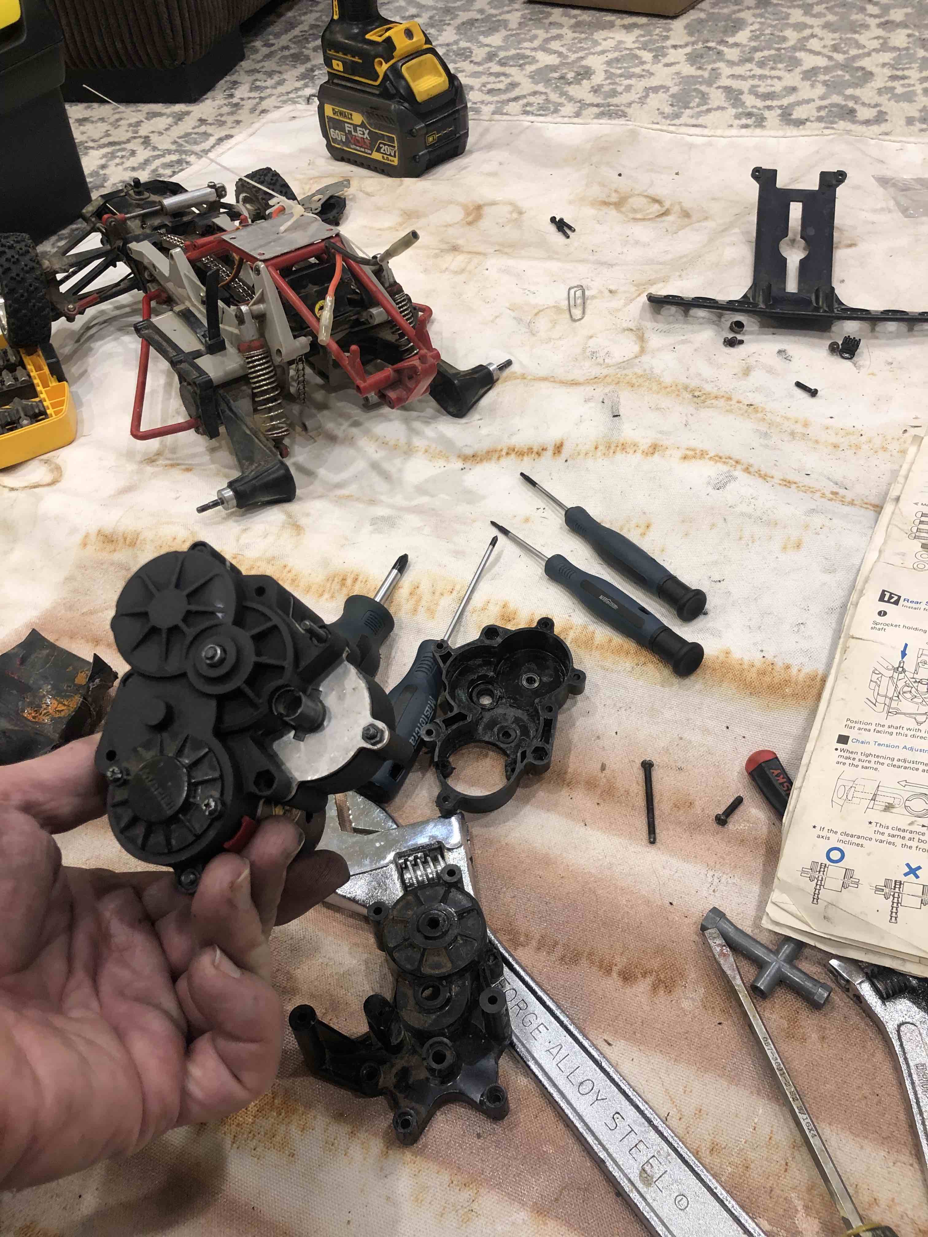

Quick update - shapeways GB received a few weeks ago, bearings last week. Put it all together in a messy saturday morning. Finished product is not as pristine as the shining examples in this thread.... but the GB came together really well, and the 35 year old gears mesh better than ever. Charging yesterday, waiting for a dry day with my 7 year old to go take it for a rip!
Agreed on some of the bearings seats... a little tight but with a soft mallet whack they all went together, the rear diff feels like the bearing seats could probably be drilled out just a little more but I didn't want to risk causing anything to get loose, so just went with it as it showed up.
Also worth noting this thing wont have run in 4WD since about 1990, looking forward to that. any recommendations on a replacement motor that won't pull the car apart?

Glad its all together again as it should be
, motor wise if its brushed I'd go 21 turn or more or if its brushless then 17 turn is pretty safe .
