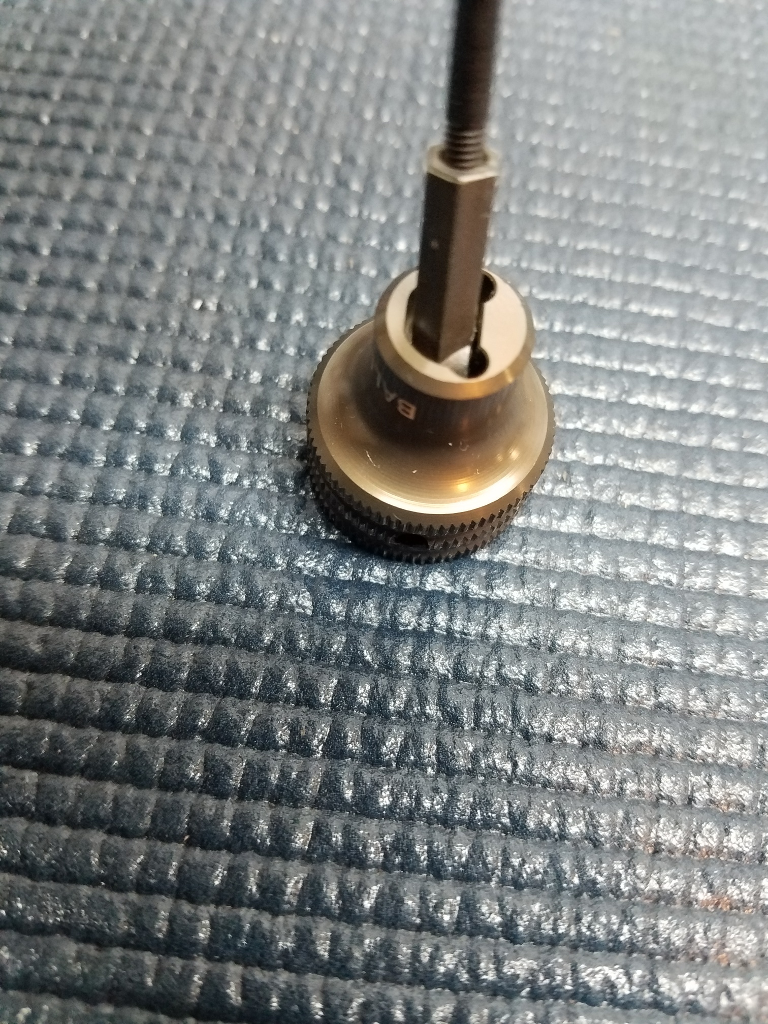

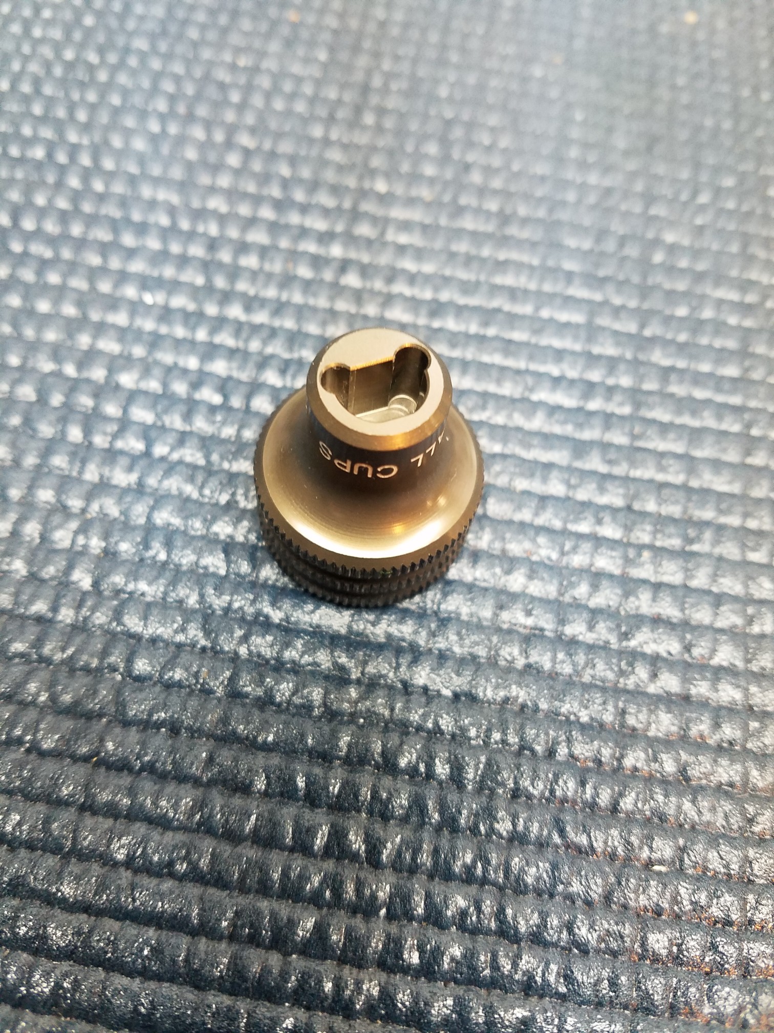

I use Team Associated ball cup wrench ASC1579, which works the exact same way as the ProTek unit. The end of the wrench has an opening, just like a nut driver but it's ball cup shaped instead of hex shaped. I prefer how the Associated unit is held with using your finger tips. It works nice and easy.
Here's a couple pictures of it. That's an Associated ball cup ASC7230.

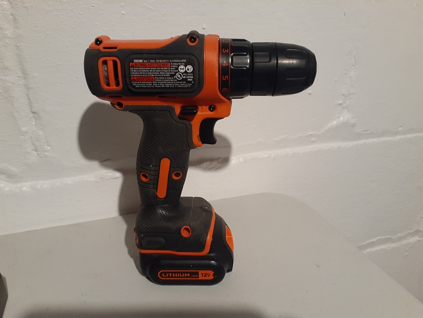

I hate making up turnbuckels so I use a drill with a little chap stick on the threads .

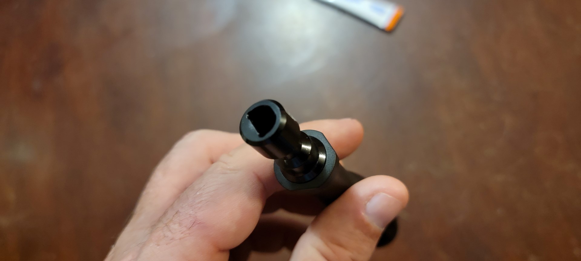

I just got this tool in the mail yesterday and have not used it yet. I have also ordered some of the other ones that are available on amain but they have not arrived yet. Here are a couple better pics of the Protek tool for you.Frankentruck wrote: ↑Fri Jan 07, 2022 4:45 pm Does anyone use a ball cup tool? I thought about getting the ProTek PTK-8467 ball cup tool but from the picture it isn't obvious to me how it holds them and if some are too big or too small to be held. Does this tool work well with AE and RPM ball cups? Does it also work with ball links? Or is there something available that works better?
