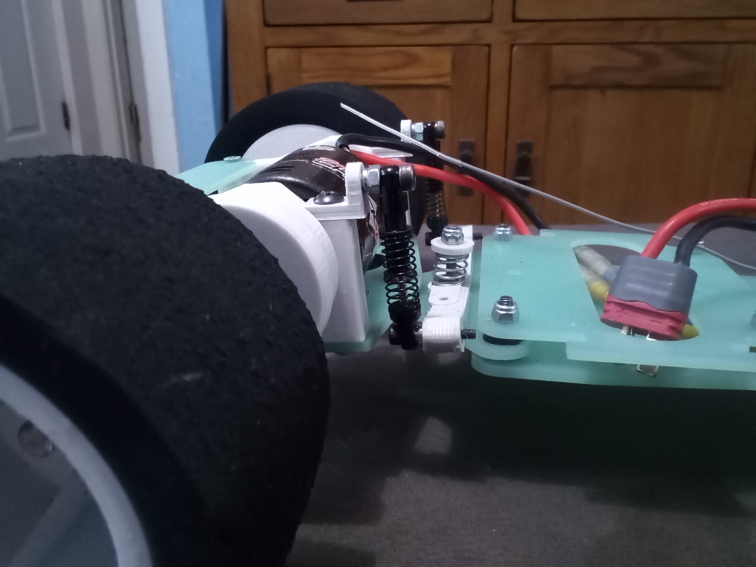

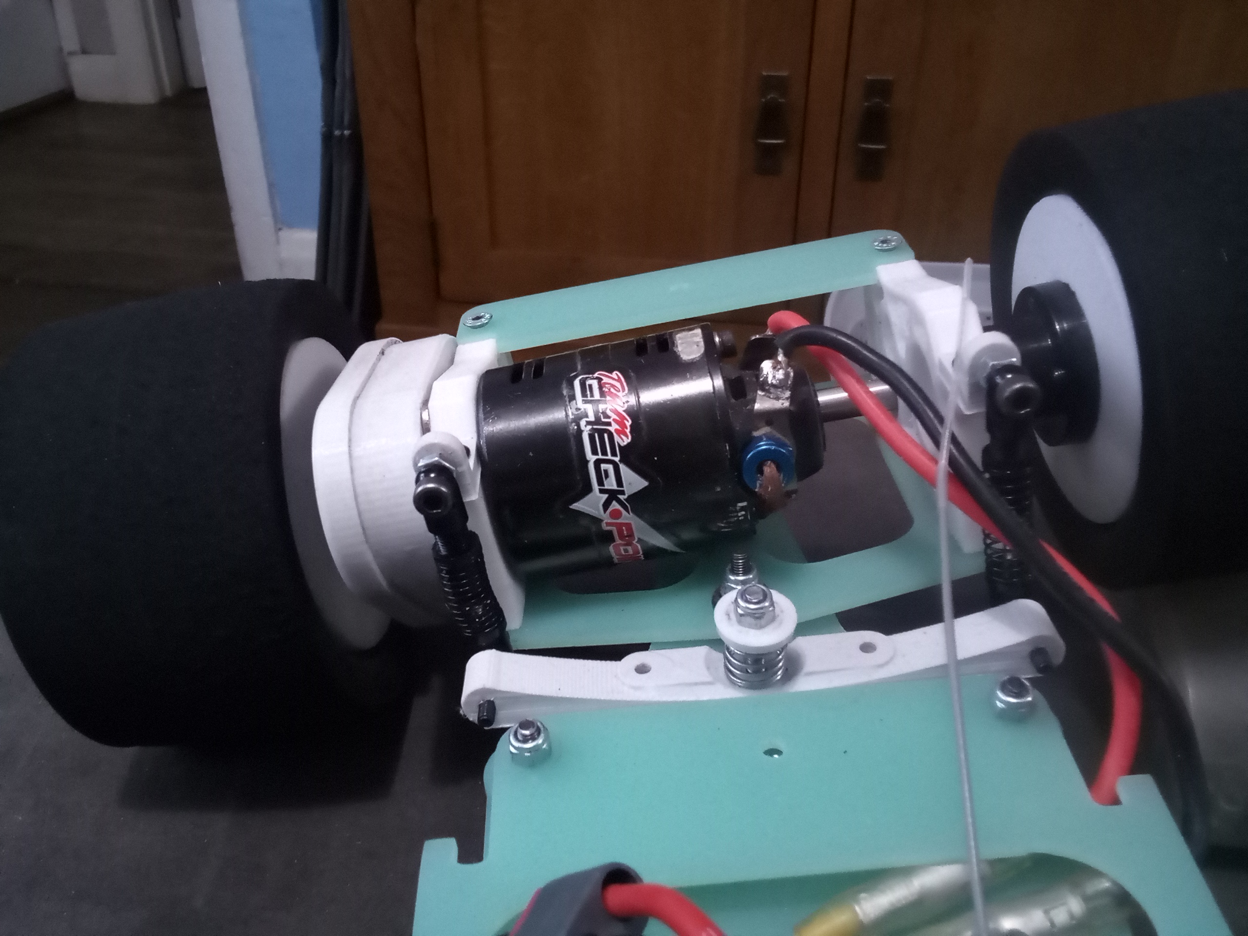

Thanks , these tires are very tight to manoeuvre about on the rim so I don't think contact cement without the turps is a good idea , I may try the turps on a waist PC printed part to see what it does .

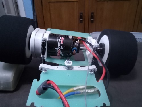

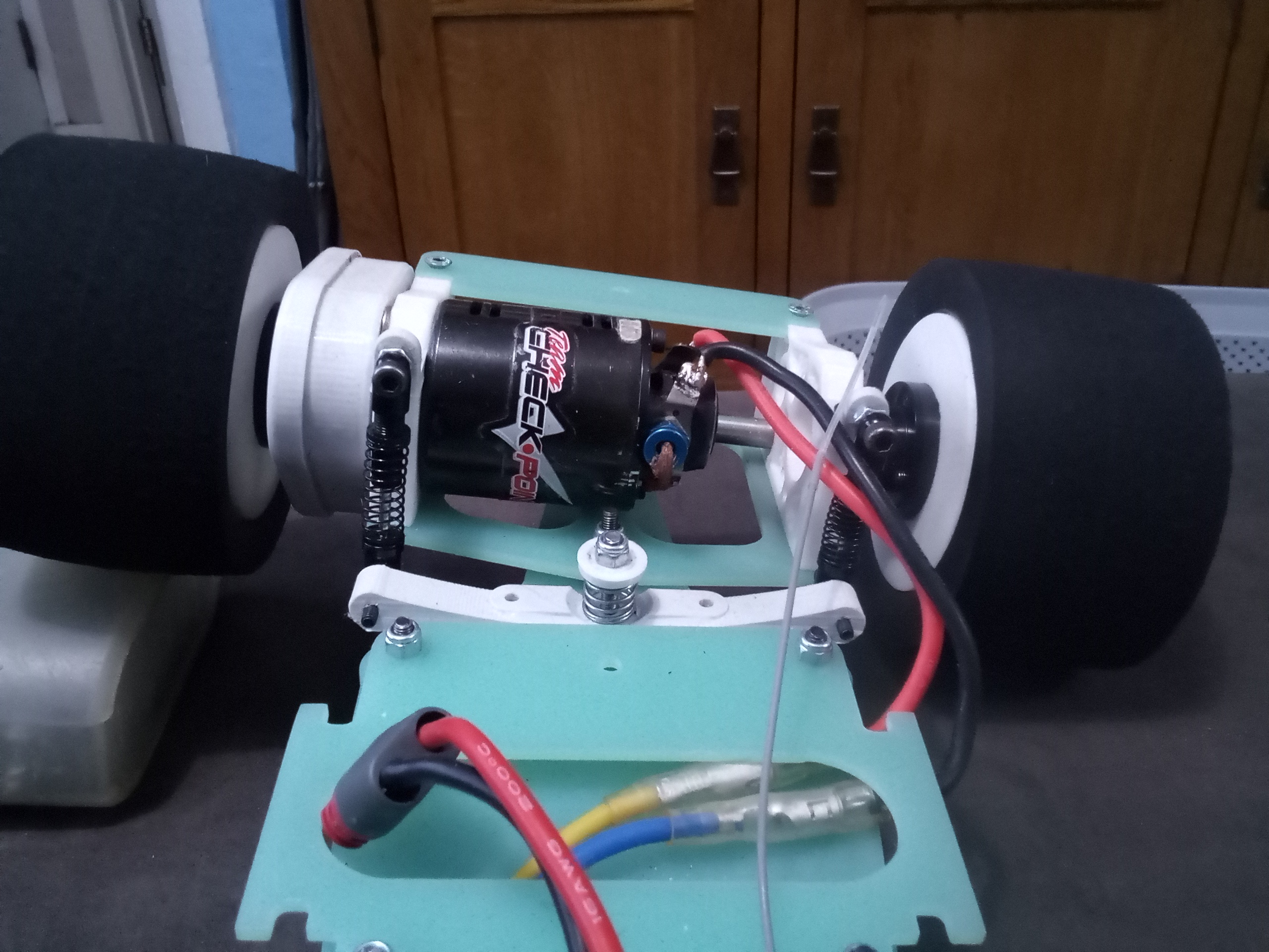

I fitted the tiny rear shocks , they work really well but I now only have damping in roll because of how the suspension works .

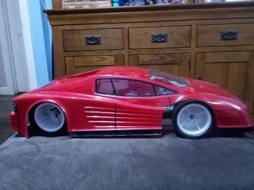

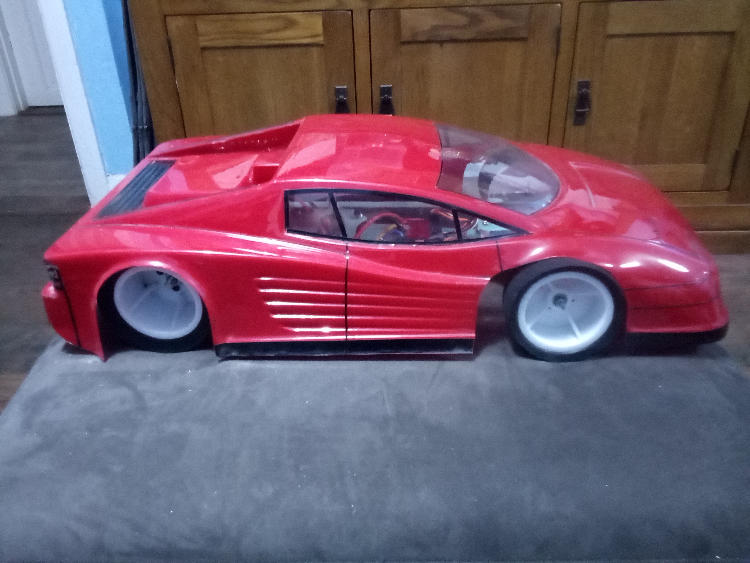

This is a possible body choice , it's been kicking around for a while after coming with a PB Mini Mustang

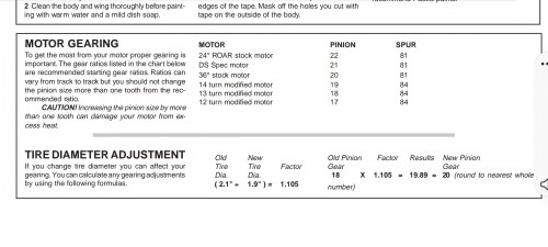

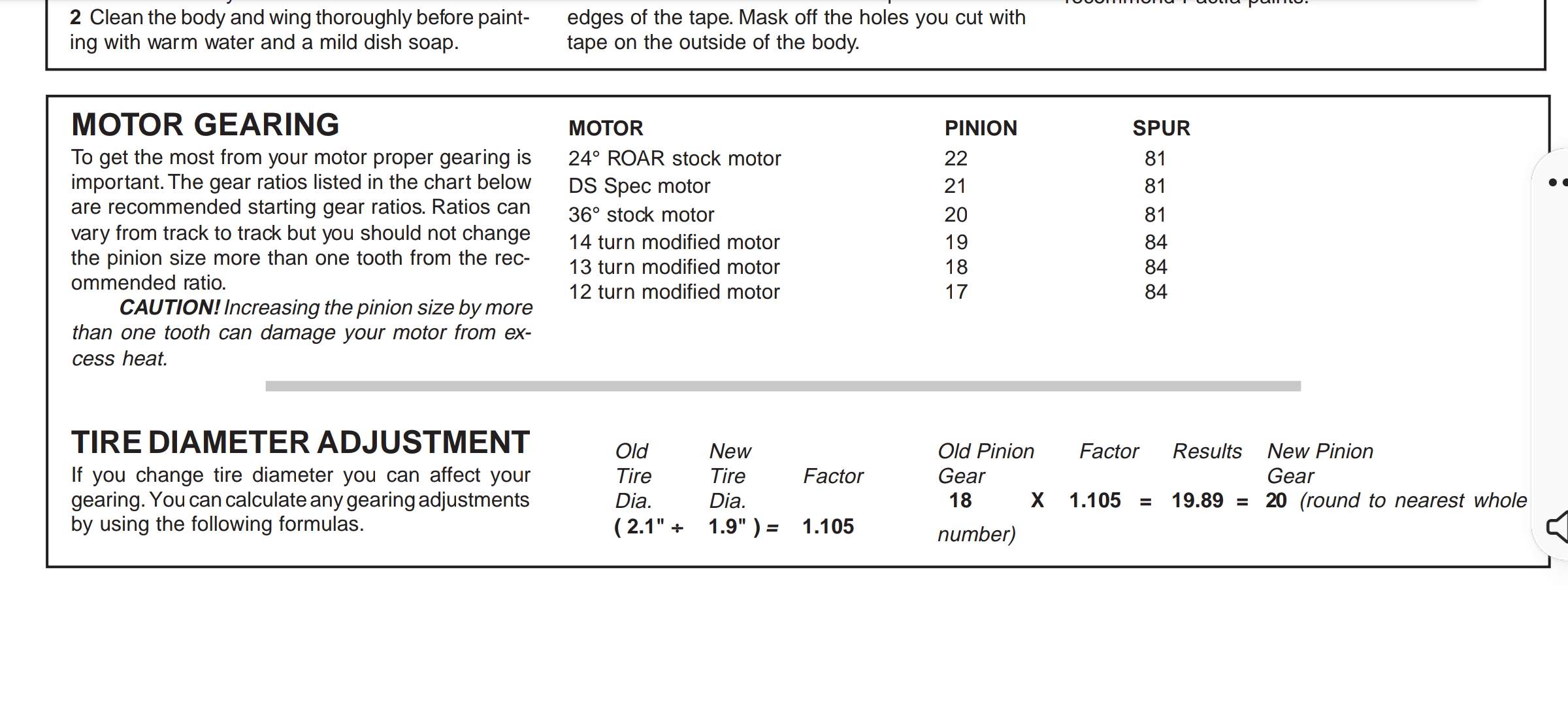

From the RC10L2. It also has adjustments for tire diameter. Should be a good start.Dadio wrote: ↑Wed Jan 26, 2022 1:04 pm Next question is what kind of gear ratio to use , I was using a 13t pinion with a 54t spur giving 4.15/1 , it felt over geared so on instinct I ordered an 11t pinion to give 4.9/1 , that still seems high to me but I've never driven a rig like this , anyone have a pointer on gear ratios for this with a 12turn motor ? The ESC felt quite warm after a short test run and the motor was warm but not too bad .

54/9 (6/1) is the gearing that I chose for this car, with an 11T triple. However I intend on running slightly taller F1 rubber tires.
https://www.rc10talk.com/viewtopic.php?f=33&t=46756

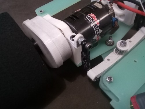

Ran way better with the 11tooth pinion but I've had to do a lot to the steering to get better lock but I've not trued the front tires yet so I'm hoping that helps too , very fast though but the ESC is just not giving me any brakes at all so that has to go .

How bad does that star servo horn throw off the steering geometry? I always try to get the ball cups as close to each other as possible.
