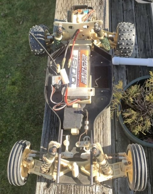

can you send a picture of your car? Does it have a metal pan ?That would help out.

It’s in pieces now but this was before that.

rwordenjr wrote: Tue Apr 05, 2022 1:07 am It’s in pieces now but this was before that.
thats a nice looking car. I am not certain of the wheels you need but they exists. As well you can find tires for the original rims and hex adapters for the 1/4" rear axles to fit modern hex wheels. Make a separate thread.
