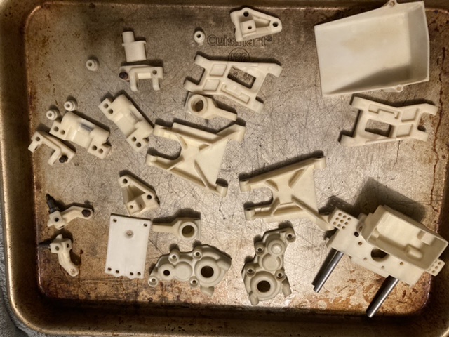

Soap and water did good

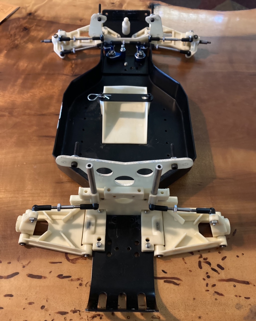

Got done what I could today. New e clips and ball studs. Still waiting on the new hardware set and bearings.

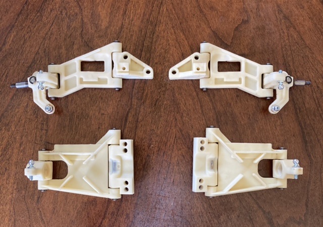

JosephS wrote: Thu Apr 07, 2022 6:53 pm That is looking quite nice. Really clean.
Coming along
