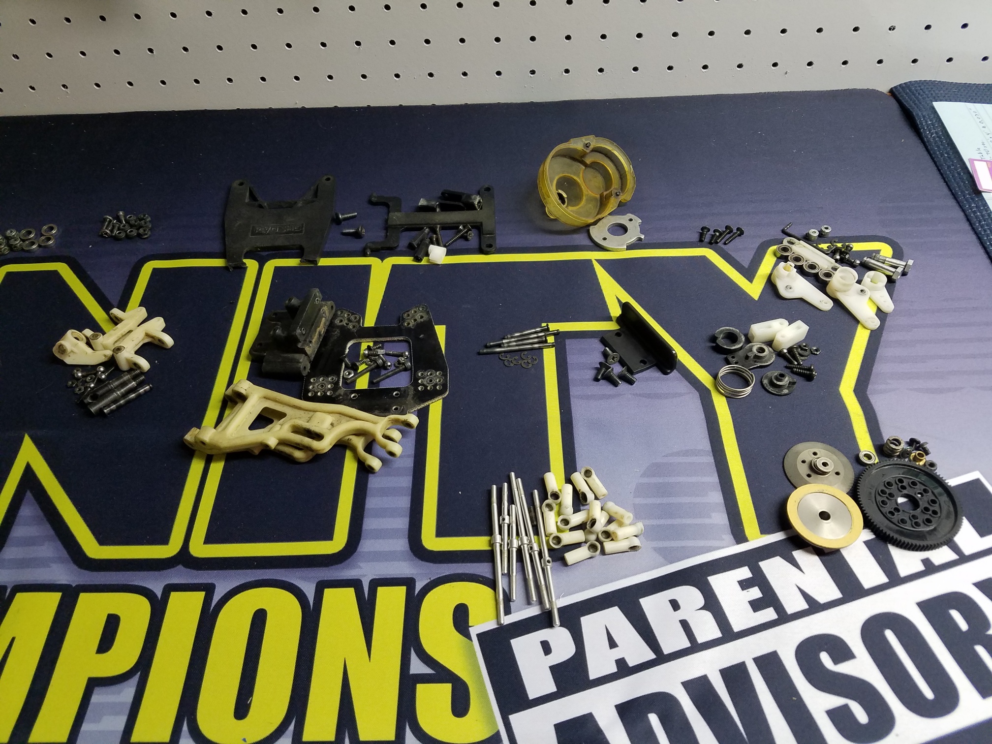

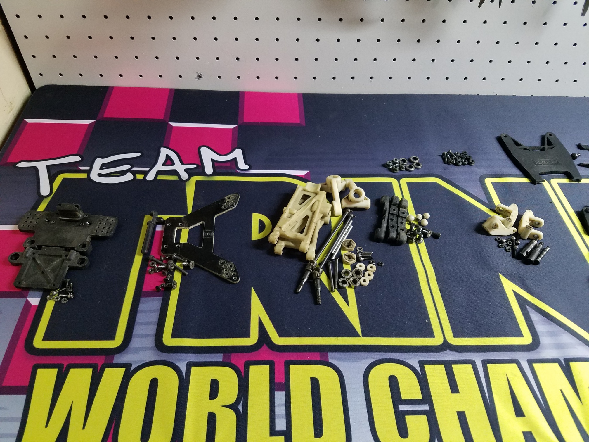

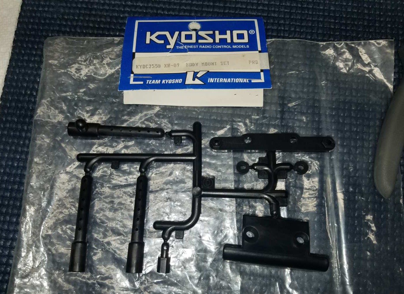

This is my Pro-XRT project I started last May of 2021. It was in a little rough shape and missing a few parts when I got it. I disassembled the truck shortly after getting it, then placed in a tote until a couple weeks ago. Plans are to replace necessary & missing parts (already done) and make it a light runner but mostly be a shelf queen that's a little rough around the edges. Because I'm not making it look brand new, it's still going to show some signs of having a past but look good while doing so.
Pics of disassembly last year in May. Pictured are a couple replacement parts the truck came with, along with some parts I found right away when I first bought the truck.

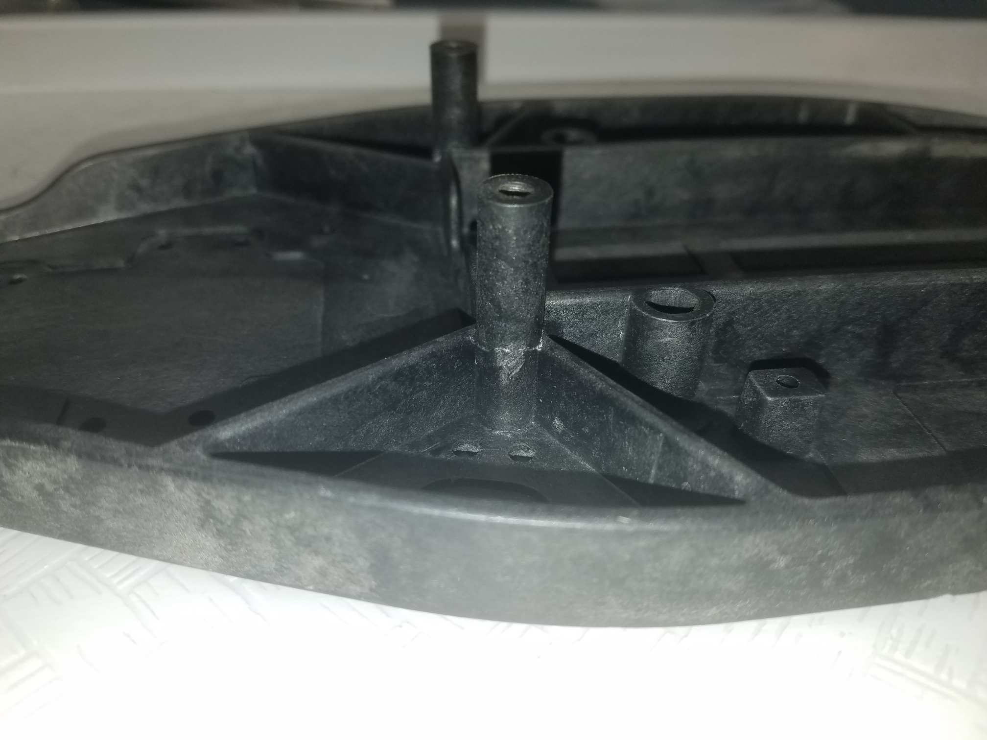

Next up after cleaning and whitening all parts, was to glue both broken chassis tabs for the front top chassis plate. Both tabs were broken off cleanly and were still bolted to the broken top chassis plate. "Loctite Plastics Bonder" was used to glue the tabs back the the chassis tub. I used two short pieces of antenna tube to hold the broken tabs perfectly straight while initially setting them to the chassis. The antenna tubing fit snug into the bolt holes and worked perfect. This stuff seemed to work extremely well, I tried quite hard to pull the tabs off after waiting more than a full day for curing.

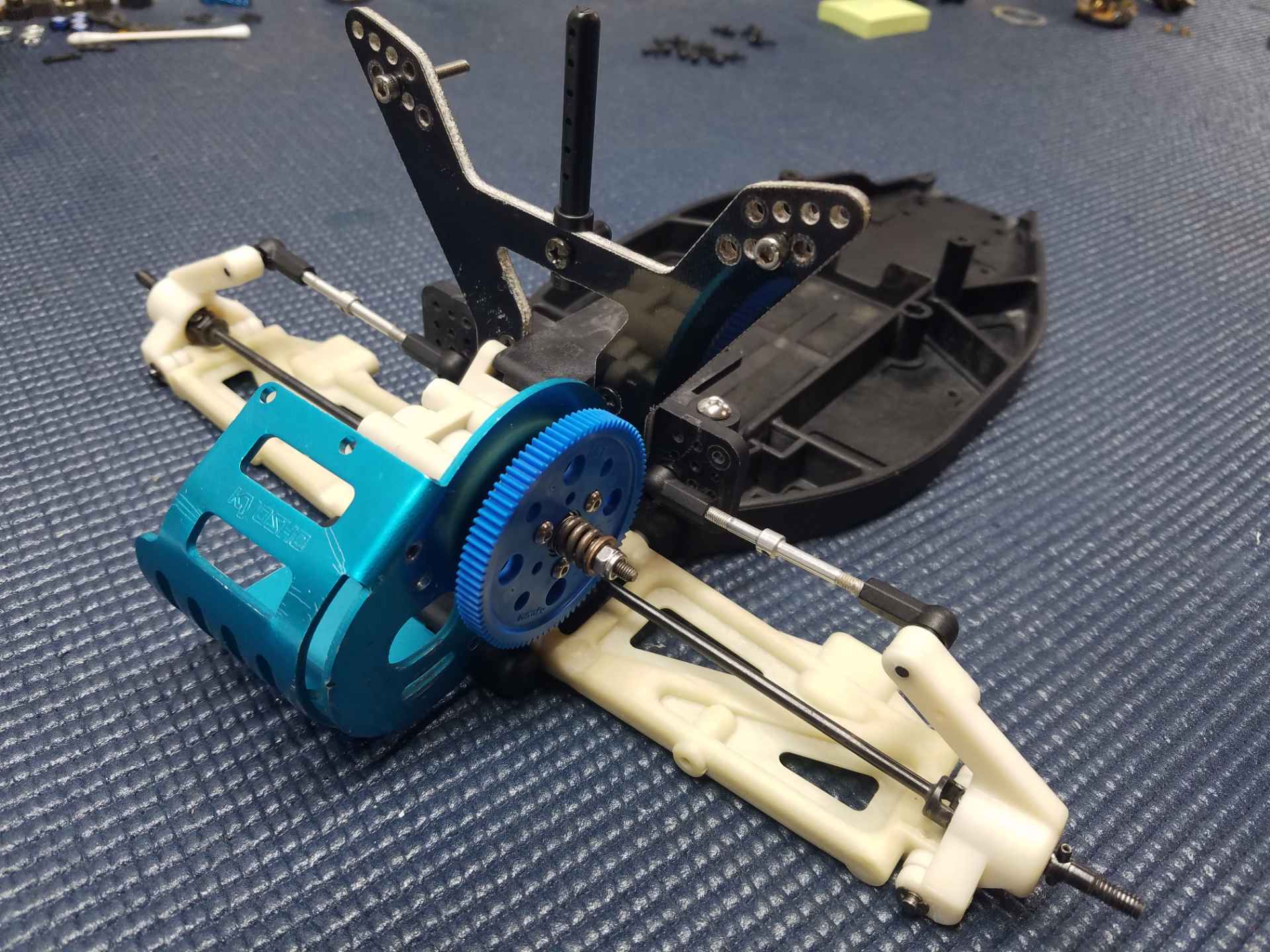

Trans, rear arms, hubs and tower mounted up.
-Jerry-

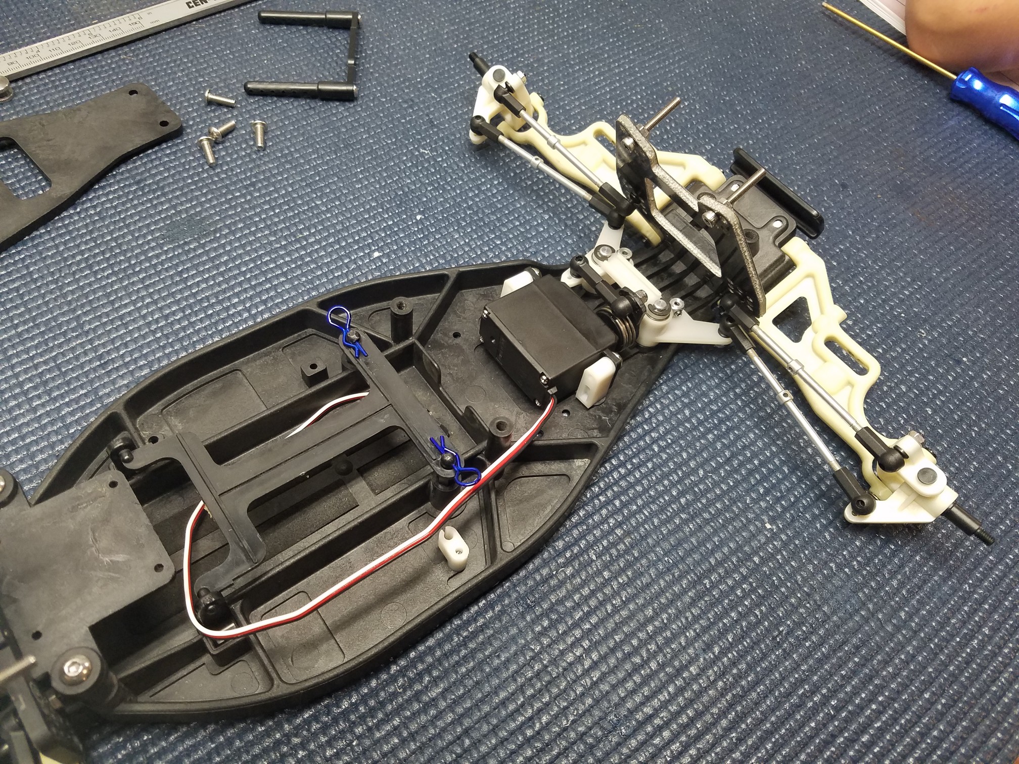

Post by R6cowboy »
Front end together and Futaba S3004 servo mounted. Had to drill out all ball stud holes to fit the new 3mm threaded studs in lieu of the original 2.6mm threaded studs.
-Jerry-
R6cowboy
Posts: 1484
Location: Mendota, IL
Has thanked: 871 times
Been thanked: 903 times
Re: Kyosho Pro-XRT stadium truck rebuild (Team version)
Post by R6cowboy »

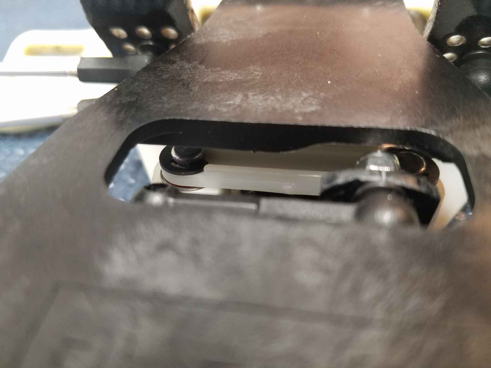

Had to shave off a tid bit from underneath of the top chassis brace for clearance of the nylon locking nut on the backside of the servo saver ball stud.
