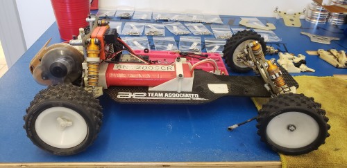

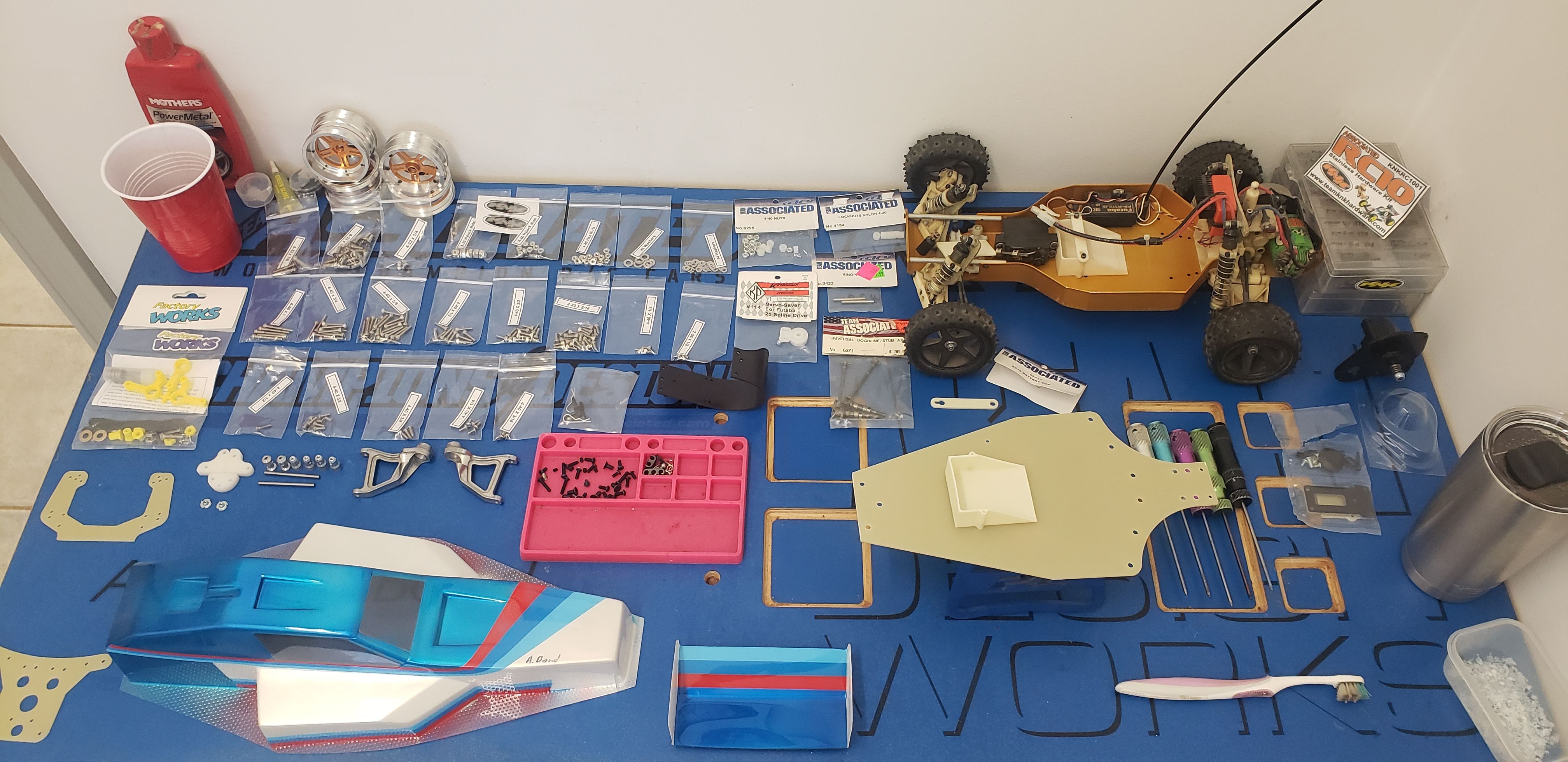

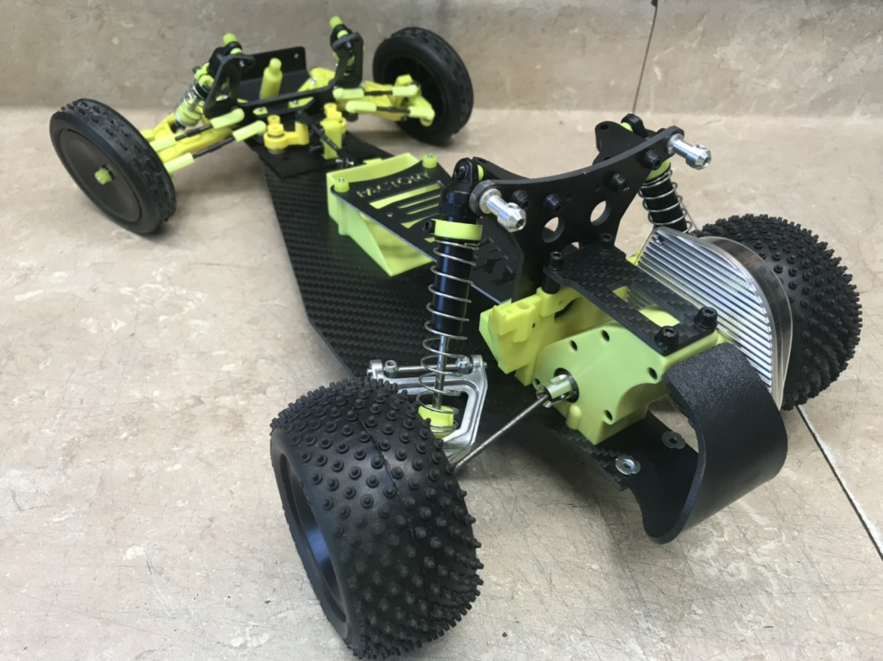

I feel like noobe all over again. I started this build years ago when painting an extra body I had lying around. After sitting on it awhile I've finally decided to pull the trigger on the A&L chassis kit. I opted for the 4 hole front tower and fiberglass chassis.
There will be some waiting on select parts, so this will be built on pace with someone Jason's builds... unless he has gotten quicker at his builds over the couple of decades :P
Here's the starter pic.

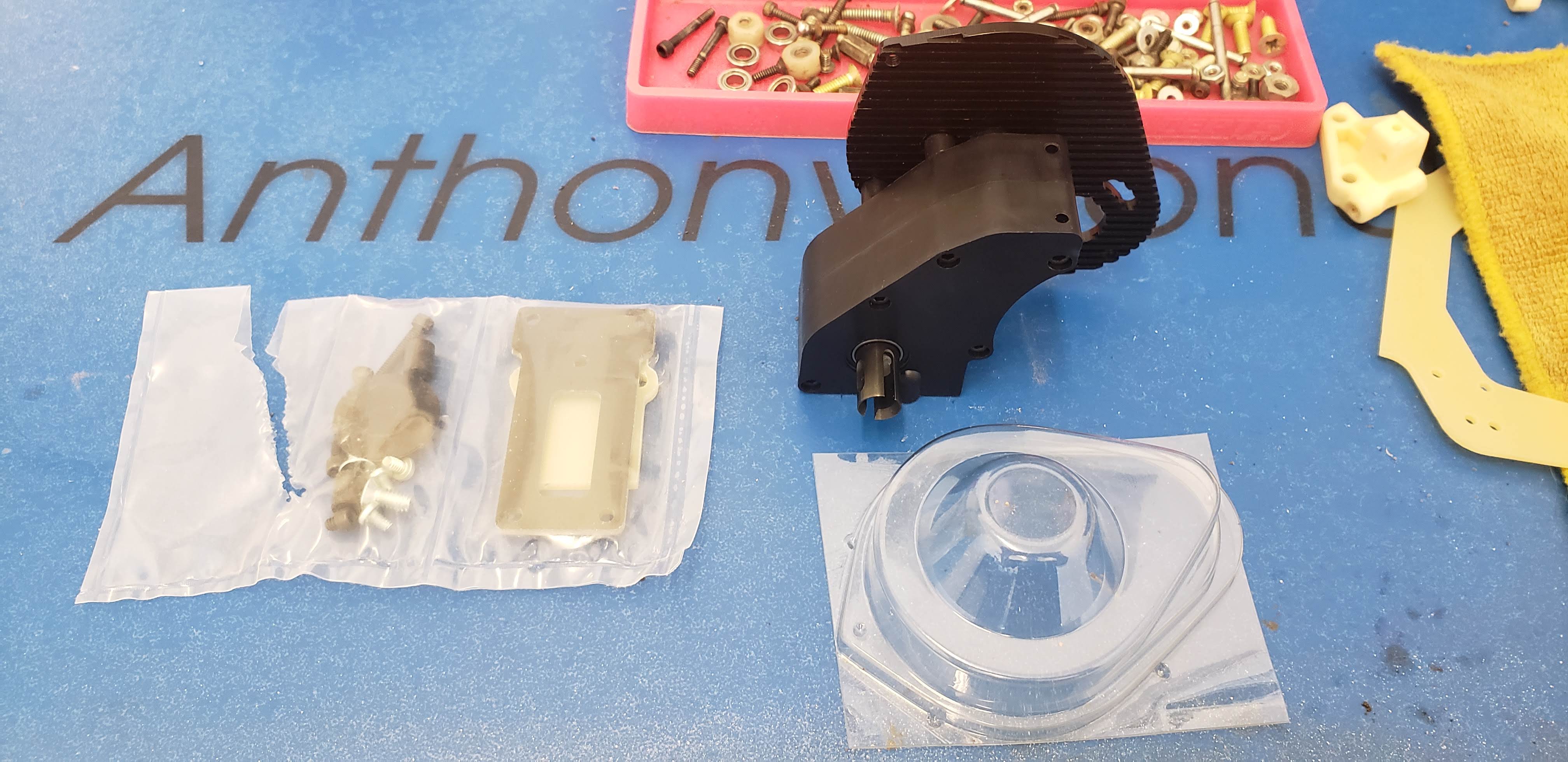

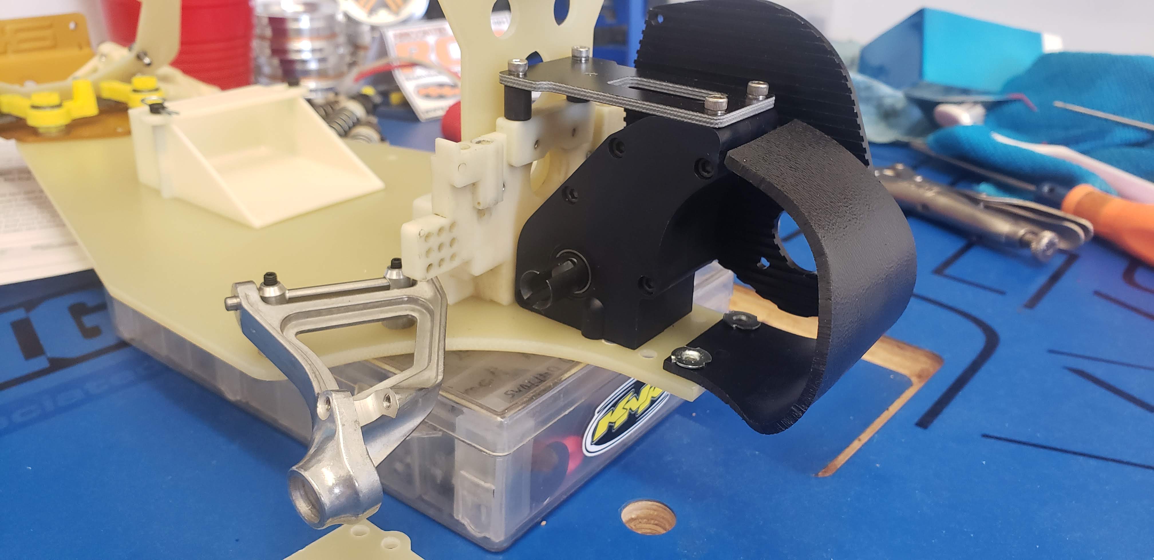

MarkyDents wrote: Sat Jun 25, 2022 8:35 am Cool build, the black trans…. Lethal Weapon ?
Yes sir. It doesn't look like it will bolt up to the A&L chassis though :?

Chassis would need to have two holes drilled out, a longer trans brace, and you would need to modify the rear bumper. They trans and the chassis were different eras, and were not really used together. That said I have built quite a few c2 with lethal weapon.

GoMachV wrote: Sat Jun 25, 2022 10:06 am Chassis would need to have two holes drilled out, a longer trans brace, and you would need to modify the rear bumper. They trans and the chassis were different eras, and were not really used together. That said I have built quite a few c2 with lethal weapon.
I'll be doing this for sure :D I can't have a new lethal weapon transmission and not install it in this chassis.

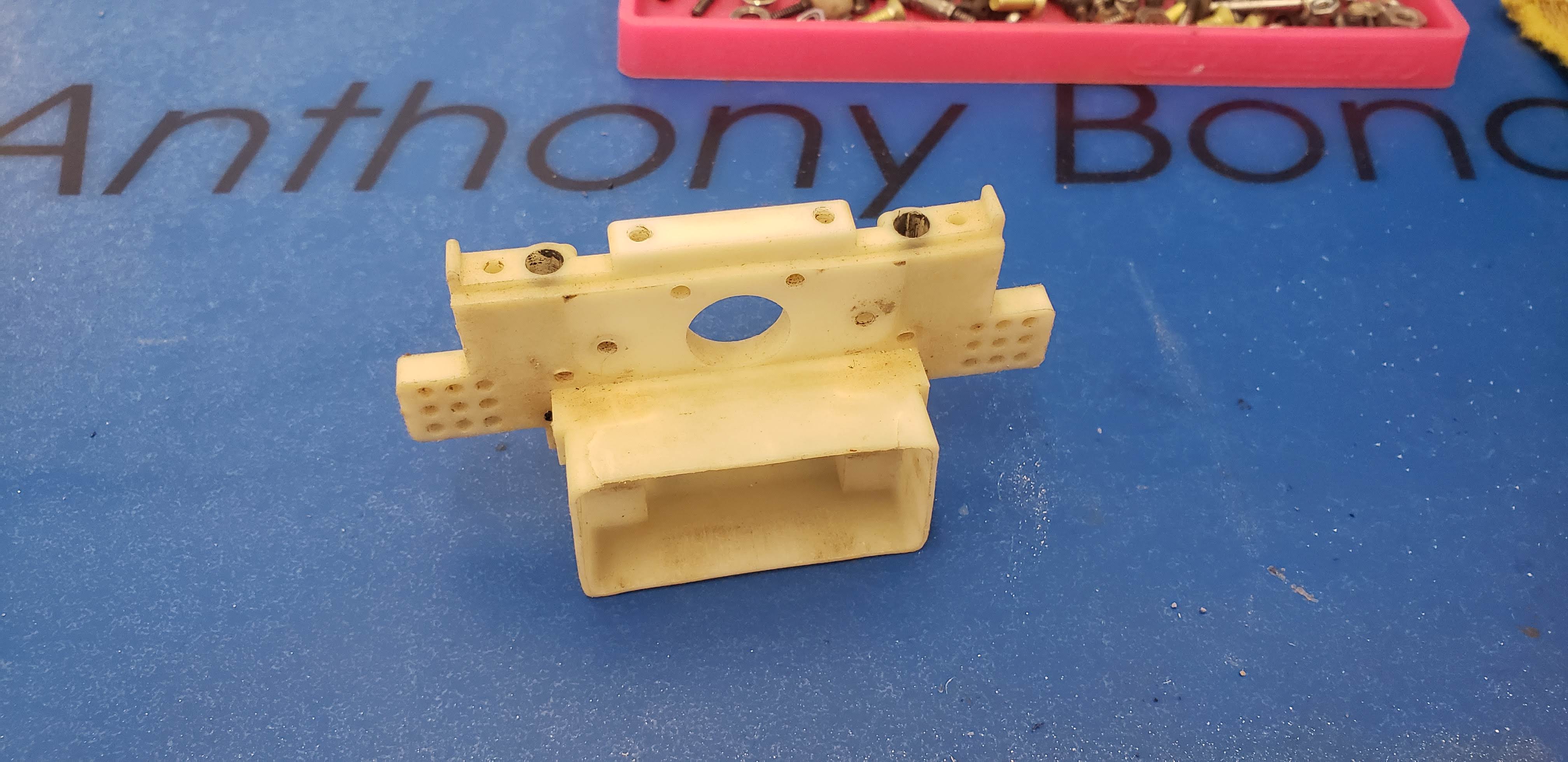

It looks like the donor Championship car with the Team car shocks is going to need help with donating parts, the rear bulkhead is cracked around the battery housing.
In comes donor number 2, a RC10 graphite. I feel so reckless tearing into a complete RC10 :oops: at least it's for a good cause.

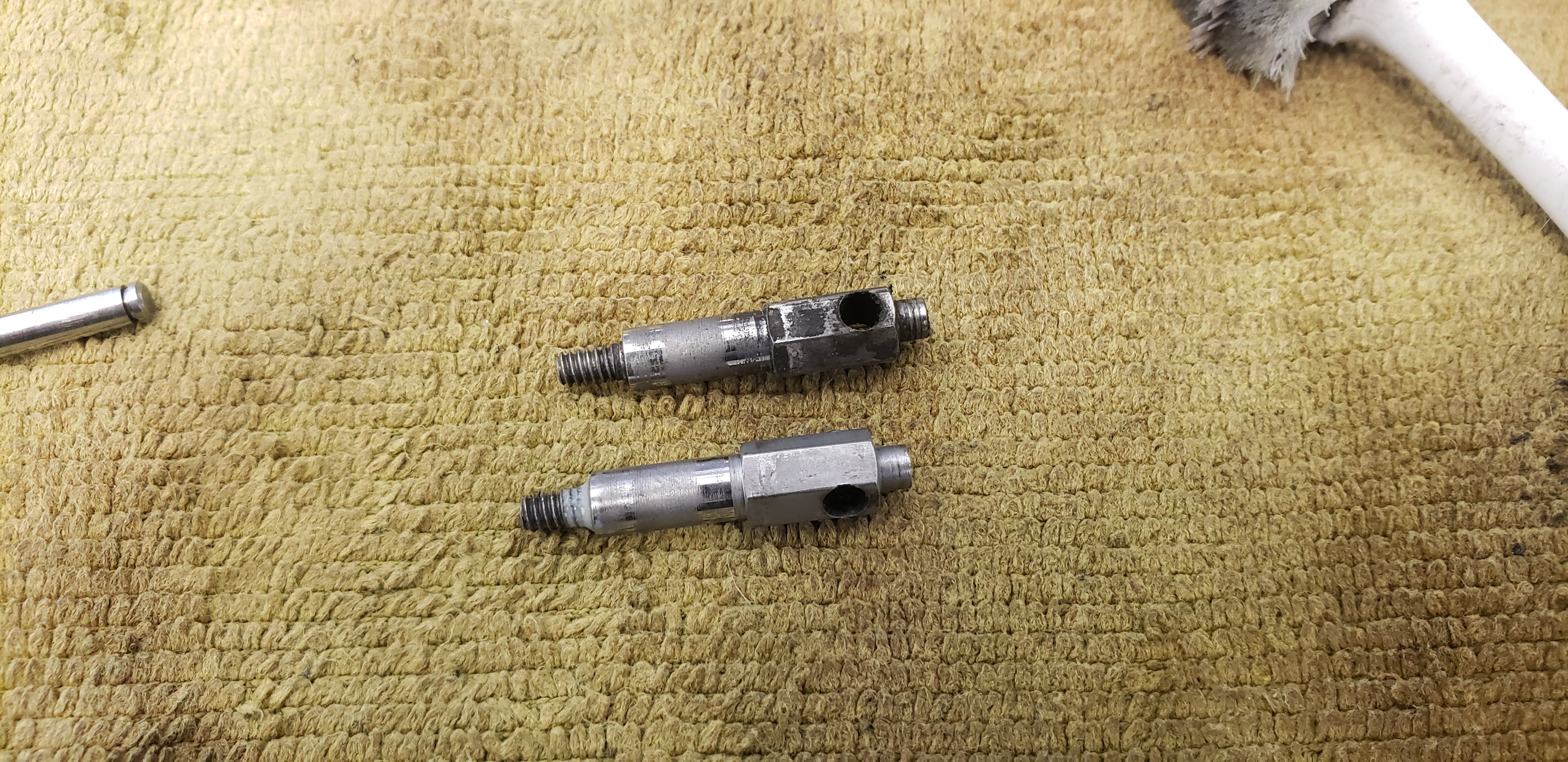

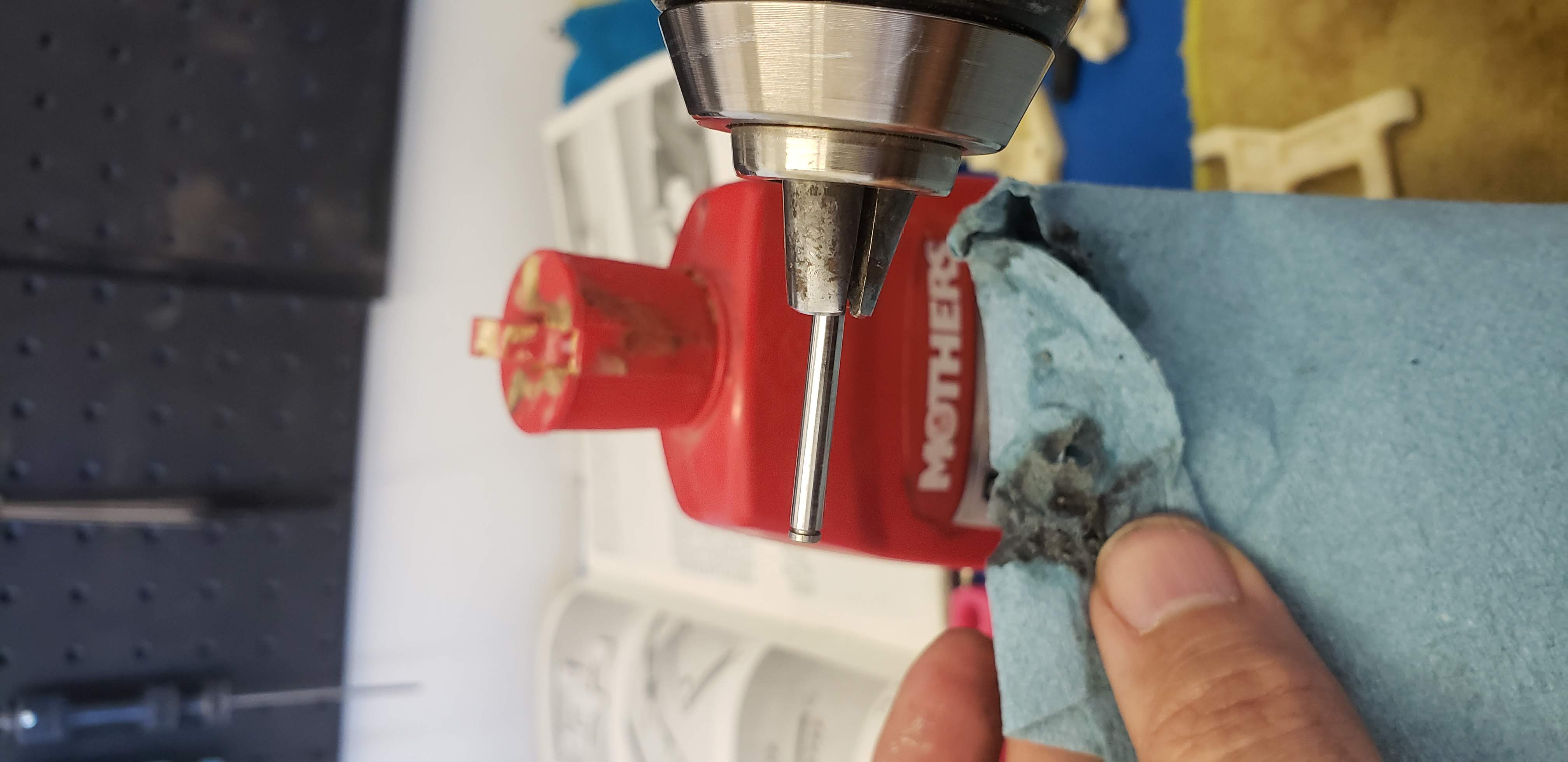

It gives me more room to polish my old balls and pins. I even stuck the front axles in the drill and gave them a once over.
Top one is dirty, bottom is cleaned.

If you didn't mind it being made of black nylon, I could 3D print you a rear bulkhead. Your RC10 Graphite wouldn't have to get cannibalized for that part.

Frankentruck wrote: Sun Jun 26, 2022 12:11 pm If you didn't mind it being made of black nylon, I could 3D print you a rear bulkhead. Your RC10 Graphite wouldn't have to get cannibalized for that part.
That is so tempting! I want as many white parts on this as I can, because fibreglass chassis' look great with white parts and stainless hardware.
As odd as this is...would you consider blue or red? At least is would jive better with the paint scheme.
Another option would be to buy a white one that would be worth trimming the ballstud tabs off, since they have to be removed anyway. I think I will head to ebay to see what unicorns lay waiting... maybe I find some cheap NIP white long arms too :lol:

I think all I have is black nylon right now, but I'll double check if I have enough white nylon left. The white can be dyed. I could also eliminate any features you didn't need, like the ball stud mounts.

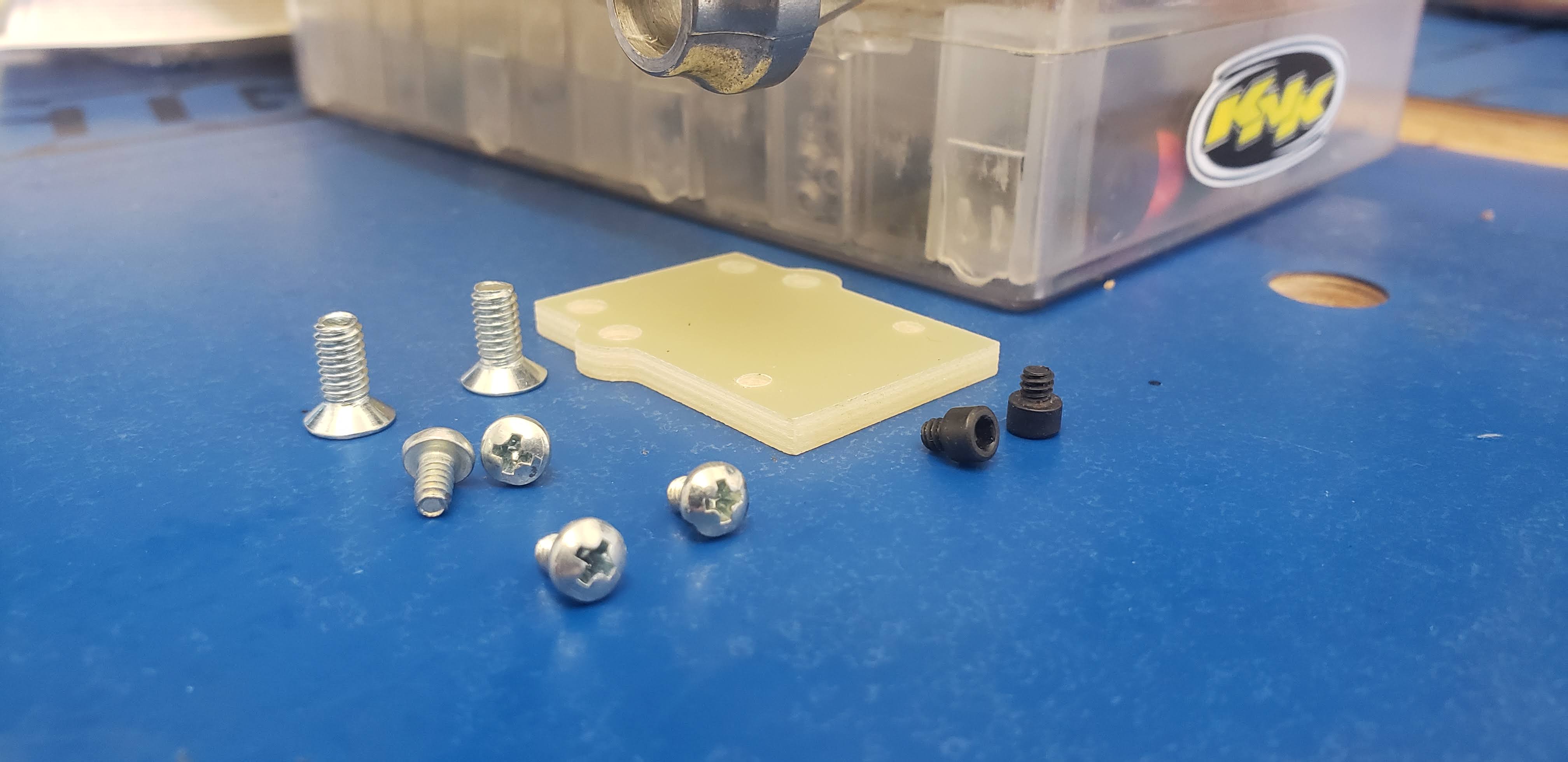

Well, I've mod'd the rear bumper and installed the longer trans brace, but have yet to drill the chassis :cry:
I have a few unanswered questions... I mean hardware, is the fiberglass plate meant to be the drilling template?
Also, what are the other screws for?
I've temporarily used the graphite car's rear bulkhead to mock things up
