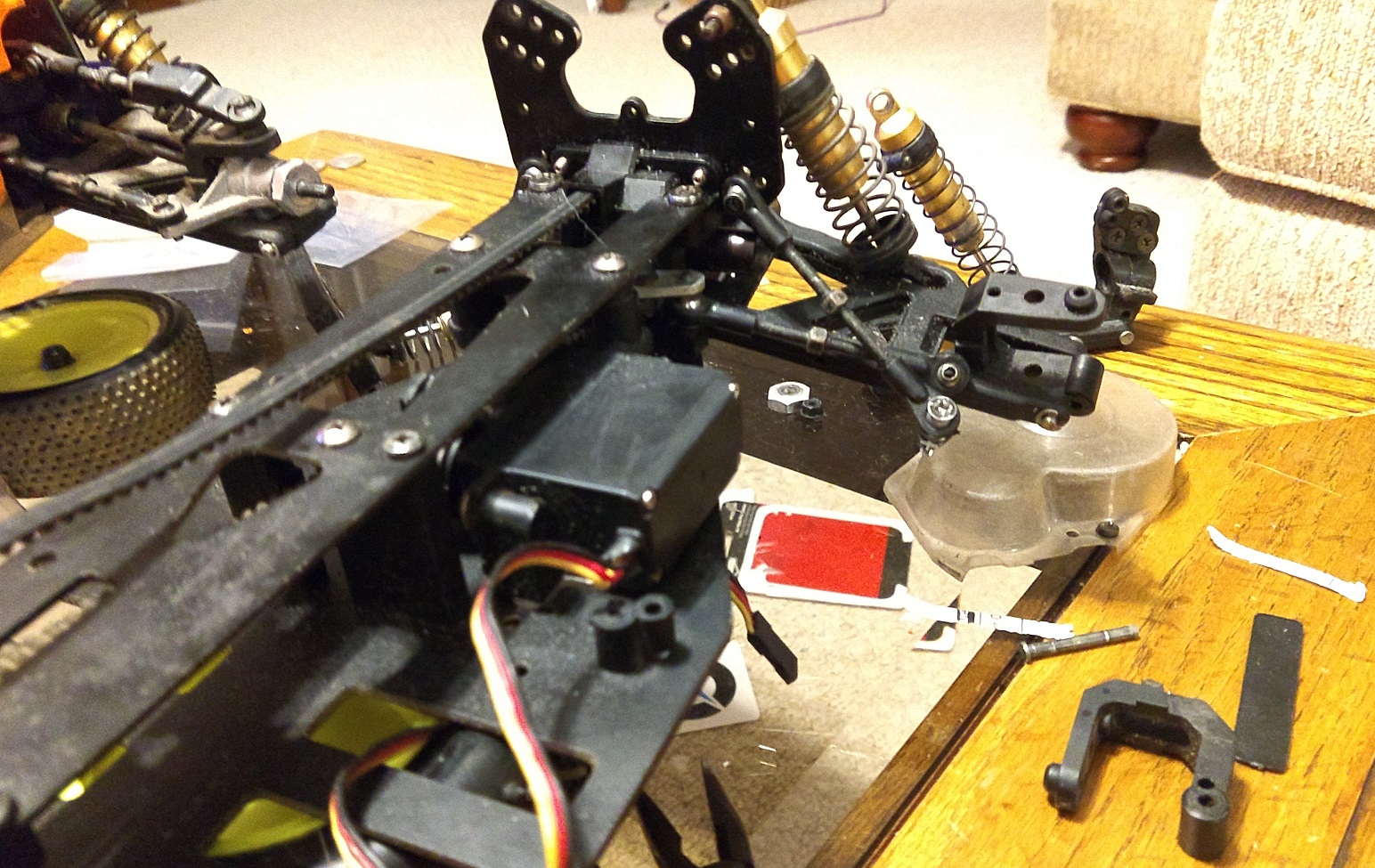

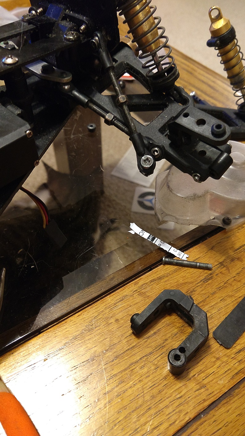

At first I thought one of my recently acquired Lazer ZX-R's was a mk2 because it didn't have the funky front-upper rod end, but now I'm thinking a previous owner drilled some holes in the uprights as a mod. Is that what it looks like to anyone else?

That looks correct for mk2, so does the front shock tower and chassis with 6 battery slots.
